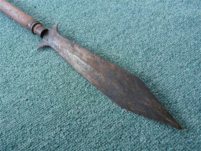

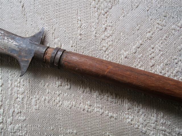

Hello, Just picked this up this rather interesting looking spear and would like your help on identifying where it could be from. I was thinking that it might be Naga but as I have found no other examples it is only a guess. It has a total length of 6 ft while the spear head itself is 12 inches in length, 2 inches wide near the tip and 3 inches wide at the base. These are ail approximate measurements and I will give more accurate ones once it arrives. Any and all help would be greatly appreciated. Sellers photos below.

I'm taking a guess. Indonesian for sure. Possibly Nias?

Pretty sure its not Naga - they don't have that type of iron sleeve on the shaft.

Hello everyone, I believe that Jose might be right on the origin of this spear. While I cannot find a photo of this exact style of spearhead I did find a reference in Albert Van Zonneveld's book "Traditional Weapons Of The Indonesian Archipelago" on page 146 where he states;
TOHO NIAS A collective term for a variety of spears. The point varies from small to large, with near the base two more or less protruding points, or a barb on one side. The shaft's upper side usually has a conical ring of brass or iron and may be decorated with pig's or goat's hair."
While there is no example or drawing of a spearhead exactly like the one I have shown above it does seem to fall under this description. Hopefully Albert might see this thread and be kind enough to give us his opinion on this item.

The spear point does have a certain resemblence with a form we see in Nias, but IMO it has another provenance.
1. Most Nias spears are more refined and more slender.
2. The iron of Nias spears is better polished.
3. This type of iron sleeve is not seen on Nias.
4. The shaft of Nias spears usually is adorned in some way with woven rattan straps, or brass strips.
So, it is not likely that it is a Nias spear.
Unfortunately I do not have a clue from where this spear does come from.

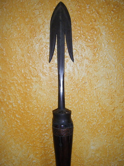

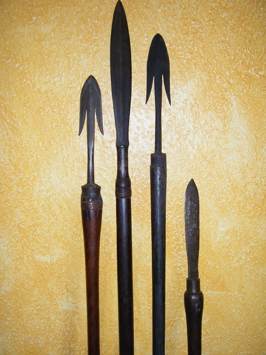

Attached is a photo on which the most common types of Nias spearpoints can be seen.

Hello Albert, and thank you very much for your help and information on this piece. The photo that you added will also be of great help to me in identification of anything that I might stumble across in the future. This spear seems to be a real puzzler and I can only hope that after it arrives and I can post more information on the dimensions and some better photos that someone might be able to identify its origin. Again, thank you for your help.

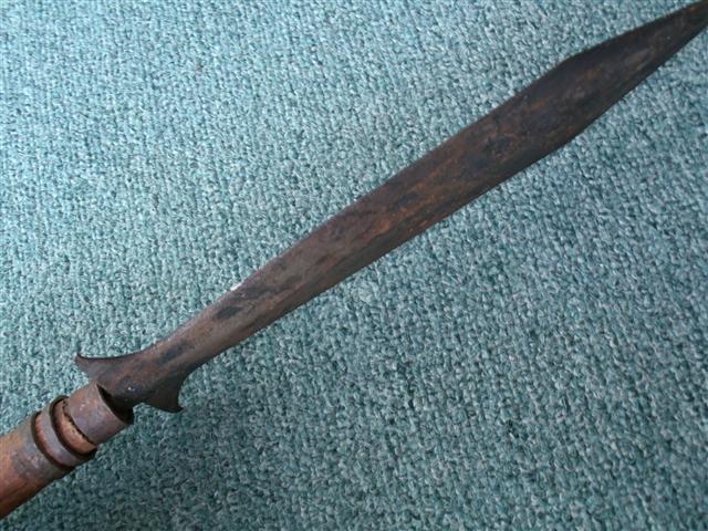

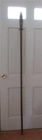

Posts: 2,196

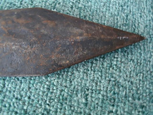

I have added two more photos from the auction. I do not know if they will be of anymore help than the others have been with the identification of this piece but they can't hurt either.

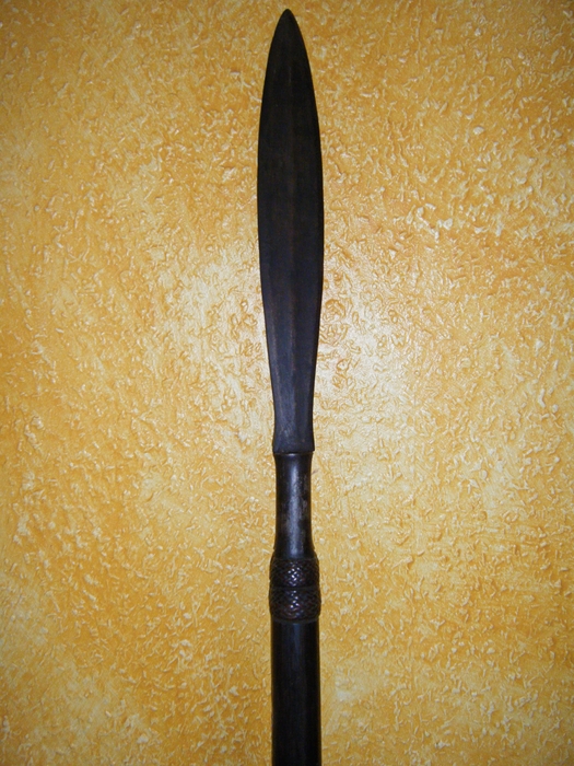

I think that your spear is more recent like the ones I have showed some time ago: http://www.vikingsword.com/vb/showth...ight=halmahera
I still think that your spear is from SEA, Indonesia or like Colin suggested the Phils.

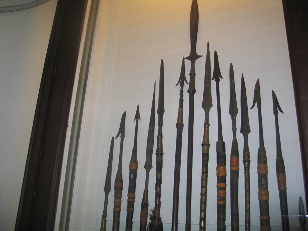

Here are a couple of images from the book (hope OK regarding copyright). Apologies for poor picture quality as they were taken in artificial light.
Colin

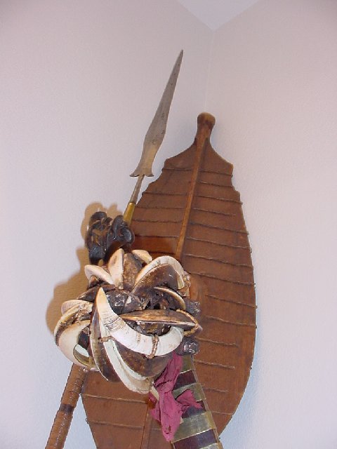

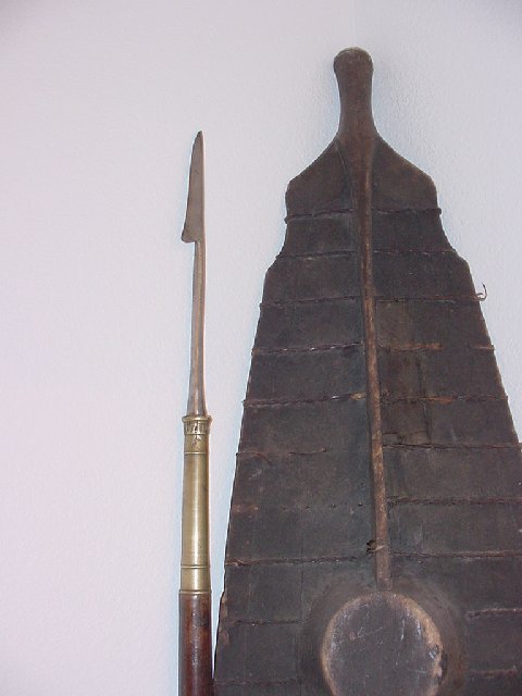

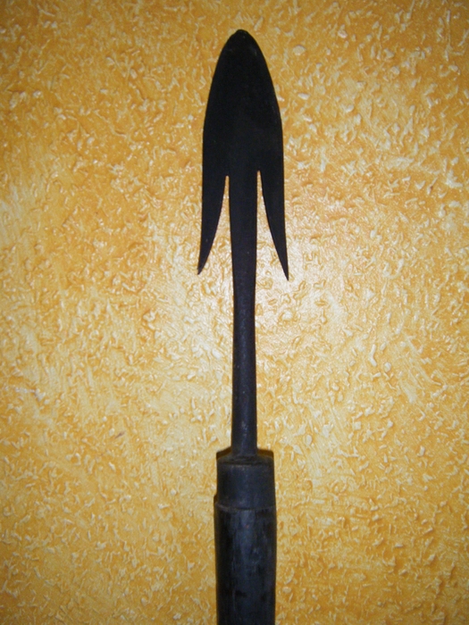

THE CLOSEST I CAN COME TO IT SO FAR IS NIAS BUT I WILL LOOK AT MY NAGA PICTURES AS I SEEM TO REMEMBER SOMETHING SIMULAR THERE. HERE ARE SOME PICTURES OF NIAS SPEARS. 1. PICTURE OF NIAS WARRIOR SPEAR IS TURNED SIDEWAYS BUT LOOKS SIMULAR. 2 OLD SHIELD AND SPEAR SHOWING AGE AND SILVER FERULE. 3. NEWER SPEAR SHIELD AND SWORD SET APPEARS TO HAVE IRON FERULE AND IS LESS ORNATE.

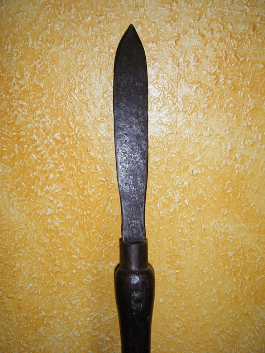

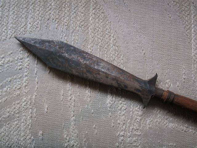

Bontoc spears look different, special at the collar, here for comparison the examples from my collection.

I just received a mail from a friend in Great Britain who is an expert for the weapons from mainland SEA, he have seen your thread and this is what he write me: This spear is from the Tonkin area in North Vietnam and can be found also in areas from Laos. The two rings are a simple way to hold the tang in place and typical for this spears.
