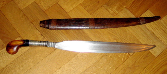

The second strange blade I found has a Barong resembling
blade with a broad fuller.
It's much lighter than an ordinary Barong.
Ivory hilt and silver ferrule with flowery pattern.
Any ideas what it could be?

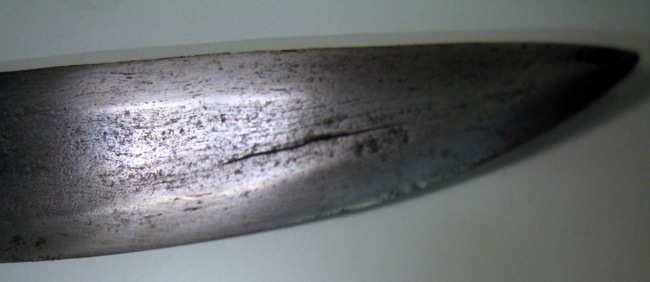

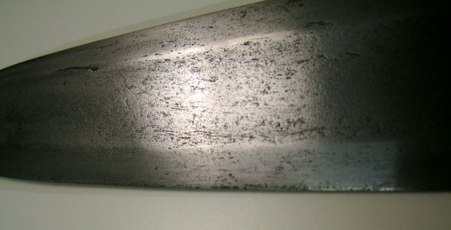

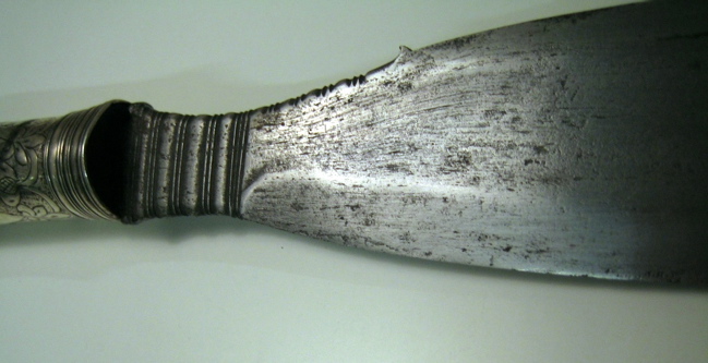

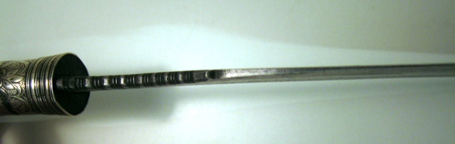

Rick, LabanTayo and others,
Here are a couple of additional pictures.
The blade looks identical on both sides.
Please note the peculiar small hook close to the hilt?
Look forward to your comments.
Michael

I've got to admit to being stumped .

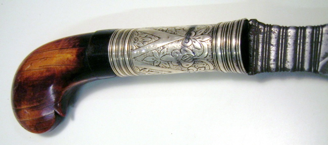

The decoration on the punto does not strike me as quite traditional okir patterns . The blade seems a bit thin for a barung but I have never handled a shandigan so I may well be off on this observation .
What is the material between the ivory and the punto ?
The filework at the forte of the blade is pretty puzzling as it does not quite look like the work seen on tenegre/sansibar/binangon blades .
Maybe we should be looking toward Borneo ....

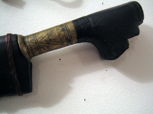

Rick,
It's a horn ring.
I have seen a resembling decoration as on the silver on two of my Melanau
(NW Borneo) parang - a Sadap and a Parang Pedang.
Enclosed pictures for you to compare.
Otherwise usually the Melanau parang have heavy and thick blades.

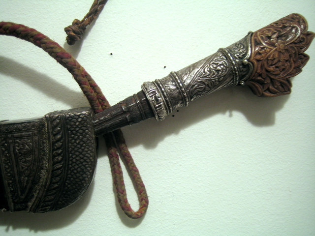

I just noticed that there are 3 dots in a (female) triangle at the bottom
of the scabbard which is usually attributed to Sumatra?
Michael

Re the scabbard :
I would like to comment on the resemblance to a Dyak scabbard in that this one has a neck like the mandau scabbards .

The blade shape, forte and scabbard point towards a rehilt of a Moro spearhead. There's too much metal around the forte to be a cut down barung. I've seen this forte form on a kris shaped spear. Double edged barung usually go half or two thirds of the blade spine, this shape goes down much of the rear. The punto design is still consistent with Sulu ukkil and the horn ring is not uncommon. The pommel is odd in that it was made to match the hook on the blade, intentionally designed to show that it was not a traditional barung. Possibly retired to a sword or rehilted to look like a sword for trade, nicely done work. Thinking out loud, btw...lolz.

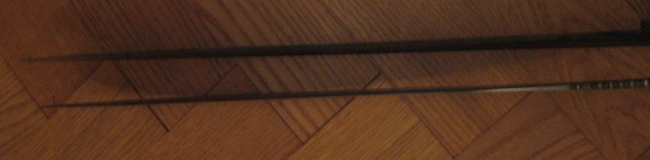

Also my blade has both a different tip and tang than a Budiak.
If you look at the blade thickness picture above it's obviously much flatter
than a Budiak and thinnest at its center.
Maybe Mabagani had another kind of spear in mind?

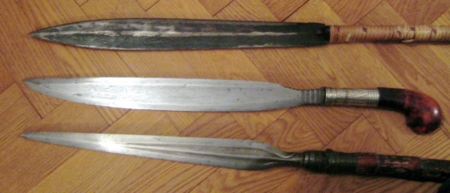

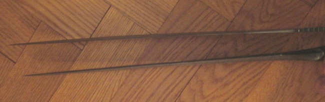

I think Mabagani's idea about the blade originating from a spearhead is interesting.
I don't know much about Moro spearheads but I noticed that some Dayak spearheads also are flat with a flat tang.

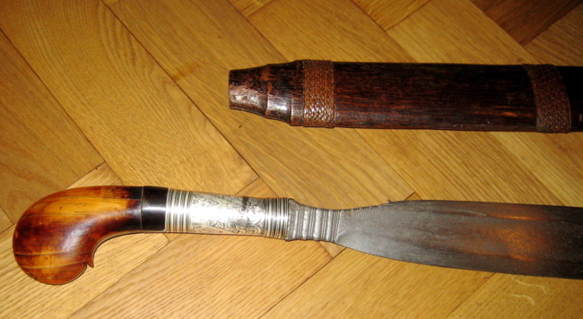

Pict 1 is the X blade next to a Budiak and a Dayak spear.
Pict 2 is the Budiak and the X blade from the side.
Pict 3 is the Dayak spear and the X blade.
Are there any Moro spears that resembles this Dayak spear?
Ben/Dajak, I still think Borneo could be a possible origin even if this blade doesn't belong to any of the documented swords.
But I am open to more specific arguments why it's impossible that it ever could have been assembled in Borneo?
Michael
