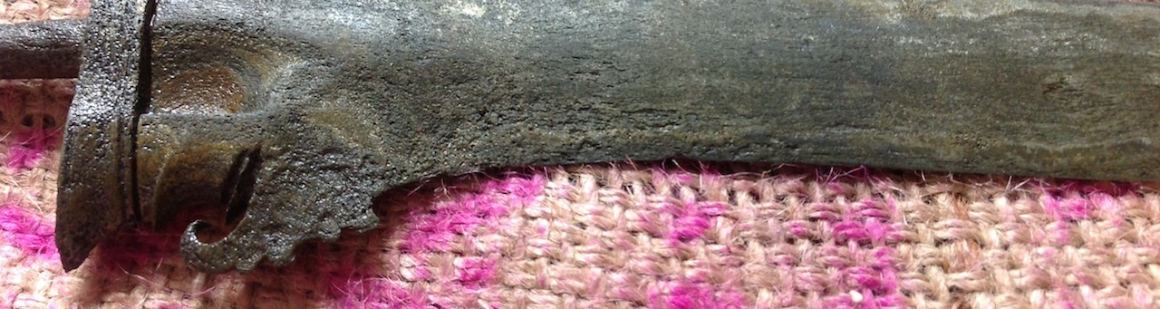

OK, my iPad was the problem. Here is an image of the keris, with rust on the ascendant. If I took time-lapse pics, the whole thing would be orangey red in 5 minutes, but a submersion for just a second in the vinegar eliminates the effect. I use spring water for the dilution, but even so that seems like a heck of a lot of iron oxide to have in water, at any rate you would think you could taste that much in a quart of water, and you can't.

when I take the blade out of my acid solution, it develops a very fine yellowy - red rust within minutes or seconds. Can I apply my warangan directly over this, or will I get an ugly rust reaction?
I have seen this happening with some blades.
First, you really have to make sure that there are no stubborn rust patches remaining on the blade; the warangan will still work on the clean metal but the longterm stability of the stain as well as the preservation of the blade may be compromised. From the last pic, I believe I do see remaining rust down in the blumbangan area. I'd also double-check all pitted areas and other crevices for "deep" rust: a set of fine needles, 10x (or so) magnification, and good light can do wonders.
Once this old rust is taken care of, I haven't experienced that a hue of powdery instant surface rust is really an issue for the warangan process. I usually move directly from the acid solution (vinegar or pineapple juice) to warangan. However, I prefer to wipe the wet blade with pure lime juice (several times if "dirt" is still coming off) to avoid wasting the precious arsenic and lime mix.

The light rust patina is not a problem. Once you have eliminated all the deep rust, cleaned the blade from oil and grease and dried it, you can start with the warangan. Since the warangan contains lime (or lemon), this will immediately eliminate the yellowish patina of rust on the blade.
Remember that etching a blade is not an exact science: the results depend upon the weather conditions, quality of the arsenious mineral, and first of all (at least in my opinion) type of iron. According to several experts, a bright sun would help, but, according to my experience, I cannot confirm this.
A friend collector has made an etching in a cold winter, and, he told me,
with unexpected good results.
Don't get discouraged if the first attempts will not be satisfactory. Try again and again. Once, after endless treatments with warangan, I decided to give up and I rinsed the blade in water. At this point the pamor immediately appeared ! I am still astonished.
