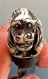

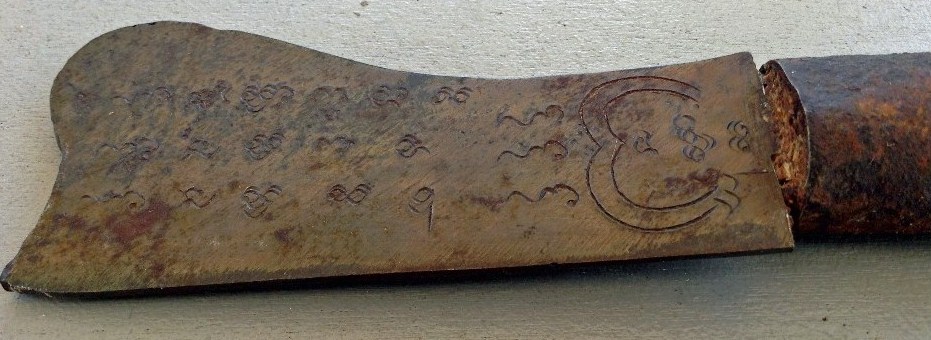

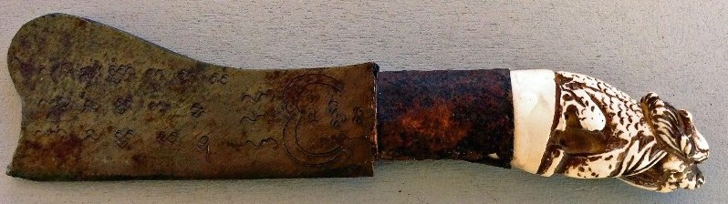

Just won the auction for this. The seller thought it was Vietnamese from the early 20th century but who knows how he came to that conclusion. It's only 18.5 cm long so it must be some sort of amulet or ritual knife?
The wavy lines on the blade look a lot like the marks you see on Thai dhas and whatnot. I wonder if they're writing or just decoration? I'll clean it up a little when it arrives and take better pictures.

Very interesting. Looking forward to see it cleaned. Is it brass? I am bit unsure about the handle in those pictures. More interesting than most stuff from SE Asia. Looks Burmese? Chindit handle?

It reminds me a lot of those Thai amulet knives, but the writing looks more like Burmese and I've never seen an amulet knife in this shape. They seem to usually look more like miniature E-neps or Kerises.

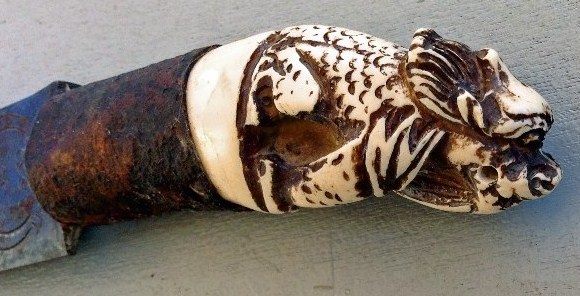

I've attached two more pictures that show the figure on the hilt better. Seller says it's bone but I bet it's tooth.

I think Burmese without a doubt. Google Chinthe. Just that handle looks funny? It might even be hamster bone {aka vandoo}

That looks like a dead ringer for the figure on the handle. I guess it's Burmese after all. Dare I ask what hamster bone is?
Edit: I just reread the auction description and he says it's a betel nut knife. It doesn't look like any of the betel knives I've seen on google though.

Interesting item! But not a betel knife. Would like to see some better pictures. The handle material look a little bit odd, would like to see some better pictures when you have received it.
Hamster bone : Barry has written recently in a other thread what people used to describe ivory in ebay and it seems that one seller has described it as hamster bone!

Not my area of expertise but I doubt this is Burmese. I'd say more likely northeast Thai (Esarn) or southern Lao. Could also be Khmer. You sometimes see similar billed as betel knives but would also have served admirably as a utility knife for basketry or other chores. The "magic" symbols do suggest some sort of ceremonial use. Good luck with your research.

The figure on the handle is definitely not ivory or hamster bone. It doesn't feel cool to the touch or heavy. When I tap it with my fingernail it makes a noise more like glass than ivory or bone or plastic.
I think it's cast, but I don't think it's plastic or at least not typical plastic. It's got what looks like a seam down the front but not in back, and the seam doesn't extend to the base. Only the carved figurine part. So maybe it's a flaw in the material rather than a seam.
I did the "hot needle" test and was able to press into it. The material didn't "glob" like plastic. It peeled out like wood shavings! Some of the peels stuck to the needle, so I held it over the flame to see if it'd melt. But it didn't melt, it glowed red and burned up. So I'm stumped.

I was wondering already when I have seen the pictures if it the same material which is used in Indonesia to fake ivory handles. By this material the hot needle test also don't work and this material is also cast.
Sorry about this bad news!

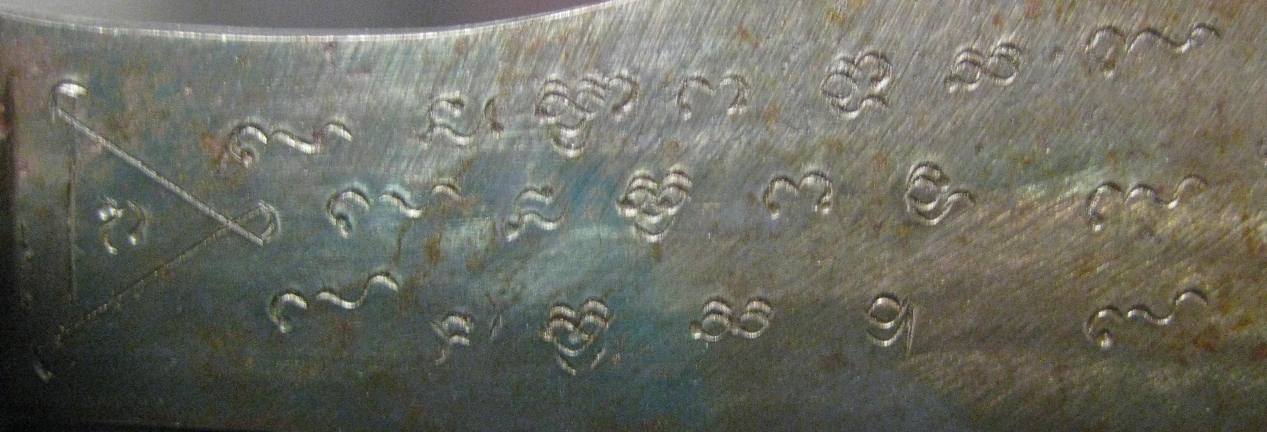

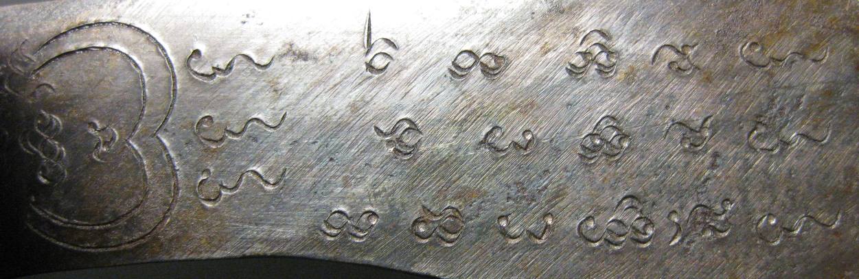

First up is the writing on both sides of the knife, assuming it is writing. It doesn't look like any writing system I've seen on wikipedia, but it doesn't look like random decorative patterns either. So I assume it is some sort of writing.

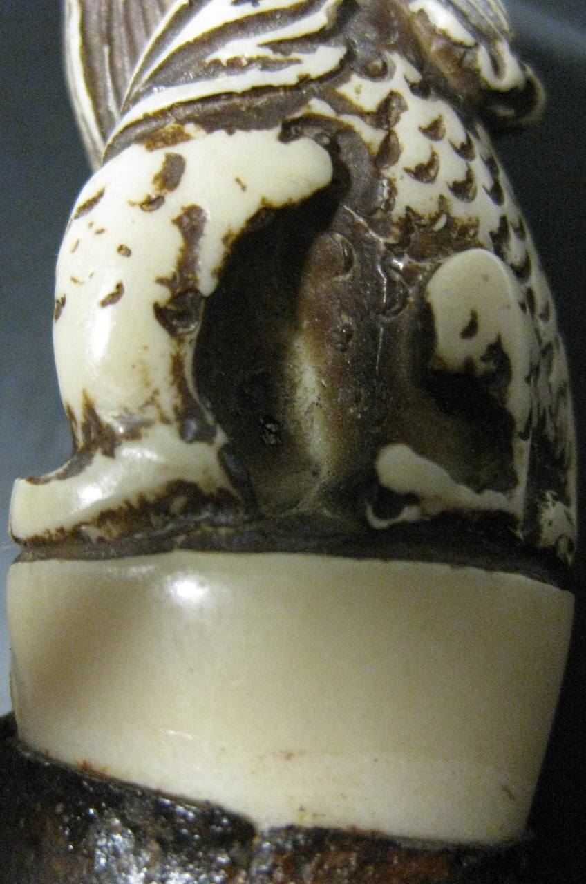

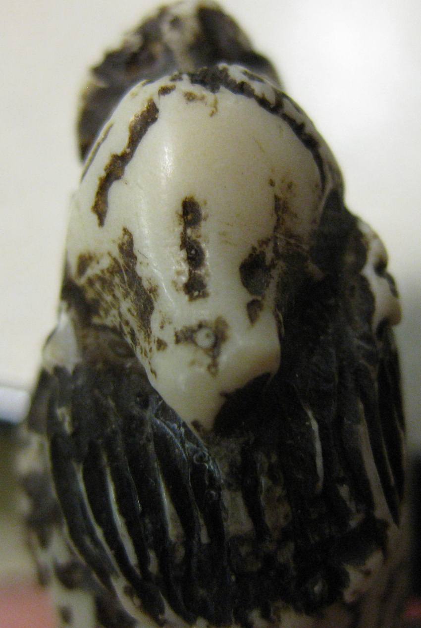

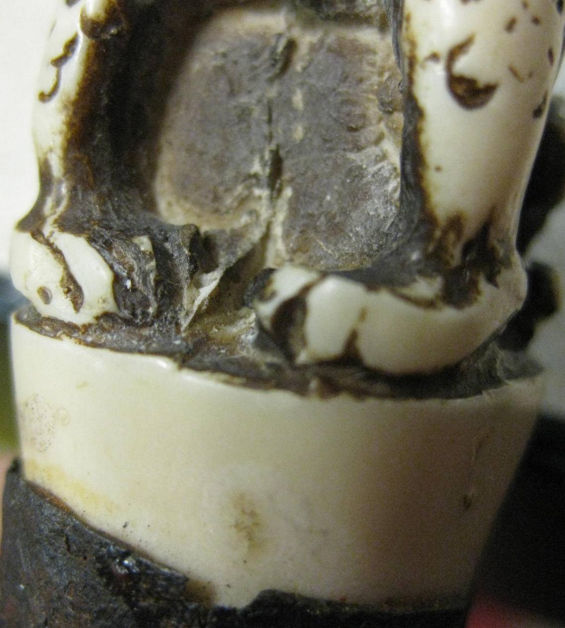

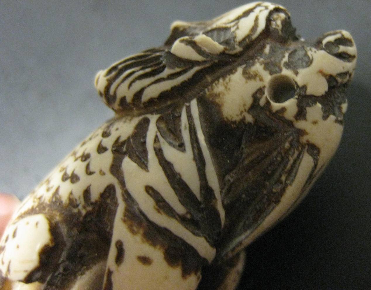

Next are closeups of the figure. I still don't know what it's made of. There's a hole going through its mouth. You can see what looks like a seam going down the front, but there's no seam on the back nor is there a seam on the "unshaped" part of the hilt.

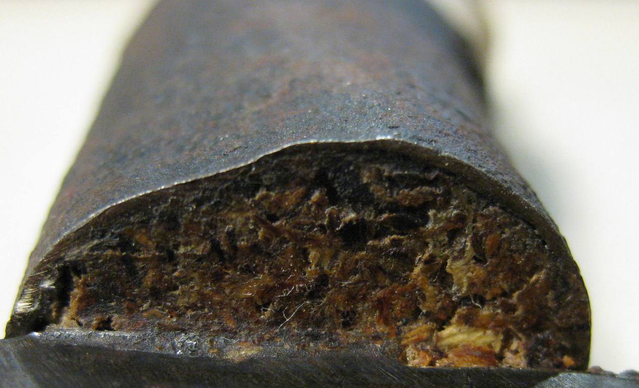

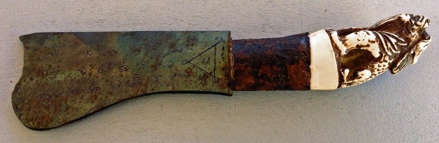

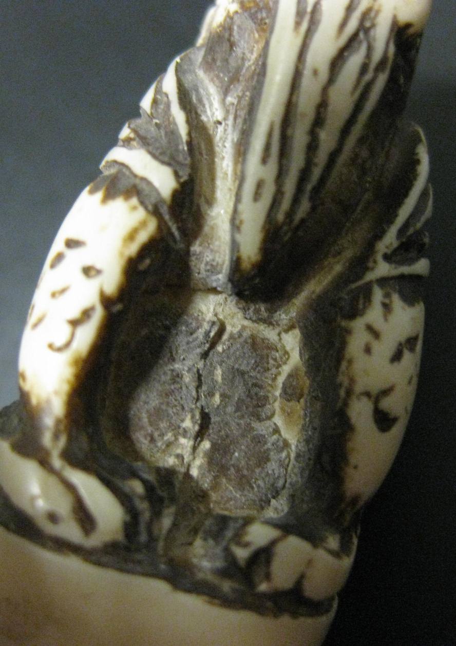

Here's a better picture of the front where the seam is. It's pretty obvious from this angle that it's a seam and not a flaw in the material. Also a picture of the back of the head.

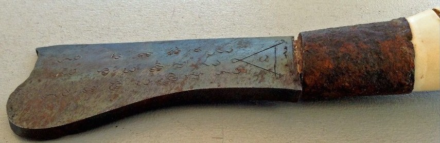

I attached a picture of where the blade meets the bolster, it looks to be filled with a natural material like wood. It feels waxy. I think the old handle broke off and this one's a modern replacement. The face isn't even properly aligned with the "edge" of the knife.

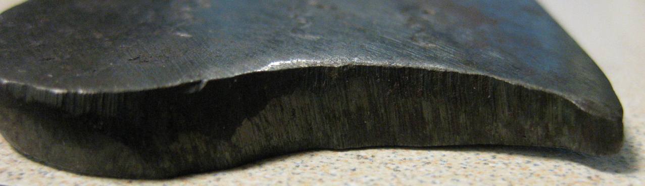

Lastly a picture of the "tip" of the knife.

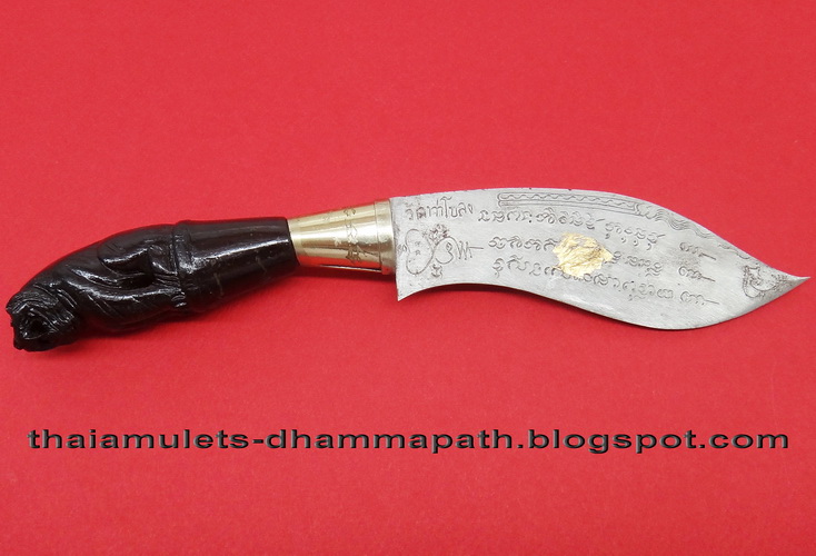

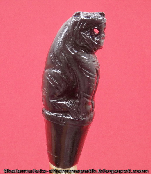

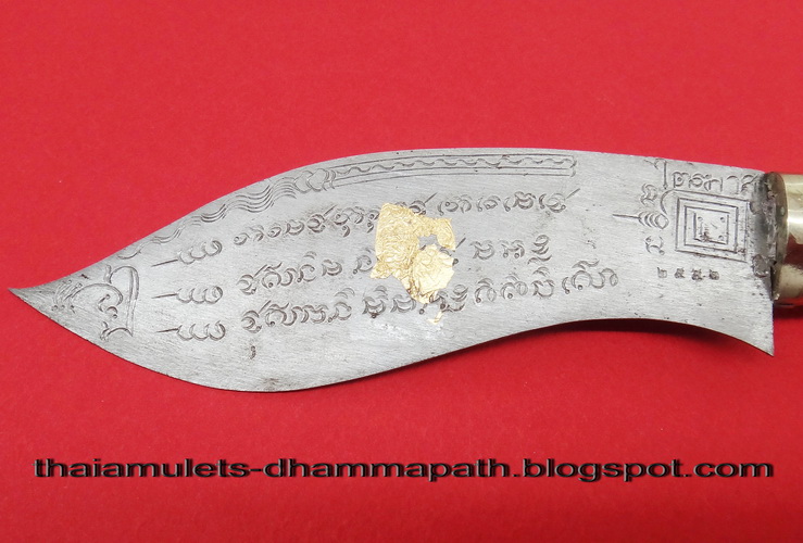

Thank you, I will. The more I look the more I think it's just a "meed mor" Thai amulet knife. I found this one with a very similar handle shape and very similar markings on the blade. Of course the blade shape is completely different.
http://thaiamulets-dhammapath.blogsp...ul-mitmor.html
Edit: It looks like the script is called Khom Thai script, and is used for Buddhist mantras and charms and whatnot.
The "M" looking decorations at the bottom of the knife are apparently a mantra praising Buddha. I still haven't found one with the blade shape of mine, though. There's tons of sites out there about this stuff, maybe I'll send pictures around to them and see what they say.

I posted some pictures of this thing on a Thai Amulet message board asking if anybody knew what it was. They said it's just a run of the mill "Meed Mor" amulet dagger. But Meed Mors always have pointy tips to them, so I asked why mine had such an usual shape. They said the tip had been broken off.
Now this thing is about 5mm thick so there's no way the tip could have broken off by accident. It would have had to have been done deliberately. Plus it looks nothing like a traditional Meed Mor knife even with the tip broken off, the shape is just completely different. So I think they just didn't know what it was.
