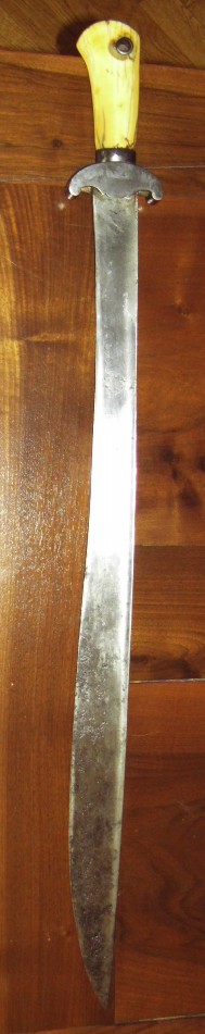

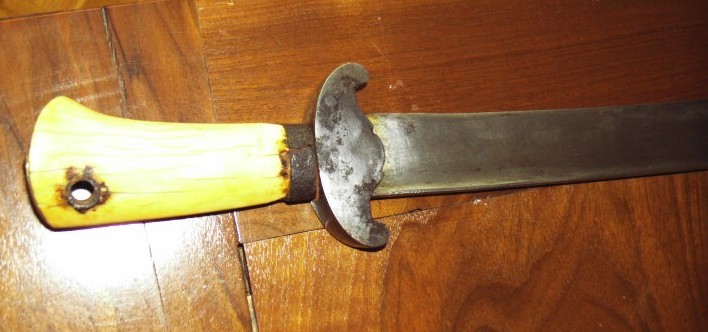

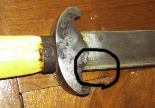

Hi!
I've been offered that puppy and I don't actually know what it is. Seems a german reinterpretation of a turkish yataghan The hilt is ivory? and the quillon section seems verry german to me or might be actually turkish simpler design of their WWI ordonance swords. The blade i verry plain and no decoration on it apparently. Is tat some sort of turkish ordonance short sword/dagger ith obvius simplified design?

Looks almost like a hunting sword

The guard has a Chinese look which I am not sure is quite right it just seems a little ill fitting. I am also suspicious about these file marks? Tim
Old 2nd February 2006, 07:18 PM   #4
Posts: 5,997
I am really sorry, I am hitting this pretty hard. The lanyard hole in the handle does not look as if it is through a tang, central to the blade or from the blades back. I am not sure the handles are blind like this on yataghan, if that is the correct terminology. Tim

This looks like a composite sword to me? Yataghan blade with a European style hunting sword hilt.

Yeah, I'm with you Louie on composite puppy.

It might be wise not to write this sword off too quickly as an assembled piece.
I recall there was a thread a few years back regarding the Pandors, in fact there was even a photo of one forumite dressed as one? They, among others, used such hybrid weapons-- or influenced them, in any case. There was endless warfare throughout the 17th and 18th century between the Turks and most of the Eastern European powers. This is probably a captured Ottoman blade fitted up for a German or Austrian. The bladeform is consistent with an earlier dating, and this type is also often pattern welded.
Though the grip is provincial relative to others I've seen, I will venture a guess in the latter 18th century. Someone who is more knowledgeable about this form of guard can probably place it within a decade or two.
Ham
If it is an assembled peice, it looks like the work was done quite some time ago. It also looks as though the new handle failed in use. So whomever bought this thing intended it for more then a simple wall hanger.

I would agree with you if it werent for the crossguard and the ferrule. The crossguard looks more chinese modern to me.

I am with Battara on this one. I suspect this has been assembled fairly recently. I too feel the guard is Chinese and recent, just have a look at the guards on some of the Chinese offerings from ebay.

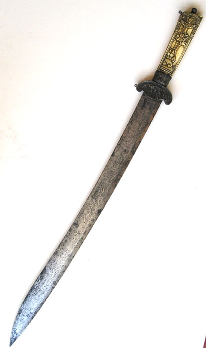

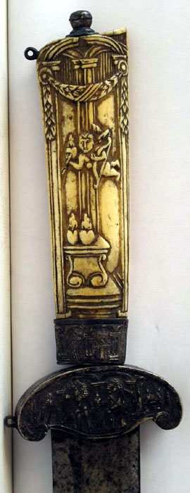

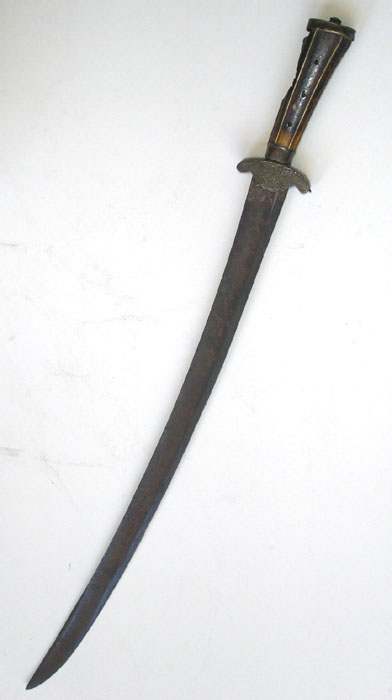

Tim, before you sip that bitter have a look at this:

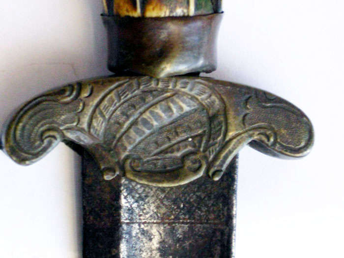

An early-mid 18th century German hunting sword fitted with a heavy double edged blade. Note the close similarity in the guard, also the one-piece grip.
There is another similar with a different form of blade ending on eBay shortly. When it does I will attach the link for further comparison.
Your observation regarding hunting and the aristocracy is a reasonable one. What it does not take into consideration is that though such swords began as hunting implements, they quickly became popular with officers and then, as is usually the case, with common soldiers as sidearms. Further, we are not seeing the sword above in its pristine state. The hilt parts are heavily worn-- note the corrosion on the ferrule. By contrast, the guard is bright. It has been cleaned over time, so that any embellishment which would originally have been found there is long gone.

That is very interesting Ham and I will agree that you have shown a similarity but just look how weak the handle of the one in discussion is, and then compere it to the one you have post. What do you make of the fresh file marks? Tim

The example Ham has posted presents interesting support for probable European provenance of the sword in discussion, very Oriental appearing guard as well recalling those of the Chinese jian. Trade with the Orient was well established in these times and Chinese weapons were keenly favored by aristocrats who proudly displayed them in thier estates.
These lighter and smaller swords known as hunting swords often served as 'riding swords' and sidearms favored by the gentry during the 17th century before the advent of the smallsword in Europe. They became well known as sidearms favored by officers, who of course were in effect members of the gentry as well. This was especially known among maritime figures, and the hangers of these forms became well known among naval officers, officers on trade vessels and the familiar examples seen carried by pirates. They of course served well in close quarters combat as aboard ships, and in other instances were comfortably worn in city wear and riding, as well as in many combat situations found good purpose during melee. Despite thier utilitarian associations, these hangers were effective sidearms for defense.
By the 18th century, hunting hangers had become well established among gentry, and often were produced as esteemed gifts and presentations in many situations. Their use as weapons is clearly shown in the Lebedynsky reference I have cited as well as many others, and larger more combat intended blades were indeed added for mounted use. Since regulation swords were not entirely in place as yet, especially for officers, who maintained free reign to carry sword styles either in vogue, heirloom or presented as they saw fit. The auxiliary forces of course carried whatever weapons they favored or had captured.

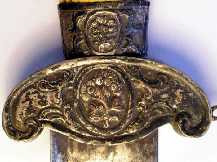

Tim, what I have tried to show here is not that I dug up another sword with a similar guard-- that tends to leads to "the chicken or the egg" reasoning. Rather, I am trying to present the notion that one ought to search out and recognise formal groups, in this case guards, which tie together like examples.
Here is another of this type:
http://cgi.ebay.com/OLD-CONTINENTAL-...QQcmdZViewItem
Comparison leads to second deduction-- these similarly-hilted weapons share a spectrum of blade forms: we have one mounted as a yataghan, one symmetrical and another single-edged. This also supports a European origin for the sword under examination. The most general requirement I suppose is to broaden one's knowledge of forms as much as possible. Fortunately for most of us, it's a pleasure.

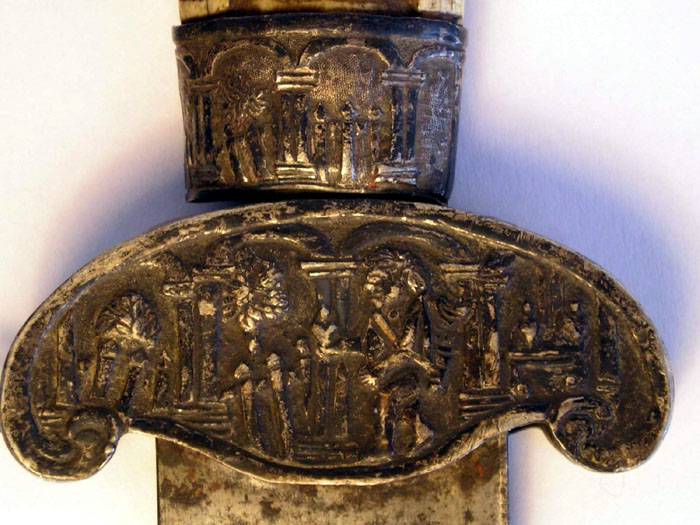

As for the scratches on the guard, I can barely make them out I'm afraid. However given the condition of the ferrule relative to the guard, I would suggest that the scratches are indicative of cleaning which was more enthusiastic than skilled. Finally, I don't seem to be able to find any Chinese swords in any of my references with guards that bear more than a vague similarity with that of the one under discussion. Can you provide an example please?
Ham

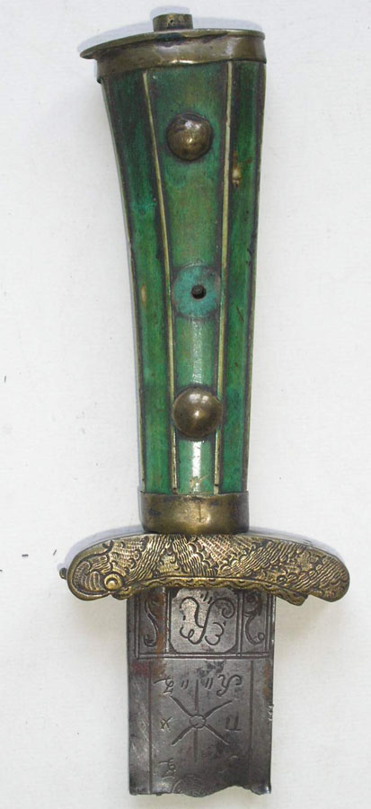

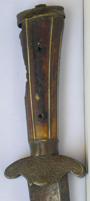

Dear All!

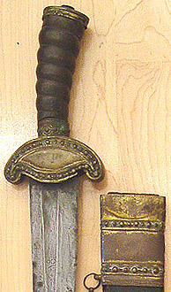

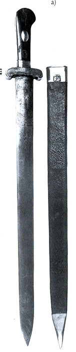

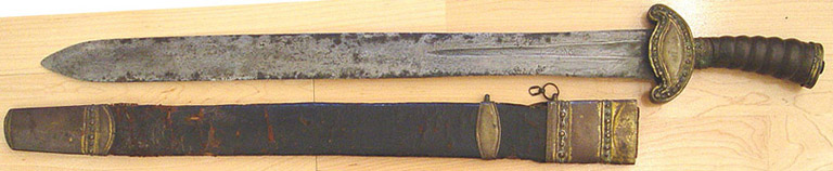

I'm happy to see discussion on this particular kind of hangers. I was always curious of this type because there are rarer and there is almost lack of any informations about them.
I haven't much time to watch discussion very carefuly, but if I understand well, we've got two problems.
First one is about genuineness of Valhjun's hanger. I'm not taking voice here about it, but I can say the hilt is quite poor. Such hilts were usually decored with engraving and repusee. But maybe such exceptions existed, though its out-of-style appearance is somehow strange.
But I will second ham's and Jim's thoughts about hangers. Such ones with "chinese" hilts existed, and were produced in Europe, probably in central Europe, and it was somehow connected to oriental fashion popular on courts. Below you'll find more examples. First and second one are from book "Hladno lovacko oruzje" by Dora Boskovic. First one was made by Clemens Weyersberg in Solingen, 1730-1740 y., second is dated on 18/19 c., so it's quite late. Other ones are examples from my museum, dated around 2nd and 3rd quarter of the 18th century. One is with yataghan blade, with etched inscription looked like pattern, other one is with badly damaged, broken blade, but you can see some magical signs in there, used mostly in Germany.
Regards!

Fantastic wolviex, this has been most informative and so far I still do not feel I have to eat all that I have said . The one in question does not even look that old and as the pictures show the handle is stubby and not elegant. I do not think I have seen this Chinese style on British hunting hangers.

My hat is off to you, Wolviex, I guess you solved this one, pan Michalko... I wouldve probably throw it as one of the Russian potentates hunting dagger, two-three centuries ago.

There is one thing I would like to solve to avoid some misunderstanding. I put CHINESE in quotes because this is style which we are matching as such. I'm not quite sure if it was made as "chinese" in 18th century, how far our European ancestors were familiar with so exotic weapons from far far east. Maybe it's just a simple convergence of shapes? So the question is, do we have 18th c. chinese weapons that could be a pattern for these hangers, and were they know in Europe?
Eastern fashion, I thought about, is appearing in yataghan blades, fitted to European hangers.
