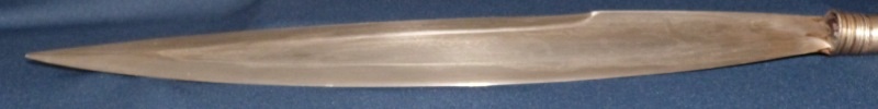

Perhaps it is related to this blade?
Michael

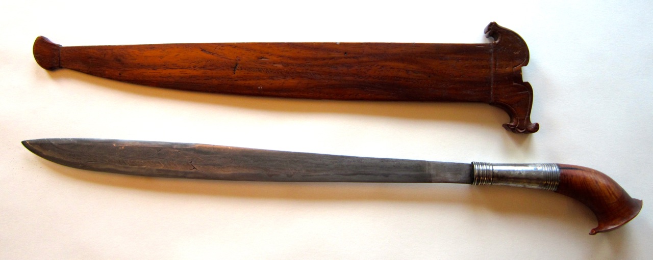

It looks like you dabble in forensics photography
I too believe that it's a Barung, perhaps one with a longer than usual slender blade. I took a photo of mine, trying to mimic the angle of the blade.
The one in the photo probably has a kamagong Jungayan pommel with a bone insets.

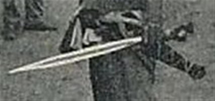

I would like to thank everyone so far for their very much appreciated opinions and help on this.
Kino, thank you for the comparative photo of your barong that helps to show how the camera angle can make an object appear very different from how it actually looks. I'm still not so sure that the photos I have posted show a Jungayan pommel on the sword in question, or if what looks to be part of the hilt is actually some kind of debris laying on the ground behind the subject. If you look real close at either of the above photos the very end section (possible Jungayan pommel) seems to be casting a shadow. Or like I said earlier, it could all just be that my not so great anymore vision is causing me to see things that are not there.

Kino,
That example of your's sure looks spot on with the one in the photo.
