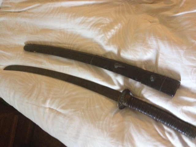

Hello to you all and I want to first thank you again for allowing me to be added to your fine community! I have, recently, been investigating a mystery that has taken me back through time to uncover as much as I can about a sword that is now in my families possession. It was recommended that I check here next, so here we go!
The Story (before another webpage put me on the right track):
My Grandfather received this sword from a Japanese officer during WW2 that he saved. The story goes that after saving the life of said officer, the officer gifted this sword to him as thanks stating it was in his family for "generations", passed from "hand to hand of each military son for generations", and was "ancient".
Since then:
I have discovered (since the story) that the sword is "blade" is VOC (pictures included). Here is a link to the conversation I have had with some great members at another site: http://www.militaria.co.za/nmb/viewt...p?f=15&t=18647
What I am curious about is if any member here has any further information they may be able to shed light on for me. I have exhausted every resource that I can think of in terms of museums, colleges, VOC ship manifests (thank you University of Copenhagen) and the like and the consensus seems to be:
1) Sword combination is rare
2) Nobody has seen that combination before on any VOC weapon (in terms of culture clash).
Again, I thank you for your time and consideration in any insight you may be able to give me into this weapon as I am enjoying this hunt for historical mystery.
Okay, let's get right to it and show you guys the pictures!

Hi Medar, and welcome to our forum!
While the participants on the other forum seem reasonably knowledgeable, I very much disagree with some of the rather blunt responses rather than looking into plausible scenarios for this absolutely fascinating hybrid.
It is important to note that the VOC (Dutch East India Co.) in addition to their presence throughout Indonesia and other Asian locations, had a long standing presence in degree in Japan. While quite limited, they maintained factories at various locations, it seems usually in islands off the mainland. During this time the chief factors of the VOC were required to pay periodic visits to Edo, the seat of the Tokugawa Shogunate, as well as pay tribute. The VOC was allowed to remain in these restricted Japanese locations even during the closure of Japan to the West.
This VOC blade appears to be correctly inscribed with the company logo and the year date 1756. In about the mid 18th century it seems the company consistently had blades marked in this manner, and the 'A' is has been mentioned for Amsterdam, the primary city of the seven key chambers of the VOC in the Netherlands. These blades seem to have typically been produced in Solingen for the Dutch.
The mounts of this katana seem well done, not in true nihonto fashion, but extremely nicely represented. In the time that the Dutch occupied these Japanese locations, in this case post 1756 through the 1796 year the VOC ended, we know that diplomatic interaction existed between these powers in this arrangement. It is quite common in these circumstances to see various forms of hybridization with weapons, whether as diplomatic gifts or with individuals combining styles and fashions in a sense of novelty or exotica. This sort of hybridization was common in India during the British Raj, with Indian hilts carrying British blades and vice versa.
An individual of the VOC may have had his blade mounted in a representation of an authentic Japanese katana in one of the other factory locations in the Indonesian archipelago and worn it in his time when returning there. In some sort of diplomatic gesture or interaction he may well have presented it to a Japanese individual, and that person may well have kept it through generations.
Japanese officers of course are known to have carried their heirloom swords to campaigns in WWII, and while quite unusual, this anomaly may well have been carried accordingly.
We know that in Sri Lanka, many 'kastane' swords were mounted with VOC blades, and these blades occur in other similar circumstances throughout Indonesia and Malaysia, however..this is absolutely the first instance of a Japanese type katana with one I have ever seen . Fantastic!
Though it is doubtful that this unusual sword can be traced with any specific detail, however it seems quite possible that the scenario I suggest might account for its circumstances and an extremely rare and unique case as recounted by your grandfather.
As an alternate though more modern instance, it does seem possible (as Battara has suggested), that a Japanese officer might have had a katana fashioned in the Indonesian archipelago using a locally acquired VOC blade and by a local craftsman. This during the Japanese occupation there 1941-42. The only thing that might disagree here is the VOC inscription on the scabbard, which there would be no reason to duplicate.
In either case, it would explain this most unusual anomaly, and support your grandfathers wonderful legacy.

I just realized there were more pages to the thread linked from the other forum, and the information added pretty impressive and rendering my notes pretty redundant, particularly the data from Ian Bottomley.
Still this is truly a great mystery!!!

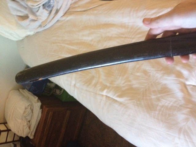

Here are some other pictures guys. And thank you again (so very much) for your time and consideration in this mystery. This has been enjoyable but finding information on the VOC blades seems hard to come by.

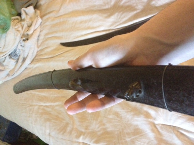

More pictures

Rich, i don't think you are going to find a hamon or boshi on this blade as the blade itself seems to be a European VOC trade blade placed in Japanese dress.
Old 17th April 2014, 06:51 PM   #11
yes, for sure the owner should NOT polish the blade, or remove the patina, there will be no hamon on a european VOC blade as they do/did not differentially temper these mono steel blades and it would lose not only value but it's soul. oil it and treat it with the respect due it's age.
