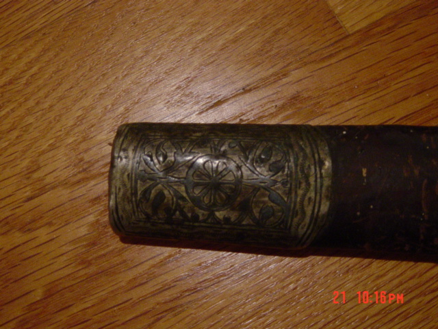

Here is my new Shashka. Despite being advertised by some people here as a "Shashka maven", I am far from it and need help.

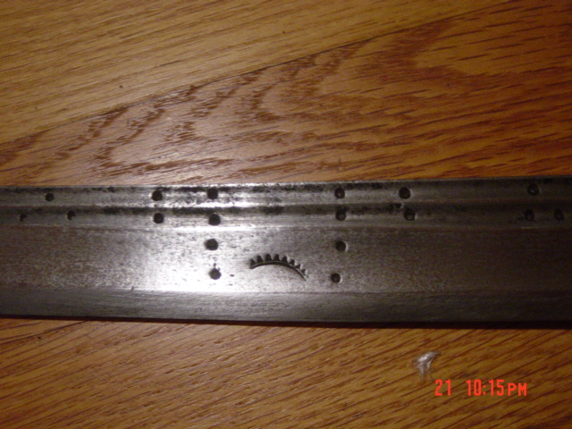

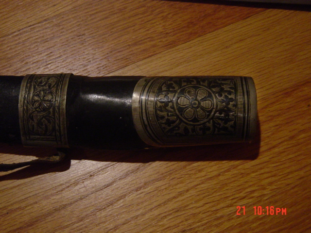

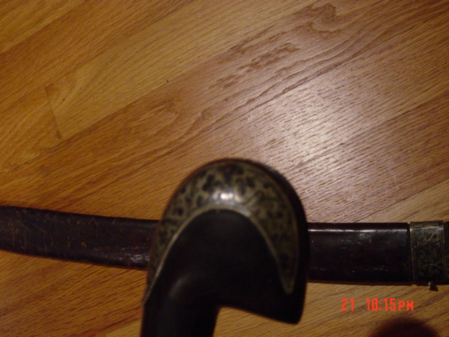

First, it is completely original, down to the wood inserts of the scabbard(very worn, though). The leather is two -color: black at the top, burgundy at the bottom (Daghestani?). The blade is locally-made and has a half-gurda mark with several indentations around (Daghestani?????). It is quite heavy, as opposed to the light Circassian ones. The handle is one piece horn, with meduim size split (not very narrow as Circassian, but not as wide as Georgian). The decorations are , likely, silver-coated brass (cheap, cheap, cheap....). But the ornaments look Circassian to me, with niello-ed central rosettes and very sparse embellishments around, although there are no typical Circassian "horns". There is no date, no name, no inscription.
I tend to think it is Daghestani, early-to-mid 19th century (Shamil???)
Need opinions.

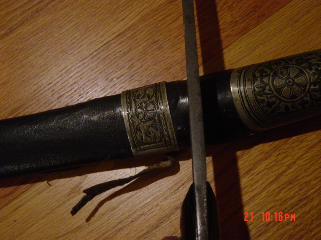

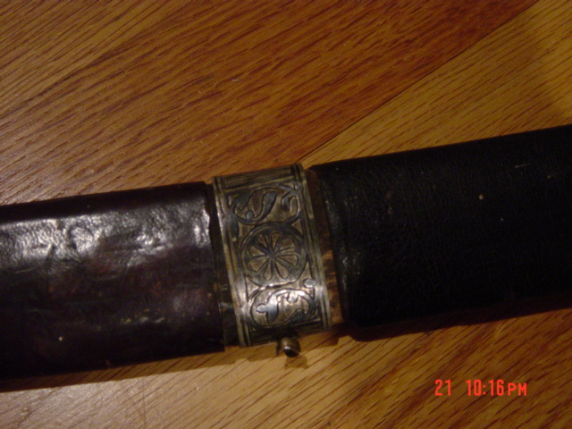

I dont understand this 2 color leather. Is it possible, the black leather to be later? Also, something is missing in the center of scabbard or it is the shrinkage from the age?

The bi-color scabbards were quite popular, especially in Chechnya. And I have found an identical ornamentation motives in the Astvatsaturyan's and Askhabov's books: both unequvocally attributed to Chechnya.
The gap in the middle is just age shrinkage of the leather.

Thank you Ariel. I didnt know this 2 color mode. The most antique shaskas you see these days they have replaced leather. I like very much the detail of the pommel with this niello work.

This is an excellent example of a Chechen shashka of the third quarter of the 19th century, and an untouched one at that. Congratulations, Ariel.
As Rivkin observes, the combination of red and black were popular there, not only as regards scabbard covering but garments and other male accoutrements as well. Astvatsaturian includes Chechnia in the Circassian culturalsphere-- and here is proof. The engraved motifs and background matting, in addition to the bicolored leather, point to Circassian influence.
Ariel, if you polish those mounts you will find they are silver, not brass. Not sterling grade, but silver nonetheless.
