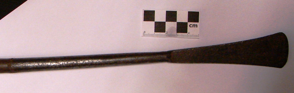

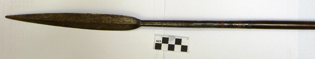

I'm puzzled by this spear: not even sure if it belongs in the European Armoury rather than Ethnographic Weapons forum. The length 163 cm; wooden shaft smooth, polished, slightly tapering towards each end. Socketted head; no pins through the socket. Three bands of copper inlay at the end of the socket. The socketted iron butt has a very distinctive flred flattened end.
I can see no armourer's marks, but have a suspicion (only because I can't think of anything else!) this might be for one of the British Imperial Army units - possibly Indian cavalry, or a Camel Corps ??
Any suggestions ?

Old 28th April 2014, 08:42 PM   #2
spiral
Posts: 1,712
Not my field but Id have guessed Taureg?
Spiral
Old 28th April 2014, 10:02 PM   #3
LJ
Join Date: Mar 2014
Posts: 93
Many thanks for the suggestion. I did consider that it might be a Tuareg Allarh (because of the flaring end of the iron butt), but I wasn't wholly convinced. Perhaps my first instinct was right after all.

Old 29th April 2014, 06:40 PM   #4
Richard G
Join Date: Jan 2012
Posts: 419
How about French colonial? the famous Spahis and that kind of thing. Just a guess, but that Tuareg type butt seems most unusual for a British spear.

Old 29th April 2014, 07:35 PM   #5
spiral
Posts: 1,712
Years ago I had a Taureg spear... {Only ever owned 3 spears.. }It also had 3 inlayed brass rings.
I personally don't think it colonial army either British or French. I think Tribal North west Africa... Taureg or similar...
But I would have thought some people on the forum, who specialise in such things, would be more certain or pass comment?
Spiral
Old 29th April 2014, 10:30 PM   #6
Iain
Iain's Avatar
Join Date: Mar 2010
Location: Olomouc
Posts: 1,720
Better images would help. Including the entire spear. It is certainly west African. Tuareg is possible but so are a few other groups.
Old 30th April 2014, 02:39 PM   #7
Emanuel
Emanuel's Avatar
Join Date: Jul 2005
Location: Toronto, Canada
Posts: 1,242
Is this not from Madagascar? I thought that particular flush socket-shaft construction with collars and flared but was a distinct feature of Malagasy spears.

Old 29th April 2014, 07:14 PM   #8
LJ
Join Date: Mar 2014
Posts: 93
Also, although I raised the possibility of it being for a mounted soldier, I've had my doubts about that. It's only 5ft 4 inches long, much shorter than you would expect for a cavalry lance.
Any expert out there on French colonial weaponry ?
LJ is offline   Reply With Quote
Old 30th April 2014, 06:28 PM   #9
LJ
Join Date: Mar 2014
Posts: 93
Madagascar - yes, you've scored a direct hit ! Looking for "Madagscar spear" on Google comes up with a spear-collectors site that comments "The warriors carried elaborate spears, which remind on Tuareg or Bornu spears with copper and brass inlay and a flat spear shoe. The shaft is from two tone hardwood". Also, checking the British Museum online database reveals a few images of Madagascar spears that are identical to this one.
Many thanks to all for their thoughts and comments
Old 1st May 2014, 12:40 PM   #10
LJ
Join Date: Mar 2014
Posts: 93
The Madagascan spear heads were not always broad. This photo of a Sakalava man from the book 'Living Races of Mankind' (volume 2, p. 482) shows him holding spears where the heads are slightly wider than the man's fingers.
I think a key difference - which would involve comparing spears with good provenances from Madagascar and West Africa - could be the form of the butt, and especially the shape when viewed in profile. One other feature, which seems to be common on the Madagascan spears in the B.M., is that the seams of the sockets 'gape': which is the case in this spear. However, I haven't seen enough West African spears to know whether the socket seams commonly overlap / meet / gape.
If more photos would help, I will have access to the collection tomorrow.
Old 1st May 2014, 04:09 PM   #11
Iain
Iain's Avatar
Join Date: Mar 2010
Location: Olomouc
Posts: 1,720
Great ID! Not the first time I've confused these.
