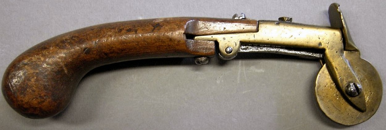

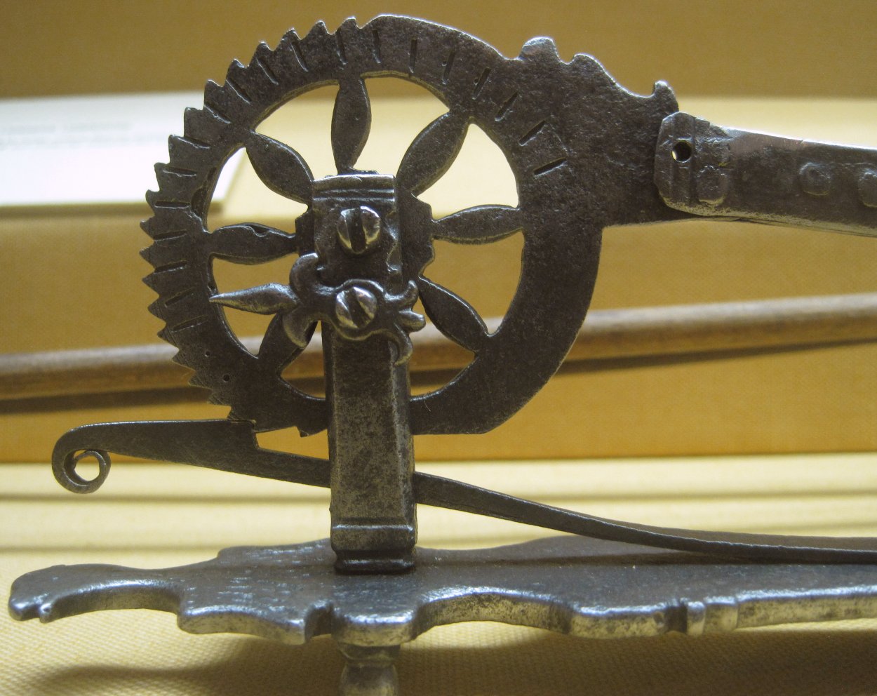

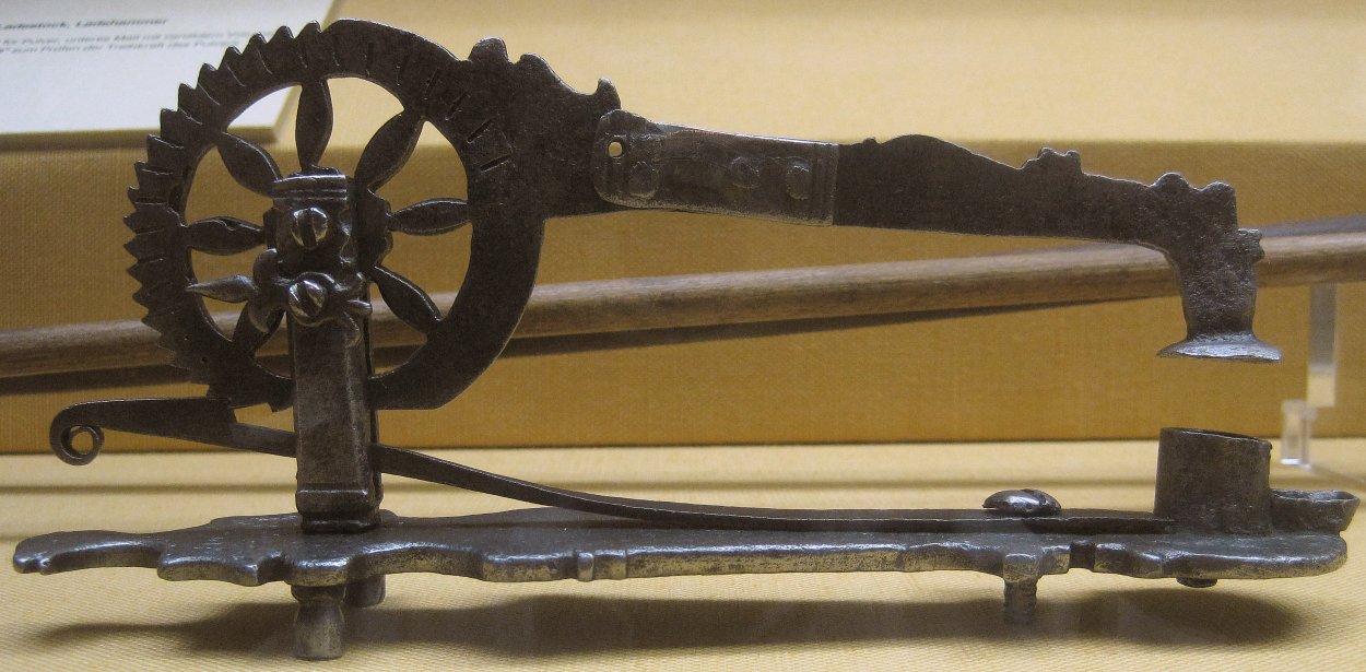

Default Unusual powder tester for comments

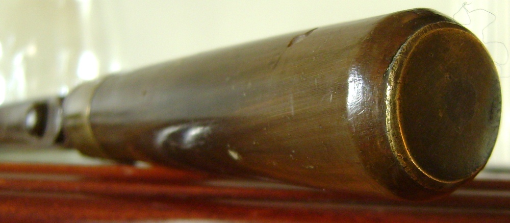

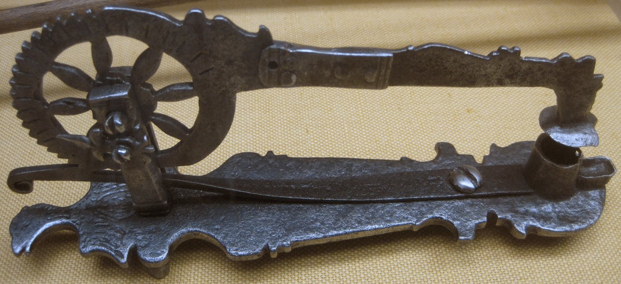

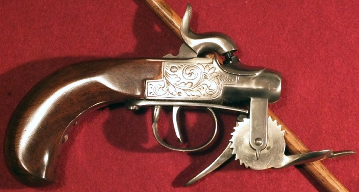

Well, unusual for me, as i have always seen these things shaped like pistols ... handle, trigger and all.
This one has a more austere look, more like a 'lab tool' .
... and the ignition system is fascinating; different from the classic flint or percussion mode. Was the technique priming the touch hole lip with some powder or instead the match cord way ?
An 18th century example for sure, right ?
The handle is horn; which type, i don't know for sure.
... as i wouldn't know the origin of this device .
Any help in part or the whole query, please ?

Hi Nando,

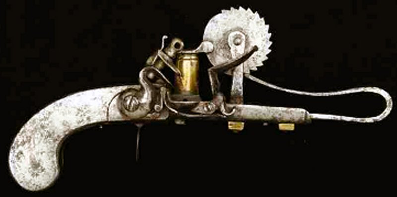

I cannot say much more on this specimen than this: it was apparently made in the first half of the 19th century and widely used by dealers and shooters alike in order to test the quality of black powder. The toothed wheel is scaled to indicate the degree of intensity/quality at the time of explosion of the powder.
You say that you have mostly known similar tools with pistol grips so far. This may be due to the fact that most of them were table lighters for private use at home, most of them equiped with flintlock mechanisms.

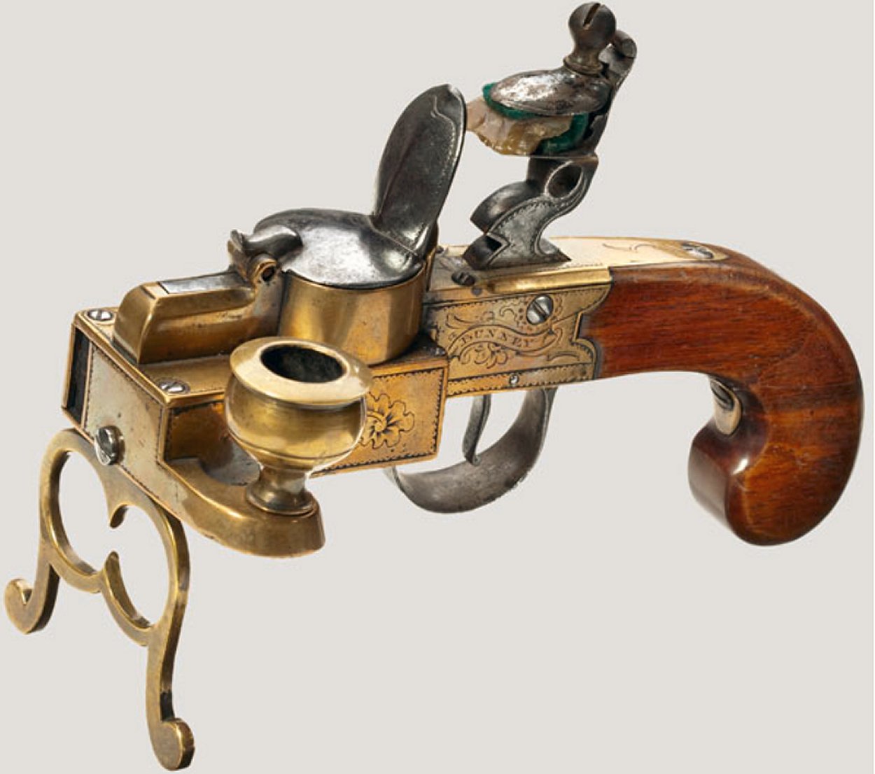

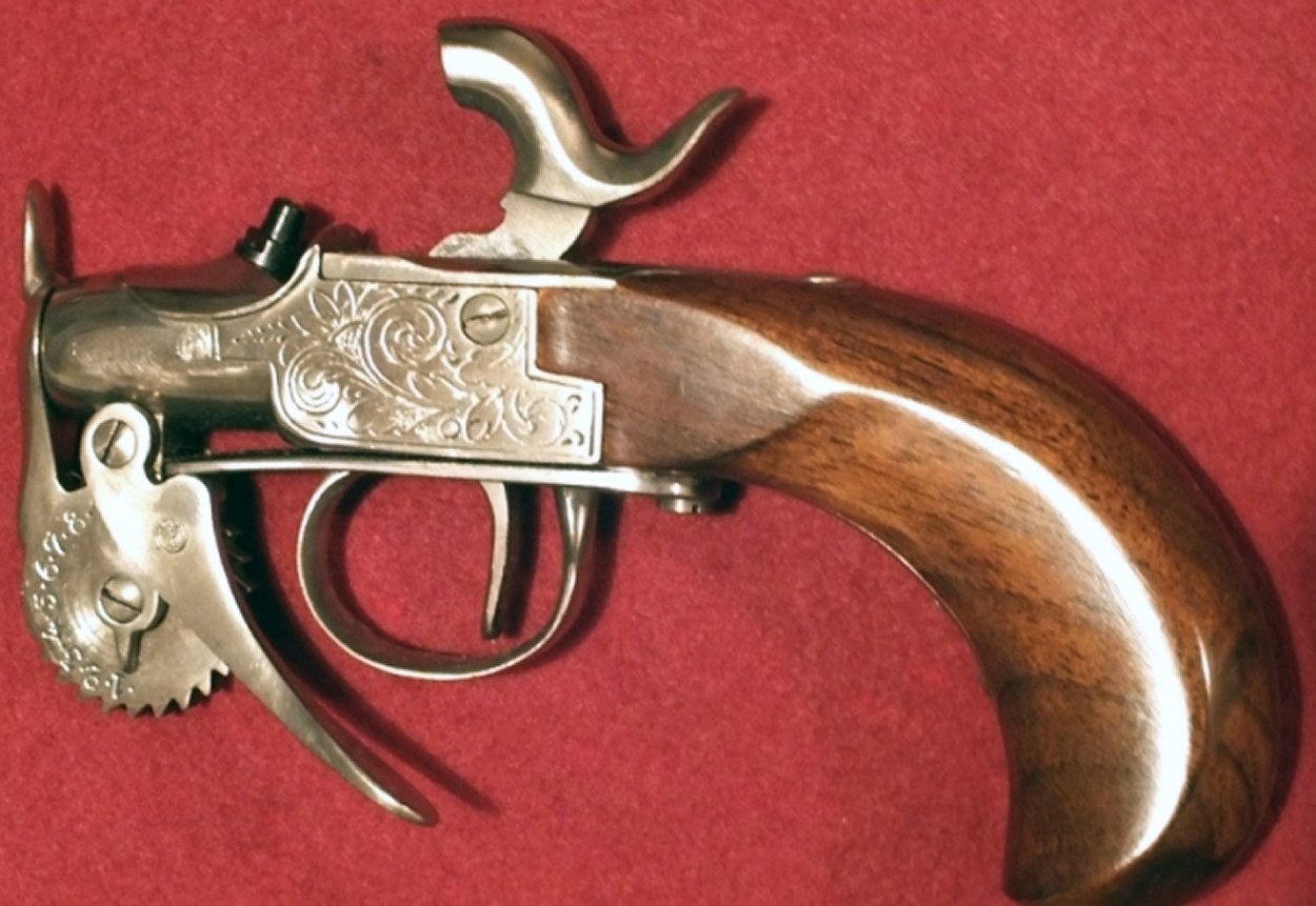

Attached please find images of a flintlock table lighter for ignition of a matchcord, first half 18th c., another for igniting a candle, English, mid-18th c., and a flintlock powder tester, ca. 1800.
Michl

Thank you for the prompt reaction, Michl .
I suspect however that my point was missed .

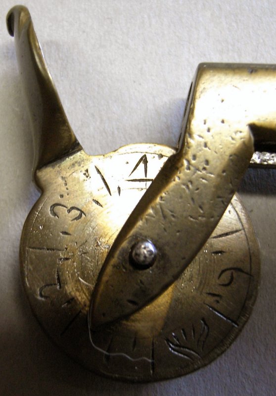

I know (knew) how powder testers work, as i am familiar with candle lighters; but none of those have a straight handle or and a manual ignition system, instead of the current mechanical ones ... flint, percussion, etc.
I also don't see how in the 19th century, this 'cannon/gonne' ignition style was still in use
Old 27th February 2014, 08:02 PM   #4
Matchlock
Matchlock's Avatar
Join Date: Sep 2008
Posts: 4,310
Hi Nando,
Though maybe not as explicitly as I had been hoping, I did try to meet your point in my reply. Please do forgive my obvious headiness, my dear friend!
Seen from the standpoint of an art historian, the (Neo-)Gothic style of the straight, plain handle perfectly corresponds to the 19th c. philosophy of 're-enlivening' the old Gothic style, and is clearly recognizable to me in this object.
Sadly I cannot tell how it was actually ignited, either, as I have never handled such an item (it's just way too 'young' to startle a true Gothic and Renaissance freak like me).
I am positive though that some of our members can. In any case, the ignition must have been very easy to achieve.

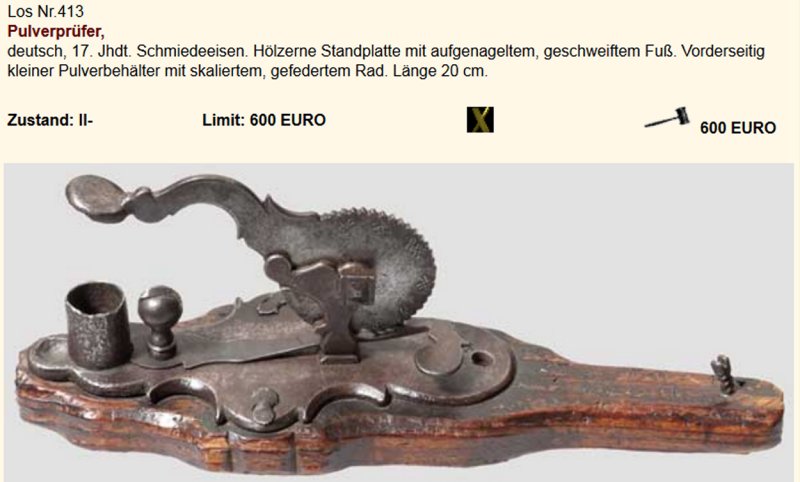

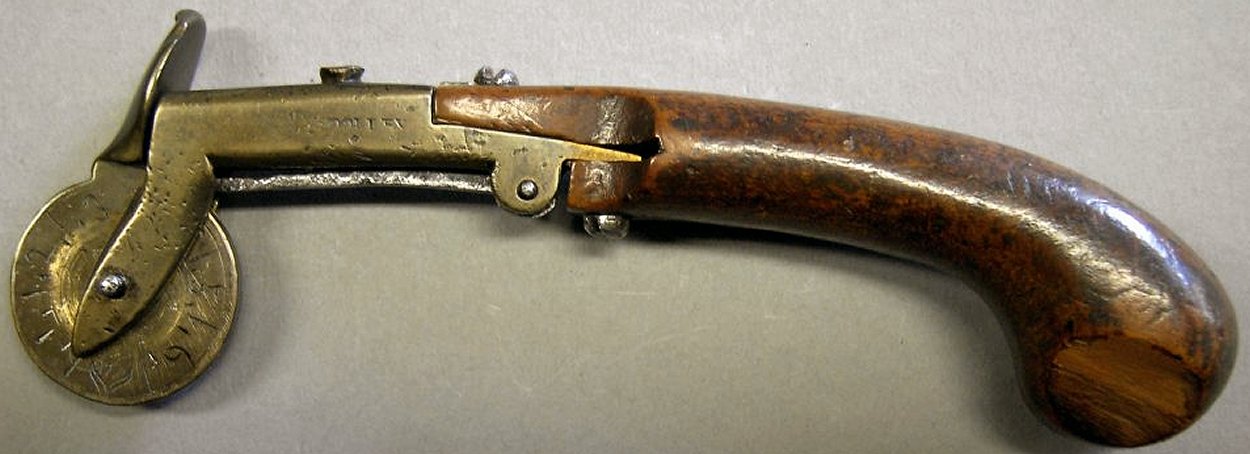

I tried to find similair examples on the web.. acording to the authors on these web pages this kind of powder tester was also in use in the 18th century, but the style differs from Fernando's powder tester and the truthfullness about these claims might be clouded by the sellers "ambition"
I did find a nice website though (pitt rivers museum).
http://web.prm.ox.ac.uk/weapons/inde...359/index.html

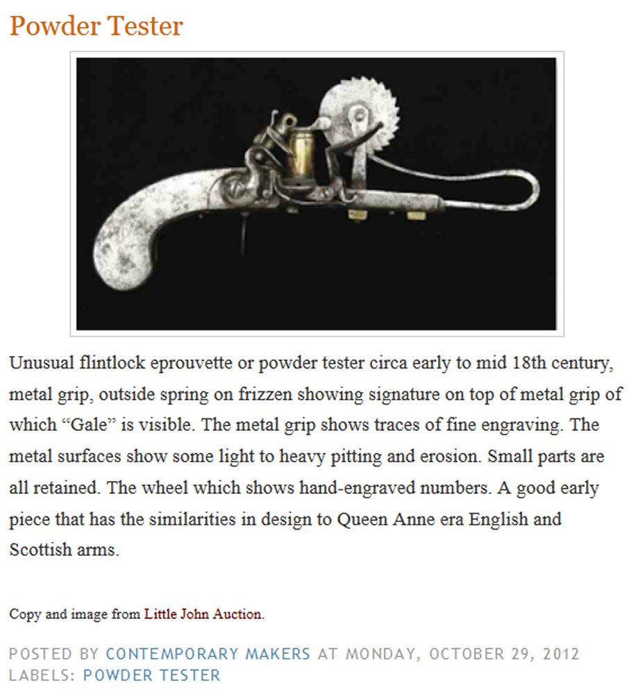

http://merzantiques.com/item/very-unusual-powder-tester ( http://www.icollector.com/17th-centu...ture_i11291595 )
http://www.icollector.com/Early-powd...rule_i11291691

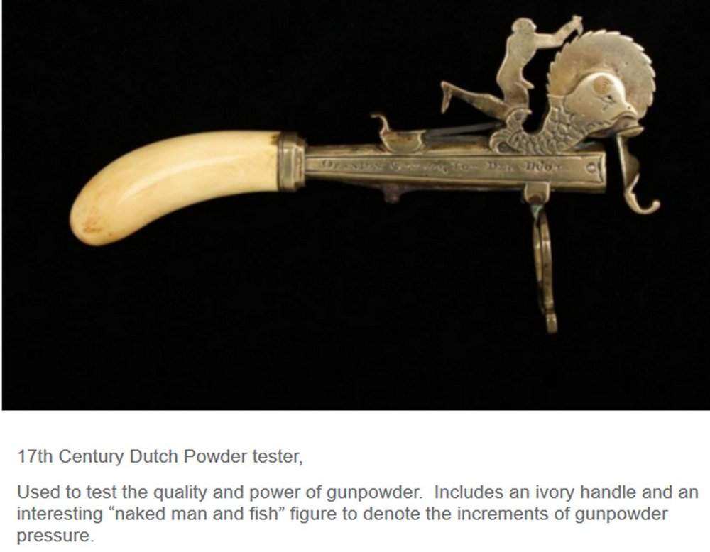

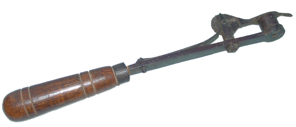

Old 27th February 2014, 09:07 PM   #7
Marcus den toom
Marcus den toom's Avatar
Location: Netherlands
Posts: 543
My pleasure
And as requested:

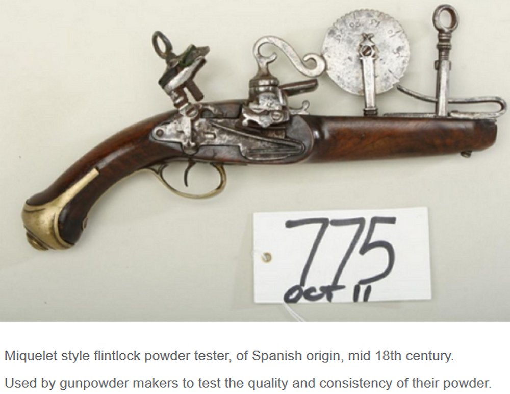

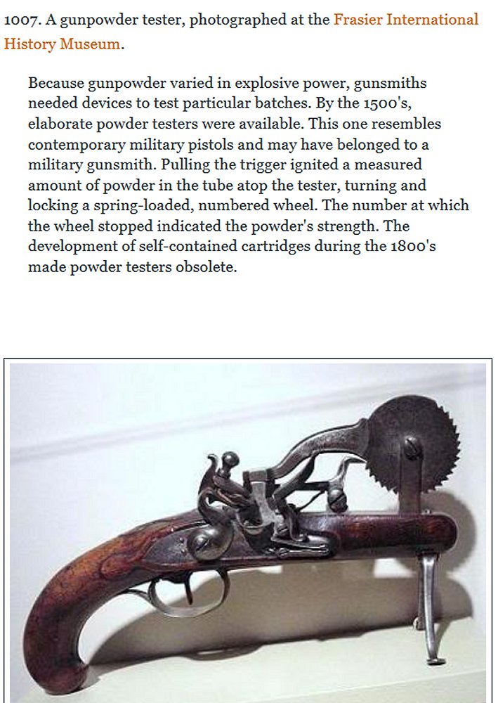

"This device for testing gunpowder was made in Avignon, France and dates to the 17th or early 18th century.
The amount of powder charge needed to pour down the muzzle of a gun depended on the strength of the powder, as well as the barrel length and bullet size. Testers tended to use the same mechanisms as the guns of the day, so this example with a nicely turned-wood handle and iron ratchet wheel, probably dates to the wheel-lock era. Samples of powder were ignited in the touch-hole and forced the wheel to rotate by means of a spring. Originally the wheel would have been marked with graduations from which the strength of the powder could be calculated."

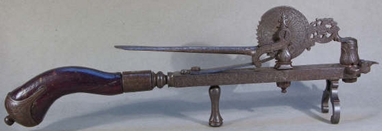

"In the shape of some sort of mythological peacock/serpent standing on four feet. Bird's head on one end and a turned wood grip on the other. Very nice item marked "H K C". Graduated wheel is marked from 0-25. Very decorative piece. Well made and in excellent condition with a nice aged brass patina coloration."
The auction discription:
"17th century style cast-brass body powder tester with turned wood grip of 20th century manufacture, signed by Coulter “HKC / 12-67”. Measures 13” from end to end. Made with a high degree of quality and precision andshows good aging. Keith Coulter was an excellent craftsman and he did work only for his own purposes, not for resale or forgery. From the Keith Coulter collection"
"Early powder tester circa 1700 – 1750. 10-1/4” overall, 4-1/2” turned wood grip with brass ferrule connected to a straight steel platform with graduated wheel showing hand-engraved numbers and tension spring.With touch hole cover. Very good condition, normal aging, small chip to the grip. Similar to example pictured in Eprouvettes by Kempers, page 92. From the Keith Coulter collection"

Old 27th February 2014, 10:27 PM   #9

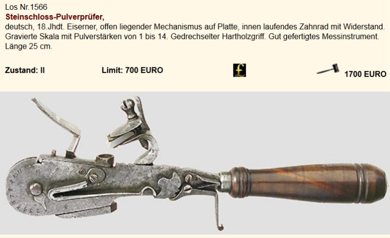

Very good and fast input, Marcus. Thank you for bringing in 'non pistol' style examples .
Certainly PittRivers and the 'ambitious' seller of the other example are claiming wrong dating.
... and the sexy 17th "style" four legged one might even be a 20th century replica ... or contemporary imagination .
I wonder if both PittRivers and the Commercial site are making some confusion with the touchole issue ... or is it me ? One thing is the little 'hole' in the base where you submit the ignition and the other thing is the 'deposit' where you fill the powder to be tested ... sorry the funny lexicon. It seems as they are calling touchole the late part.
Obviously i might be wrong; my knowledge is very superficial. Correct me if i am wrong .

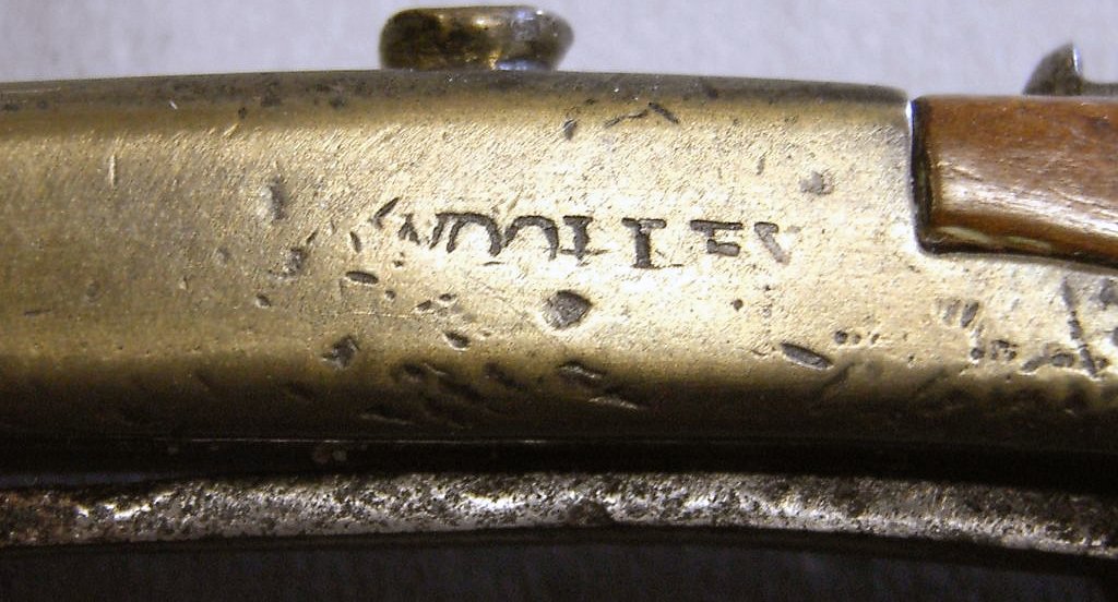

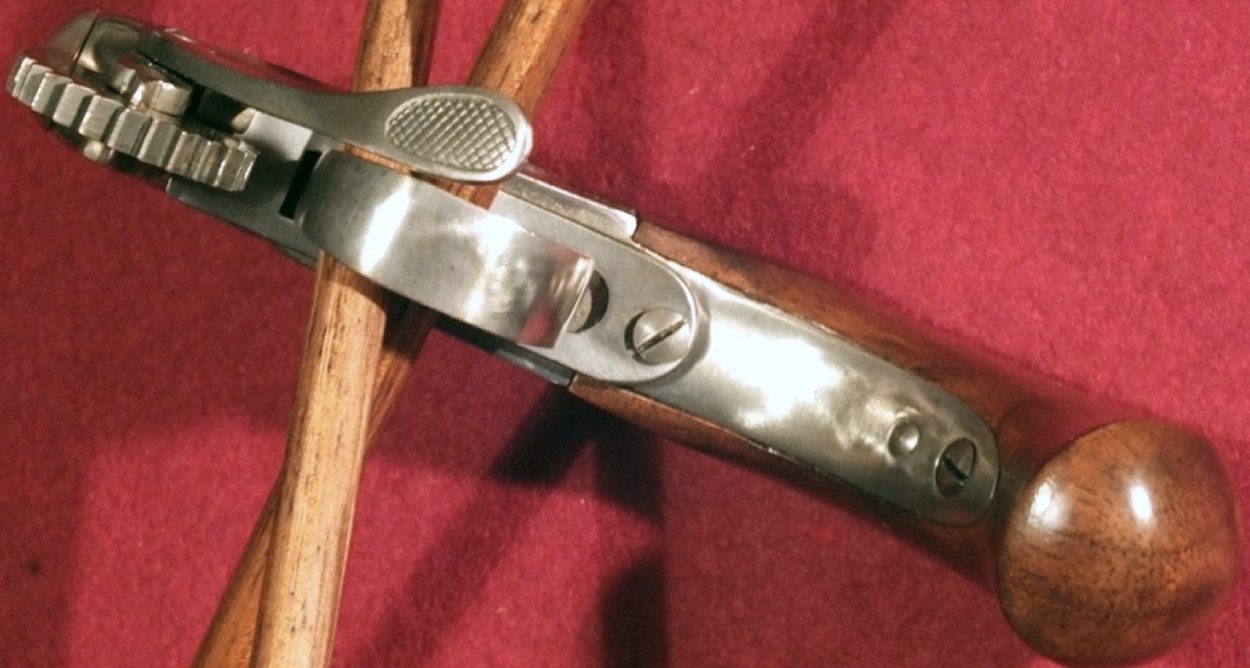

Hi Fernando,
I must appologize for the lack of other pictures which gives also a view of the other side of the powder testers (with touch hole).

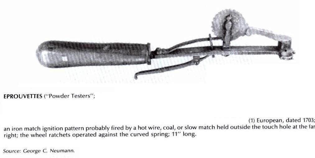

The bronze 4 legged one and the third one from post #7 where both made by the collector Keith Coulter, who according to the auction website who sold these items before, made these powder testers for his own collection and not for fraudulent purposes. Thus these are modern replicas, most likely using multiple styles? (confusing )
Here are the pictures from the touch hole side, notice the second powder tester of this post. It has a spring next to the powder 'deposit', i wonder what this might do.

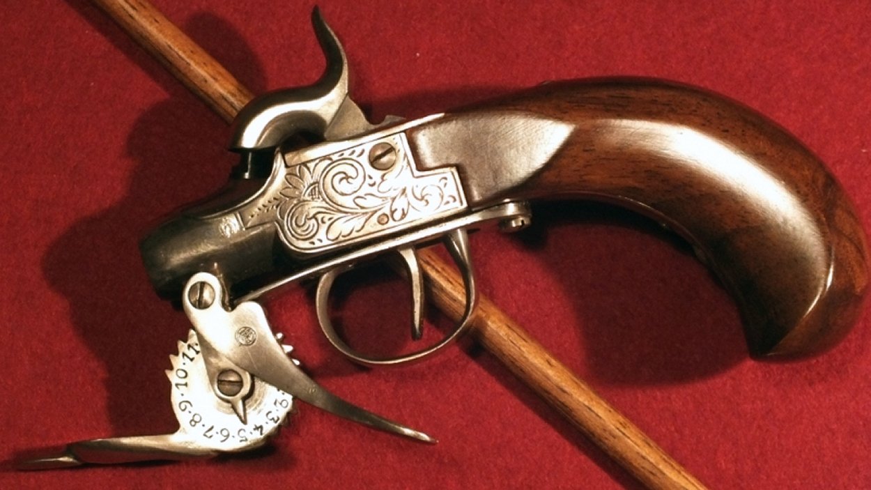

Old 28th February 2014, 10:13 AM   #11
Matchlock
Matchlock's Avatar
Join Date: Sep 2008
Posts: 4,310

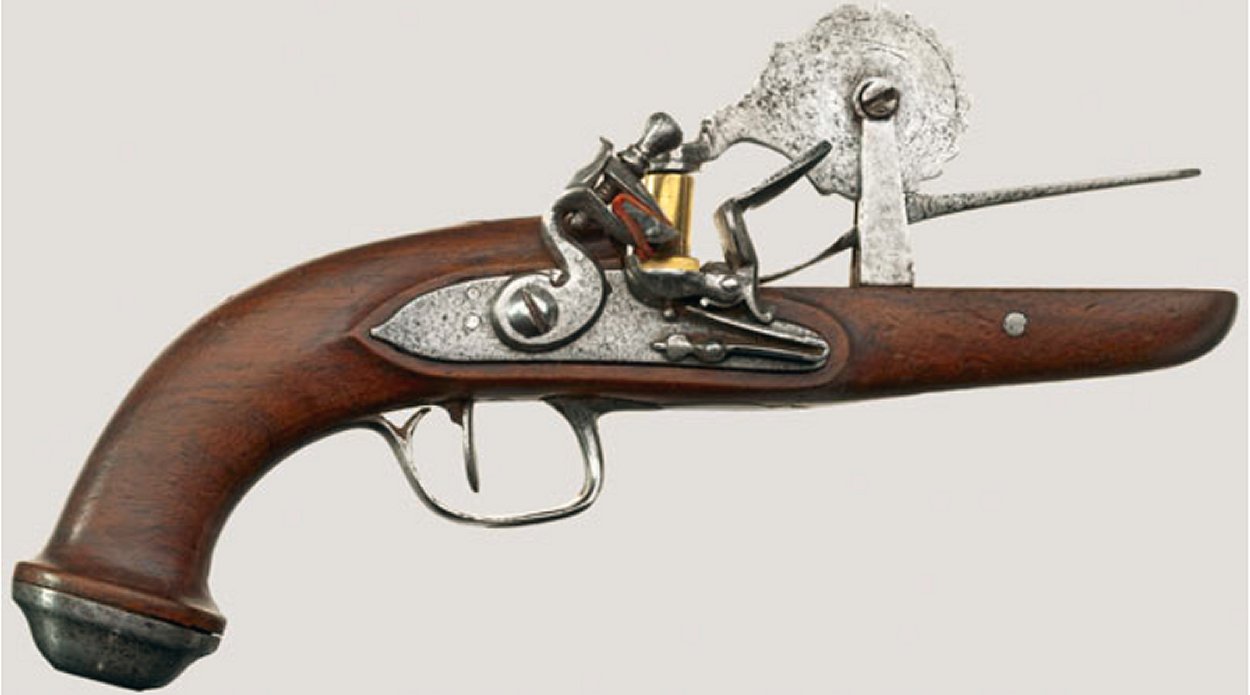

With these on our site we have, I guess, a full spectrum of powder testers, starting with an early instance of the second half of the 17th c. (top attachments), featuring an English model signed by Woolley, ca. 1780 (made of brass), and including a modern copy (the one on the percussion system).

Old 28th February 2014, 10:16 AM   #12
Matchlock
Matchlock's Avatar
Join Date: Sep 2008
Posts: 4,310

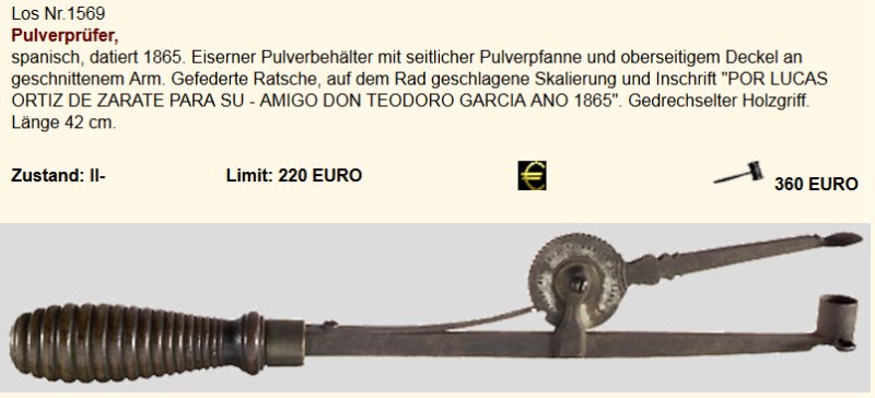

Two more, the one on top Spanish, dated 1865.

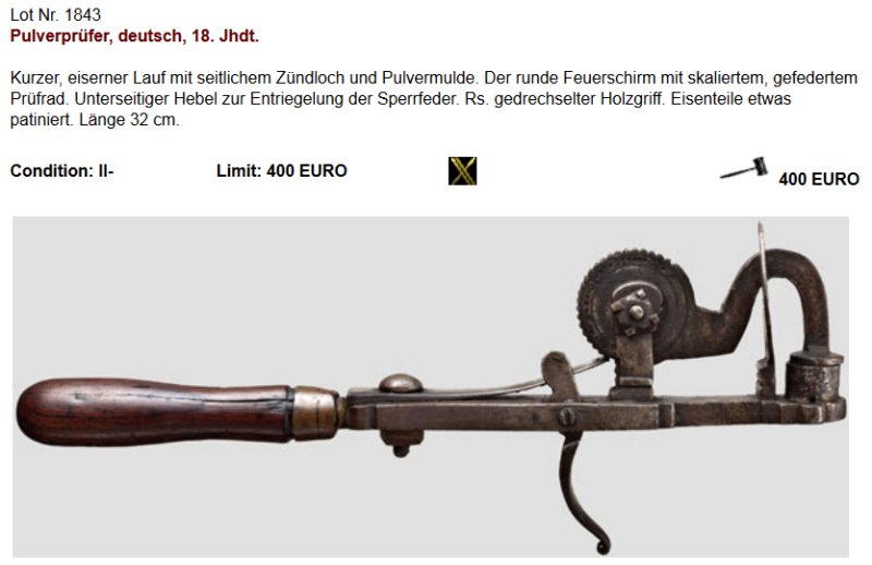

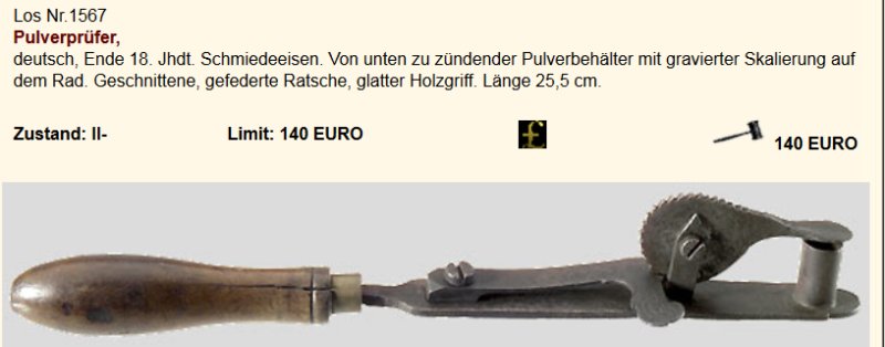

A Dutch model with ivory grip, 2nd half 17th c., a mid-18th c. specimen and two of late 18th c. date, the second employing a Spanish miquelet lock mechanism.
m

I remembered this powder tester from an auction (probus auction 21). It is dated 1701 and "Richter Koln". I hope i don't have to censor the sexual content, since the overall picture does show a good portret of that periods style.
The auction labeled it as barock, but i would also say some renaissance content ?
It is 23 cm long.
Say Michl, how long ago has this auction taken place ?
I am trying to figure out whether my example, just acquired, cost me a good or a bad price.

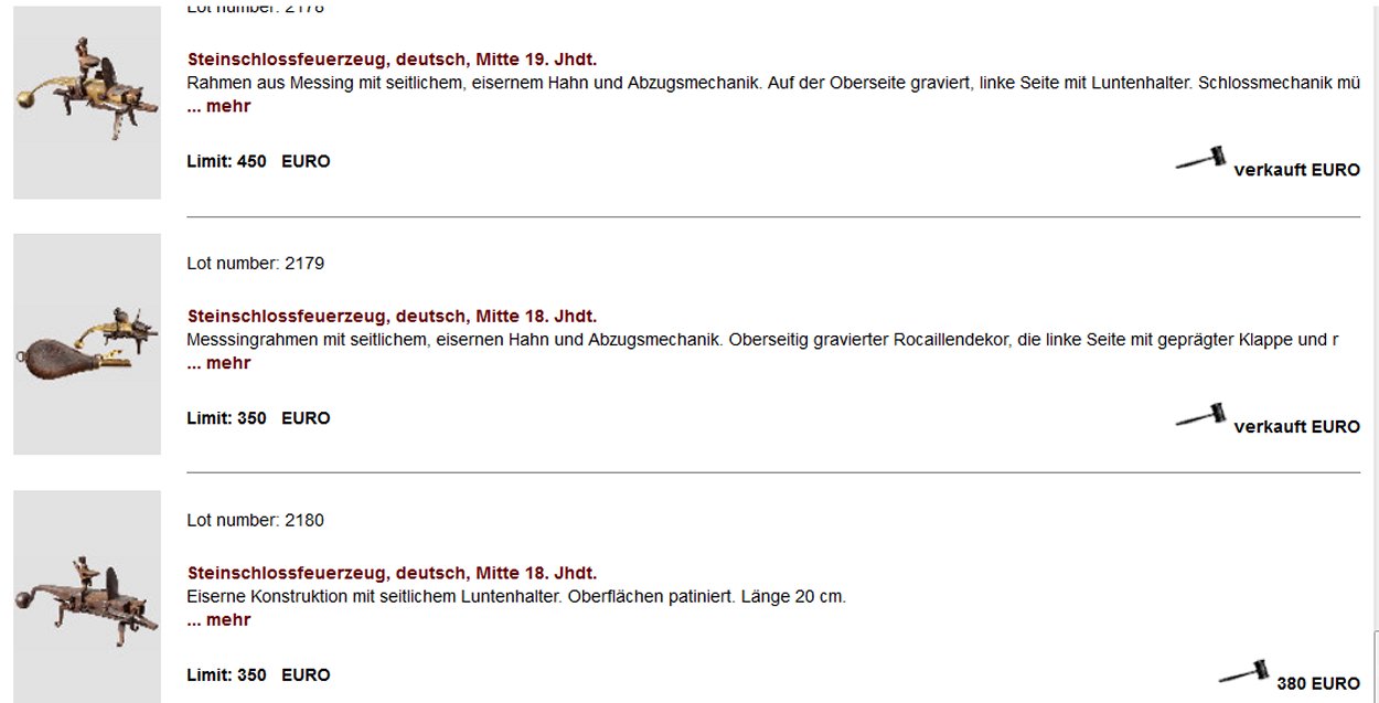

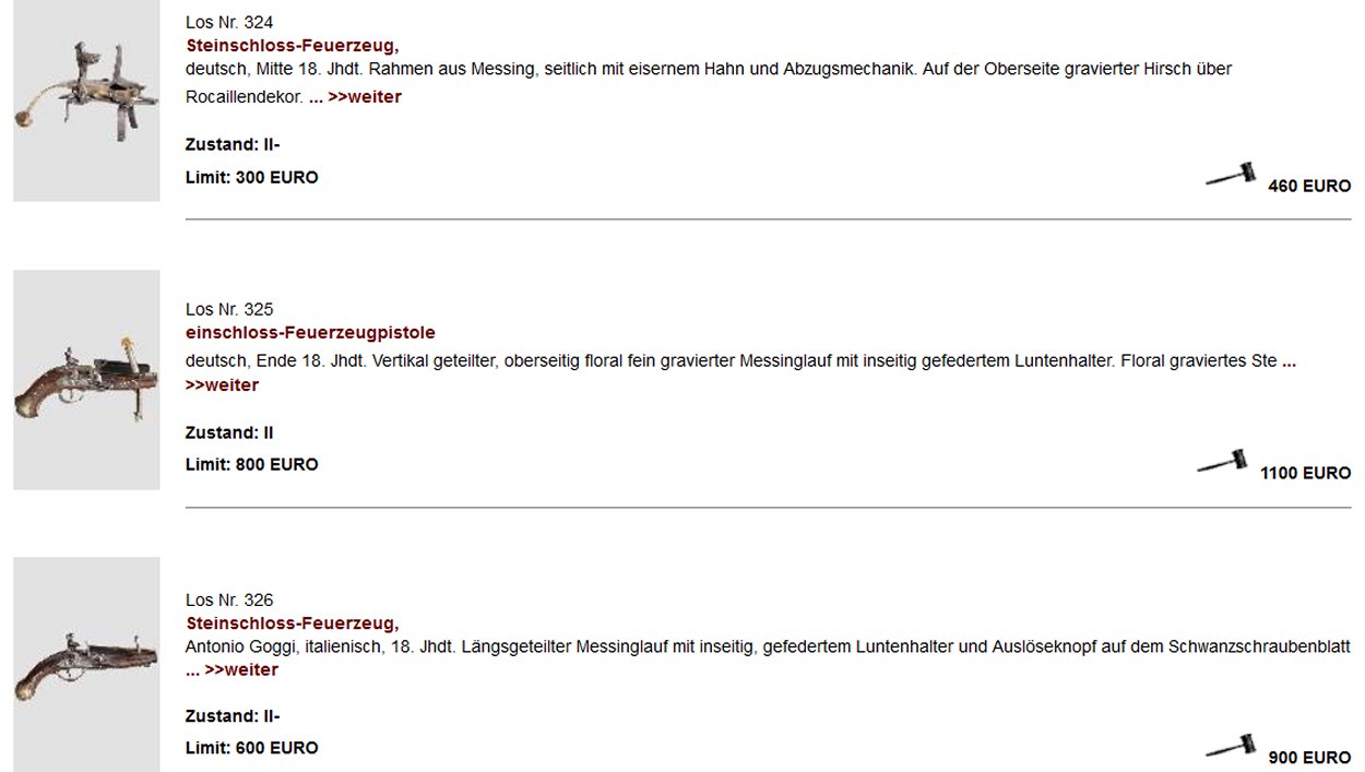

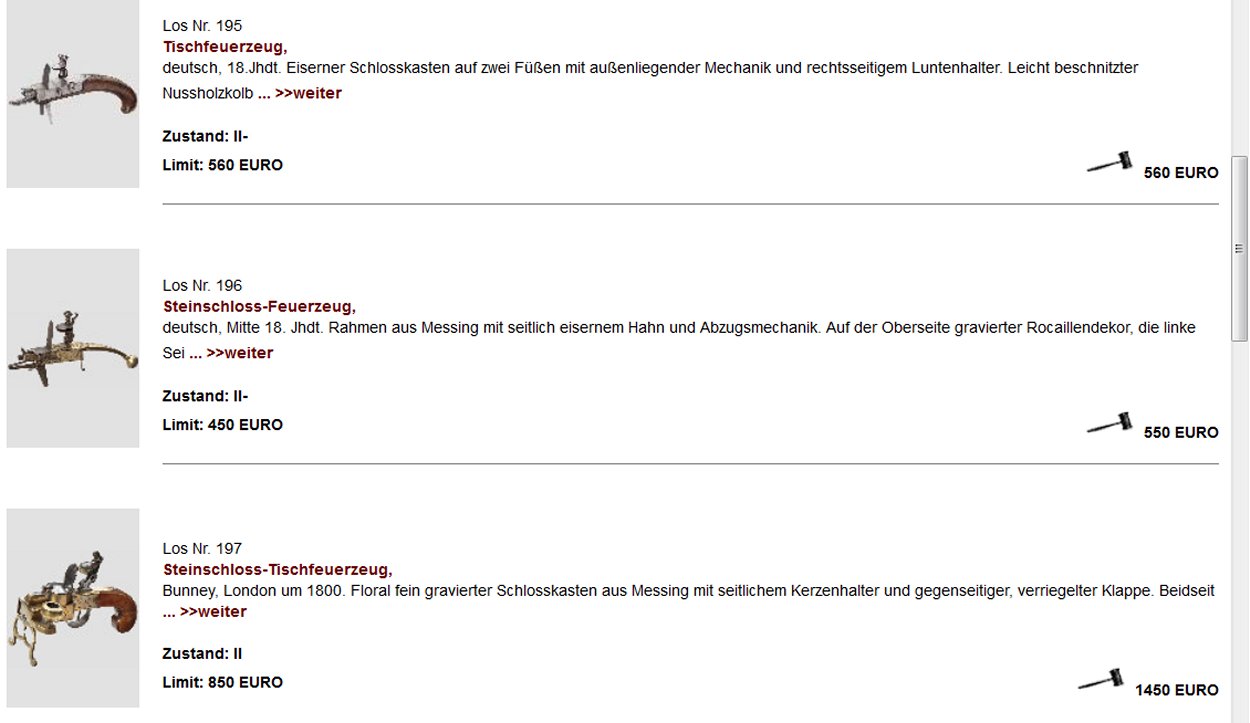

here are the hammer prices (plus 23 per cent commission for the buyer, minus 23 per cent for the consigner) of Hermann Historica's Munich back till 2012 (descending). As they prove, prices greatly vary.
Please forgive me for not finding exactly the items posted before as I picked them up from the web at random.
Michl

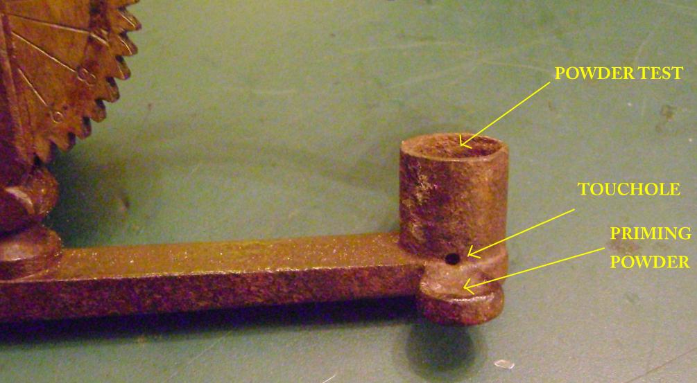

Old 1st March 2014, 11:09 AM   #21
Matchlock
Matchlock's Avatar
Join Date: Sep 2008
Posts: 4,310

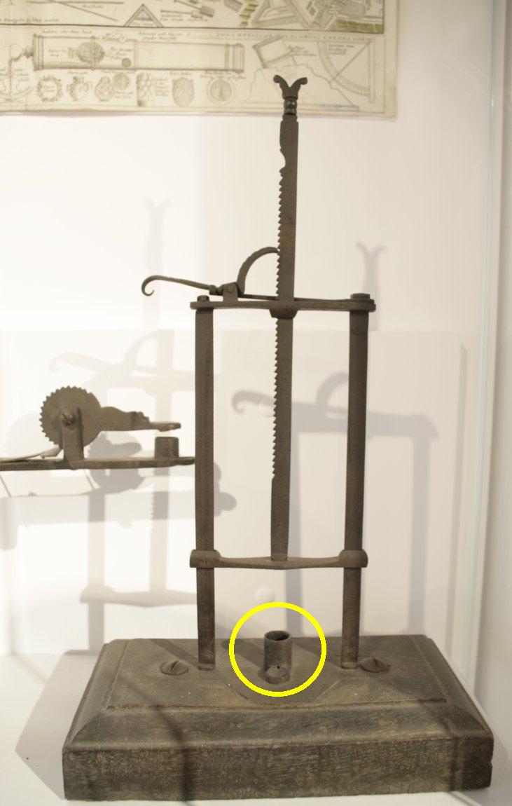

Hi Nando,
Not being in the least familiar with these objects, I have been wondering ever since you asked this question in post #9.
I guess you must be right: the small external trough marked by you must have been an igniting pan for priming powder, probably lit by a glowing pinewood chip always kept ready in any average home (German: Kienspan). This then lead to the explosion of the testing powder.
m

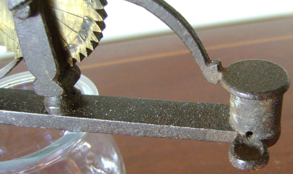

Old 1st March 2014, 04:17 PM   #22
Of course, Sir Nando,
Right at your command and service: ...
Thank you for the pictures and for the reverence, Sir Miguel .
... although none of them has the date the auction took place, which was my humble request; you know, trying to update the prices ... inflation and all .
Old 1st March 2014, 04:26 PM   #23
... I guess you must be right: the small external trough marked by you must have been an igniting pan for priming powder, probably lit by a glowing pinewood chip ...
Sure thing Michl,
... Reason why i found this primitive system example more appealing that the mostly seen ones operated by 'mechanical' striking.

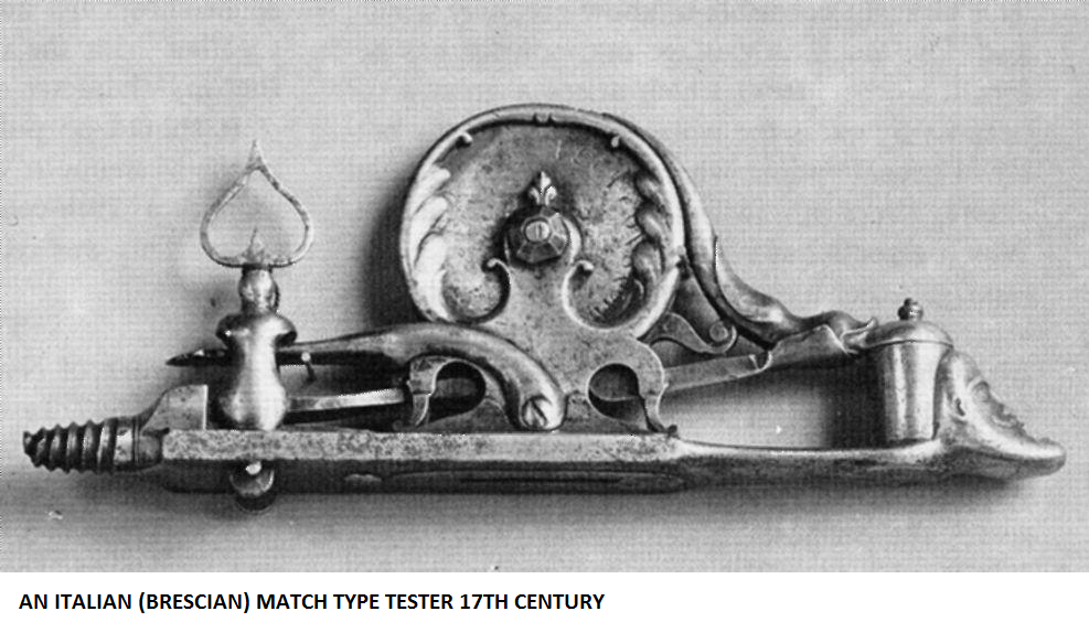

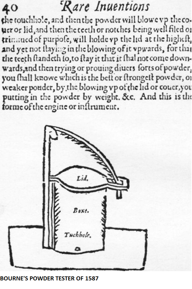

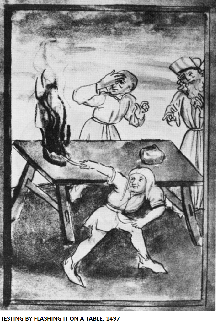

Old 1st March 2014, 04:55 PM   #24
With these on our site we have, I guess, a full spectrum of powder testers, starting with an early instance of the second half of the 17th c....
Let me then widen the spectrum ... back to the dawn of powder testing.
Images drawn for a rather interesting article written by Dr. H. G. Muller:
http://www.reenactor.ru/ARH/PDF/Muller_H._G.pdf
I am trying to find the author's email address, to query him on my example but, so far, had no result. Anyone has an idea how to get it ?

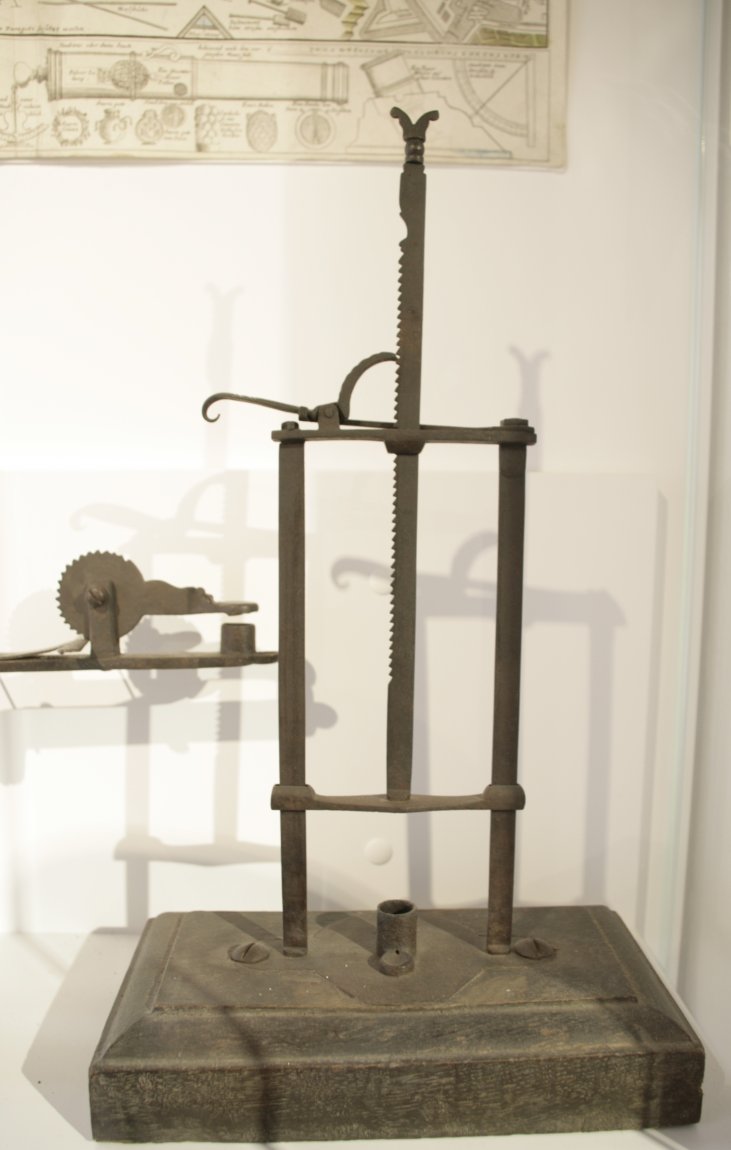

Scanning and selecting an example shown in page 166 of Collector's Illustrated Encyclopedia of the American Revoliution, by George Neumann & frank J. Kravic.
Recalling the 'early' origins of this type of tester plus an interesting description of the ignition system.

I have received comments from Spanish collector, author and documentalist of the former Montjuic Museum of Barcelona, Mr. Juan Luis Calvó, in which he concurs that my example is Spanish, apparently earlier than 1800.
He also sent me a picture of the (only) example in his collection, attributedly Spanish, in which we can see a strong resemblance with mine.
