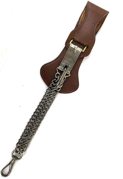

we tend to forget little details here, like how did the poor sod who had to carry one of these weapons for hours on end actually do that. i like to get an appropriate sword belt/frog/carrier/baldric for my swords where possible, or a close approximation.

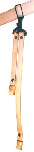

the 1902 U.S Army sabre scabbard has two carrier rings. early sling straps had a pair of straps of unequal lengths terminating in two hooks with screw locks on the sword end and a single wide snap hook on the other that snapped onto a square metal loop protruding from the leather belt loop/clothing shield. looks a lot like a jeb stewart (patented) hanger. this was later replaced (see below) by a single fancy chain for the rear scabbard ring, the front ring hung on the hook. while that looks OK for dismounted carry, not having a 1902 sabre, i'm not sure how that would balance if you were actually mounted. i do have a couple of swords/sabres with single ring scabbards that, while not historically correct, this will do nicely if i ever do want to wear one of the single ring swords, at least until the real thing comes along.

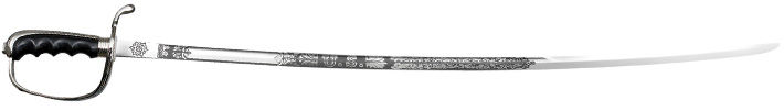

the info he posted was indeed interesting, as was the ref. site. as he notes, the m1902 sabre was a parade only item, not a combat weapon like the patton 'sabre' which was really just a short lance. i see the scabbard rings are quite close together on those with 2 and they really only need one if the sword is carried on a saddle rather that the man.
the m1902 had/has a very slender blade, and like the current USN equivalent*, would not stand up to actual combat, being made of brittle stainless. 'Cold Steel' makes one in 1050 HC steel, but it's the slender 3/4 in. 'issue' model which, even if sharp would be a poor weapon compared with the earlier 19c models. no more teddys charging up san juan hill...
*- the 1852 navy sword was 1 9/64 in. wide. the 1931 version, 3/4", current model is 5/8". i have a 3/4in. high carbon steel one myself...i imagine the army degraded theirs similarly.
the M1902, note the distinctive finger grooves: ( i have no desire to own one, as it's really only a big boy's toy. the hanger is cool tho )

the belt carrier shows a leather single strap sling, but looks like it was originally the early 2-strap with the 2nd cut off.

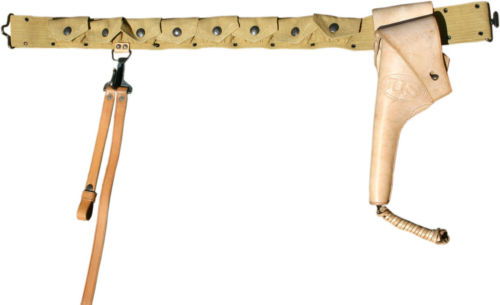

Old 14th September 2015, 08:46 AM   #10
1902 is now firmly in the 'over 100 yrs. old' antique class. as are many early and pre ww1 stuff. today's junk is tomorrow's antiques. 'ersatz'? ersatz is a state of mind. just because it's obsolete does not mean it's not effective. a well known ww2 brit (scots) officer went into battle, landing on the beach with his claymore and with bagpipes playing, later captured 42 germans, one after the other with only his sword, and also has the honour of the last confirmed battle kill with an english longbow, skewering a german sgt. during a battle. he was,of course, a tad eccentric. but effective.
sadly, the m1902 army sabre IS an ersatz sword, not having been designed for combat, but just for parades, it is a poor substitute for the real thing. luckily not all swords used in ww1 (or ww2 - remember the milsco version dutchy klewang issued to US marines) were ersatz.
anyways, to complete the set, i just stumbled across and purchased the earlier 2 sling leather version with the belt slide. it can also be used on the ww1 era issued canvas cartridge belt as shown below.
