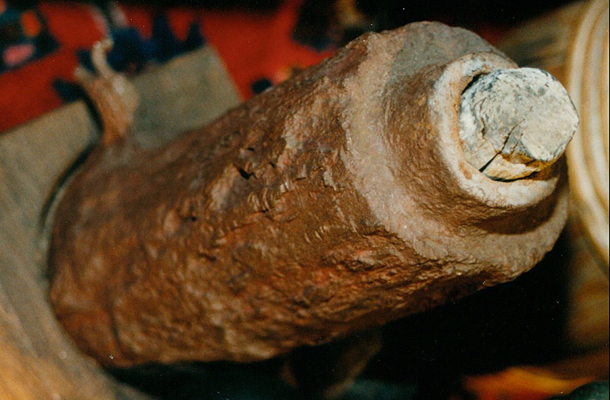

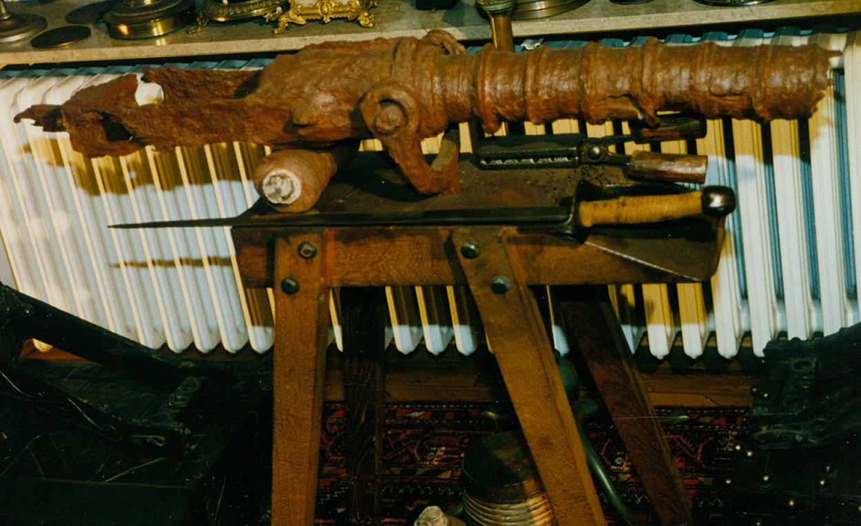

Hi Marcus,
Once more I must say that I like that ca. 1540 mug-shaped interchangeable breech of yours a whole lot!
For more than 20 years I had a similar one, only slender and about 100 years earlier, ca. 1440, which is extremely early for breechloaders; it now is in 'Nando's collection!
http://www.vikingsword.com/vb/showth...oading+chamber
Michael

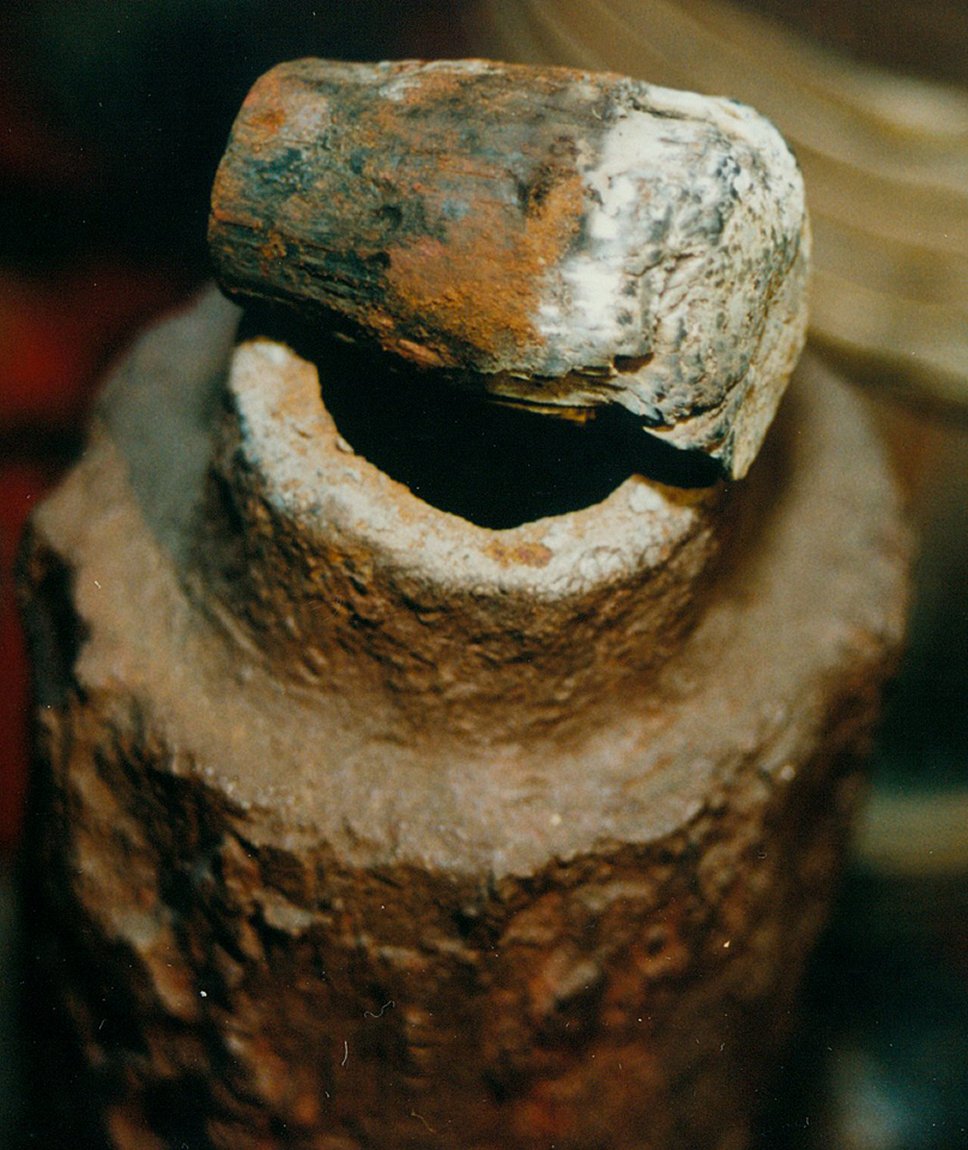

Hi Marcus,
Not that any ball was originally part of a breechloading chamber ...
As I have shown in my thread and demonstrated by photos of a ca. 1480-1500 Late-Gothic chamber dug up still loaded only with powder and a wooden plug, the ball was separately shoved in at the rear of the barrel, at the beginning of the breech recess, before the powder chamber/breech was inserted.
Michael

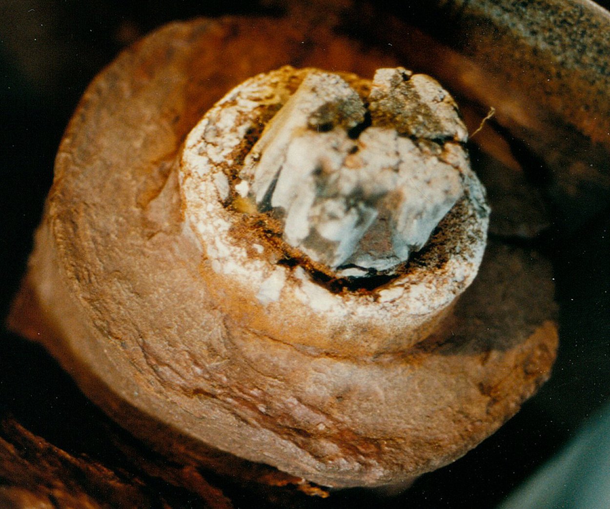

Posts: 4,310
I guess the breech plug was mainly there in order to prevent the fine meal powder from falling out, and to preserve it from moisture.
The thread I told about this fact is here:
http://www.vikingsword.com/vb/showthread.php?t=7364

Back to the sealing issue ...
After reviewing this issue with some source, i would give a touch up to my previous approach .
Wooden plugs were used to close the chamber mouth and wax was used to seal such plugs ... and also to seal the touch hole.
