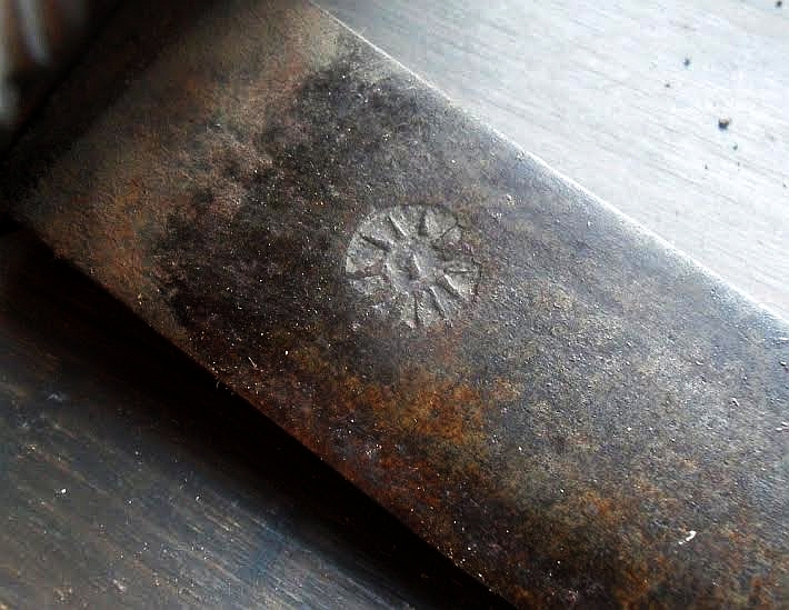

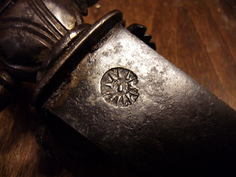

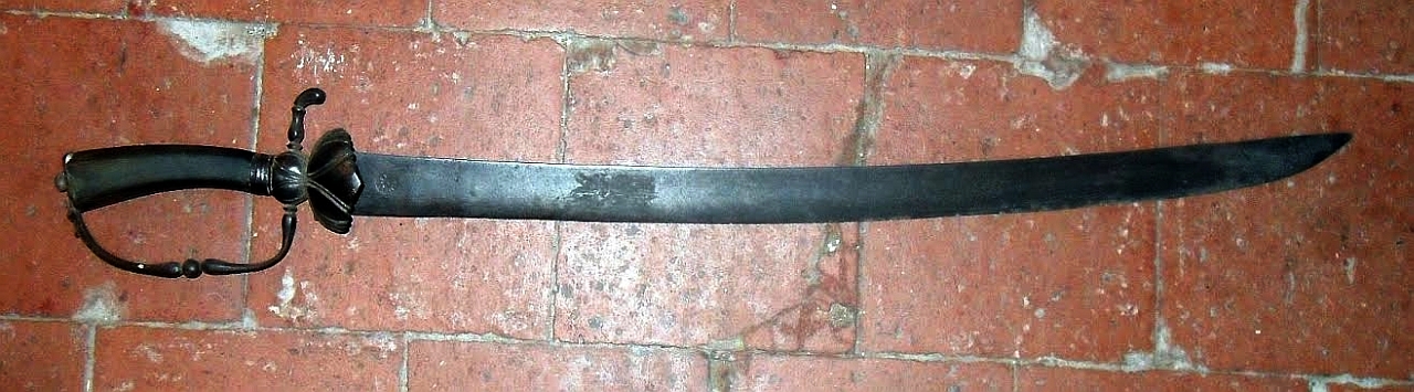

I did want to ask you guys about this blade because it's the only one that still partly holds some mystery to me. I've seen it around my grand parents' house since childhood and always thought it was only some 20th century decoration item, but noticed it was actually a quite proper weapon when I started actually researching those things some years ago.
It was identified before as a "19th century German hunting sword", but no one so far could identify the marking on it.
I wanted to ask you guys if you could validate or not this identification, and even better, if you could find the blacksmith to whom belonged this marking.

can you post photos of the whole sword (with but out of scabbard if it has one)?

any other markings on the blade? looks like something about 1/4 the way down from the grip.
a quick search did not reveal anything on that sun marking near the hilt. i'm sure our other experts have much better reference materials tho.
many swords had blades made in solingen, and were hilted in other countries, such as france. curved hunting sabres/hangers were not the norm. looks a bit too simple for french tho y'all liked them ornate back then.
i'm sure a ship's officer would have liked to carry a handy weapon like that tho. my initial impression was 18c but it's not really an area i'm very knowledgeable in.

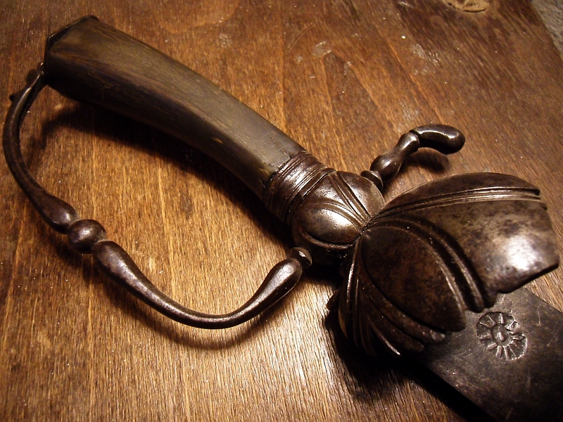

Neekee welcome to the forum!! and thank you for sharing this very nice hanger which while of the general form of European hunting swords would be hard to classify as 'German'. I would presume this more likely 18th century as Kronckew has noted, and as he also has suggested, there does seem to be some kind of configuration further down the blade.
The deep circular stamp near the forte seems possibly to be a rather stylized version of what is often termed loosely the 'Dutch star' ("Blanke Wapens", Puype, p.50) which commonly occurred on Dutch blades. According to notes from Fernando taken from a Dutch curator, these radiating figures similar to a sunburst or sunflower were a kind of paternoster. As often the case, these kinds of marks are not attributed to a particular maker, but favored by certain groups or regions in varying periods and applied in rather a talismanic sense. Other dialogue has suggested these often deep set devices seem to have ceased use about middle of 18th c.
While Solingen indeed provided many blades to European markets, a number of smiths emigrated to Netherlands where they continued production.
These hangers were favored by gentry and nobility as riding swords and were favored as well by officers, often naval as Kronkew notes. These swords were also often considered dress or even court swords.The stylized nature of the stamp suggests this blade may be later in 18th century, and the form was in use into the 19th, but this example seems probably Dutch mid to later 18th century.

Thanks a lot for the insightful comments guys. I closely examined the blade again but couldn't find any other markings. The "sun" marking is on both side of the blades though, and I will provide new detailed shots with this post.
Thanks again !

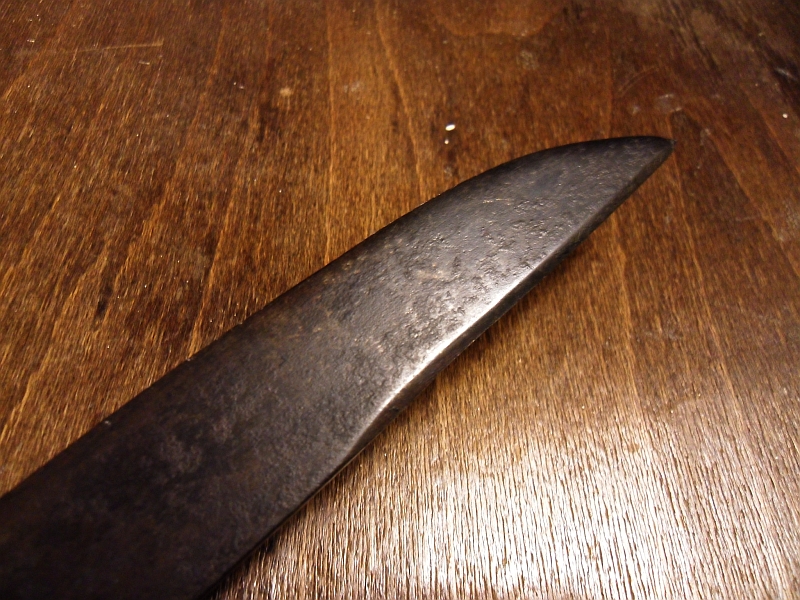

interesting tip. the dutch seem to like the clipped point on their sabres & klewangs.
Old 11th December 2013, 03:30 PM   #8
Posts: 10,860
Q.E.D.

Gorgeous piece! A fine hanger, as used by both hunting gentry, infantry and naval officers of the period. I'd add that it probably is earlier- ca. 1700-30, based on flat cap pommel, shell guard (in vogue from 1700 on, earlier types jutted straight out from piece) and knuckle bow with ball decoration mid-curve (fell out of favor after 1730's). Thus, a hanger we can date more concisely than most. A hanger I'd be proud to own! No, I mean it! If you ever decide to sell...
