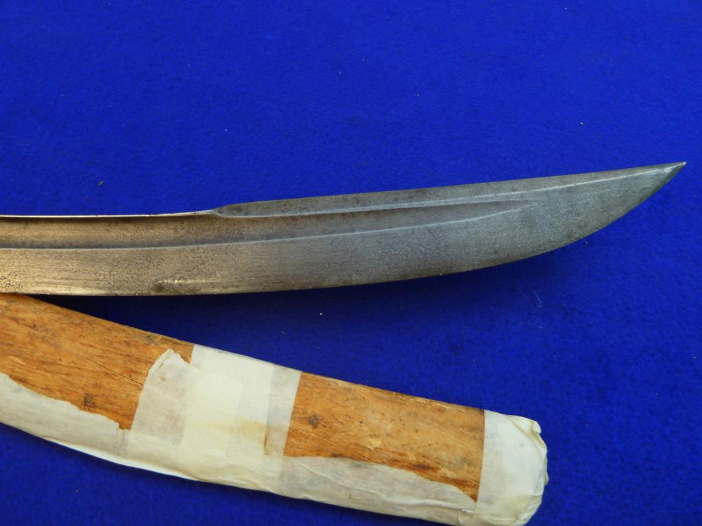

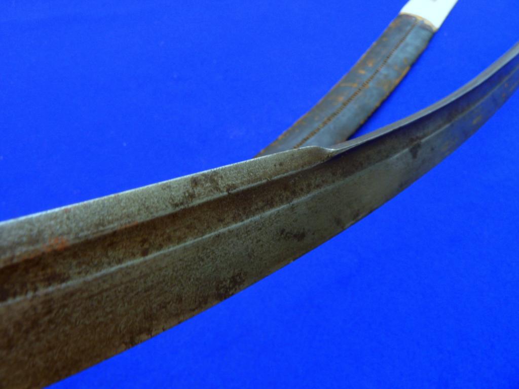

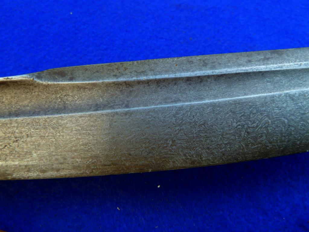

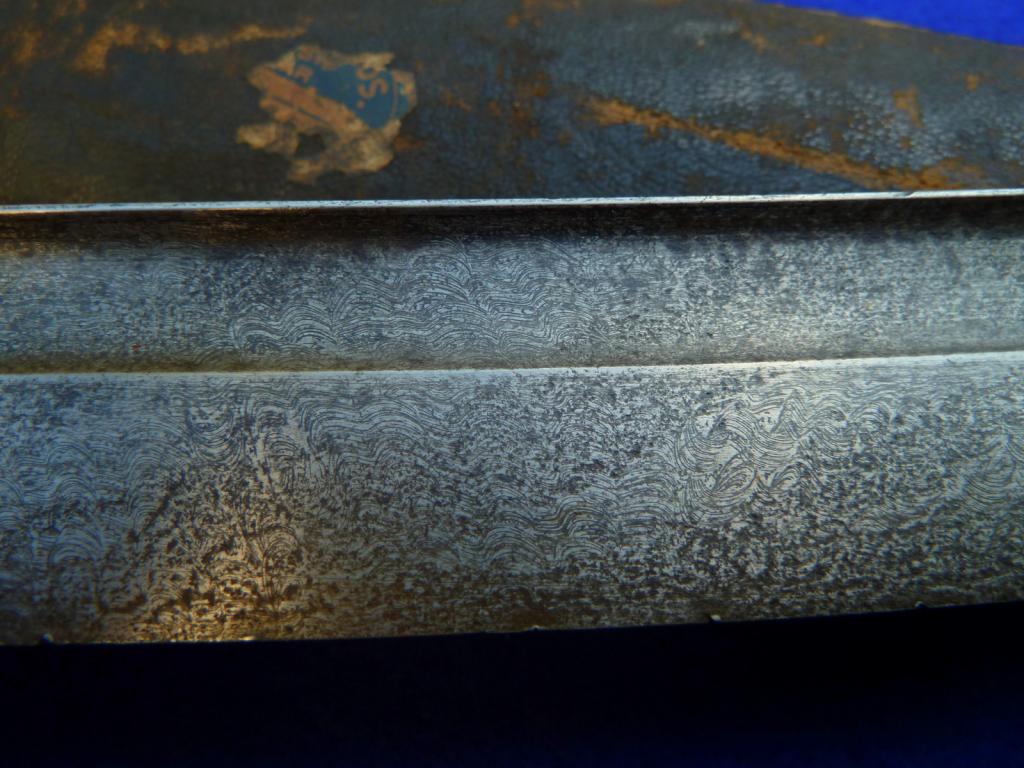

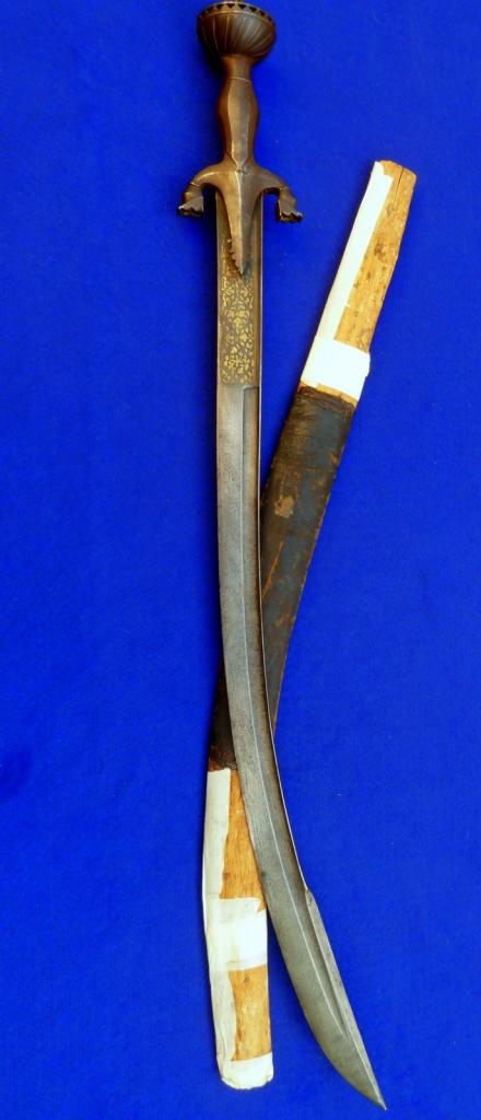

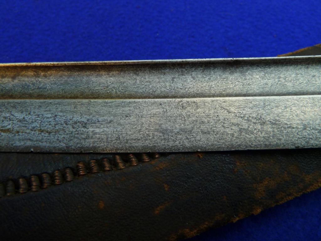

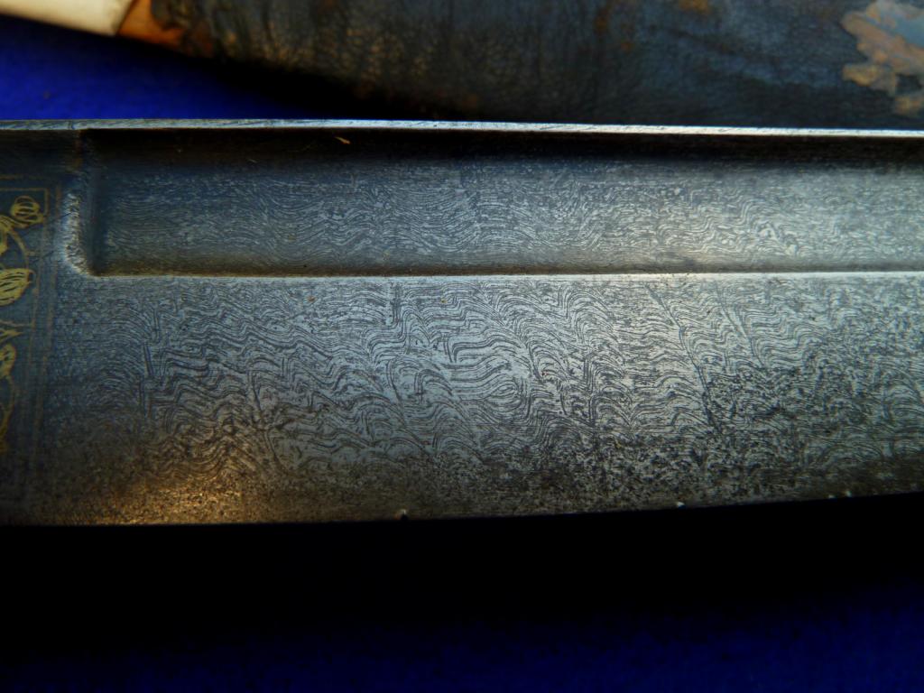

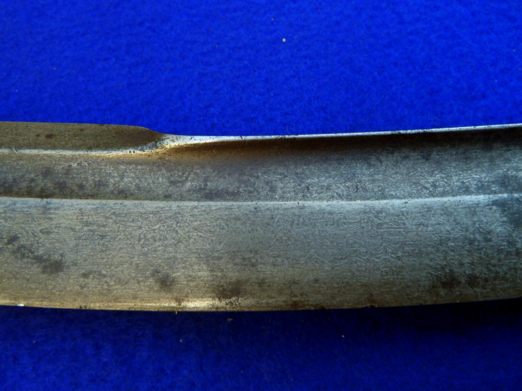

Colleagues,
This beautiful indo-persian saber was recently sol.
There sems to be a marked difference of opinion on the technique: is it a true mechanical damascus or just a superficial damascening ( etching?)
I am putting a bunch of close-up pics for you to express your opinion. The input from professional bladesmiths is especially welcoe.
Thanks.
Old 15th November 2013, 04:55 PM   #2
ALEX
ALEX's Avatar
Posts: 936
Clearly acid etch - imitation pattern applied on the surface.
Old 15th November 2013, 05:07 PM   #3
mross
Join Date: Jan 2005
Posts: 478
Looks etched to me as well.
Old 16th November 2013, 04:33 AM   #4
Posts: 7,416
Yep. I agree. However "damascening" means basically something like koftgari, but a little thicker, and usually in script.

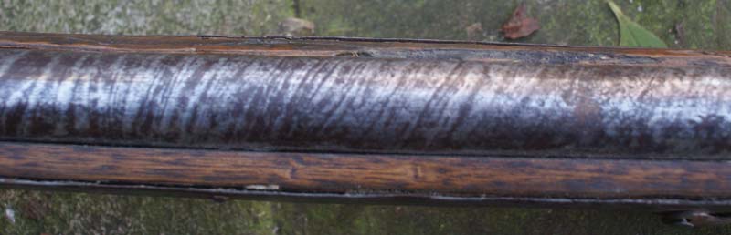

However, before leaving the subject does anybody have an opinion on the probable constitution of this barrel? Its currently loosely attached, in the way they usually are, to a Tibetan matchlock but may well be Persian. We know it’s twist welded but how would you describe the banding? Is it patterning welded, wootz or what?
Old 1st December 2013, 03:12 PM   #17
Of course it is pattern welded. Wootz was never used to manufacture barrels.

As usual I am late to the discussion...the sword blade is etched and done in a way to note try too hard to appear as anything different. I have seen some etch jobs which I had to really look at for a while to pick up up.
