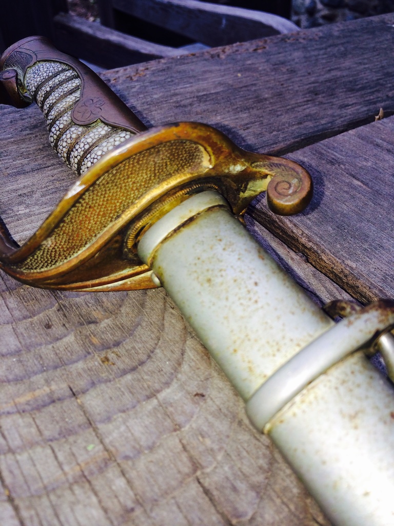

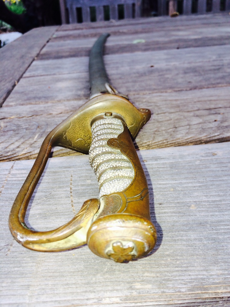

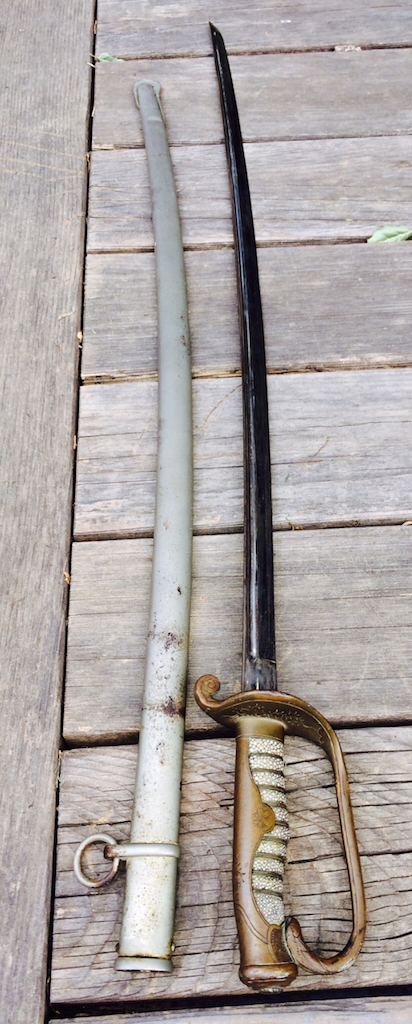

Hello All,
A friend has asked me to help him identify a sword. His father brought this back from Korea after serving there in the 50's. Not my area of study, but I'm guessing this is related to either the Japanese occupation or Chinese participation in the later conflict.
Thoughts?

Yes, Japanese military sword.

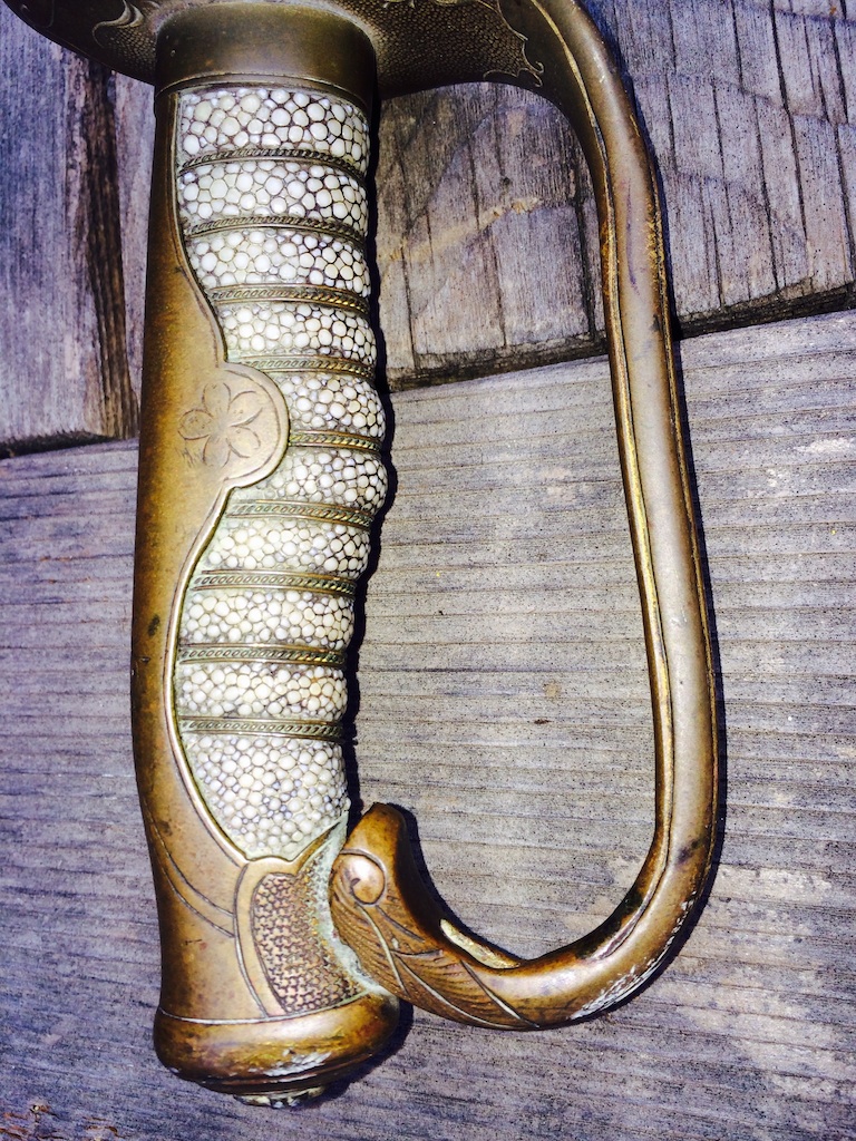

Chinese Nationalists, or possibly Manchukkuo officer's sword. Copied from Japanese patterns. Shows navy influence. Note the five petal plum blossom, as apposed to the five, of ten petal sakura (cherry blossom) used on Japanese swords.

Note the similarity of the hilt design to the sword shown here, identified as Japanese army officer: WWIII Japanese Military Collectibles
and here: Japanese Military Swords Scroll down to the section on "Kyu-gunto" swords and the discussion of army vs. navy backstraps. Also, the scabbard with a single ring is identical to the one in my pictures.
Is it a plum blossom or a cherry blossom?
How would a Nationalist Chinese sword end up in Korea in the 1950's, to be brought back by an American GI? What specific indicators do you see to suggest this is Nationalist Chinese vs. Japanese?
Thanks for taking a look!

Default Japanese Kyugunto with D guard
WW2

[QUOTE=DaveA]Note the similarity of the hilt design to the sword shown here, identified as Japanese army officer: WWIII Japanese Military Collectibles
Best Regards,
David[/QUOTE
The sword in the first link, is CHINESE!!! The Type 19 Kyu Gunto in the second link is similar, but not identical. Chinese swords, were copied from Japanese swords. Japan defeated China, in the 1890s. Chosen (Korea) was acquired with the defeat of Russia, in 1905. Manchuria (Manchukkuo), was annexed in 1910. Lots of Japanese influence throughout the region, for a long time. After examining many Japanese, and Chinese swords, there is a huge difference between cherry, and plum blossoms.
As to how a GI in 1950 got his hands on a Nationalist sword... The Maoist government was only two years old. Any weapon usable, was put to use. Even if only a badge of rank.
Specific indicators: Decorations on the hilt, are very crude, and lack definition. Style of the blade, and scabbard, are not typically Japanese. Plating on the scabbard and blade, are very thin, and flakey. If you study Chinese swords,, and daggers, you will find no two alike.

It's more than WW2. Japan colonized Korea from 1910 to 1945, and Manchuria from 1932-1945. The Japanese police were quite active in these times, and their retreat in 1945 was rather precipitous. In addition, Korea nationalists fought with the communist Chinese against the Japanese throughout WW2 (and indeed previously)
Given this mixed history, I'm unsurprised that a Japanese, or Japanese-style, blade, would turn up in Korea in the 1950s.

I agree with Trenchwarfare on this one. I've owned Japanese kai gunto Army dress swords and police swords complete with family mon on hilt. The Chinese were copying this style for quite awhile. If you ever get a chance to look at a Chinese Pilot's/Air Cadet's dagger, you see many of the Japanese influences, but more crude and typically flaking to the chrome, simpler depictions/line work to the scabbards, etc. It doesn't make the piece any less desirable to me, as I'm into the history of it. WWII era.
