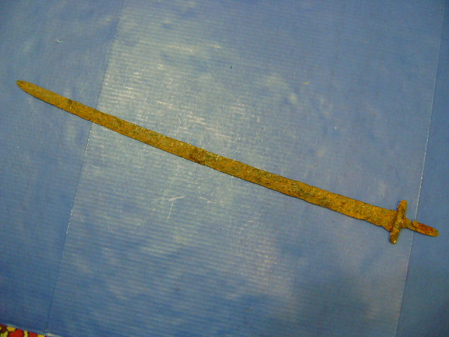

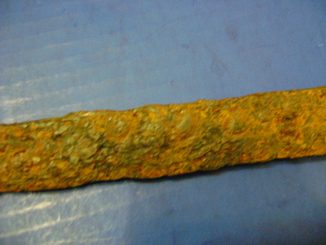

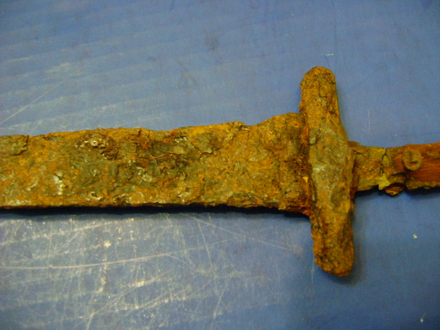

I got myself a 7-9 century Khazar saber/palash.
Very rusty, of course, but with a lot of "meat" under the rust/mineral accretions.
I would like to conserve it. Got in touch with conservation departments of a couple of local archeological museums, private conservators etc, but nobody is willing to help. Maximum that I heard from them was " Put it in a plastic bag with silica".
I decided to educate myself and went to the Internet. What is obvious (to me) is that tannic acid should be the final step.
But what should I start with?
Dry removal of accretions? Soaking it in distilled water?
Would be extremely grateful for an educated advice.

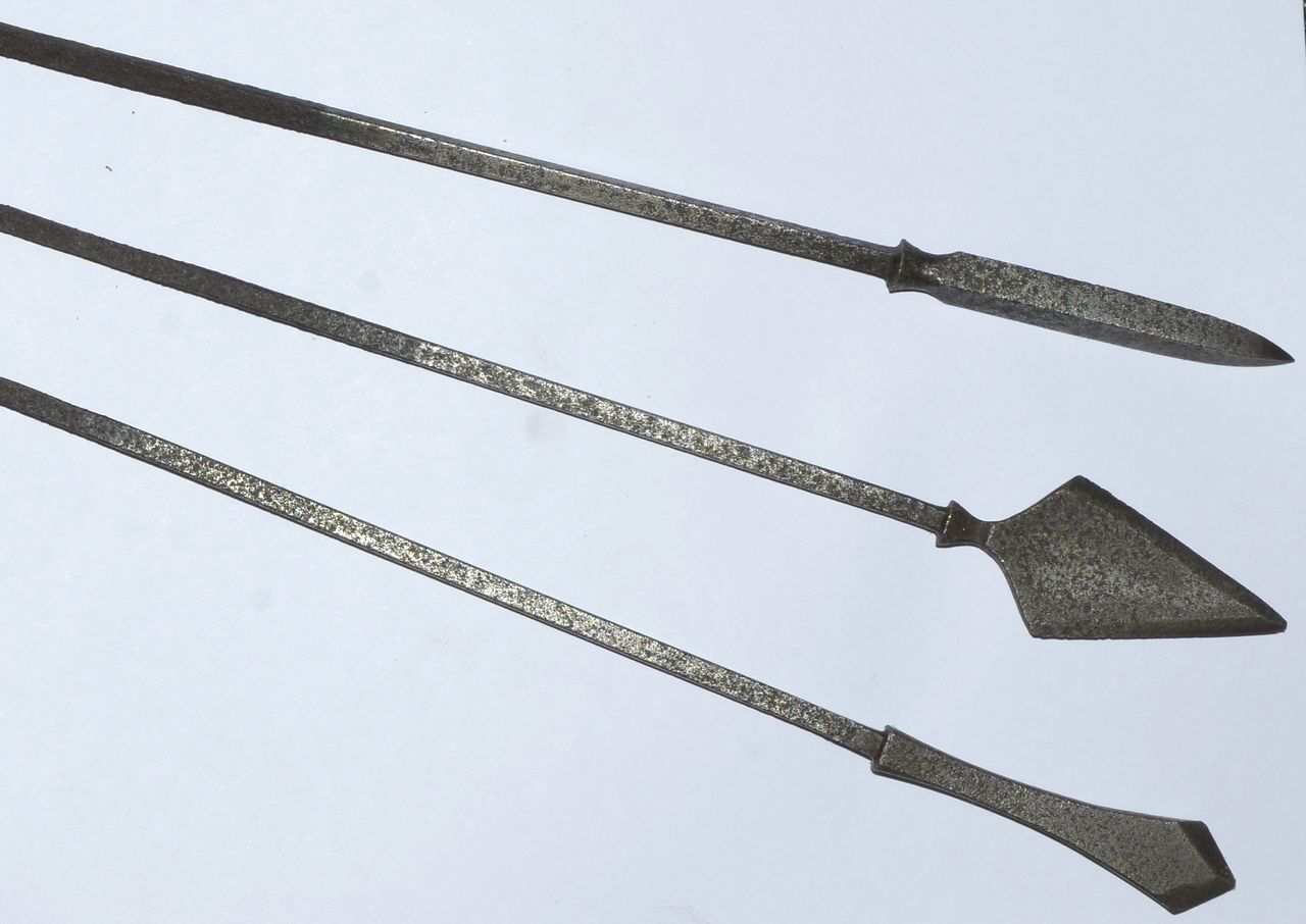

Have you think about elektrolysis? All you need is a car battery charger a bucket and a little bit of baking soda. I already made it and I'm totally satisfied with the result. The heavily corroded japanese arrows in the picture had an electrolysis treatment. The lower part of the shaft is untreated. All you need to do is cleaning the object from time to time during the treatment. Very easy and safe. No acid, no salt and no toxic gases, just a little bit of hydrogen.
Museums often use elektrolysis for restoration.

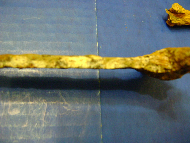

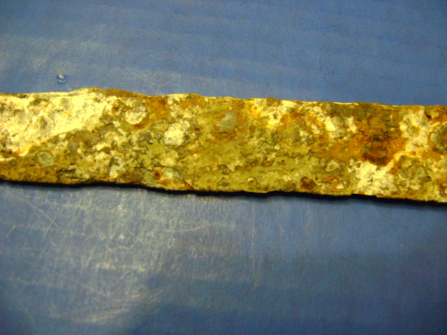

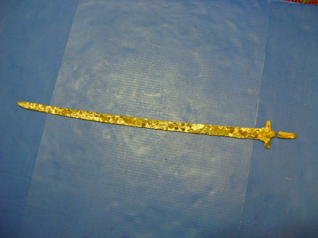

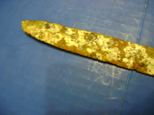

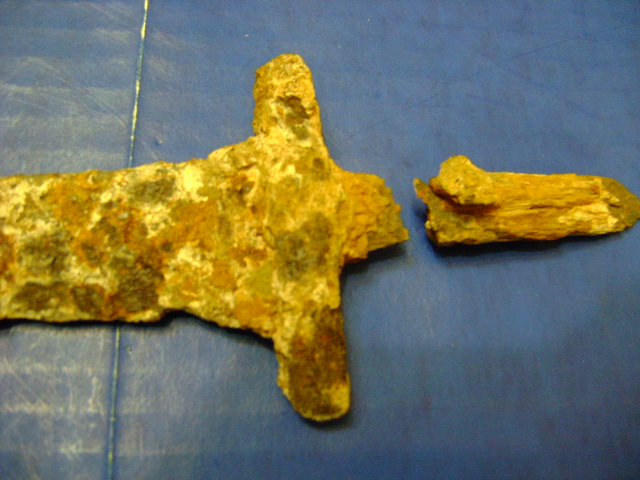

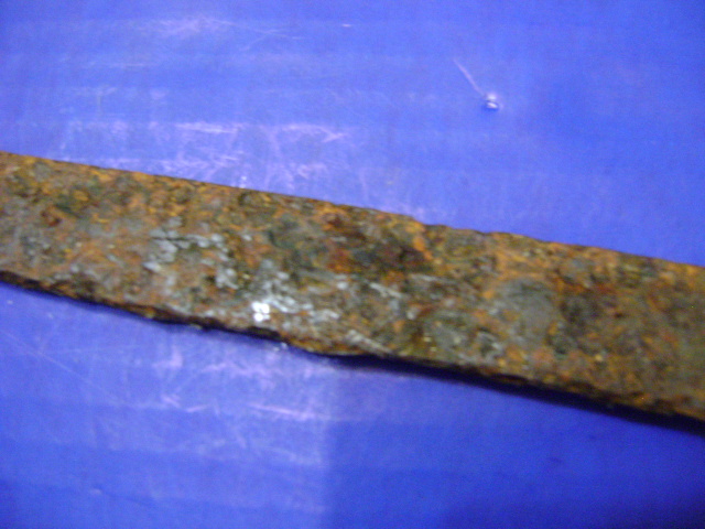

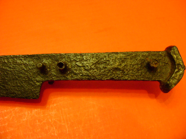

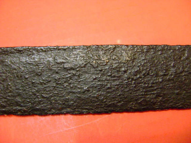

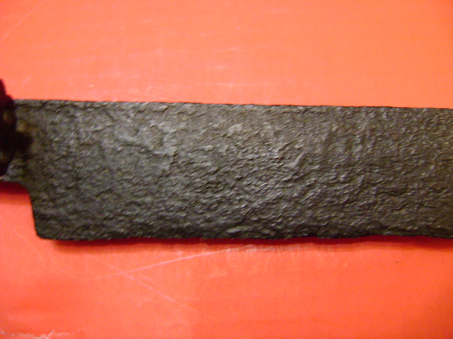

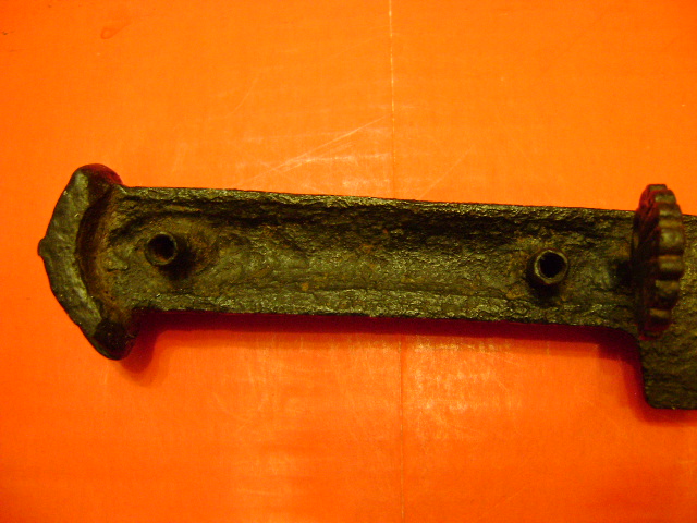

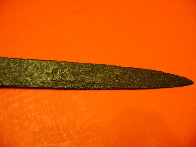

Old 27th December 2016, 02:12 AM   #8
As for vinegar, been using that stuff since I was little kid, like maybe 6 years old. True.It was one of my jobs as kid:- clean the saucepans.
I am glad you remembered the lessons of your youth:-) BTW, your remark was one of the highest inspirations for my attempt of "archeological conservation" . Many thanks!
So: what do you think of my final result?
Old 27th December 2016, 03:50 AM   #9
Posts: 7,255
Actually, if I look at the botom pic, it seems as if there is good solid metal under all that rust. If this is representative of the rest of the blade, I feel that I might be brave enough to do a little bit of mechanical cleaning by picking off pieces of rust flakes. Maybe you might be able to get it back to solid metal --- but don't blame if you finish up with a fragile web of holes.
If you took it very slowly by picking and brushing with vinegar and washing, you might finish up with something.
