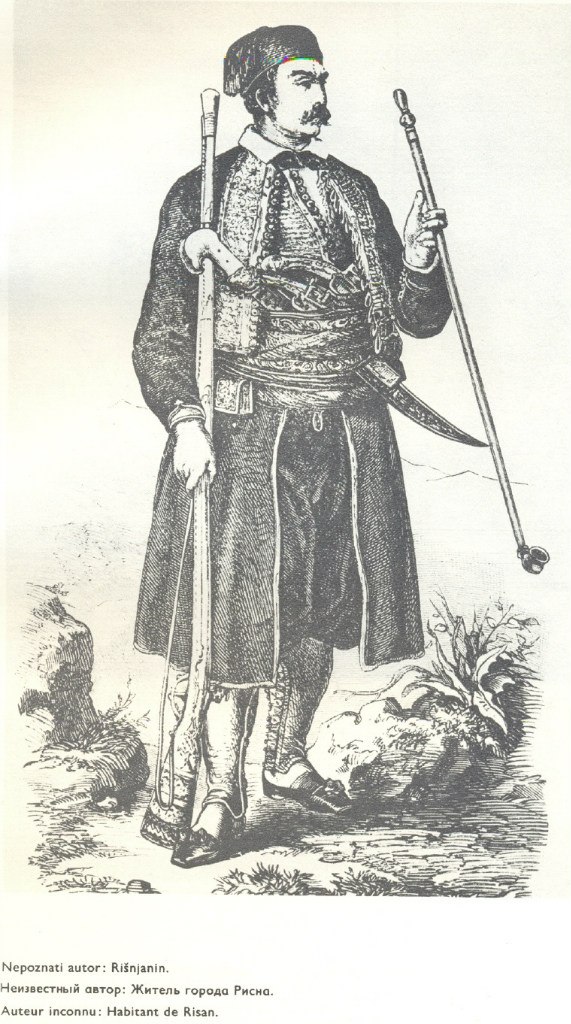

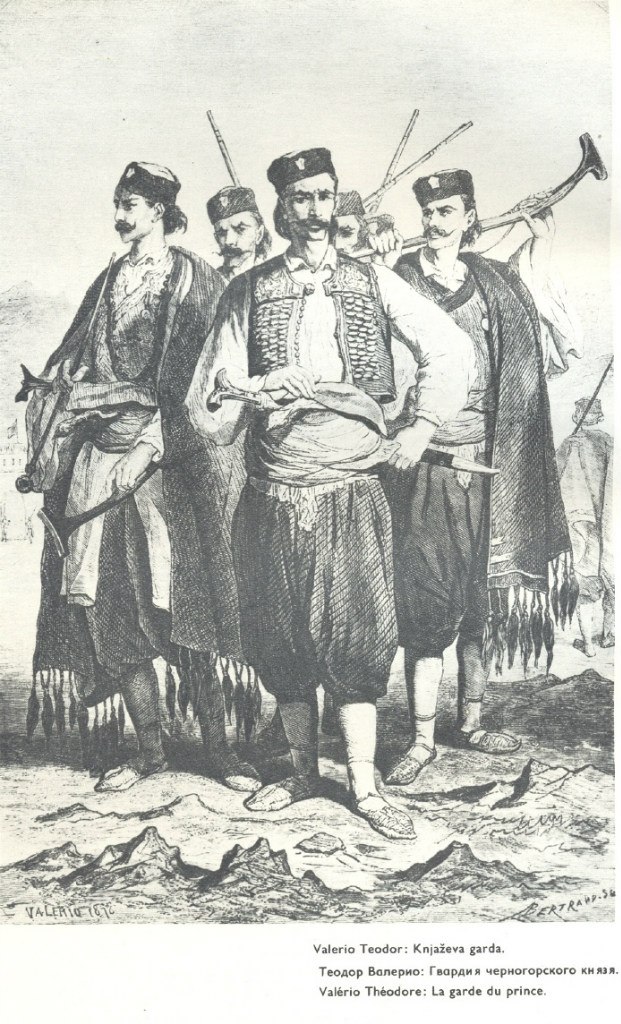

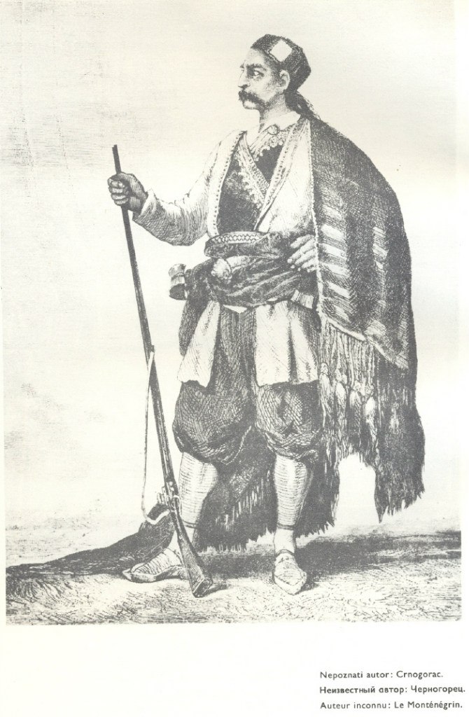

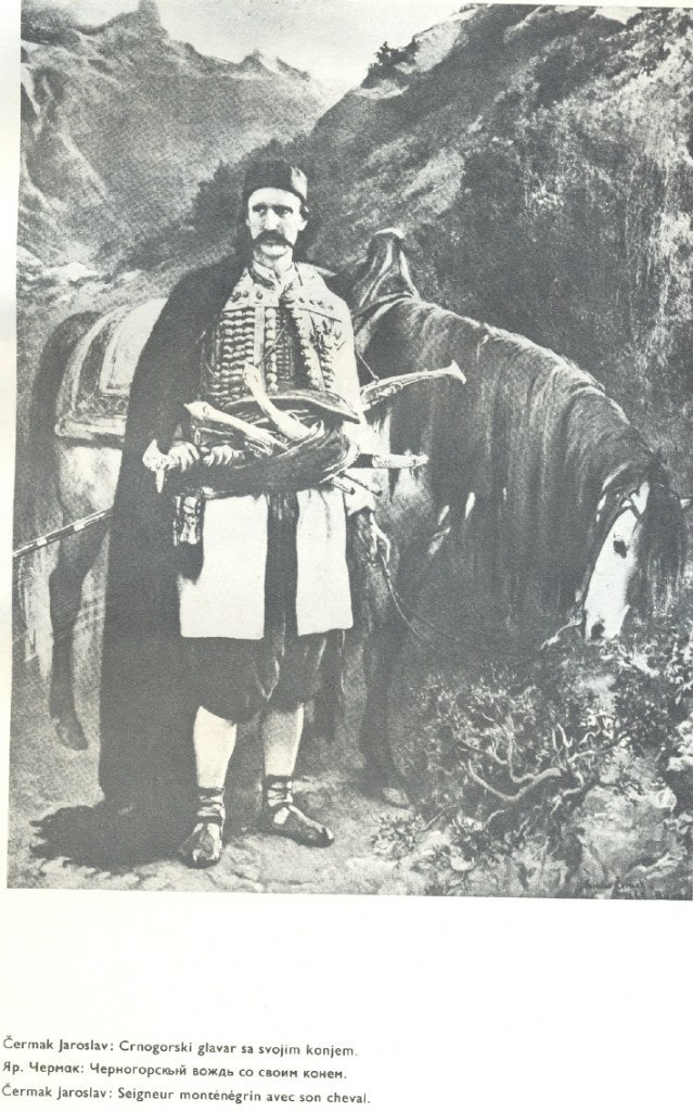

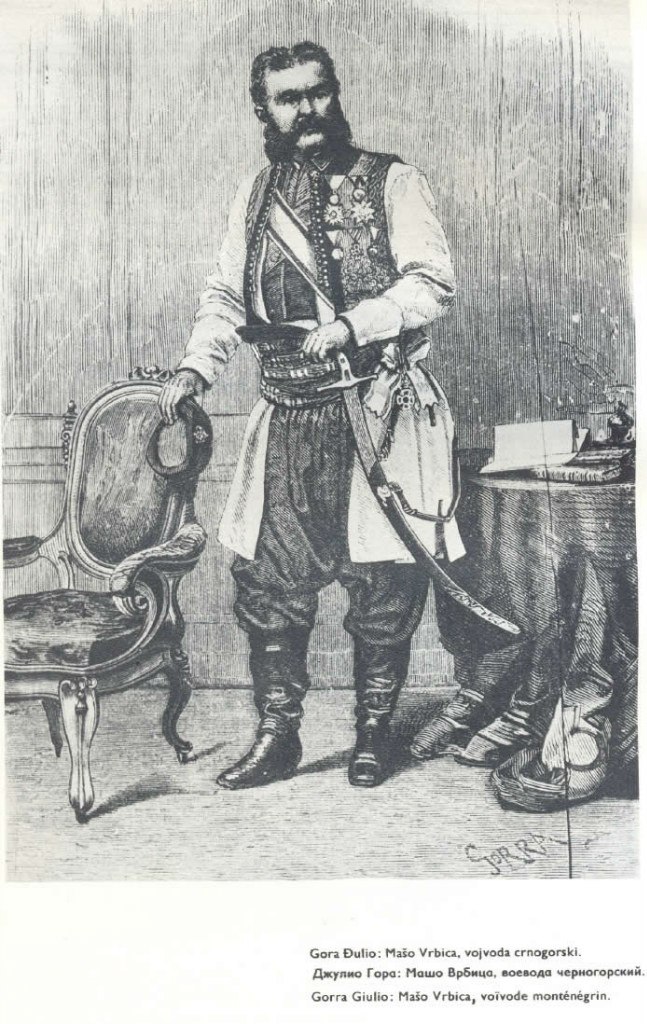

What weapon used by Montenegrin soldiers in the 19th century? Interested firearms and cold weapons. I see muskets, yatagans, revolvers, mameluke sabres... But I need concretization.

Thanks of course, but I need only determine the weapon from the figures above.
Here I do not know if this is yataghan, sludge can have some sort of the varieties that?

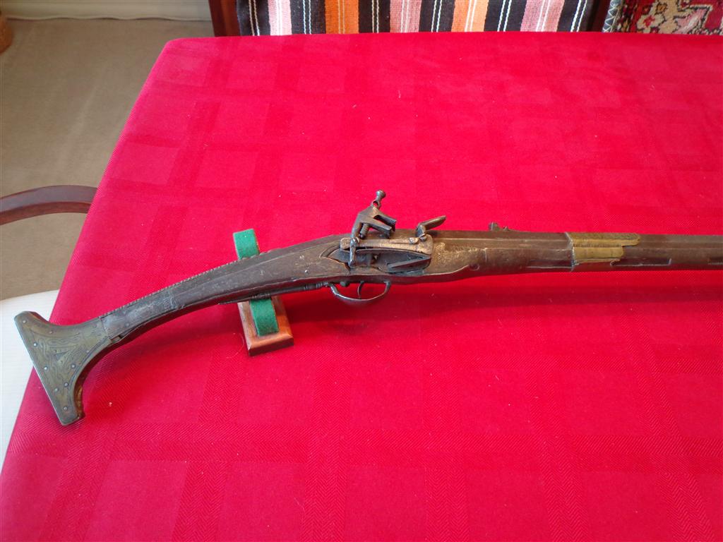

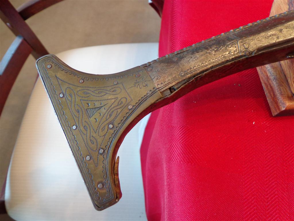

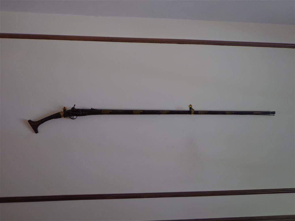

If you will refer to your 2nd, 10th, and 17th photo you will notice a long gun/musket with a fish tail type butt stock. This gun is generally known as an Albanian Tanchika long gun. These guns were produced during the 18th and early 19th Century. Albania was an arms producing center in the Balkans primarily during this period.
Here is a photo of that gun. I have additional photos if you desire. Rick.

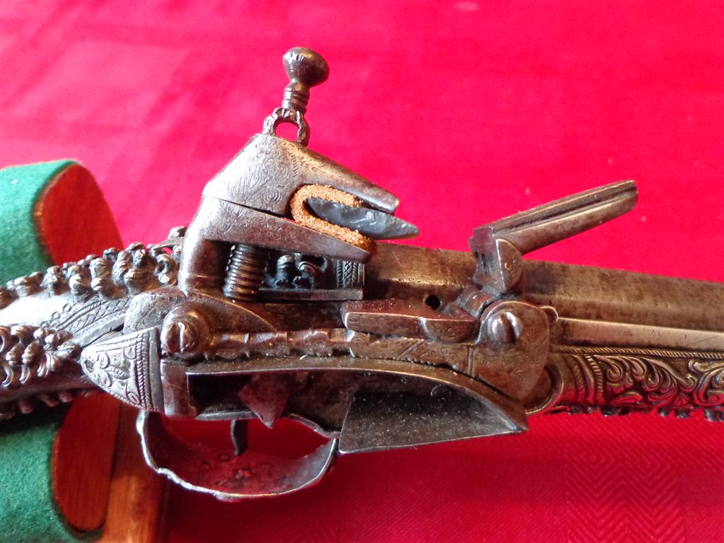

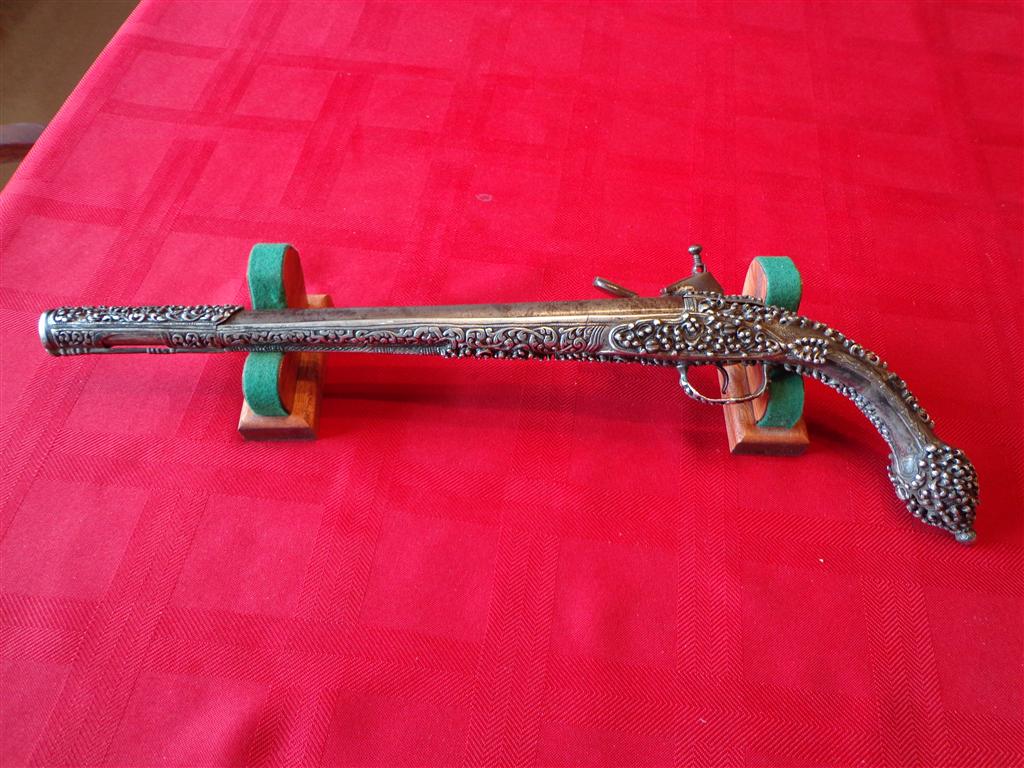

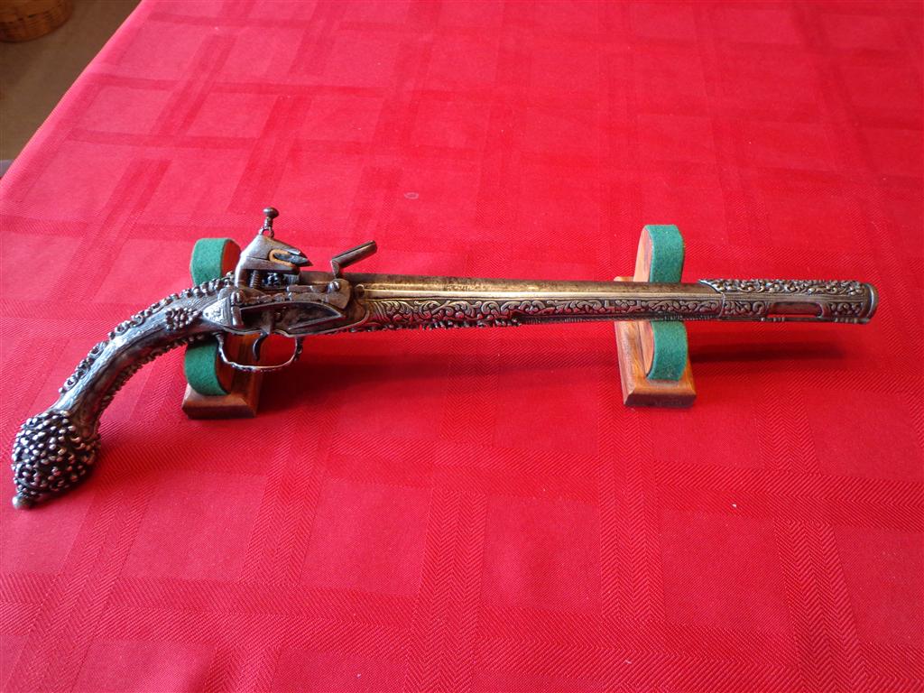

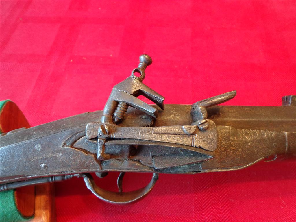

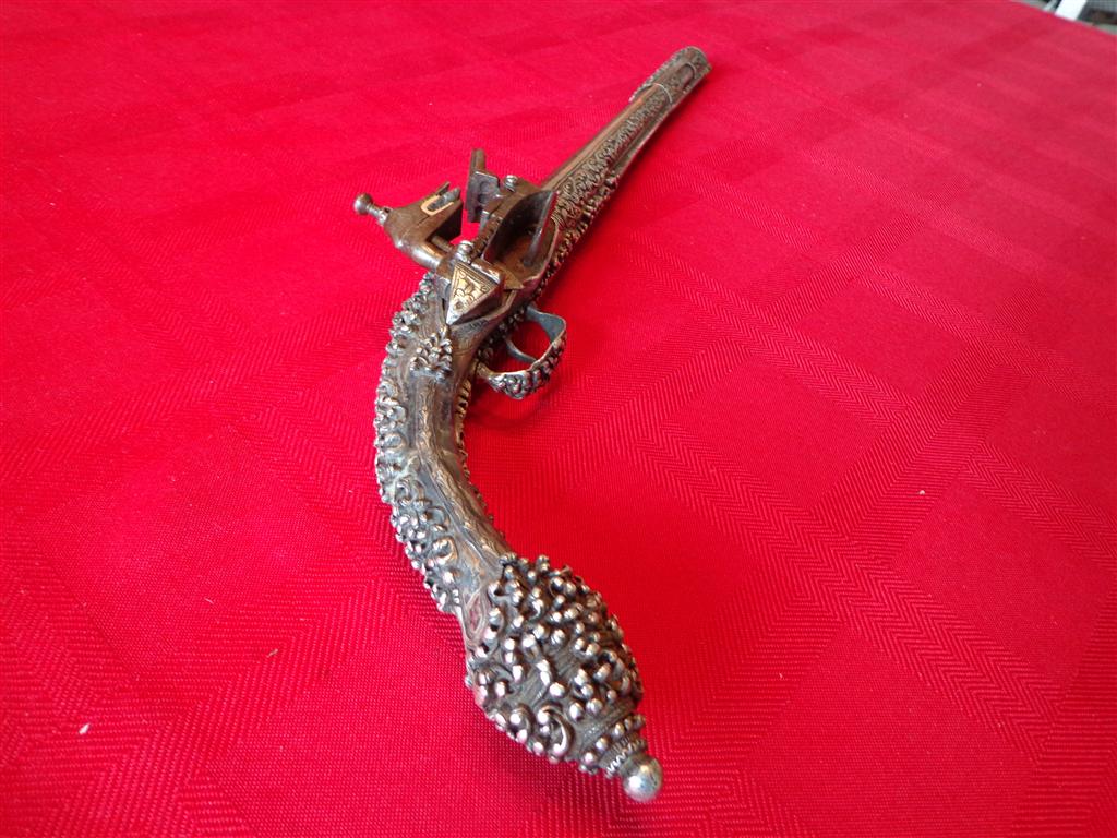

Here is a silver celina or ledenica pistol that was probably made for the Montenegrin market during the late 18th or early 19th Century.
If you refer to your 1st, 2nd, 9th, and especially 10th photos above you will see the similarities to this pistol. Again, hope this helps. Rick.

There are some unusual clipped-point swords shown in some of these engravings .

I see sabres, yataghans, biçaks, karakulaks and things like Surmene knives. A few pictures show the fanciful generic "scimitar" but the scenes look formulaic.

A wide variety of Ottoman kilij / pala, perhaps even some karabelas, and yes Mameluke sabres as well. I see some sabres with western guards but I cannot identify specific sabre patterns. Elgood's book has a very good overview of the very large range of edged weapons available in the Balkans in that time, some in Ottoman style, some in Polish, Hungarian and Western styles. There are also many different combinations, sometimes of kilij blades with yataghan handles (like this one)
Are you asking for specific identification in each individual illustration? If so I suggest you post each photo in a separate post in this thread so we can comment on each individually. If not then search for examples of the above terms as there are many posted on this forum.
