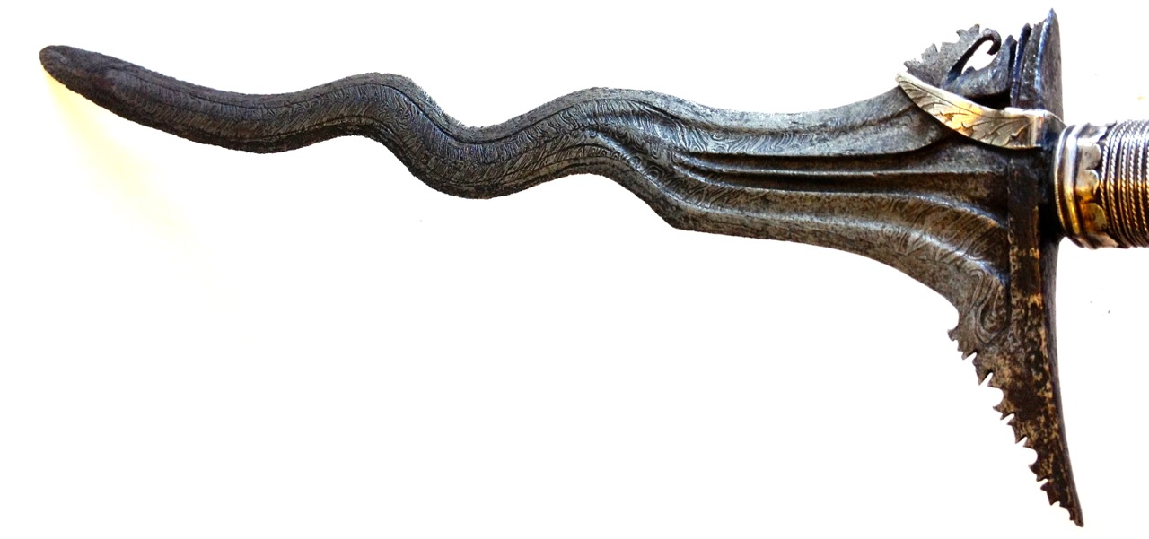

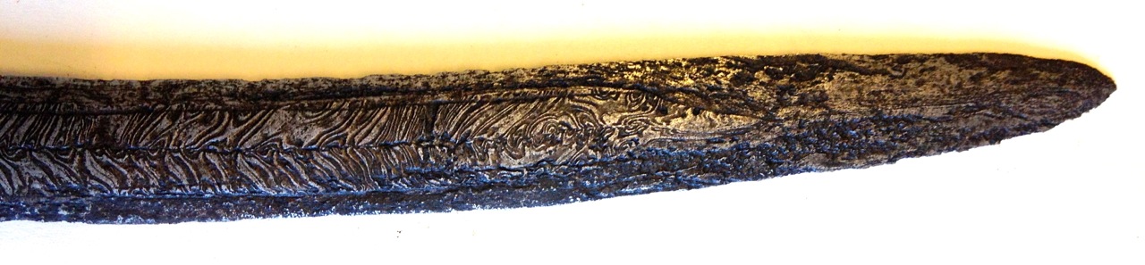

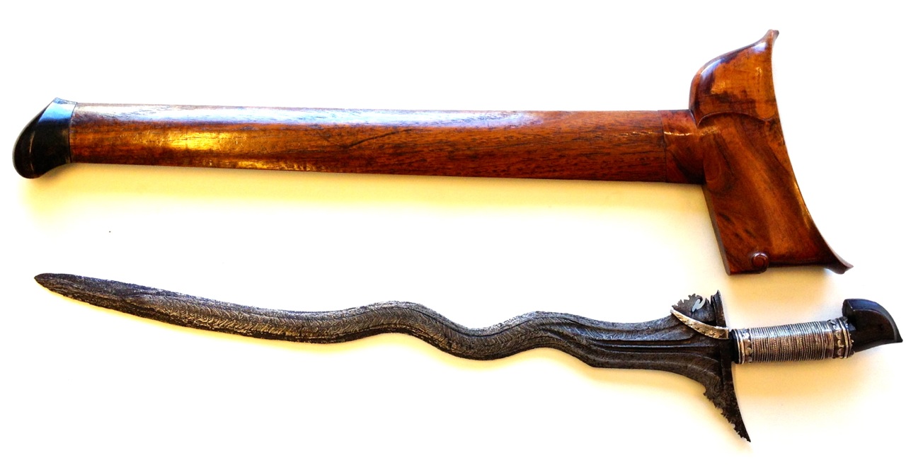

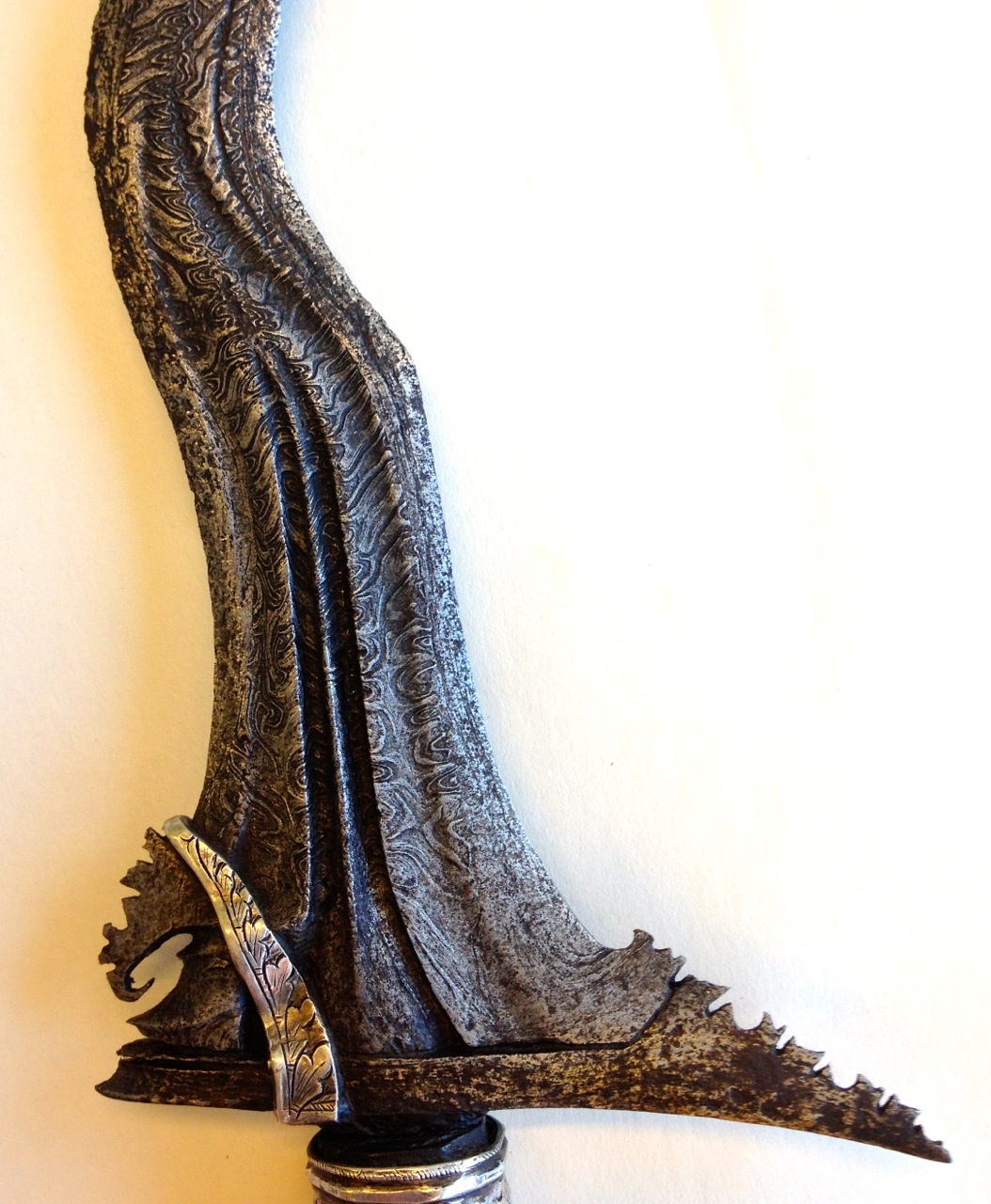

Like CharlesS, I also have a weak spot for the Malay versions of the large keris.

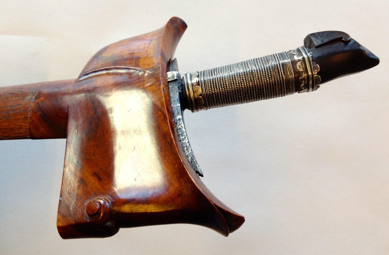

Here is my latest find with a nice twist core and a scabbard usually not seen matched with a Malay keris of this size.
Michael

What a nice example! I love the twistcore. Heavily etched. You can tell the unique okir work of the this piece versus that found on Moro pieces.

Super piece Michael. What dramatic twistcore.
The scabbard looks like a Sumatran keris scabbard.
What a beaut!

Actually it's called Sampir Kusiwo and comes from northern Malay states. I thought, it would be more typical for Kelantan and Kedah, yet I could be wrong.
Yet the curved Loto, typical for this Sampir, surely is influenced by Palembang.
Very interesting and nice ensemble, Michael!

yowza! now that's a twistcore!!! excellent find, Michael!!!

Gustav, I did not know what the scabbard is called but I would also place it in North Malaysia.
Michael

VVV, that is very nice addition to your collection. Amazing blade. I like the deep waves. If this was Moro, I believe some would classify it as being archaic.

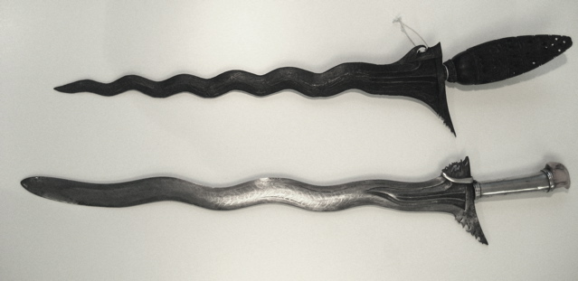

I have a Malay Kris with a twist core blade, a similar but an ill fitting scabbard.

I would also classify it as archaic, which is the step after proto-kris on my scale.
It is slightly below 21 1/2" over all with a 17" blade.
If you already have posted pictures of your Malay kris, please share the link?
If not, maybe you can post it, too?

I have in my keeping the keris that was the State Execution Keris of Brunei, it was made and commissioned in 1842. The blade is exactly the same style.

Maybe you could share pictures of it with us at the forum (as it is not a Javanese keris)?

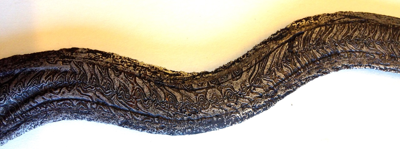

My reasons are based on a combination of: the size (2" shorter blade than yours and smaller than the regular mid to late 19th C kris), the flow of the waves (see Kino's comment), features at the "sorsoran"-area, the miniature pommel and the way the twist core is done.
Michael

I'm not sure that the luk form tells us anything in the absence of documented comparison pieces. I note Kino's comment, but this is not a Moro keris.
I've seen perhaps 3 or 4 of these keris over the last 30 years or so, and the features in the sorsoran are always done in the same way.
To my eye, this miring pamor is the style of work I expect to see in later pieces. The techniques and technology required to weld this type of pamor and to achieve this degree of perfection did not develop until relatively recently in the areas of keris production with which I am familiar.
Frankly, I have very little knowledge of keris outside the core areas of keris tradition, however, applying the tells that I use in my own area of expertise, I would place this blade at no earlier than the first quarter of the 19th century, and the dress as somewhat later.(19th century = 1800's)
Just as a matter of interest, what is considered to be an early date for a Moro style keris? What would be the date attached to the earliest documented example?

A bit earlier at least IMHO. How much this extends into the 18th century (and even earlier) is still not well researched yet; the main problem is the scarcity of reliably provenenced museum examples.
Here's an old discussion on archaic (Moro) kris:
http://www.vikingsword.com/vb/showthread.php?t=241
So, what would be your estimate when twistcore-like pamor appeared in, say, central Jawa?

My qualification is:-
perhaps complex pamor miring did not appear in Central Jawa until the late 18th, early 19th century; in other words at the time when the keris had already been reduced to an item of dress.
Alan, which kind of pamor would you consider as a complex pamor miring?

Any pamor miring is difficult, and once you go to a pamor miring you can count on using vastly more material, fuel and time. The possibility of error increases many times, and the possibility of failure increases many times.
Assessed on the basis of these factors alone, any pamor miring is by its nature a complex pamor. However, some are more complex than others, and these are pamors that are produced by twisting, splitting, re-welding, or other manipulation of the entire body of the bakalan, rather than by manipulation of the surface alone.
As examples, udan (hujan) mas is the result of surface manipulation.
The pamor in the keris that we are looking at in this thread is the result of manipulation of the entire bakalan.

Alan, Kai, there are well known examples of Keris with Pamor Puntiran (twistcore), which are surely made before 1700. If this pamor wasn't popular in Central Java before 1800 (yet I think, the picture in Yogyakarta is another one then in Surakarta), it most probably has the reason, the technique of Pamor Puntiran is not coming from Central Java or Java at all.
So it would be wrong to conclude, Pamor Puntiran appeared on Krisses on Philippines only after they became popular in Central Java.

Gustav, as you know, last year I looked at and photographed a number of very early keris held in several European museums.
In some cases I was unable to read the pamor, either because of the poor condition of the surface, or because the surface was polished.
In some cases the pamor was surface manipulated.
In only one keris was the pamor a miring pamor. This was keris EDB.16 held in Copenhagen. This keris probably entered the collection in 1674. My note reads:- "pamor skilfully manipulated, no name"
I am not prepared to say that pamor miring did not exist in Jawa prior 1700, but it was most certainly was not widespread.
I do not now possess, and I have never possessed a genuinely old Javanese keris, that is a keris that I have good reason to believe may date from before 1700, with a complex pamor miring. I cannot recall ever having seen such a keris.
It is most probable that the skills to produce complex pattern welds were brought to Jawa by Muslim metal workers. These people settled on the North Coast and in parts of East Jawa, rather than in the hinterland. In my opinion the skills used by the people of the Southern Philippines to produce complex pattern welds were brought to the Southern Philippines by Muslim metal workers, just as they were brought to Jawa by Muslim metal workers.
However, the metal workers who took the skills to the Philippines were very probably descendants of the original craftsmen who came from outside Maritime SE Asia. The craftsmen who spread the skills through Maritime S.E. Asia very probably came from the North Coast of Jawa and Madura.
Whenever I have shown photos of the blade of my Brunei keris to knowledgeable Javanese keris authorities they have given the opinion that it is Madura work, and this is also my opinion. Not "Made in Madura", but made by a Madura craftsman, or a craftsman who was trained by a Madura craftsman.
I really do not think that Central Jawa plays a part in this spread of form and technique at all, in my opinion it all came from the North Coast, which followed on from the original trade routes of Majapahit --- which of course were a development of earlier trade routes.
