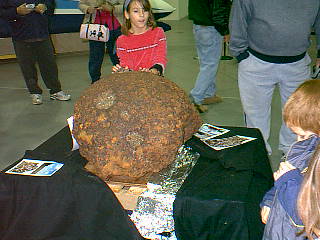

THIS METEORITE WAS IN TOWN AND I GOT TO TAKE A CLOSE LOOK AT IT, HE ONLY WANTED 1 MILLION FOR IT BUT IT WAS TOO SMALL FOR MY NEEDS SO I LET IT PASS

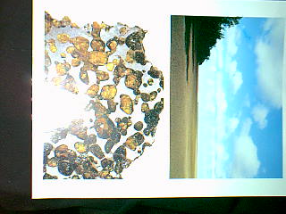

IT WAS COVERED WITH RUST AND IMPACTED DIRT SO THE METAL CONTENT WAS NOT EASY TO SEE BUT THERE WERE ROUNDED PITS THAT SEEMED TO BE MADE ENTIRELY UP OF GREEN OLIVENE CRYSTALS THEY SEEMED TO FORM TUBES THAT RAN THRU THE BODY OF THE METEOR. THE CRYSTALS BEING MORE BRITTLE MOST LIKELY BROKE AND FELL OUT AT IMPACT FORMING THE PITS AS FRESH CRYSTALS WERE EXPOSED. I HAVE SEEN SOME SMALL SLABS OF THIS TYPE OF METEOR AND IT LOOKS LIKE SHINEY NICKEL STEEL WITH GREEN CRYSTALS IMBEDDED IN IT. IT IS QUITE ATTRATIVE WHEN CUT THIN SO YOU CAN SEE THRU THE GREEN CRYSTALS IN THE SHINEY METAL. I TOOK 3 PICTURES ONE WITH ME AND ONE FROM THE OTHER SIDE WHERE THE LARGER PITS ARE AND ONE OF A PICTURE OF A SLAB CUT FROM A SIMULAR METEOR. I HAVE SEEN METEORS CUT INTO SLABS WHICH COULD HAVE BEEN FORMED INTO SPEAR POINTS BY MECHANICAL MEANS, BUT I HAVE NO IDEA HOW BRITTLE THEY MIGHT BE, TO CLEAN UP A METEOR OF THIS TYPE FOR FORGEING WOULD REQUIRE A LOT OF WORK BUT I THINK IT COULD BE DONE WITH THIS TYPE.

That's very cool Barry. Just for the record though, once it has fallen it is a meteorite, not a meteor. Did you try a magnet on this one?

THE METEORITE FELL IN KANSAS NOT TOO FAR FROM HERE AND WAS FOUND BY A PROFESSIONAL METEORITE HUNTER USING A 4 WHEELER AND A METAL DETECTOR. THERE WAS A VERY STRONG MAGNET ON THE METEORITE AND IT WAS DIFFICULT TO REMOVE IT AND ESPECIALLY HARD TO PUT IT BACK WITHOUT PINCHING YOUR FINGERS. I THINK THERE MAY HAVE BEEN A LINK TO THE NEWS STORY IN ONE OF THE PREVIOUS FORUM POSTS, IT WAS FOUND VERY RECENTLY. THE TOP PORTION OF THE PICTURE WITH THE SLAB SHOWS THE AREA WHERE IT WAS FOUND, QUITE A FEW SMALLER ONES HAVE BEEN FOUND IN THE AREA OVER THE YEARS. THERE ARE QUITE A FEW SITES WHERE METEORITES HAVE FALLEN IN THE USA BUT FEW OF US ARE AWARE OF THEM.

From the pictures, this is a Pallasite (a Stony-iron Meteorite)... a rare type of meteorite! It consists of olivine crystals (as a gem stone, it is also called Peridot) in a nickel iron matrix. Usually goes for around $5.00 a gram, so a cool million may not be that far-fetched for a monster this size.
Being a meteorite collector, it would be a crime to make this into a edged weapon... an expensive crime at that, even before removing the olivine.
Several Pallasites have been found in Kansas. At $5.00 a gram... anyone have a metal detector?

It's a Brenham, and the fellow who found it did alot of legal legwork before he started looking - apparently signed contracts with all the local landowners in anticpation of a good find, so the rights to search in the vicinity might just be all sewn up.
For forging, Campo del Cielo would be more appropriate, low nickel and cheap, more like 5 cents a gram wholesale....
