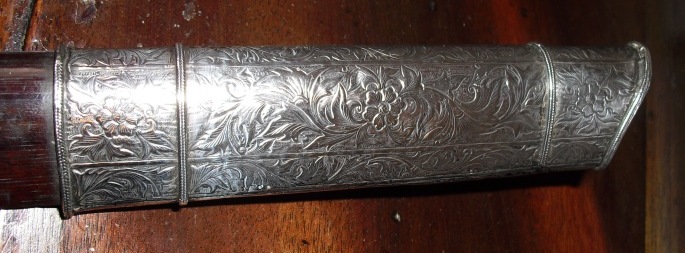

Hi folks,
I would like to tap into your vast collective knowledge base please.
If you saw a scabbard with an end like this, what weapon would you expect it to go with? The metal is silver:
Many thanks for your help,
Matt

Hullo Matt,
My first guess would be a golok/pedang sheath from the Malay Archipelago. The silver would be lower than Sterling, but probably Swasa.

Asian, this reminds me in some ways of dha scabbards, or even sewar or badik. However these regions are far from my area of specialty. I'm sure other members will have much more informed opinions.

Something Indonesian, a klewang perhaps ?
Dimensions ?

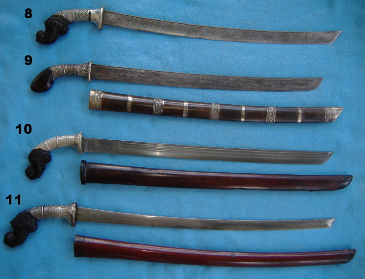

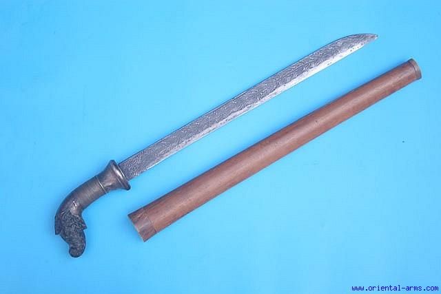

LIKELY A PEDANG FROM SUMATRA HAD THIS SCABBARD. SEE EXAMPLES

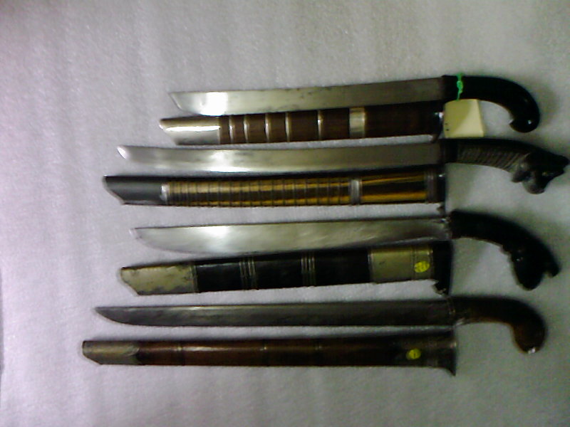

Default GOLOK SOENDA
Hullo again Matt,

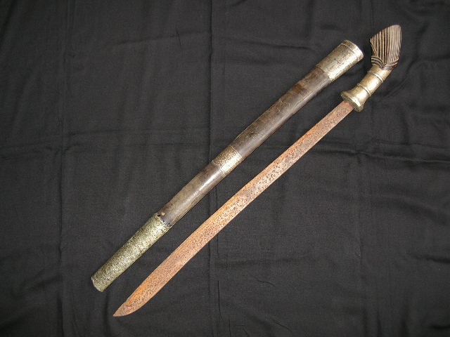

Here is a foto of some GOLOK SOENDA I happen to have handy.
Apologies for the poor quality. It was taken with a 5yr-old phone.
Note the 'sock's/toe-caps.
Goloks and swords came in a variety of similar sheaths, depending on owner.
You mentioned 'colonial officer', so I would look at circa 19thC Java, West Java in particular, as that was where all 'the heavies' were located. European swords in local sheaths were not so unusual, as European sheaths were usually metal and rusted easily as well as being 'noisy'. Leather sheaths didn't last too long either.

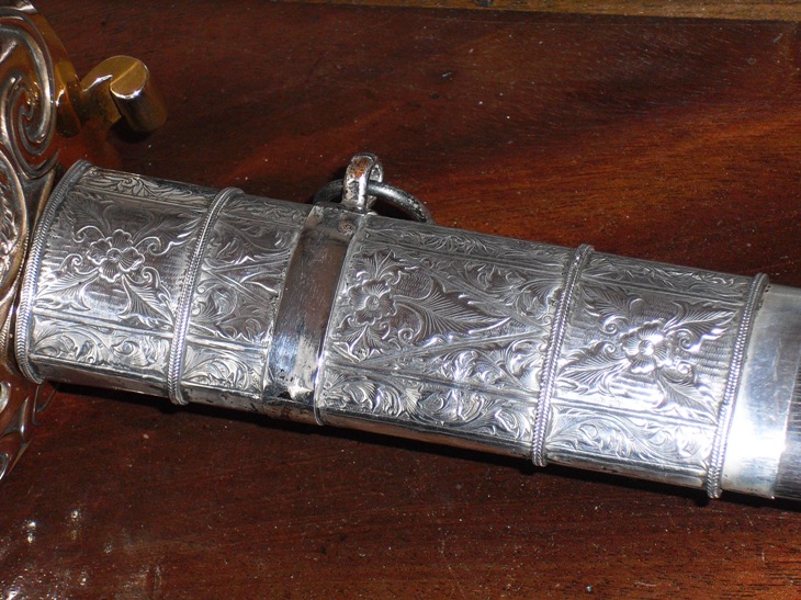

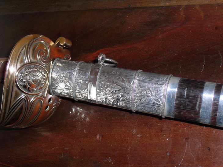

Hi Matt,

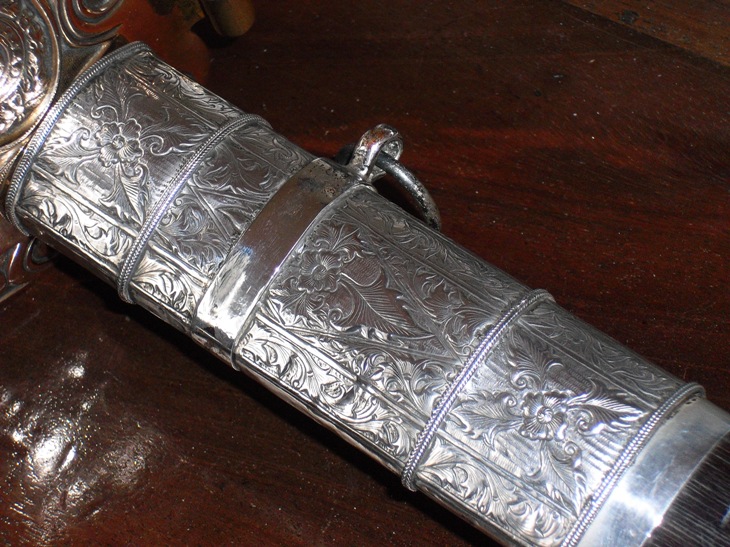

The devil is in the detail. The flower in the scabbard throat may add more to the discussion and the four petals sprouting from it. There appears to be more detail just above the flower, in the next section towards the throat opening. I have attached a detailed photo of this area that may also help others discuss this sword for your understanding.
To my eye, the small flower is seen on Burmese swords but not the 4 large outside leaves. I have a Burmese blade here the same flower on the spine and the binding on the scabbrd is typical of the region, a region that was British occupied....but....the scabbard end, it however A-typical of Burmese sword scabbards to my knowledge, which by design points back to the Sumatran swords mentioned above, a region that also uses this flower like motif and shares the same binding method more so than a Dha.
I recall seeing the flower and four large leaves on some Philippine weapons too.
An interesting pickup.
Gavin

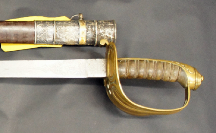

Many thanks Amuk and Gavin, this is all great info. And yes that's the sword that Gavin posted above .
To add more grist to the mill, this sword also bears a Latin motto - that of Sarawak as it happens - 'Dum Spiro Spero' (Whilst I breath, I hope).
This motto is carried around a stylised letter S. The S could stand for Sarawak, but if so, I have never found any other Sarawak emblem like that.
Perhaps the S stands for a region of Sarawak, or somewhere else entirely... such as Sumatra.
I initially assumed that this sword was that of a British officer serving under the White Rajahs (Charles Brooke to be precise), but I am now less sure.
The Java examples posted by Amuk above certainly seem to match very closely.

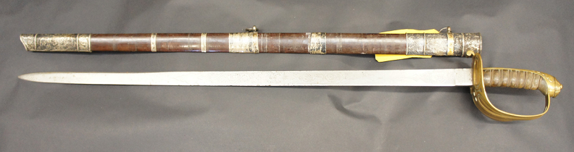

Hi guys, so here are some details of the hilt components - any opinions?

To me, it looks as if the floral decorations are stylised representations:
- four-petal flower: wax apple
- six-petal flower: durian

Here are some more pics:
