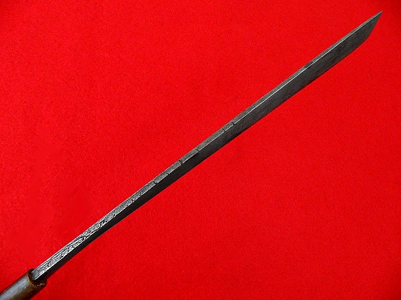

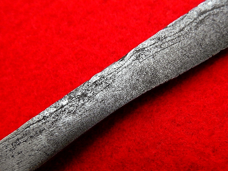

I think that it is a Batak sword but frankly said I never have seen something similar before. I would like to know if someone is able to enlighten me.

Hello Detlef,
Sure, Batak: Pakpak tribe. Nice knife with blade in ladingin shape; need to check where I saw a similar hilt - will try to post a pic.

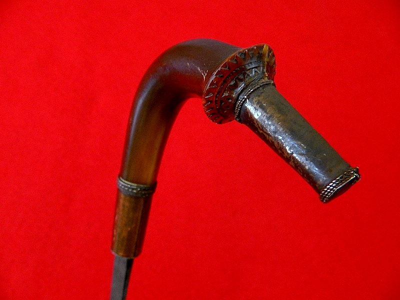

Hi Detlef!
Killer sword bro - I love the hilt and fittings! The blade (lading, as kai says) and especially scabbard says Batak to me too, although I haven't seen a similar hilt in my (rather diminutive) collection of material on the Batak. Most often, I've seen the lading with a Babah Buya hilt. Love the color and structure of the horn - and is that a very cool native repair we see on the ridge?

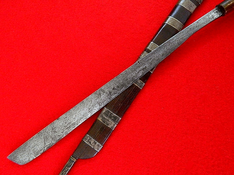

Very nice sword!
A pity you got outbid on this one...
I think the blade is a typicall amanremu blade.

Nice sword.
The hilt makes me think of lopah petawaran hilts. although the cutting edge in reversed on them.
The end cap of the hilt is a repair. Wonder if the shape and length of this cap is original, or was it longer, as with the Lopah Petwaran handles

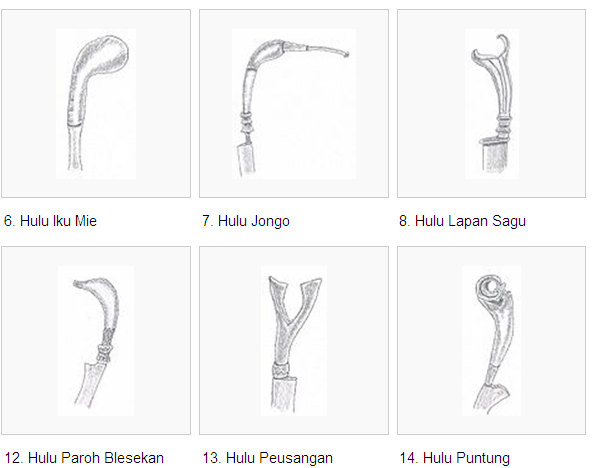

can we call this a "hulu paroh blesekan" ?

Hello Thor,
I believe that the seller is correct that there was a metal (probably silver) piece attached (with 2 brass pins) which is now missing.

Hello Maurice,
Yes, very similar. Some ladingin also come with this type of blade.
Note that this is small (blade 11.5 inches = 29 cm) - should handle more like a knife rather than a sword.

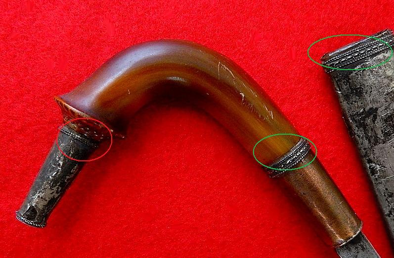

Hello Willem,
What hints do you see for a later repair? From the pics, I believe this could be en suite with the ferrule.
Given the multitude of names for hilts from many of the ethnic groups all over N Sumatra, I'd guess that this quite distinct hilt did have a special name, too.
Hello Kai,
Please check this picture.
There is definately a difference in the silverwire pattern, as well as the refinement of this silverwork.
