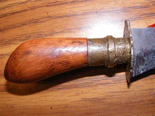

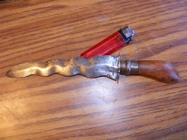

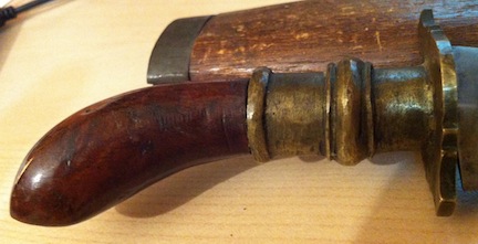

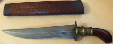

I've had this small gunong for a month or so now ( it was pointed out to me at auction by a very kind forum member) and thought it was time to ask a few questions about it. First, the guard and collar are cast in one piece. This is something that I have not seen before. Does this help pinpoint who it was that made it and help in where and when it might have been made? Second, the blade of this piece was not attached very well and pulled free from the grip with little effort. It was inserted where the point was pointing up not downward like it is in the photos. Which is the correct way for the blade to be positioned, point up or point down like it is now? My thank to anyone who might be able to help in answering these questions. The blade on this is 6-5/8 inches in length and 1-1/4 inches wide at the guard. Total length of this piece is 9-3/4 inches. Again, I apologize for the poor picture quality but it has snowed over 12 inches here in the last two days making it a bit difficult to take them outside.

I have to admit I have not seen a cast guard and ferrule like this either. The blade is correct. By the waves in the blade, the simplicity of the work, the size of the piece, and the form of the hilt, I might place this as an early gunong, parhaps 1910s to 1920?
Hard to date these with any real accuracy. Also hard to figure out where it was made since there is no decoration to indicate tribal origin. The only thing is that most of these were made on Mindanao........

Thank you Jose. I was hoping that the one piece cast guard/collar might help pinpoint a specific group and location for this gunong. As for the age, I have always been quite confused as how to figure that out. I take it that the shape of the hilt and blade are two of the better indicators used in dating these, is this correct? Thank you again for your help.

The orientation as you have it now is correct. I picked up one very similar to this at the local smalltown gun and knife show last year. It was in a batch of "take your pick" for $12.
I would place it around 1920 as well.

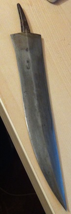

Can you post a pic of the blade longitudinally? it looks very thick in the centerline.

Hello Nirghosa, and thank you for your help. I can post a picture of the blade thickness sometime tomorrow if that would be OK. To answer your question though, the blade is 3/16 of an inch thick at the guard. Could you possibly post a picture of the one you have for comparison, is the guard/collar cast on your example too?

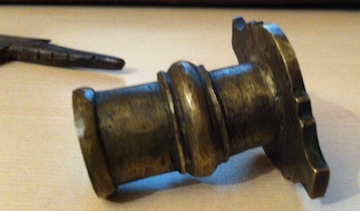

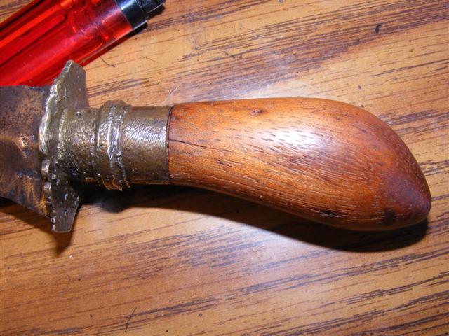

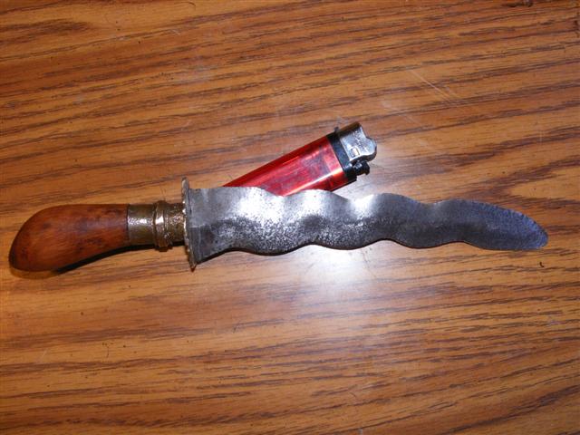

I had to take pictures immediately, so forgive me if they're taken right on my computer table. This is a Gunong that I picked up on eBay about 3 months ago. It arrived after I went to India, so I hadn't had a chance to look at it until last week. Like the one above, the blade was not at all firmly attached in the handle, and another similarity is that the ferrule is cast in one piece, as you can see. The blade is a dull color because I stained with ferric chloride, hoping for some kind of a pattern. There are very small cracks in the blade that suggests that it was forged.The blade is 6 1/2 inches long. The sheath seems very ordinary.
I think the blade is nice and functional, an excellent knife and a real weapon, I don't have any idea of the age. Can anybody here help me?

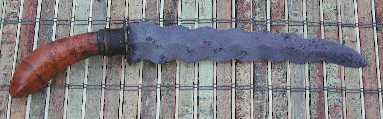

Robert
sure, I'll take a picture in the morning when the light is best. No, the guard and collar are not cast but more like Montino's.

Actually, I found I did have one poor picture on this computer

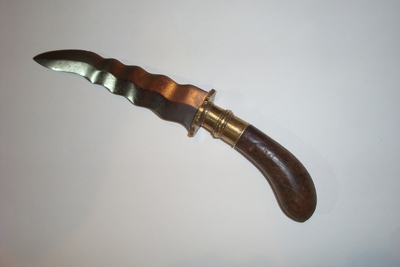

I've got at least one with a cast ferrule/guard. Here's one of a similar (?) age.
