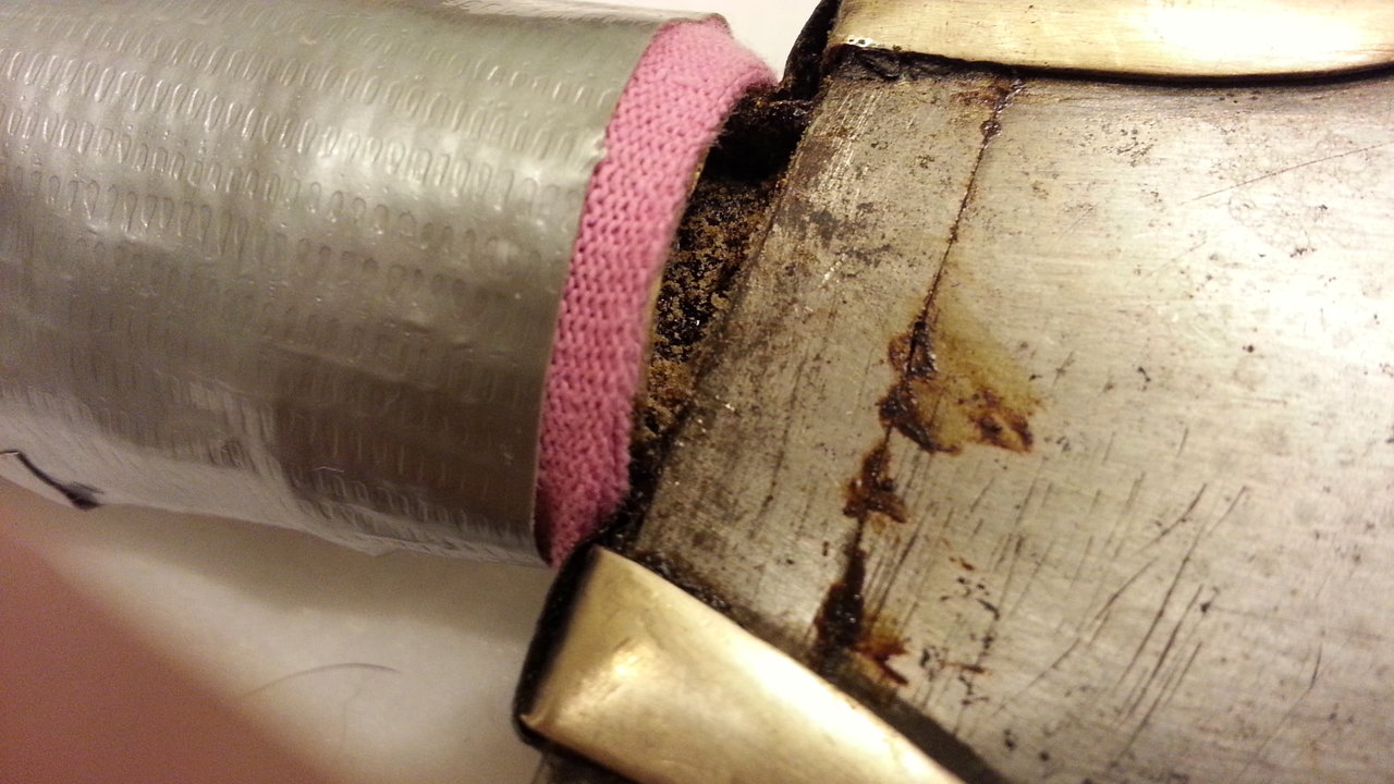

Thanks for everyone's feedback so far!
I've attach some pictures of what i'm working on.
Alan, i don't think it's pinned, but i'm beginning to wonder if the strap to the asang-asang is welded by rust. after taking some very close up pics, i can see where the strap looks like there's rust, but then again, it could just be the epoxy. i have tried methylene chloride, MEK, and acetone, but so far none of these worked. and heat. if the rust is bonding the strap to the handle, how do i go about in loosening this up?
Old 20th February 2013, 05:20 AM   #16

Hello Spunjer, I've been watching this thread with great interest as I too have a piece that has been put together with epoxy and need the same help that you are looking for. As to the kris you are working on, I have one that the strap going to the asang-asang was actually nailed to the hilt. Do you think that this could be the same for yours?

I've never worked on one of these Philippine pieces, however, a couple of things do occur to me.
Firstly I'd remove the covering on the hilt if this is possible, in order to ensure there was no pinning of either the tang or the support stirrups.
The second thought is this:- if those stirrups go up into the hilt and there is adhesive holding them too, it is entirely possible that the heat transfer through these much thinner pieces of metal is insufficient to heat the adhesive to the point where it will let go.
If you can get the metal hilt covering off it might be easier simply to cut away the wooden hilt inside the cover and replace it.
The tangs on the things I work on are very often bonded with rust, and then it becomes a matter of repeated heat treatments over days , or even weeks, and working the hilt back and forth under heat, Eventually they let go, but sometimes the rust is so bad it totally penetrates the tang and you need to replace that when you get it free.

there are no pins or nails securing the asang2x. Alan did make a good point:
i'm exploring it from this angle at the moment; perhaps a micro butane torch aimed at the stirrups might help loosen the strips attached to it.

Spunger, if you feel confident to use a micro torch --- which in my experience can sometimes be more severe than a normal size torch --- why not use a normal torch with a nice bushy flame that will put heat into both the blade and the stirrups at the same time?
Are you able to get at the wood core of this hilt to cut it away?
I reckon that's the way I'd be going if I'd tried the normal route and it has failed, its an easy thing to replace a hilt core, and once the thing is together again you cannot see the core. To my mind this is no different to demounting a blade and remounting with fresh adhesive.

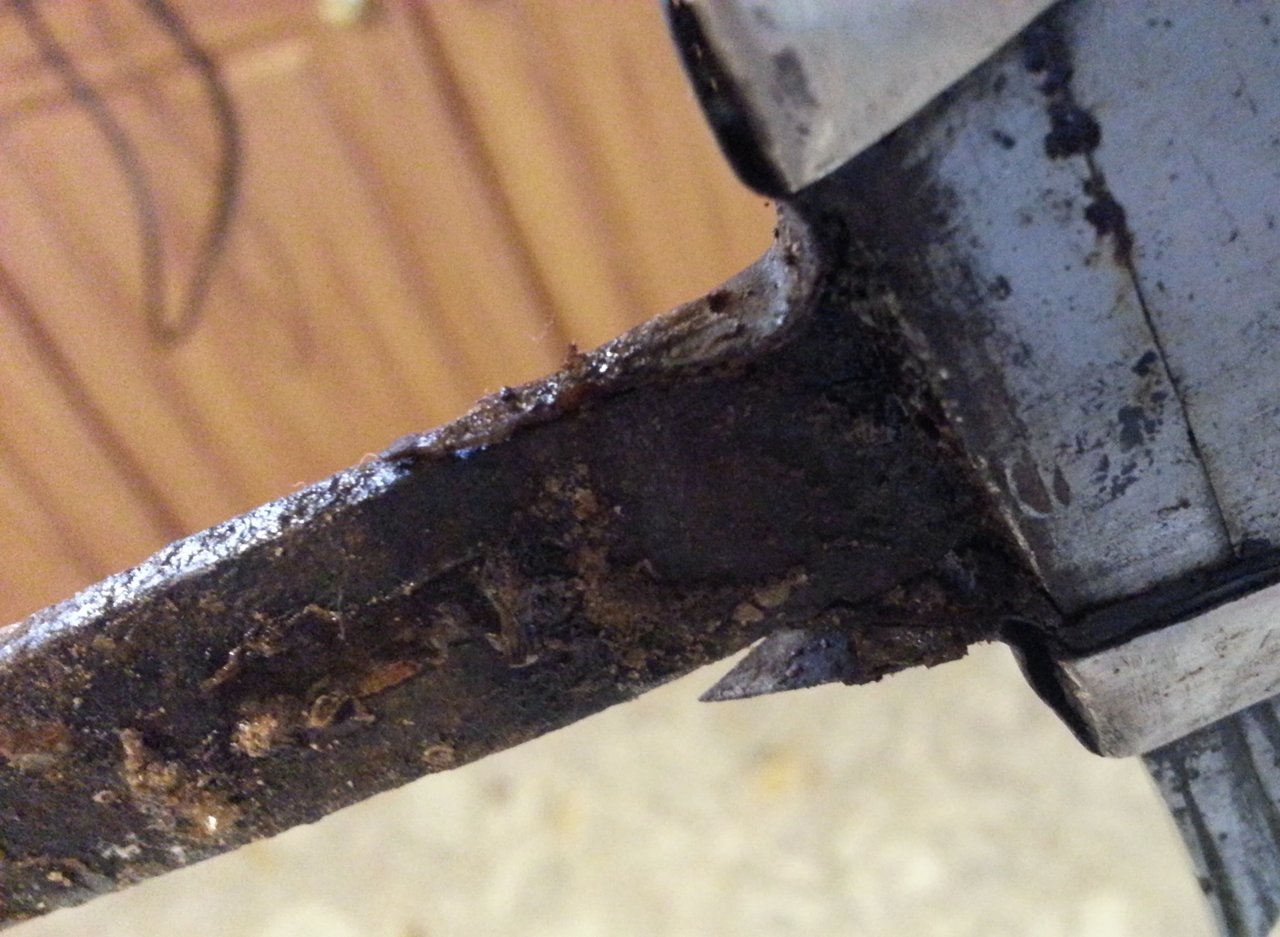

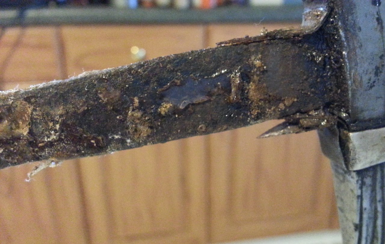

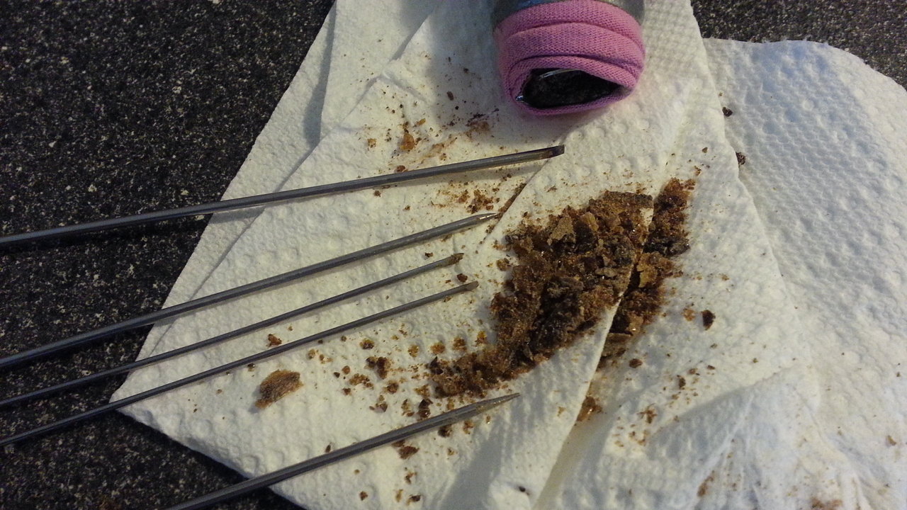

Yes!
placing the heat closer to the stirrups helped, i'm guessing, or perhaps it finally weakened after messing with it for more than a week!
it was a challenge removing this handle without altering anything. i actually thought about what you suggested, Tim, regarding snipping the stirrups awhile back, but that was going to be my last resort. anyway, posting pictures of the aftermath, for future reference.
i was able to scrape most of the epoxy inside the handle. i've enclosed pictures of it, and also the tools of the the trade (homemade shanks).
thank you all, esp. to you Alan!

Those little stirrups don't go up very far, do they? As I've said, I am not familiar with these weapons I've never had one apart, but I had a mental picture of the stirrup running up inside the hilt for maybe a couple of inches.

Hello Alan,
Usually these are running along the outside of the wooden grip area rather than inside the hilt hole (along the tang); in Ron's example, the metal strings appear to have been shortened to be placed along the tang by an epoxy wielder trying an repair job despite being not terribly knowledgeable regarding Moro kris...
Here's a pic of an asang-asang made from a single piece of metal:
And here the usual hilt configuration (without braided grip binding which would also secure the clamp or metal strips):
Old 24th February 2013, 10:44 PM   #27
Congrats, Ron!
That looks like a bit of brittle stuff coming off, too. Remnants of the original resin?
BTW, please let us have an unobstructed peek at the hilt/pommel, too!

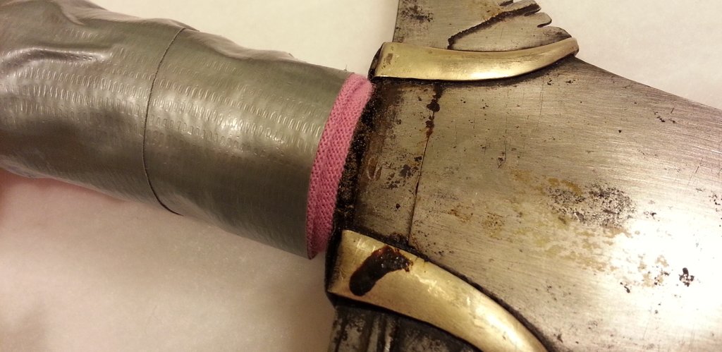

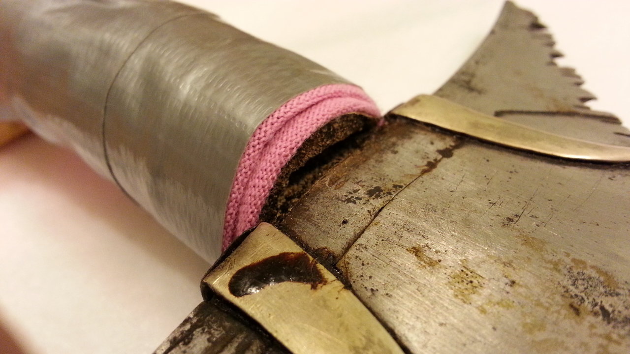

Old 26th February 2013, 08:12 AM   #29
Spunjer
Spunjer's Avatar
Posts: 1,730

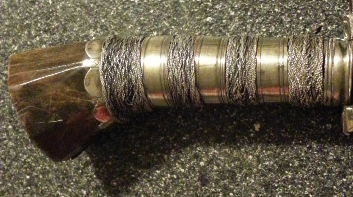

here's a close up of the handle.. sorry, i had it all assembled together before i read your request, kai.
had this kris for awhile. just didn't like the space between the handle and the blade with the epoxy actually bulging out in some areas.
as far as the variation on how the strap is assembled, i've seen this done before, whereas the straps run inside the handle as oppose to the outside. the only difference on this is how short the strap was; normally it's about the length of the tang itself.
Old 26th February 2013, 10:27 PM   #30
Thanks for the pic, Ron!
Yeah, the short(ened), pointed pieces don't look right.
I have yet to see an example with strips running inside the hilt that proves to be at least 19th c. and being unaltered; I guess this may rarely be a genuine feature, especially with hilt types that don't favor attachment to the outside. However, this construction would not offer any benefit over any tang-only attachment (like most other swords of the region).
