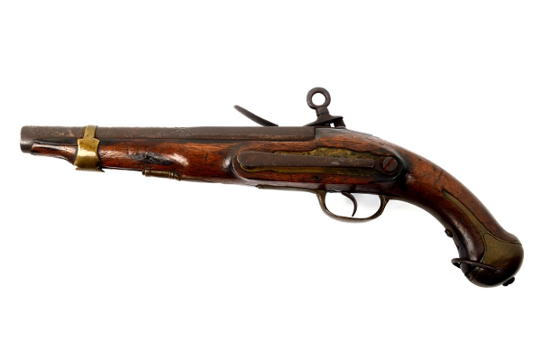

Default Spanish Cavalry Pistol with Patilla Style Miquelet Lock 1808-1812

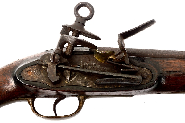

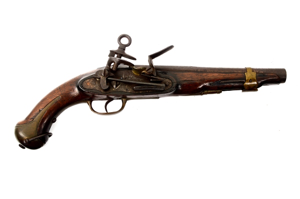

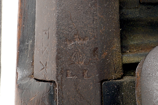

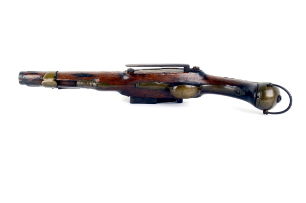

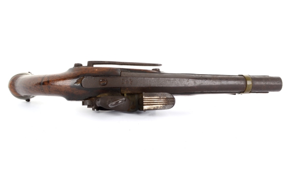

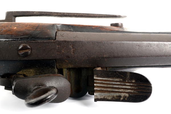

Here are some photos of a Spanish cavalry pistol with a patilla style miquelet lock. It was made in Valencia 1808-1812. The pistol is marked “Fa.Va.” (Fabrica de Valencia) and “L.L” (doblemente leal=LL=doubly loyal). The emblem of Valencia (a rhombus with vertical lines under crown) is also stamped on the barrel.
Juan L. Calvó depicts a similar pistol on page 68 of his book “Armamento Español en la Guerra de Independencia”.
The pistol has a belt hook. I am looking for any illustrations of Spanish cavalry carrying this style pistol in a baldric, saddle or horse holster.
This pistol may have been in use during the Spanish War of Independence 1808-1814 (Guerra de la Independencia Española).

Estimado Dana:
La llave (lock) es "a las 3 modas". Del miquelete, toma el resorte mayor actuando hacia arriba, el "gatillo" (cock) y el tornillo pedrero (flint screw) con aro, y el sistema de disparo. De la llave a francesa, toma la brida del rastrillo fija a la cazoleta (pan) y el rastrillo (steel) redondeado y curvo (si bien está estriado como en el miquelete). De la llave "a la romana", toma la disposición del resorte del rastrillo (encima del muelle real), si bien está fijado como en el miquelete, por oreja pasante y no por tornillo.
Afectuosamente. Fernando K

Dear Dana:
Key (lock) is "at 3 fashions". Del miquelete takes more acting spring up, the "trigger" (cock) and screw scree (flint screw) with hoop, and the trigger system. Key to French takes rake flange fixed to the bowl (pan) and rake (steel) rounded and curved (but is striated as in miquelete). Key "to the Roman", takes the rake spring arrangement (mainspring above), although it is fixed as in the miquelete by ear and not by screw intern.
Affectionately. Fernando K

Sorry Fernando K, I am not sure what you are trying to tell me.
Maybe you wouldn't call this a patilla style lock. It is certainly a late example. The frizzen / battery spring is forward of the pan and has no bridle, but it still looks like a patilla to me.

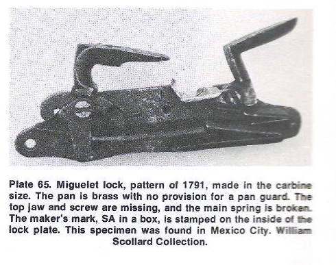

Miqueleter also sent me some additional information on Model 1791 locks and pistols. It comes from the book Spanish Military Weapons in Colonial America 1700–1821. One of the authors is Herman Benninghoff. He also wrote a great article for the American Society of Arms Collectors titled Some Spanish Weapons in the American Revolution. http://www.vikingsword.com/vb/showthread.php?t=11084
