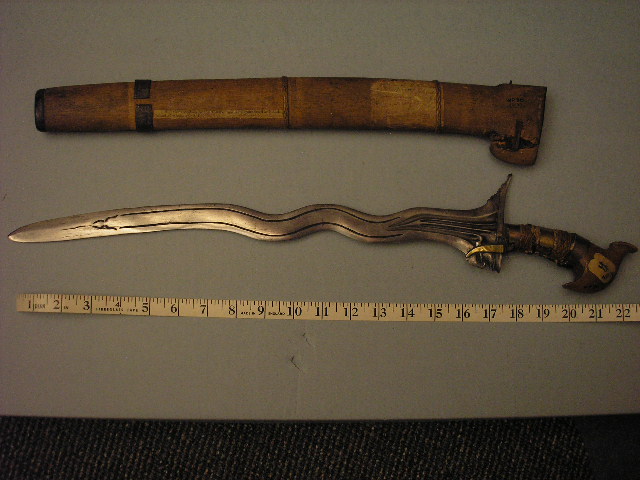

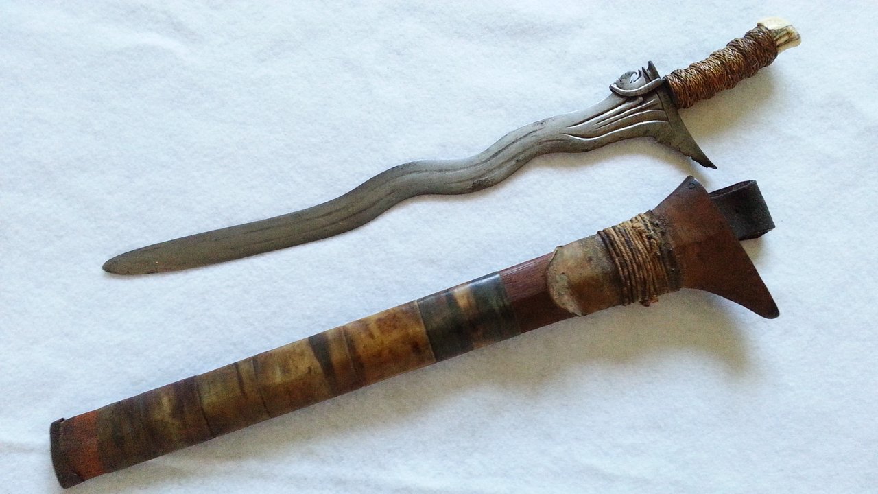

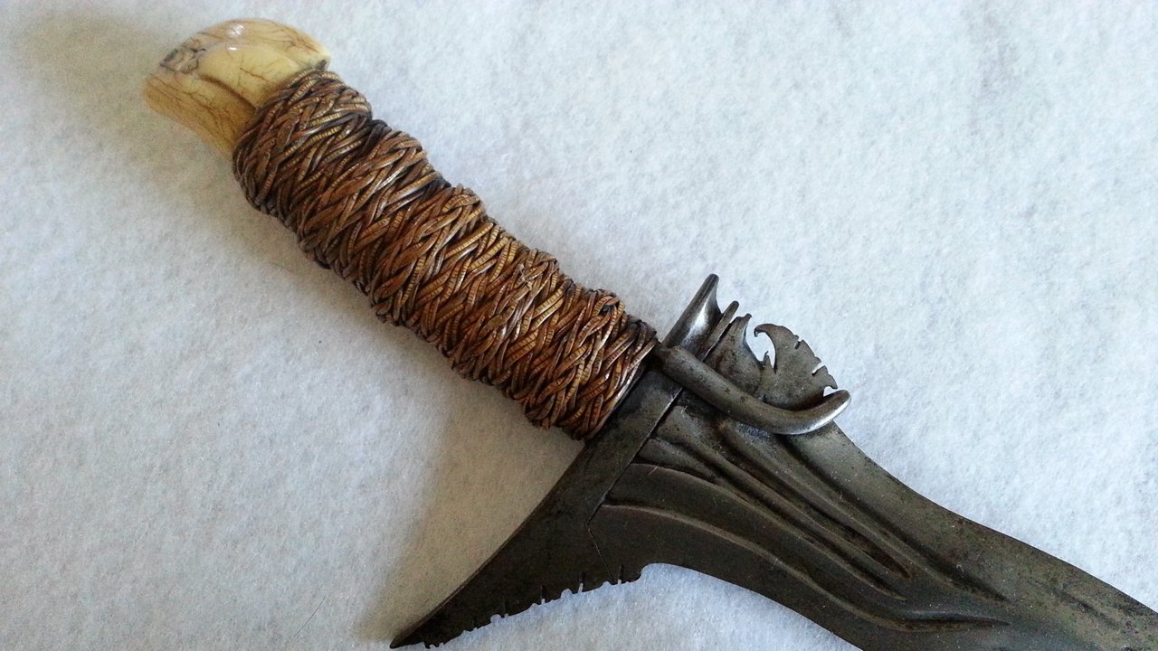

here's an unusual kalis. been looking for one of these diminutive pommel/short blade for awhile, then BOOM! this baby showed up.

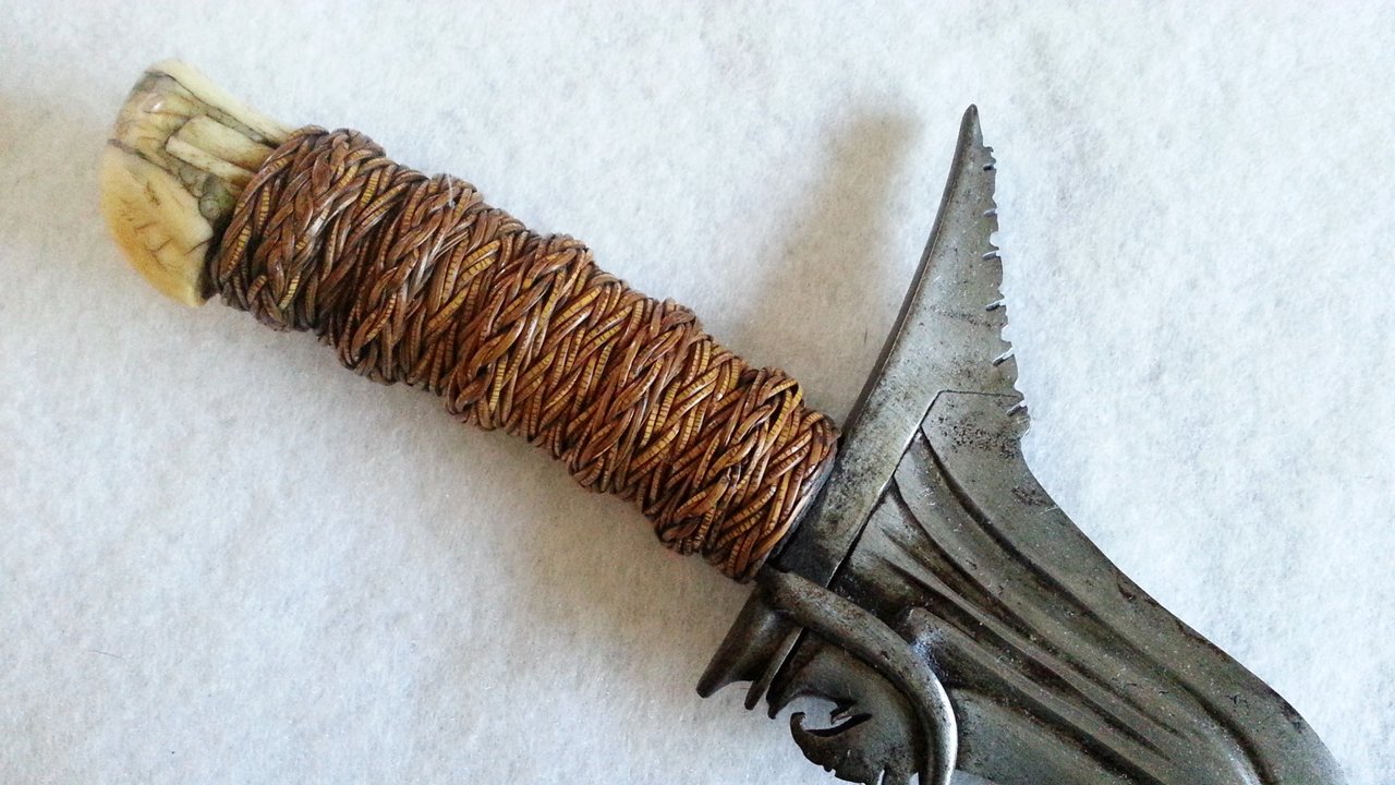

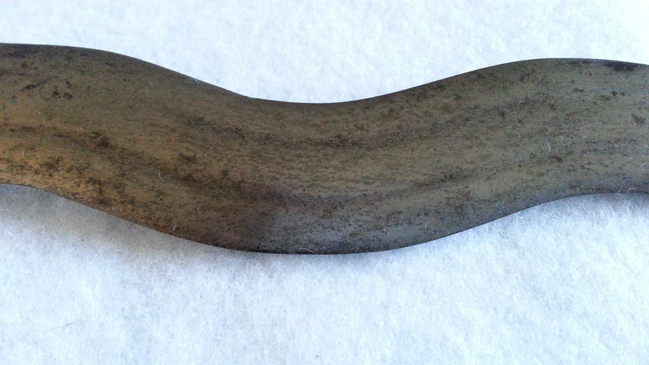

it has a miniaturized ivory pommel that look similar to VVV's miniature kris (http://www.vikingsword.com/vb/showthread.php?t=5834). odd thing about this is, the left side of the pommel has a complete appendage, whereas the right side looks like it cracked while it was shaped and instead of fixing it, it was stuffed with thin ivory pieces to cover the boo-boo. size-wise, the blade is only 16.5" long and an inch wide, an inch longer that VVV's, but i think these two came from the same era. the scabbard is in bisayan fashion, which was a latter addition. the scabbard itself is old, based on the hanger attached to the throat. the bottom shell wrap is missing. another odd feature is the surface of the blade. it looks like lamination, but then again it might just be imperfection on the the metal that was used.
while we're on this topic, here's what i don't understand: why is it that the elephant's truck/eagle beak on these so called archaics are similar that if we have to go by cato's book, they are all sulu? if these are indeed the percursor of the longer krises, then is it safe to say all krises were made in Sulu and some were imported to mindanao (highly unlikely), or were all the krises had similar elephant's trunk/eagle beak design? if that's the case, when did the Mindanaoans deviated to have their own design? or are these so-called archaic krises are just another type of the myriad designs the Moros of yore had in their arsenal?
discuss...

Yeah Ron, I have wondered the same things.
In fact I would add to that the ganga line - most of these archaic forms do not have a straight ganga line but one that tips at an angle. Hmmmm.......
Anyway, nice piece with a very small head. Are the ivory pieces Jed together?
I also thought I saw some lamination in the blade, although it could be be lighting.

Have you etched it already? I'm sure you can get more out of it, if you try!
I'm not sure that yours and Michael's kalis are from the same period. From the looks I think yours may be a later example.

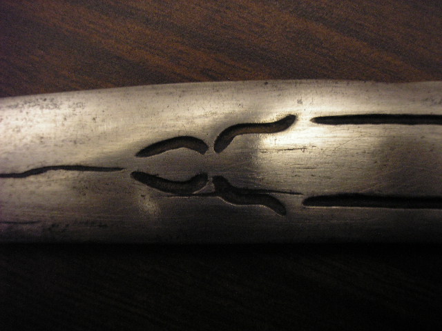

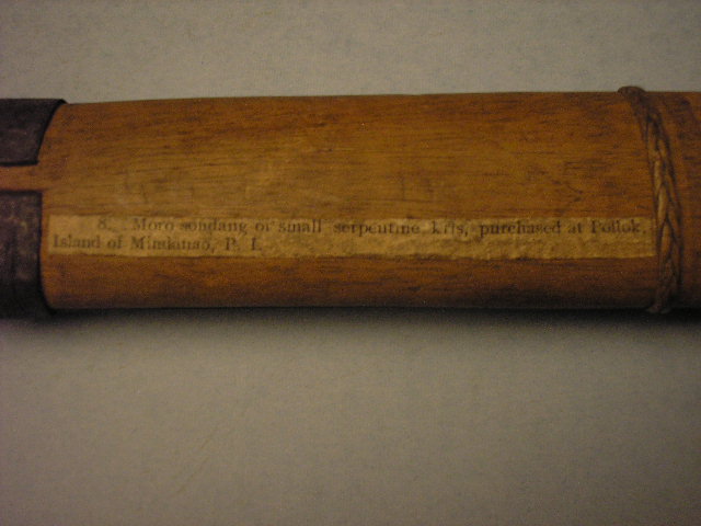

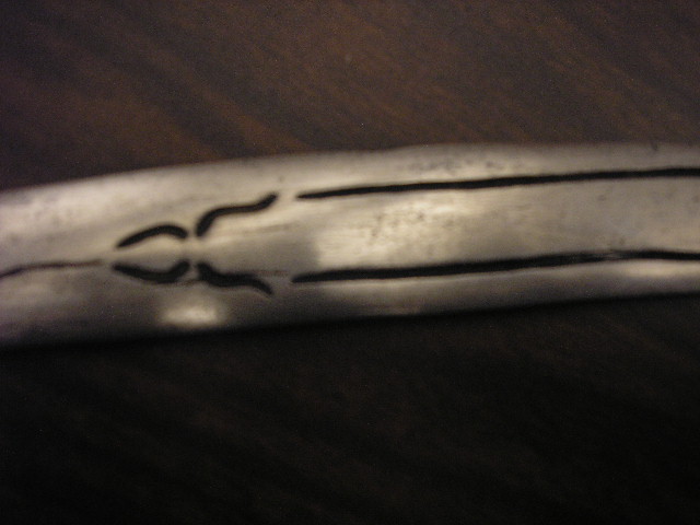

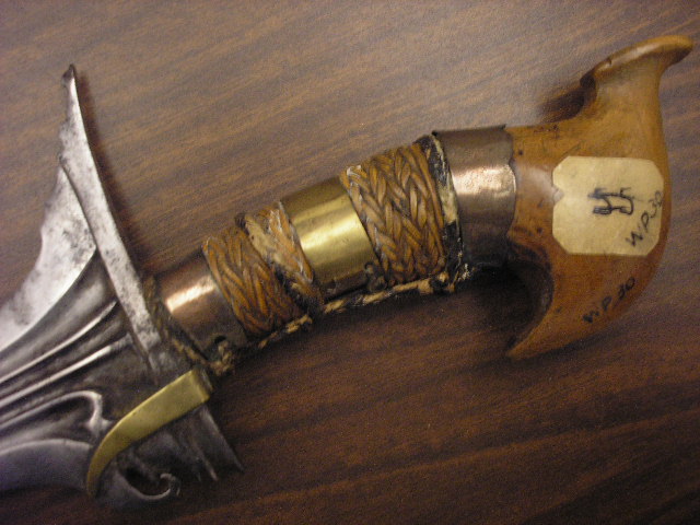

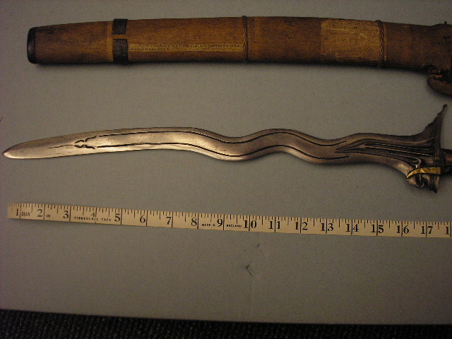

i'm posting a provenanced "archaic" kris that was purchased in Mindanao around december of 1899. the question would be, was this piece old (as in over a century old) when it was purchased? or was it purchased new? notice the how the black inlay is perfectly intact. btw, as a side note, there were other weapons that was purchased with this particular kris, including a huge Junggayan kalis and a gasah. i believe on one of the tags, it was stated that it was purchased in a marketplace. please understand though, that the officer that bought these weapons was one of the first americans that was sent by the Army to Mindanao to negotiate with the Moros, so it begs the question: if they bought these weapons in an open market, then who were the intended customers of these enterprising moros? it's hard to imagine that there would be lots visiting spaniards and filipinos from up north visiting these marketplaces...
anyway, back to the topic:
i did the hot water test on it and it does appear that it might be laminated. i might have to etch it sometimes in the future and will post it then.
