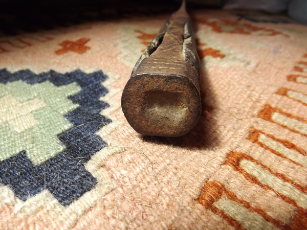

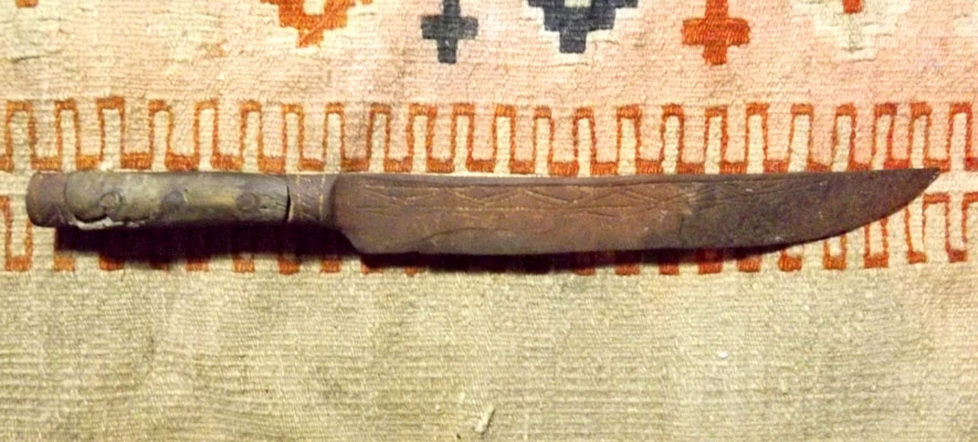

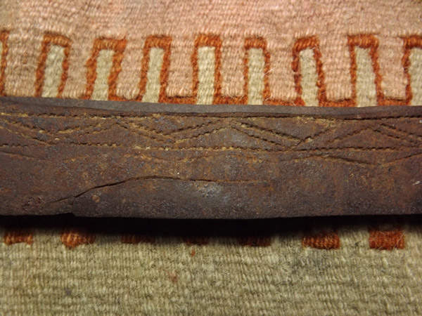

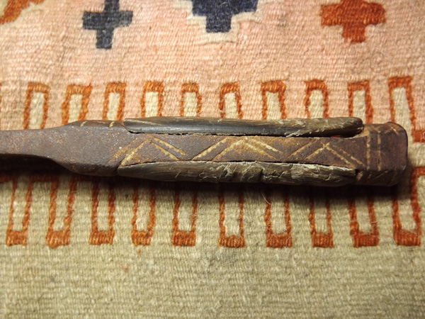

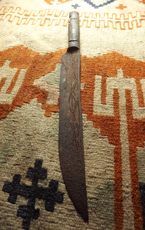

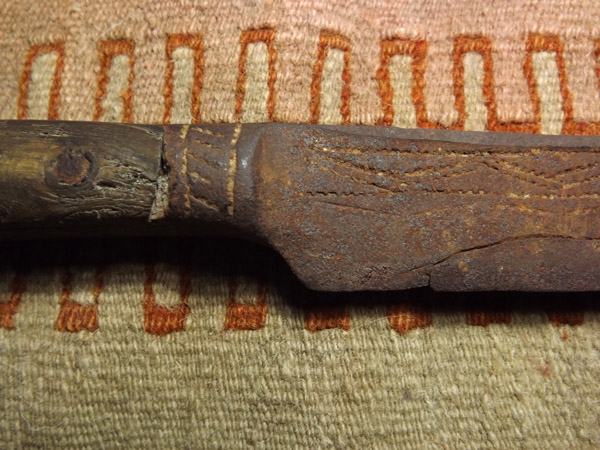

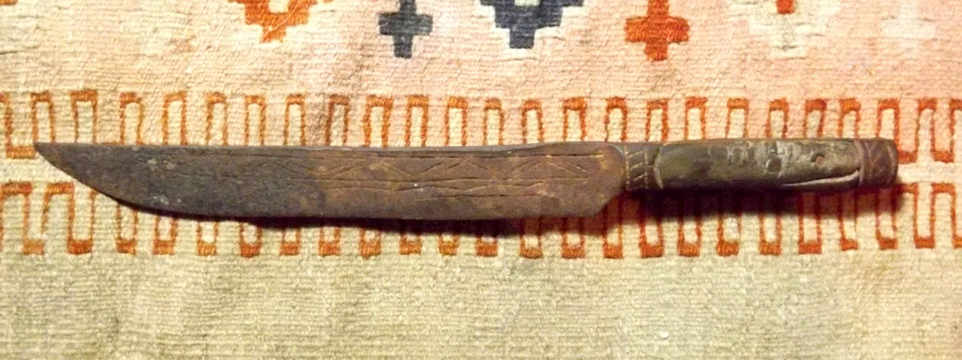

Hello, dear Forum Members.

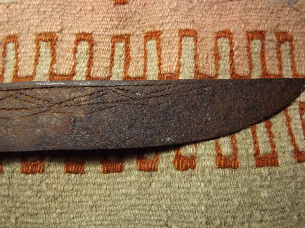

I recently aquired this knife, so I would like to present it to you. It comes from Romania, from the Northern part of Muntenia (Wallachia). I have not gathered enough information about it yet, I hope to do so in the near future. Anyway, as you can see, it is hand forged, no signs of file work, bone handle...I left it uncleaned, for now - there is also a question regarding the blade, that would be the presence of blood stains on top of it (different rust colour). The object was not advertised as being blood stained, I just developed a sensitive relation to this idea.
Lenght - almost 37 cm.
So, in short, a rather rare item around here - could be an 18th Century Haiduc's or peasant's weapon, rather than a regular soldier's...Still in doubt.
thank you
S.L.S.

SLS,
This type of knives are quite common in Bulgaria, and were probably quite wide spread from Wallachia to the Aegean. They are referred to as shepherd's knives, though I suspect they were used by all kinds of farm workers. I would definitely clean the blade to prevent it from further corrosion.
Teodor

Posts: 17

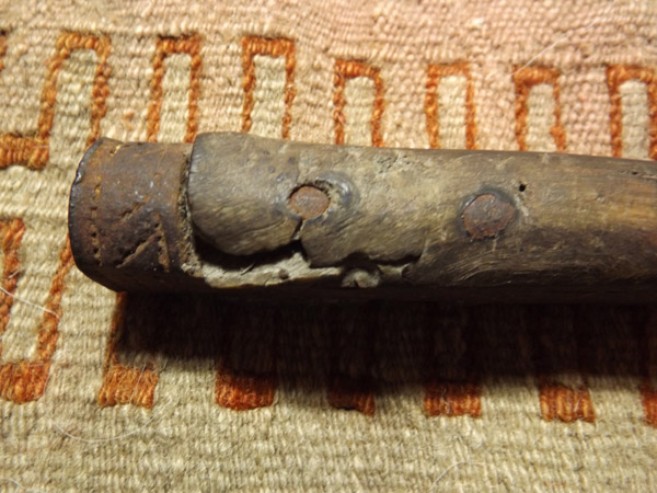

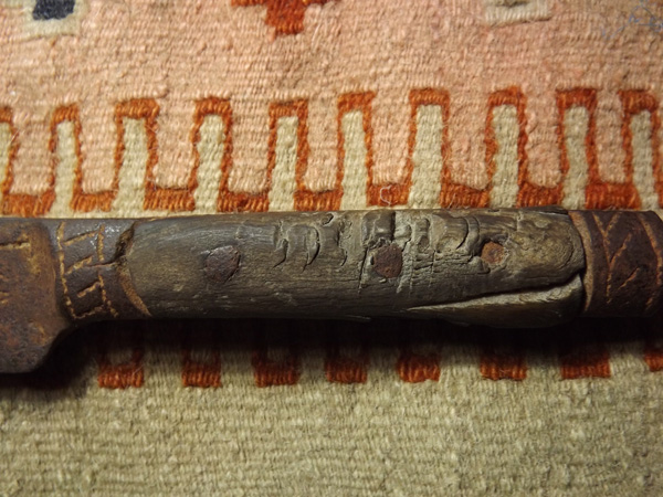

...what I forgot to ask, Teodor - the ”pommel” on this type of knife is different comparing to the bulgarian ones I saw, which seem to have a more curve, ”yatagan-like” hilt. Is there any way to trace the knife based on this thing? Its place of ”birth” and so...If, of course, we exclude Wallachia.
thanks, again

Sasa-Liviu,
Treasure hunter (the archaeologists do not publish such mundane items) finds suggest that knives of similar form and construction were used in the Balkans since at least late antiquity. They are certainly of a utilitarian nature and the massive pommel could be used as a hammer or pestle, for example for cracking nuts, etc. Since collectors and dealers (especially dealers) want to present these as shepherds knives, used by shepherds for self defense, one version is that the pommel was used for cracking open the skulls of lambs in order to gain access to the brain, a delicacy.
Teodor

Pommel in question could be used for smashing various things, no doubt about that . What interests me is the shape and its possible link to a certain place or period.

p.s.
As for the cleaning...well, there is a strong patina on the blade - I only removed the new/red rust and oiled the surface. I guess that would be enough for now.
