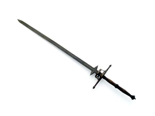

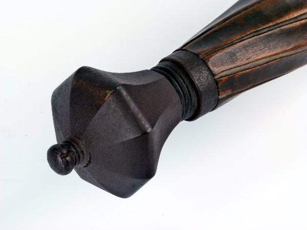

I inherited this sword from my father two years ago. He believe that it dated from the early 16th century. Some people have told me it is a ceremonial sword, others say it's Victorian era copy. Nobody seems to like the looks of the triangular flukes or how close they are to the guard. Any ideas?

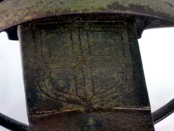

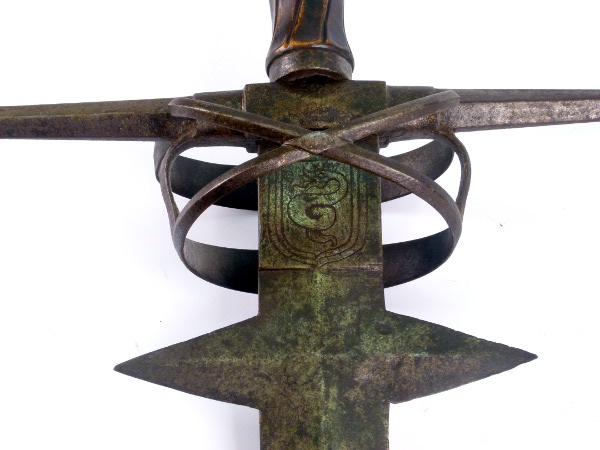

Below the guard on one side is the Coat of Arms of the Visconti of Milan. It depicts the Biscione, a serpent who appears to be swallowing a human, but is actually giving birth to it. On the other side is a St. George Cross.
Overall Length 63 inches
Handle 15 inches long
Guard 14 inches wide
Blade 48 inches long
Weight 5 pounds (approx)

This is a most interesting example of the two hand sword, and extremely attractive. It is not a 'Victorian' copy and the ceremonial term is broadly interpreted.This sword does seem to be quite well made with an apparant degree of age, and with the heraldic motifs as well as style it does seem quite possible to be a guards weapon most likely from Milan. As you have well noted the serpent is indeed the biscione (Milanese 'bissa')which is the heraldic emblem of the Visconti family. The cross in the shield is actually the coat of arms of Milan, and is known as the cross of St. Ambrose.
The two hander swords were of course used by German and Swiss landsknechts usually by the doppelsoldners, specialized swordsmen in the combat involving pikes and placed in front lines against these. After initial contact and as battle became closely engaged melee these huge swords were of little use, but were key in breaking through and destroying these deadly pikes. By the mid 16th century these were largely discontinued as combat weapons, but did become highly symbolic and visible in guard situations as well as in certain degree ceremonial.
The structure and elements of this sword seem well made enough for such purposes, and it does not appear to be a combat weapon. The flukes as noted are a bit unusual as they are a bit heavy, almost rudimentary in shape and are placed vestigially high on the blade near the ricasso and guard system, certainly not as on the earlier swords. Most of these seem to have typically had ring type guards rather than this basket type, and examples of the German and Swiss combat forms of 16th century seem to have had no ricasso on blade.
The pommel is faithfully represented, and appears to be of c. 1615-30 (AVB Norman, "Rapier and Smallsword" , 1980, p.257, #38) a truncated cone tapering toward tip with longitudinal flutes and prominant capstan. In examples of these two hand swords from Italy (Boccia & Coelho, 582-584) these are termed 'spadoni a due mani' and shown as c. 1600-10, with #583 having the same type pommel. The flukes on these are smaller and almost toothlike, while on others these are slightly larger but downward turned lunettes. The hilts are of similar form and some with the central rib bisecting the grip. These are quite finely made and not with the spiral wood grip, which suggests a later probably ceremonial guard type weapon.
I would say this, with these heraldic emblems and representations of features in the style of earlier weapons of these forms, it may be of 18th century or early 19th and from Milan. Certainly worthy of further and more detailed research, there are many possibilities given the complexity of geopolitical circumstances of these times and well into the 19th c. in Italy.

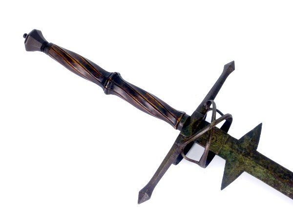

A rather elegant sword you got there, Dana.
You are right in that the flukes are too close from the guard, thus prevent the user from the option of holding the sword by the ricasso whith one of the hands, a typical feature in these swords.
I follow Jim's thought on its age. It looks like the biscione is not so aged. However, Jim ... this being an early XIX century replica, how do you distinguish its difference from a Victorian copy, when its period is about the same ... or not ?

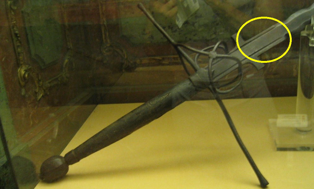

Fernando posted some photos of a ceremonial montante from the Lisbon Military Museum. It too has unusual flukes close to a basket type guard.
http://www.vikingsword.com/vb/showpo...6&postcount=13

I think that 99% of sword specialists will attribute this sword as a later reproduction.
Vicorian era or perhaps even later in the 20th century .
obviously given the fact that some unusual design features can be seen on this sword;
- Parry hooks of a less common shape and too? close to the cross.
- A cross counter guard which does not allow ricasso grasping.
- A uncommon spiral-cut grip.
This in combination with the Visconti coat of arms and st George cross make the twohander a stranger between the known.
my personal opinion and I'm fully aware that not many, probably none, will agree with me, is that this is an original processional sword from the last quarter of the 17th century, Italian and used (not necessarily made) in Milan.
My free- speculation is that this sword could be from the guard of Federico Visconti (1617-1693), he was an Italian Cardinal and Archbishop of Milan from 1681 to 1693.
This is pure speculation and ofcourse difficult to evidence.

... Fernando posted some photos of a ceremonial montante from the Lisbon Military Museum. It too has unusual flukes close to a basket type guard...
You are right Dana,
I was only reasoning as to give consistency to your mentioning that nobody likes the flukes positioning.
The sword you point out at the Mlitary Museum, Vasco da Gama 'ceremonial' montante, is a different variation in that, there is a portion of ricasso after the flukes, to possibilitate for handling ... a bit like the half sword styling, if i may say so.
I thank Cornelistromp for coming in with his opinion, which undoubtedly has a far more considerable knowledge in this area.
