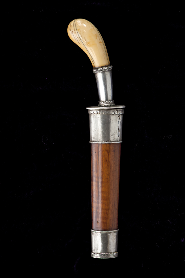

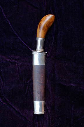

So....someone really needs to do serious research on these little fellas and write a good book...
Don't know why i never noticed the reverse hilt orientation on these two old gunongs. I have serious doubts that the hilts were ever replaced, though the old 19th C mexican silver dollar used as a guard on the one with the wooden pommel might well be a replacement.
Sooooo....were these made for a right-handed and left-handed user respectfully. Anyone else have gunongs with differently oriented hilts. I only have these 2 for comparison.

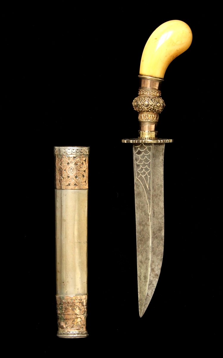

A nice and used gunong found in a Middle-East antique shop!

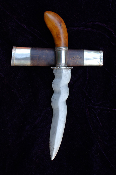

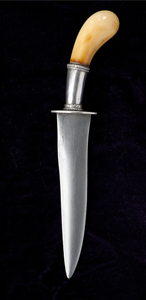

Here are the blades. The hilt orientation seems correct to me. I believe this is a matter of which side of the body the sheaths are oriented to be worn on.
Old 5th October 2012, 01:28 AM   #10
Posts: 7,416
Well the blades do show that they are not post 1940s. Nice blades, although I suspect an etch could show laminations.
