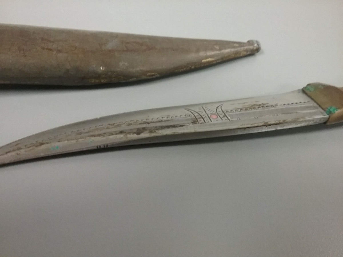

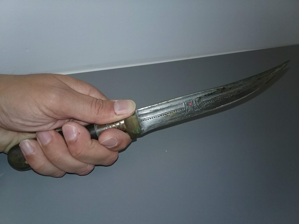

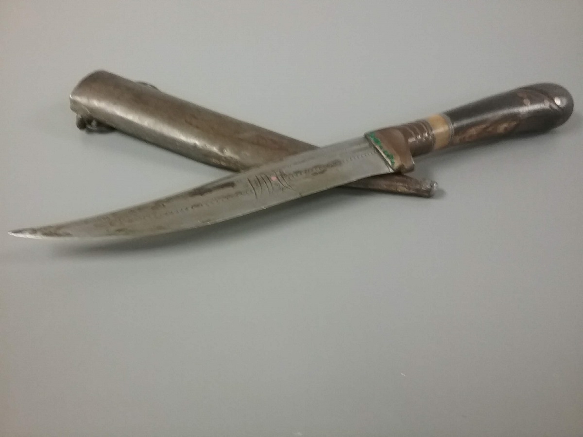

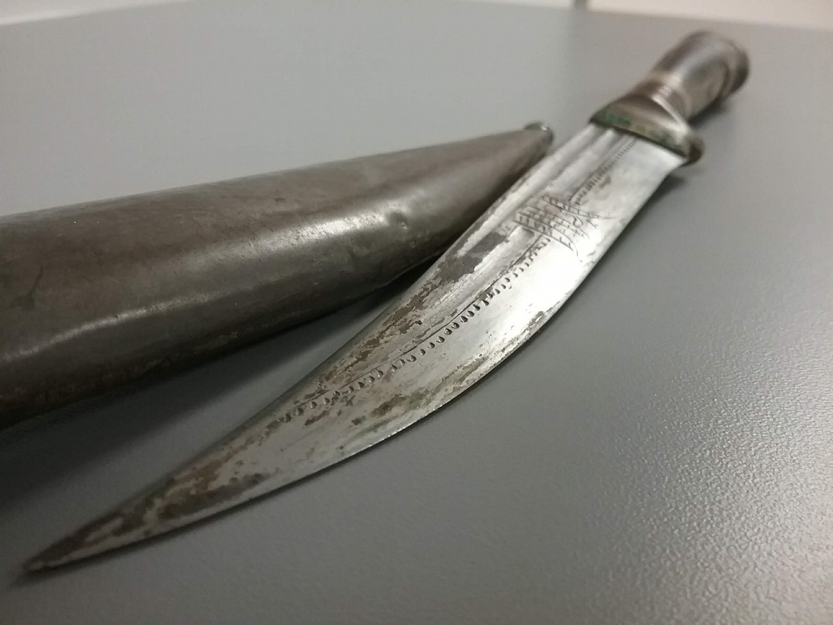

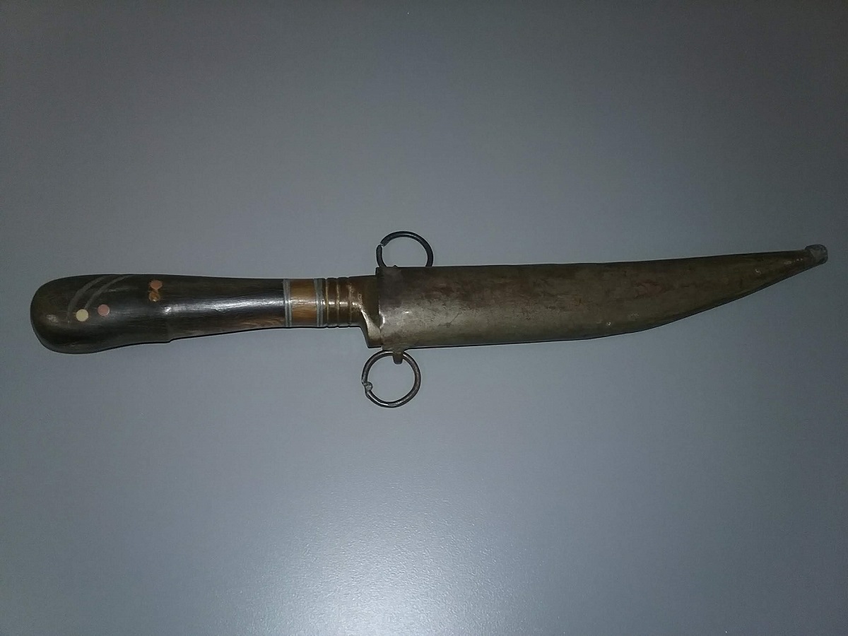

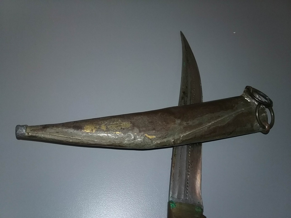

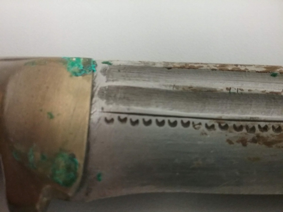

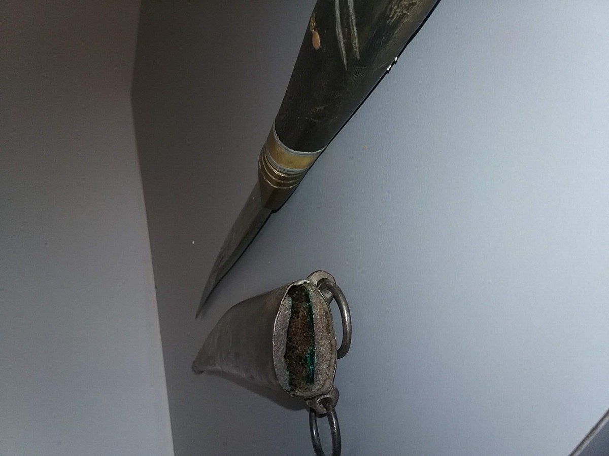

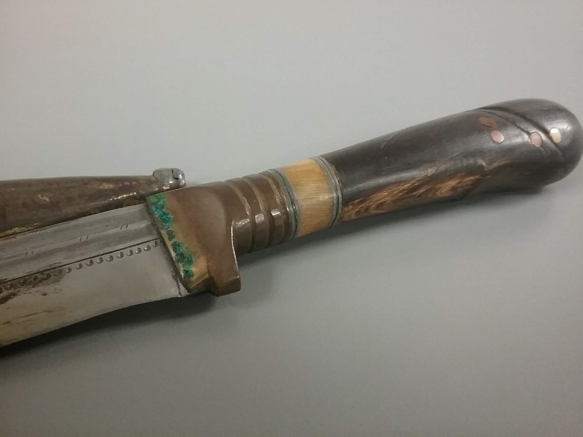

I just acquired this little knife. I nearly passed on it, because I first thought it to be one of the many Mexican Bowie knives produced in the later half of the 20th century. However, the ferrule seems more Central Asian, the sheath seems Middle Eastern/N. African, and the inlays on the hilt and blade...Balkins, perhaps? I even thought Ueghar, initially, but in now that I've seen it in person, not so much. Also, I just noticed that along the spine (barely descernable in the photo), there is an additional fuller. I feel I've only seen this in S. Asian blades (maybe Persian). By this, I mean a fuller forged into the spine itself, not on the blade face (see the 9th photo below)
I suspect someone here will know it immediately, and I thank you for taking a look and offering your impressions.
Thanks,
-Rob

To me it looks 100% Turkish.

More specifically, it seems more Syrian or Lebanese, both next to each other and within the Ottoman empire at one time.

To me it's 100% Syrian/Lebanese
with a strong Turkish influence of Surmene knives
check on our forum you'll see...

I would hesitate putting Surmene knives ( Trabzon area) together with Syrian/Lebanese patterns. After all, these are opposite poles of the country.

This definitely looks like a Surmene knife from the Trabzon area, and it could very well be one. But I understand the confusion.
There are some elements that look Syrian or Lebanese.

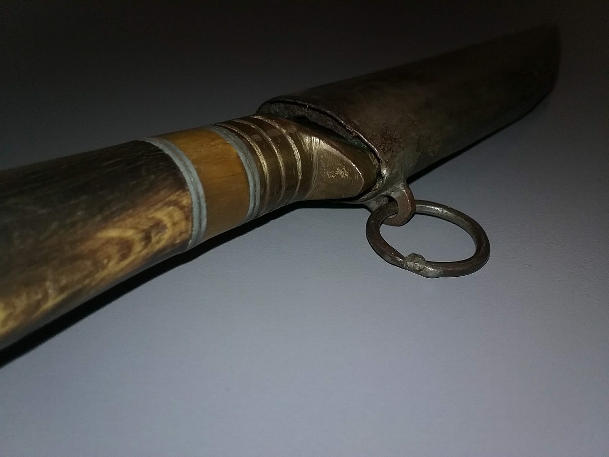

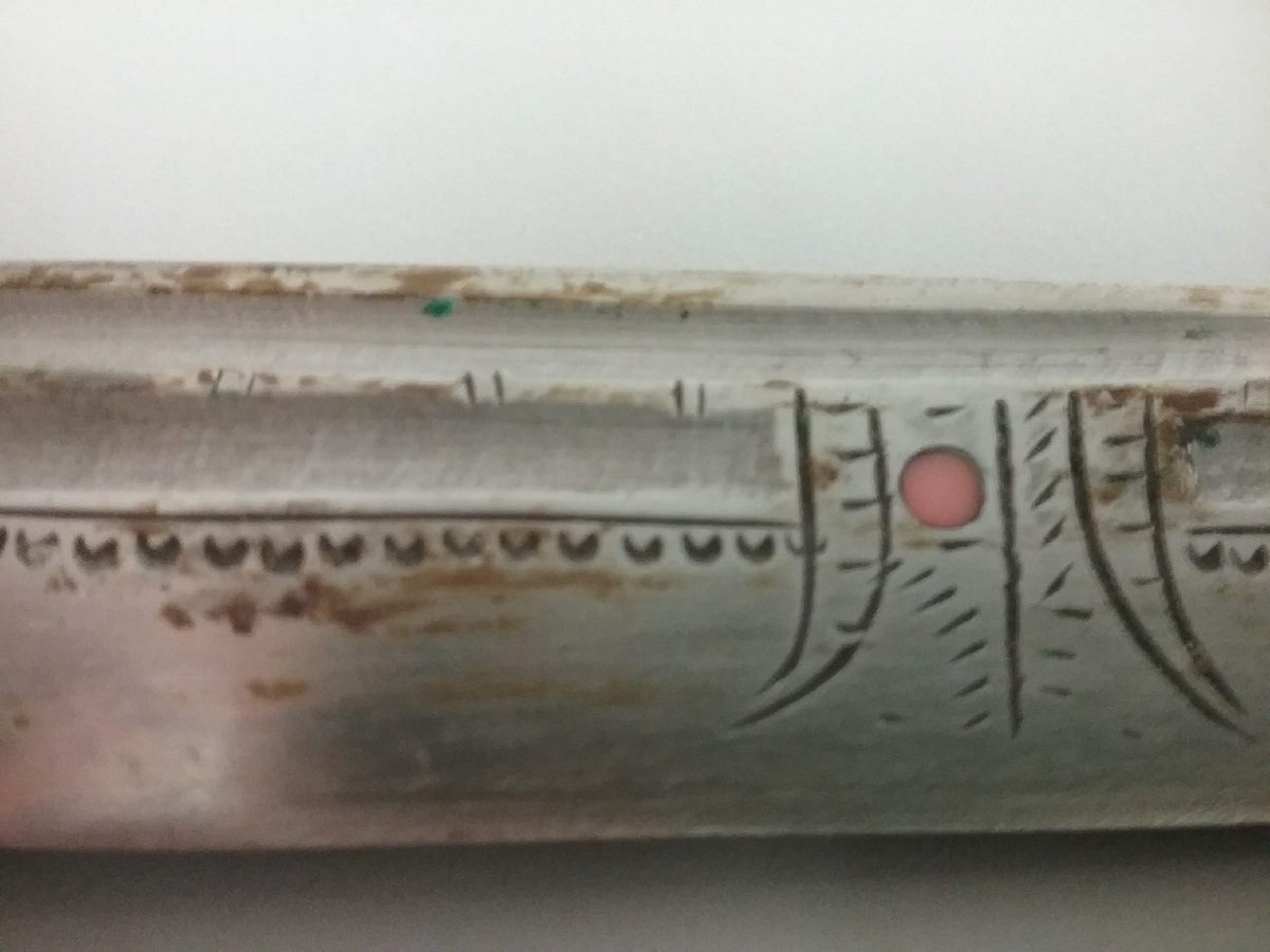

The quality and finish of Surmene knifes is usually high and the decoration is sparse, besides the intricate pattern of fullers. The blade on this one is of a bit lower quality, the fullers are shallow and the "red eye" is a Syrian, not Trabzon element. The scabbard also looks Syrian, and Trabzon knives have a leather scabbard, or leather with metal embossing.
So, where is it from? I can only guess. Syrian workshops were not very style-fast. The catered to everyone's taste. They made a variety of Syrian kindjals for Caucasian Ottoman clients, swords of different sorts for the Bedouin, like shamshirs and other sabers with kilij hilt, and many styles of daggers, both for real use as for tourists. I guess this could be a surmene knife made in Syria, maybe for an Ottoman subject from Northern Turkey.
