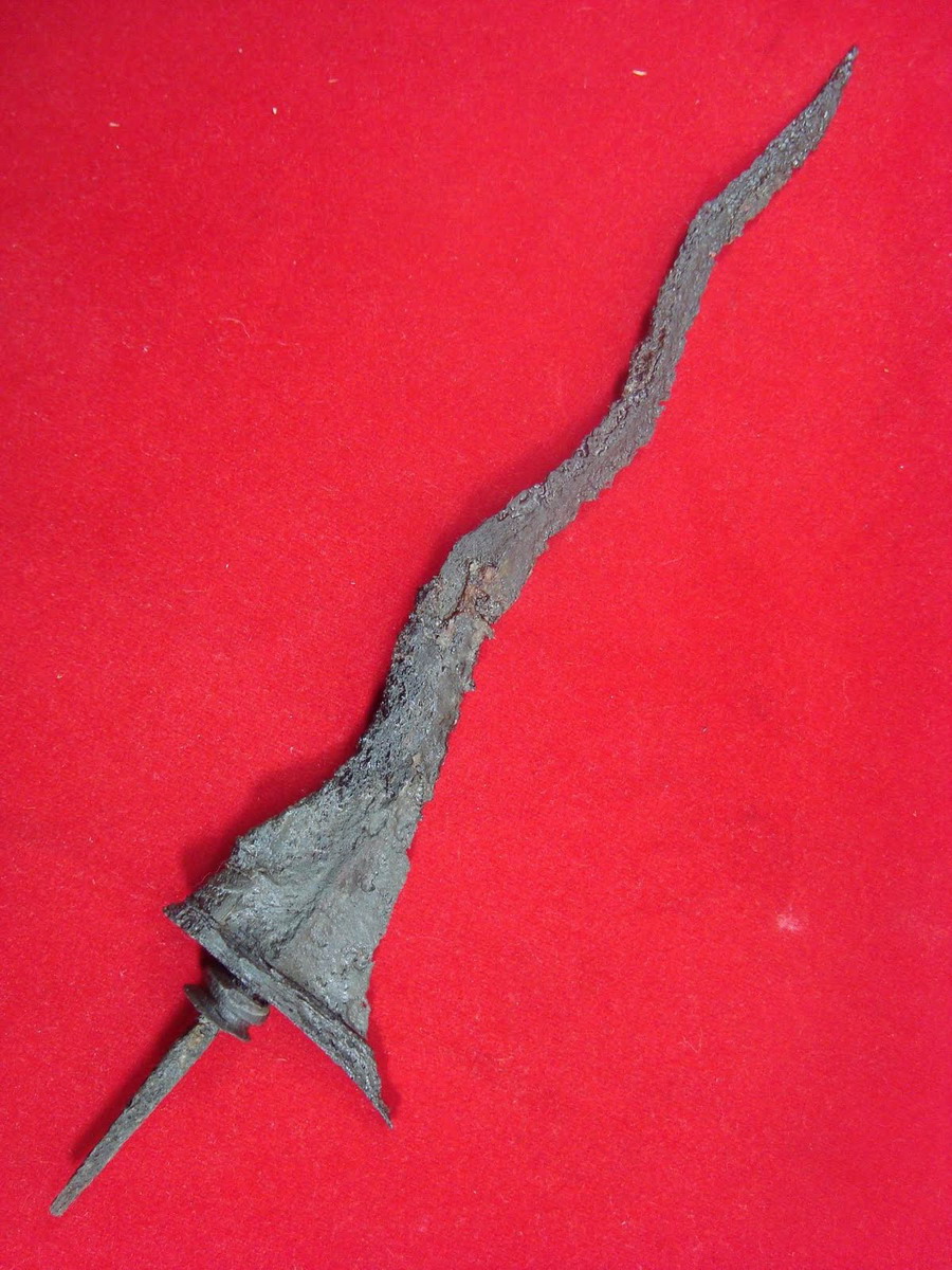

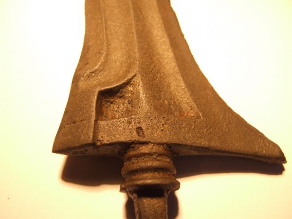

Hello all
now it's my time to ask for your help
I was offered this keris by friend of mine
it is said to be found buried quite deep in the remote village in central java, found by a farmer digging for well - said to be found in pair. Sadly the other is said to be corroded / damaged beyond restoration.
as from the texture of the metal, which already stone-like, this was judged as Singosari Era made
but I am not sure, as the degree of preservation is somewhat too good, even though the keris already lost section of landepan (cutting edge) in the forefront section
I haven't decide whether to purchase this one or not yet
your expert opinion is expected

Originally Posted by satsujinken
....but I am not sure, as the degree of preservation is somewhat too good, even though the keris already lost section of landepan (cutting edge) in the forefront section
Well Donny, let me first say that i wouldn't hold my breathe expecting "expert" opinions on this forum. We are pretty much all students here,albeit some more enlightened than others.
Personally i agree with you that the degree of preservation seems a bit too good for an iron object that has been buried deep in the ground for centuries. This keris form is often seen made by current age makers and artificially aged for an ancient look. Use your own discretion...

This is what we call a "Keris Buda", or a keris of the form that was present in the Buda period of Jawa, that is, the Javanese-Hindu period, both Early Classical and Late Classical.
This type of keris has usually been found buried, often with other objects of value, such as bronze statuettes or bronze bells.Sometimes one or more of the other objects will have corroded into almost nothing whilst one object will be almost untouched by corrosion. It should be noted that pure iron tends to be much less affected by corrosion than impure iron or iron containing carbon (steel).
However --- in recent years some very good reproductions of this type of keris have been floating around. For at least 30 years there has been a gentleman, and probably his son, working in the Malang-Singosari area who have produced very fine deliberate forgeries. When I say "deliberate" what I mean is that in this case the maker has set out to produce an object intended to deceive. Usually it is the middle men who turn perfectly good new keris into forgeries, but in the case of this type of keris, if it has been produced by these extremely skilled gentlemen, they set out to deceive from the moment they lit the forge fire. Even before, because they would have searched out the correct iron for the job, not such an impossible task in Jawa.
If this keris is genuine it should be very, very highly priced. Everybody who deals in keris and other antiques in Jawa knows the value of these blades. They do not come cheap. If this keris is relatively affordable it is very probably not the real thing.
It is absolutely impossible for me to give an opinion on authenticity from a photograph.
I do have a small collection of Keris Buda, currently 8 or 10 pieces, of which possibly two are not from the Buda period. I have seen and handled a lot more, and have focussed my attention on this keris form almost exclusively since the early 1980's.

At first, I should say, I never have seen a Keris Buda, only pictures of some examples.
This is the first Keris Buda depicted I see without sogokan of some kind. Or more accurately, all pictures of blades I have seen, which supposedly are genuine, do have sogokan.
As I understand, judging from pictures I have seen, the gonjo of a Keris Buda holds its thickness towards Buntut Urang, so the gonjo seems to be thicker then the blade at the end of Wadidang. Yet here I possibly have wrongly interpreted the pictures I have seen.
On this Keris there seems to be no such feature.

Gustav, there are KB's without sogokan; the sogokan came later, but before the appearance of the Modern Keris.

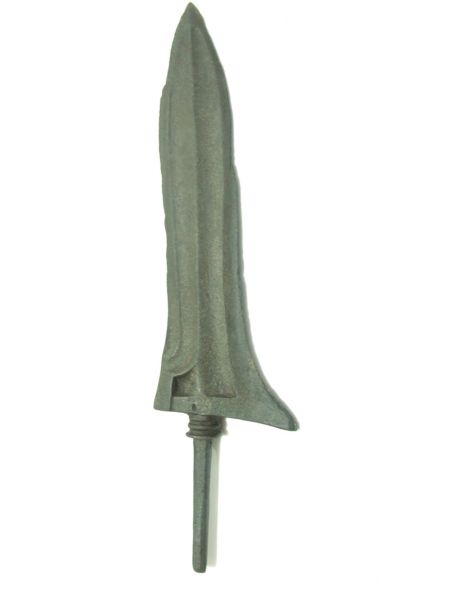

Default example of known singosari tangguh keris
in addition
this is what I expect in singosari era keris in terms of corrosion level compared to the age (around 750 years)
this one belonged to a collector, and known as Singosari era keris
luk 5, kelengan (without pamor) - or well perhaps the pamor is destroyed due to corrosion - who knows ...
and the odd thing is the peksi / pesi is squared (not rounded) - or my eyes deceiving me

I am not offering an expert opinion but just a personal but definite one about this piece: I cannot see any clue which would make me believe that is is an old and genuine piece (metal condition and aspect, shape of the blade, gonjo, pejetan, etc) . One typical example is the condition of the peksi which is still intact after being supposedly buried in the ground for centuries! I may be wrong but would not consider to buy it at any price....
And if you know M.M. Hidayat, please ask him his opinion.

I'm sorry Donny but it is absolutely, totally impossible for me to give you the information that you need by way of written words and pictures. It has taken me over 50 years to gain my knowledge through hands on contact with keris and hands on training from masters. I cannot pass this on in the way that you might like.
My best suggestion for you is to find a knowledgeable person or persons in Jawa who can teach you.
You're right there, on the ground. You're in Surabaya, where much can be learnt by somebody who really wants to learn.
I had to travel back and forth from Australia and spend more money than I can possibly estimate to gain my knowledge. You can get similar knowledge just by committing to the search and moving around in your own backyard.

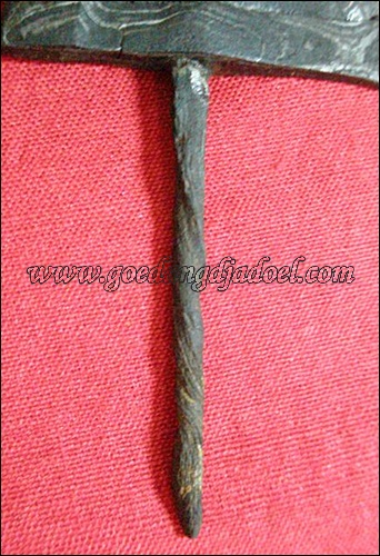

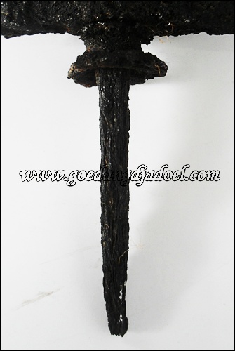

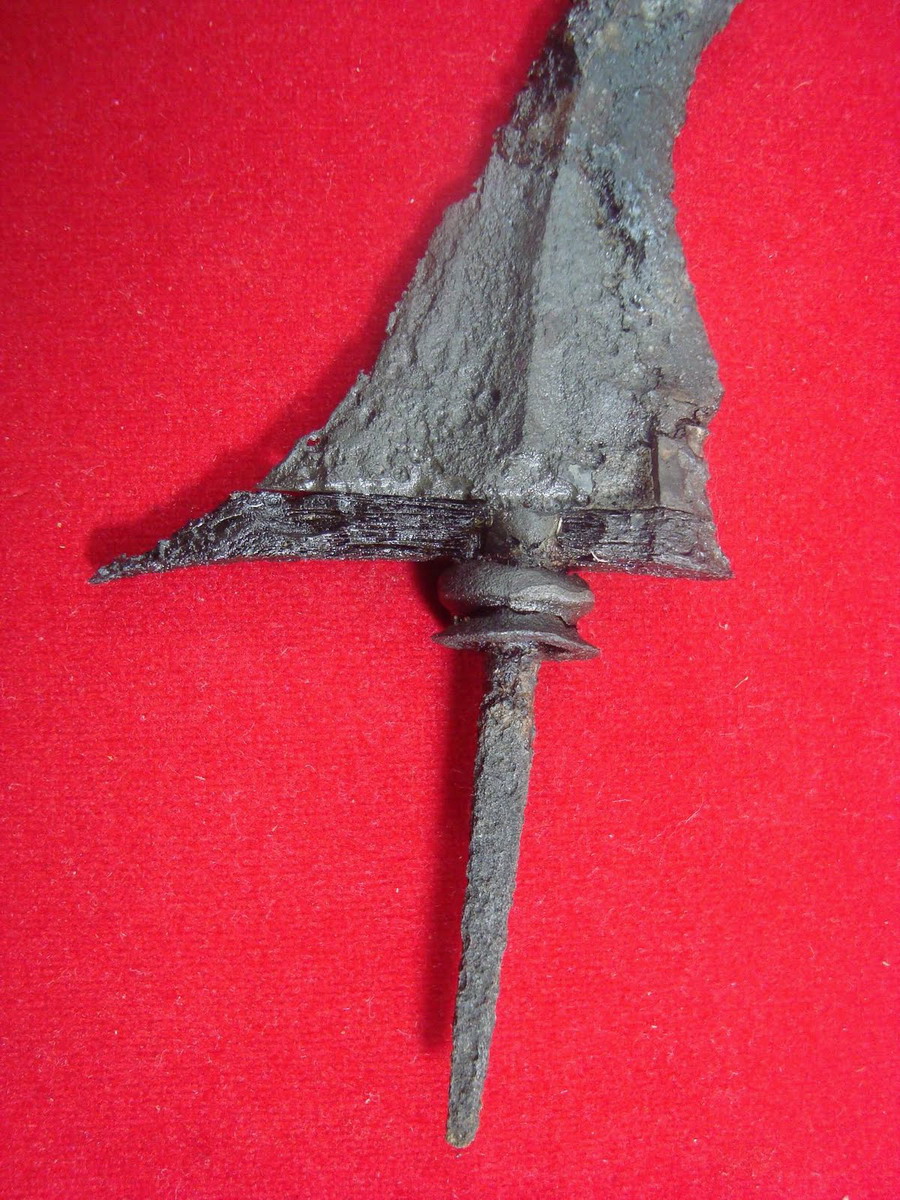

OK back to the point, I would like to ask you about one characteristic of older blade my friend told me last night
feel free to correct me on this one
there are 3 shapes of pesi : rounded, rounded and spiral-like, and squared (kotak)
squared pesi are from old blade, very old blade
spiral-like and rounded are common and from younger blade
is it true ?? can the shape of pesi be used as one of main factor to determine age ?? is there no younger keris with pesi kotak ?? (squared)
photo below taken from various sources, and only served as educational purposes - I have sent email to the owner asking for permission to use his pictures for educational purposes and as courtesy, I put the link to his website : http://goedangdjadoel.com/2011/12/keris-jalak-budho/
1st photo from Jalak Budho keris, the owner said that it is genuine Singosari era, and honestly that's what I thought seeing this keris ... looked like something you dig up from the ground - and has been there for centuries
2nd photo showing the keris' pesi (squared), or kotak in Indonesian terms

4th photo showing spiral-like pesi
satsujinken is offline   Reply With Quote
