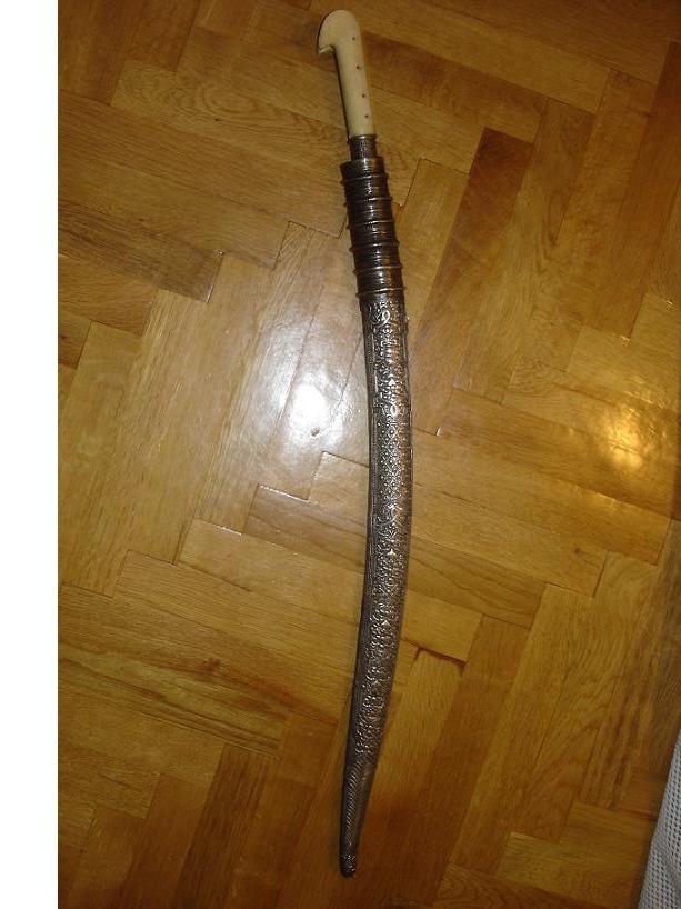

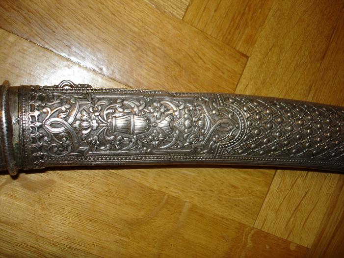

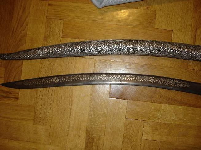

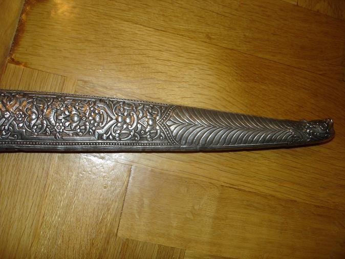

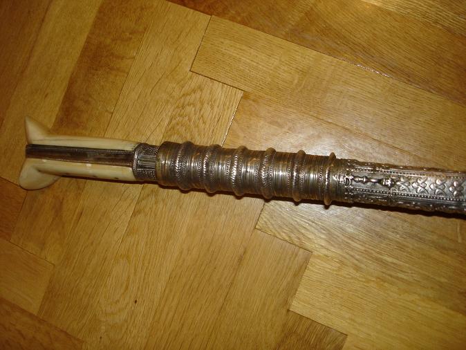

Hi.I acquired this yataghan recently. silver scabbard, walrus hilt and both sides silver inlay. length 83 cm. Has 1215 ( 1799) as date. can anybody translate the Arabic inscriptions please?
regards
erlikhan is offline   Reply With Quote
Old 28th November 2005, 04:32 AM   #2
Posts: 7,407
Impressive. The silver work is in great shape.

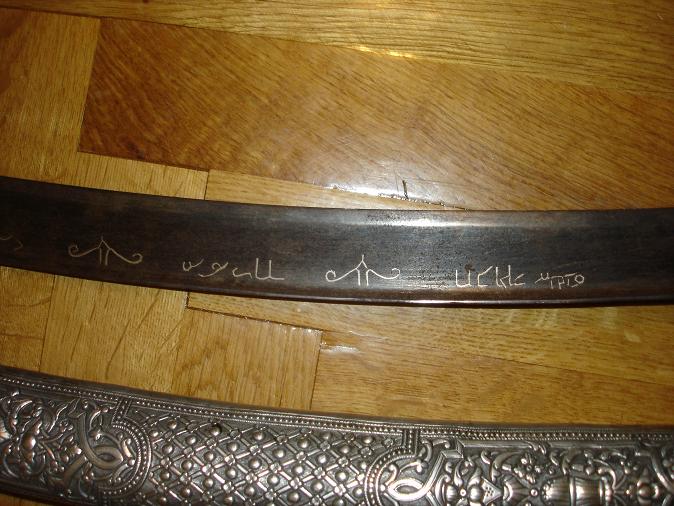

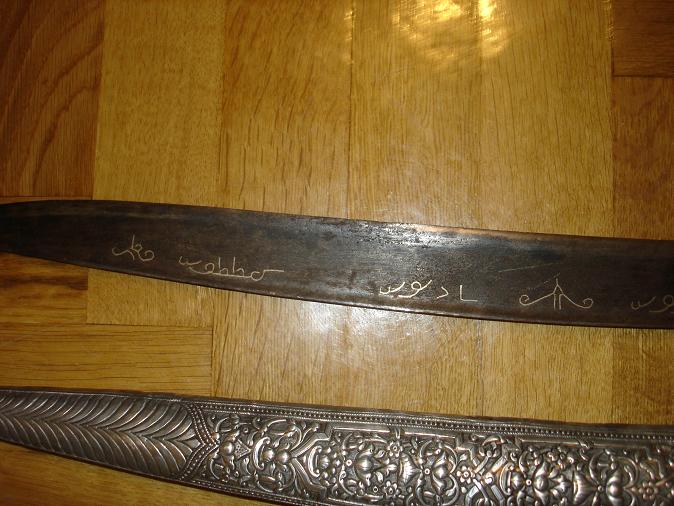

Hi
on the first pic (from right to left) the date seem's to be 1315 more than 1215, anyway the hegire 1 is 622, either
1315 + 622 = 1937
1215 + 622 = 1837
but 1799 ??
the first group of letters could (?) be "Ali", the (?) because it's arabic alphabet letters, but without clear meaning,
the second group is not letters, just signs without arabic relation
on the second pic, all signs are not arabic letters , even if their design seems to be oriental
anyway, this yataghan is really wonderfull
à +
Dom
Old 28th November 2005, 07:47 PM   #4
Dom,
You need to use conversion calendar: Islamic year is lunar!
Please check this:
http://www.oriold.unizh.ch/static/hegira.html
1215 H= 1800 Gregorian
1315 H = 1897 Gregorian
Lovely yataghan: somehow reminds me of Greek/Balkan origin: handle, dolphin, silverwork...

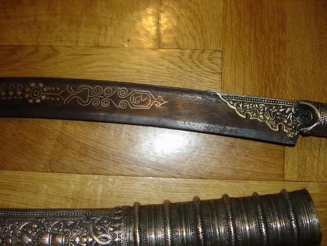

hi. I think Islamic calendar is not calculated so,we can't just add 622 to find the matching date in the other calendar. it differs around 11 days every year compared to Gregorian. otherwise it would be very easy
The discussed number on the sword has two tips going upward, if it was number 3, it should have three tips. it is carved quite crudely, thats why you think it is a "3" I guess. if it is 1215, it means something like 1799 or 1800 for sure. in 1890s-1900s nobody was making yataghans anymore. Which picture do you mean by "the second"? The second one containing silver inlaid figures, from up to down? Yes some of them are oriental decorations but, you think none of them are Arabic letters?
regards

In one of my books I have found a way to make the calculation.
1221 AH. 1221*0.97+622 = 1806.
Hope it helps.

Jens, I know 1293 means 1877 as a certain date from the history, and went back accordingly to find something like 1799-1800 but I am not so sure after your correction. I hope there is somebody to say it exactly. Tim, it is from today's Turkey or its surrounding countries of former Ottoman empire,I guess Balkans if not Turkey. But the silver inlaid figures look Central Turkey,as I have seen several samples with the same style offered by local dealers from that region. They can be original to the blade or later, that I dont know, but I dont think they are after the 3rd quarter of 19 th c. I would like to know the translation of the inscriptions to have more accurate info. The hilt must be walrus, as the cracked-loking known structure of the walrus tooth core is seen in the inner parts.

In addition to the site I've mentioned above, here is another one to convert Islamic/Gregorian dates with optimal precision:
http://www.rabiah.com/convert/convert.php3
Remember that checking both Month 1 and Month 12 is important: the dates within the same year of one calendar may fall into different years in another.
I added those to my Favourites and have been using them extensively: very easy.

ariel, thank you very much for the information.i missed your first post i think, perhaps you sent it while i was busy with mine. i see it just now. right, the 1st and 12nd months are confusing. I have a dagger which is dated 1700-01 instead of 1699-1700 . I would like very much to be able to say I have something from the 17th century .

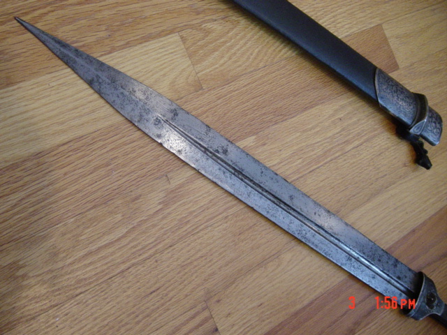

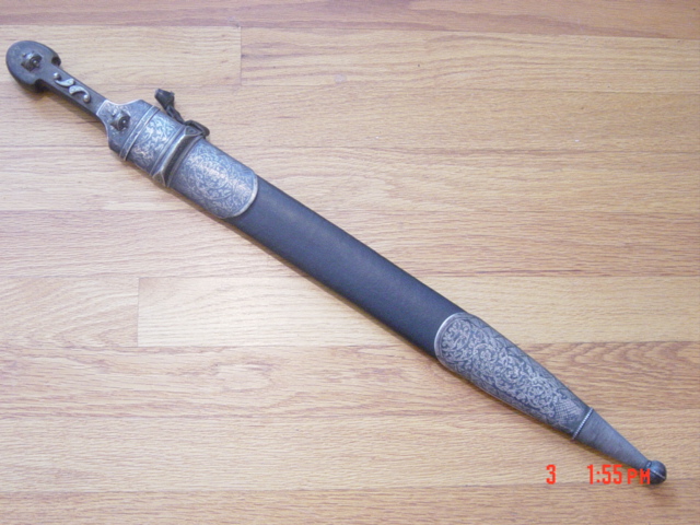

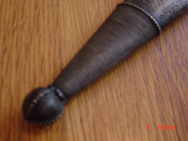

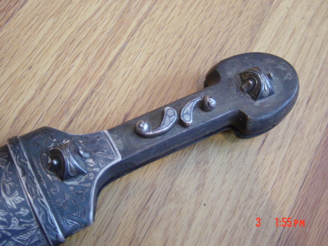

Here is my Kindjal as promised. Couldn't photograph the markings but you have to believe me: 1181H. The leather is new, the rest is original and in a very good shape. I do not want to polish the blade for fear of removing the markings.

I have been thinking about the origin myself...
The best would be to read the armourer's mark on the blade and I shall try to find a translator ( afraid, there are very few Chechens around here, though...)
The form might be of help:
Circassian kinjals wer smaller and narrow-er ( except for Shapsughs', but those were shorter). Daghestani/Chechen kindjals had better silverwork, but that was after Shamil; The Great Leader favoured simple iron. The ornament has nothing to do with the traditional Avar/Chechen/Daghestani motives: too simple .
I would stick my neck out and say: Georgian. They had blades of any kind, and 3-rivet handles. Flimsy evidence, to put it mildly, but I can't do better than that. Why couldn't the bugger sign his name on the scabbard??
What do you think?

1. I don't know if I understood you correctly - there is a mark on the blade, and it is not in arabic ? You suspect it's in chechen ??? I can have it translated, but I am really puzzled by this fact.
2. IMHO: it's definitely not chechen, most likely not dagestanian. I've seen too few circassian kindjals to say anything (I heard many times about shapsugian wide kindjals, but never seen one). Definitely not armenian, and not osethian. Georgian ? There is however one thing - we can make our judgement based on XIX century styles, but I don't think we have an extensive knowledge of earlier kindjals (I don't remember any pre XIX century kindjals in Astvatsaturjan). It may be that earlier niello was indeed more primitive than super-elaborate XIX century styles.
I would really like to see this mark you refer to.

Posts: 190
Gentlemen,
Actually, this is Chechen work. Culturally, the Chechens were more closely associated with the Cherkess-- their belief in Nart cosmogony stands as evidence for this. Due largely to geography, they were often politically aligned with Daghestan during the 19th century. As a result, their decorative repetoire could include the entire range of Circassian motifs but also drew on Daghestan styles as well. Sparse engraving and use of niello and gilding were found side by side with extensive engraving, chiselling and large, complex areas of niello.
After the Murid Wars, and increasingly into the early 20th century, Chechen work was also distinguishable by a sometimes random combination of these styles, with no particular one prevailing-- sorry to say, as time went on, the workmanship was rarely equal to either of its cultural ancestors. The motifs on the scabbard and lower grip mount of this kindjal are a simplified "spiral vine" often worked in fine relief by Kubachi smiths. Here, it has been deeply engraved into the silver and heavily embellished in niello. Unfortunately, neither the grip buttons nor the central decoration assist in establishing a place of origin as they are all associated-- the buttons from a belt and the central ornament from a horse trapping. This however indicates the paucity of materials in early 20th century Chechnia, and the desire to maintain traditional motifs. It is typical of Chechen weapons which survived the Revolution and First World War.
The grip of this dagger is also closely derived from a particularly popular Kubachi type usually rendered entirely in silver, ivory, or a combination thereof. Great store was set by heirloom blades, hence the appearance of an early date on the blade of the kindjal under discussion is not incredible though the mounts clearly postdate it.
Caucasian arms, perhaps more than any others save Indonesian, require a great deal of study of individual examples in order to begin to be able to categorize them. The Russian and Turkish museums afford the best selection for the serious student but can be difficult to gain access to. The works of Mrs. Astvatsaturian and Mr. Askhabov are likewise invaluable and now, thanks to the internet, generally available.
Posting an image of the mark on the blade would probably be very helpful.
Sincerely,
Ham
ham is offline   Reply With Quote
