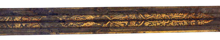

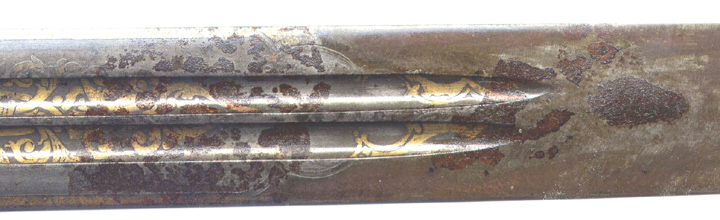

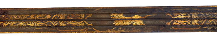

Hi guys. Just wants to share this beauty with you. It is a straight blade sword (GURADE or SEIF) made by Wilkinson. The scabbard did not come with the sword, but it fits quite nicely. The blade must have been just superb in its original condition. Unfortunatelly some of the gilt is gone, though there is lots left. As you can see from the last picture, there are what look like blood stains (???). Does any of you know how to remove them without damaging the gilt. ROANO

If the blood stains don't rust any further and damage the blade I would leave it and just oil the blade. The real proof this beauty was used in battle.
Old 3rd December 2005, 08:50 PM   #3
Posts: 6,000
Where did the scabbard come from? It looks almost made for the sword, many a dealer would pass it off as so. As to cleaning the best advice is very carefully what is the stain? is it rust? you cannot get rust on top of gold. Will bits push off using a blunt scraper like a butter knife. You might have to leave some of it on the gilding and just clean around it. To me it looks that it just needs some oil rubbed in with the very finest grade steel wool . Tim

On the spots away from the gilt, I would use a fine steel wool. The areas near the gilt use bone or antler and pick away. Use lots of time and WD40.
All the Best
Jeff.
