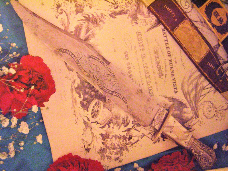

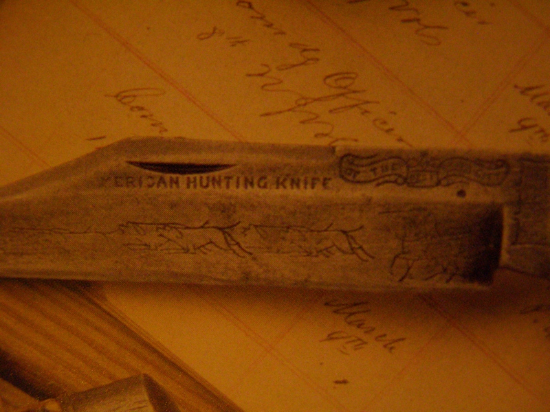

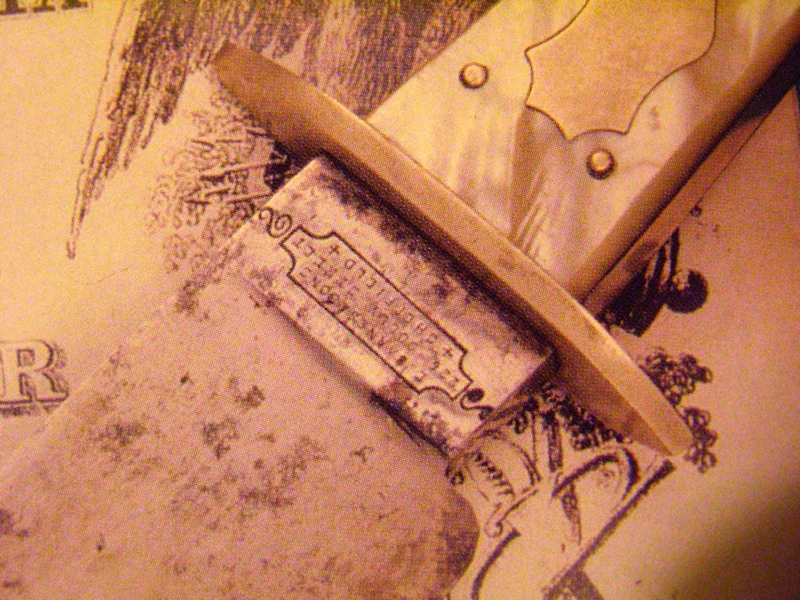

The examples listed by Chris. for further study. {Some hotlinked as originaly posted in the blunderbuss thread.}
Strangly {img} tags dont work on the ones actualy posted on viking sword, how does one link to those I wonder?
