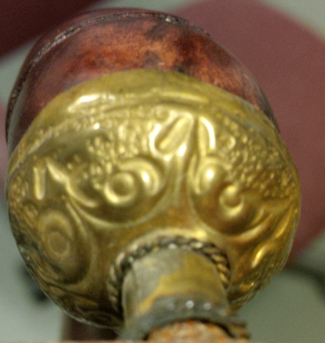

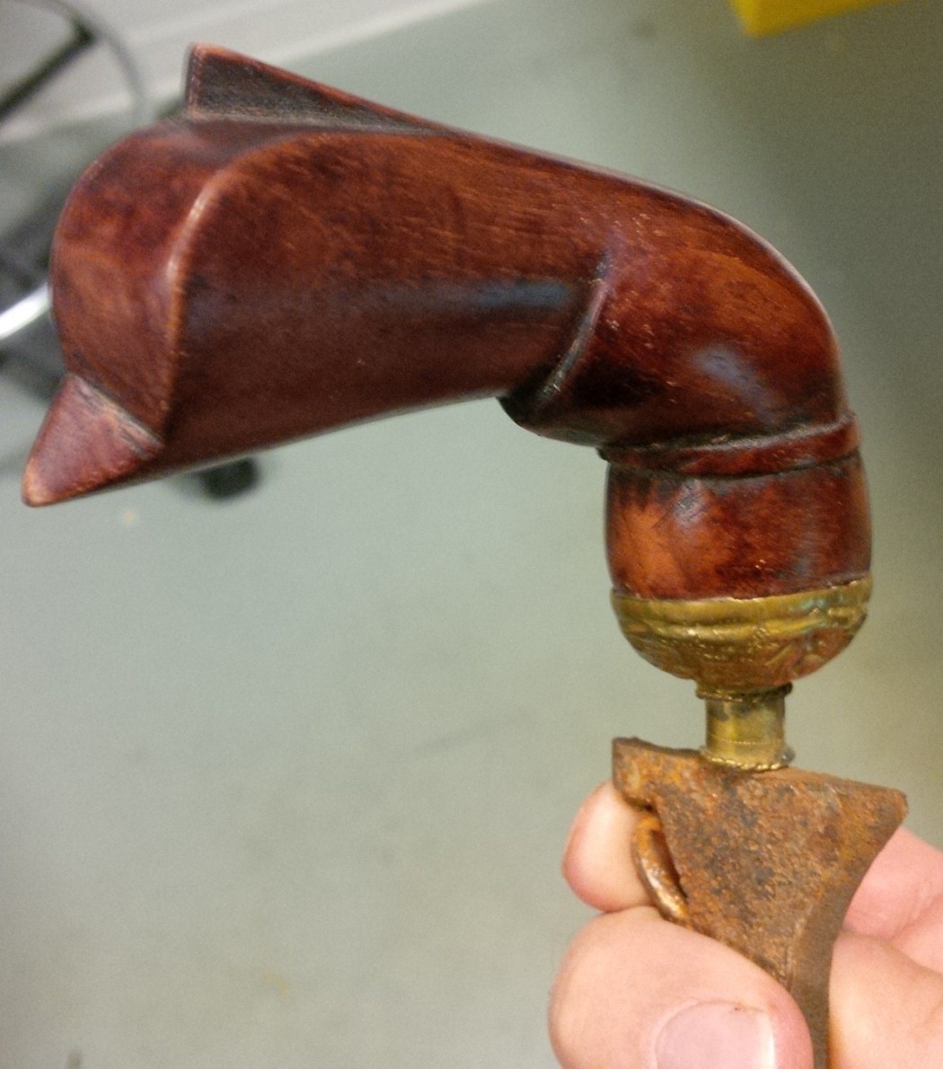

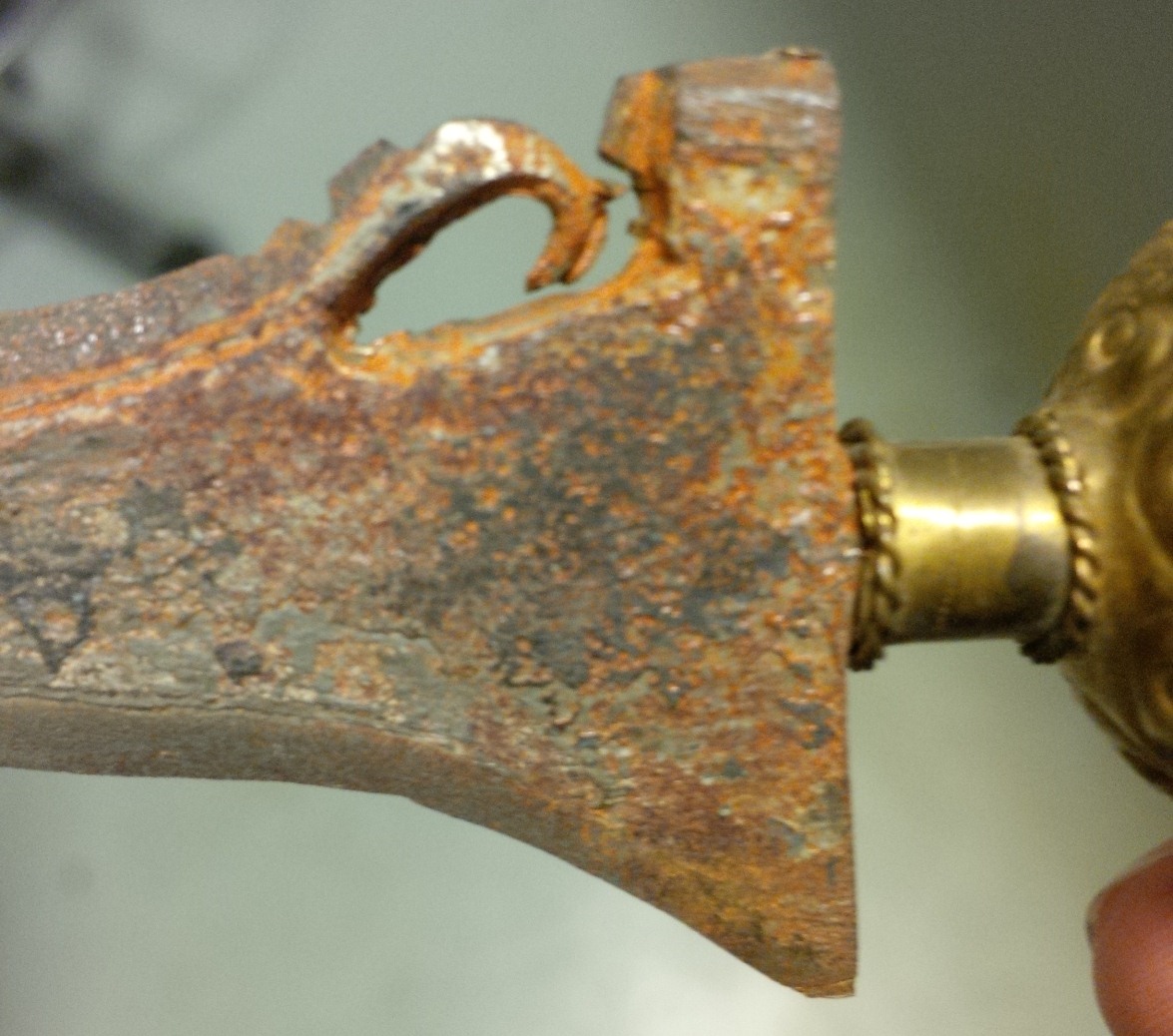

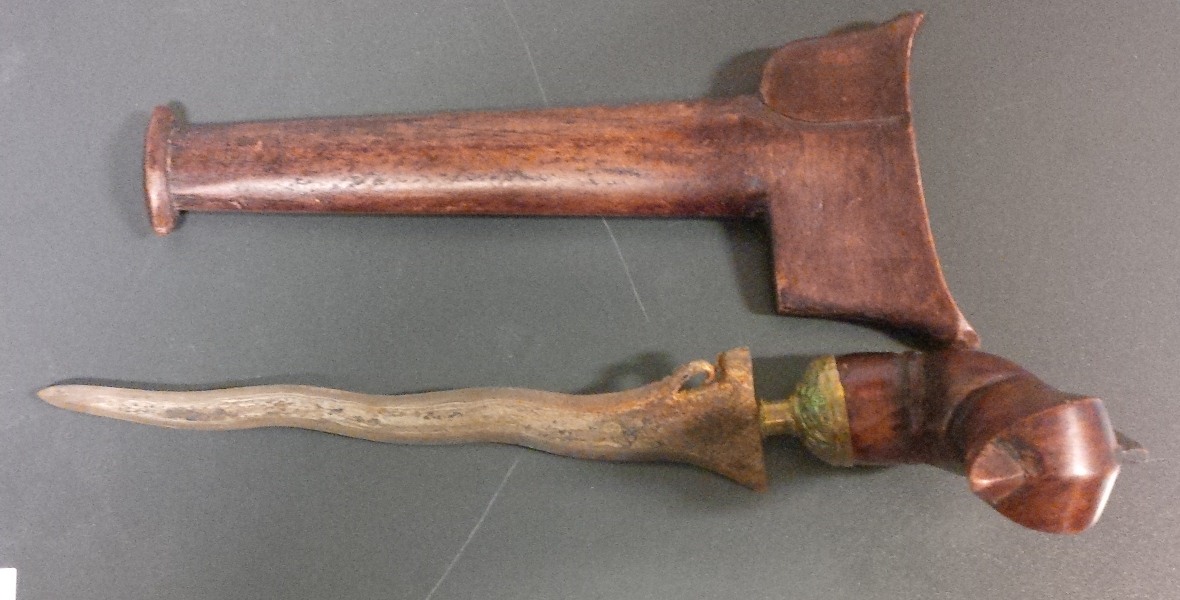

Okay, here's my final junk e-bay keris I promise. I guess this one is Bugis style, the blade is about 7 inches long. It has a little pamor, but it's quite rusty. I'm going to dunk it in coconut milk for a week and see if that loosens it up. I like this one, it isn't quite as tacky as the others.
I guess my only question is modern tourist piece or vintage tourist piece?
Old 21st November 2013, 04:42 AM   #12
Posts: 7,297
I think what you want is coconut WATER, not milk. Though you might have better results with either vinegar or pineapple juice.
