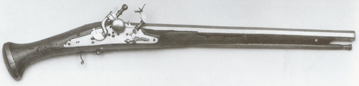

I bought this pistol in a street market ... no label and no ID.
The stock butt is very particular, but i don't know for sure where it comes from. I have been thinking it is Moroccan, possibly (wishfully) 19th century.
Any better oppinion or actual knowledge ?.
Thanks in advance

It is probably Moroccan. That type of snaphaunce lock is typical of that area (Algeria and regions to the east used "miquelet" locks of Spanish design, those characterized by a large external V-shaped mainspring and an "L" shaped combined pan cover and "steel". The snaphaunce of Morocco is derived from north European (Dutch and English) prototypes of the 17th cent.
The flare on the muzzle, and the almost circular outline of the trigger guard, are carried over from the familiar Moroccan long muskets, "moukahla".
I would recommend S. James Gooding's "The Snaphance Muskets of al-Maghreb al-Aqsa" in ARMS COLLECTING, Vol. 34, no. 3 (August 1996), pp 87-93.
The subject is also addressed, with illus. of exceptional examples, in Dr. Robert Elgood's FIREARMS OF THE ISLAMIC WORLD IN THE TAREQ RAJAB MUSEUM, KUWAIT, London/NY: I. B. Tauris, 1995.

Thank you so much Philip, for the excelent information.
Are the pictures clear enough to guess an age on this piece ? Could it be prior to the 20th century ?

Fernando,
Yes, it could be 19th cent, as well as early 20th. During the period in question, styles didn't change appreciably so without inscriptions, assigning exact date is difficult.

Looking closely at the pistol, I'd guess that the lock and barrel are from an earlier piece, and this is a replacement stock. I say that because of the quality of the metalwork on the lock itself, and the poor fit of the inletting into the stock. What you can see of the barrel is alos of finer quality than the workmanship surrounding it. So even if the pistol is 20th cetnury (which I doubt), I think the odds are that the works are older, possibly much older.

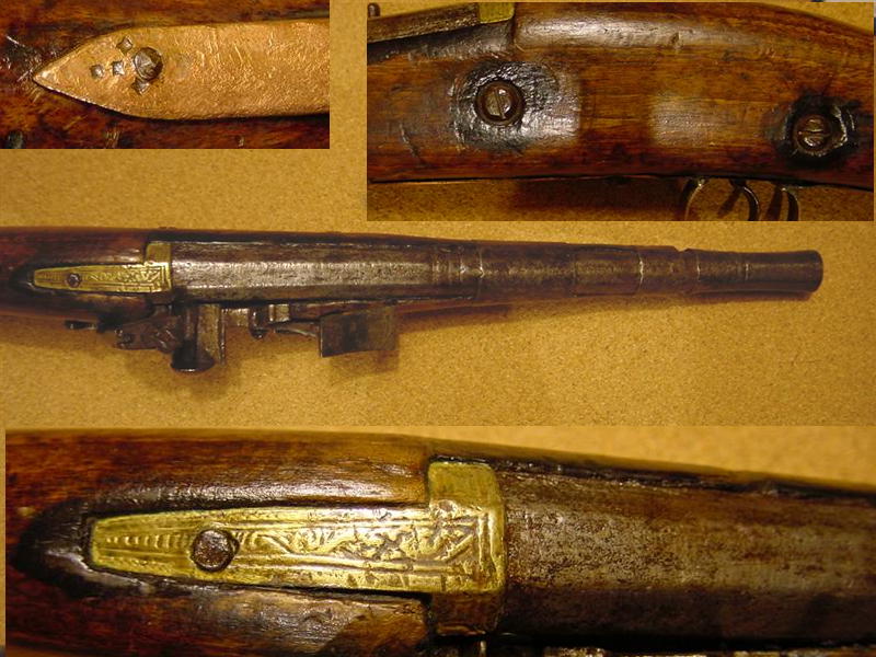

Old 28th January 2007, 08:31 PM   #8
Hi Fenris,
Thank you for your coments.
I can see your point.
Here are some more pictures of the barrel and other details.
You will notice the dark stains in the wood, around the screws and near the barrel. Would this mean this stock has seen some use, even having been a replacement to the original one ?
kind regards
Old 29th January 2007, 08:08 AM   #9
FenrisWolf
FenrisWolf's Avatar
Join Date: Jan 2007
Posts: 181
Originally Posted by fernando
Hi Fenris,
kind regards
Those darkened holes around the bolt heads bring up an entirely different possibility. Given the reasonably good fit of the inletting around the barrel and tang (as revealed in the new pictures), it's probably the lock that is the replacement, not the stock. Those large holes are evidence that originally there were bolts with much larger heads inletted into the stock. The snaphance locks changed very little over their lifespan, so it's not surprising that a gunsmith was able to replace an earlier one with a new lock. Snaphance locks, while a significant improvement over the much more fragile wheellock mechanisms, are still needlessly complex, with something like three times as many moving parts as a true flintlock. Given the number of weapons being converted from snaphance to flintlock, the gunsmith might easily have had a spare lock lying around, making it cheaper to replace the old lock than to repair it. Given the evidence of the bolt head inlets along with the rough fit of the inletting around the lock, that would be my guess.
