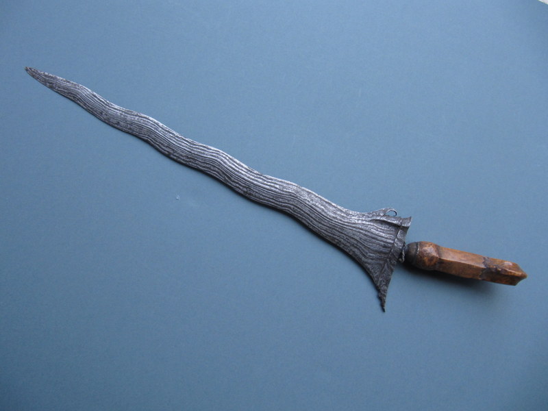

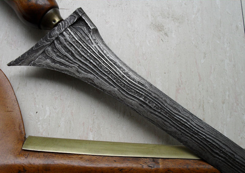

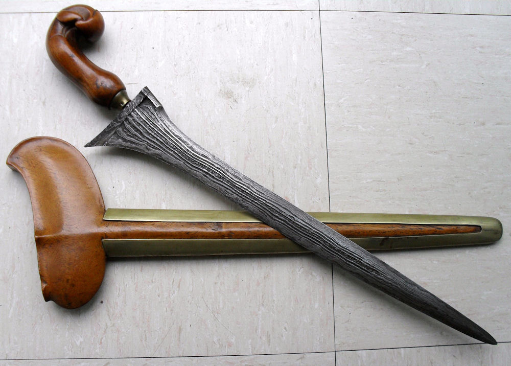

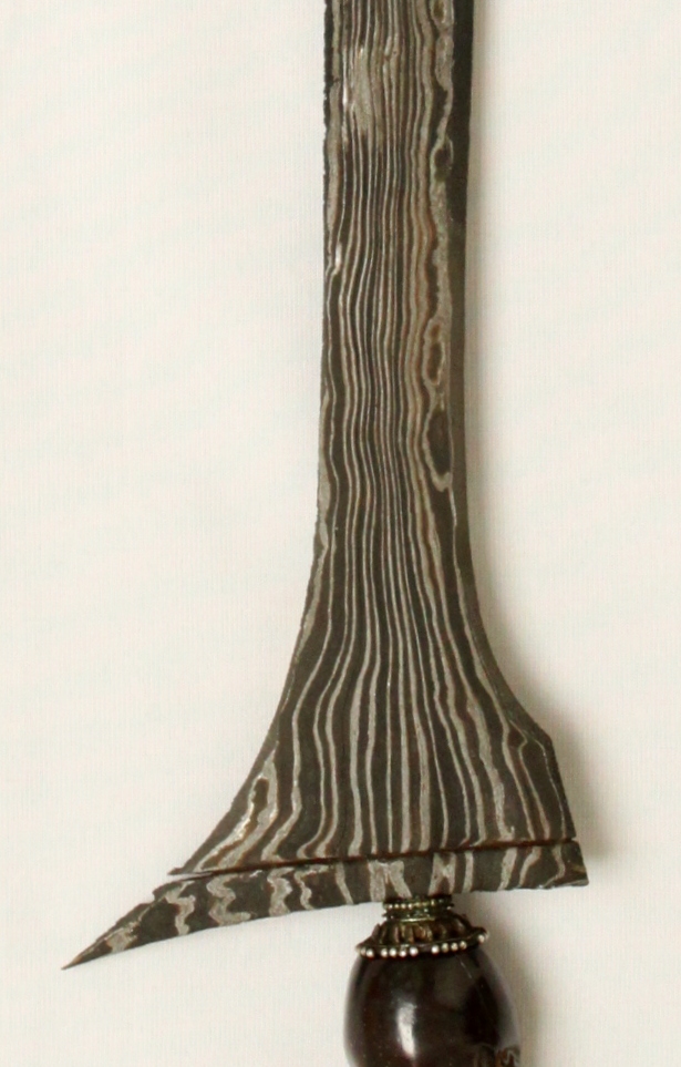

I find the form of this Keris very pleasing. Hopefully you can all tell me more about it:
Old 24th June 2012, 05:35 PM   #2
Posts: 9,761
Seems to be a East Java or Madura keris with pamor adeg. How is the fit inside the sheath?
Old 24th June 2012, 06:04 PM   #3
Atlantia
Atlantia's Avatar
Join Date: Jun 2008
Location: The Sharp end
Posts: 2,928
Hi Detlef,
Thanks for coming in on this one.
LOL, not a good fit in the sheath. How did you know?
I've not seen this shape grip or type of pamor before, are they unsual?
The pamor is like a river and the grip is like a sheeps head!
Best
Gene

Originally Posted by Atlantia
Hi Detlef,
Best
Gene
Hi Gene,

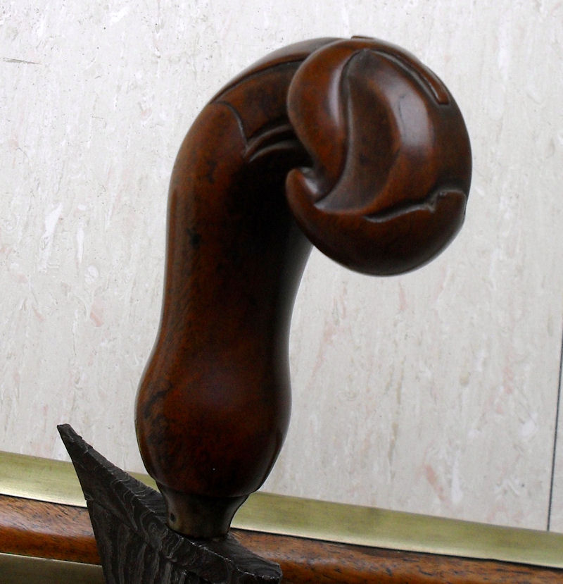

hilt is donoriko type from Madura, sheath like Chandra write is Central Java, by the blade I am unsure but think East Java.
Both are not uncommon to answer your question.
Like Chandra I think that others will be able to tell you more.

Posts: 7,217
I'm in agreement with what has already been said, but I'll add this:- we would name this pamor as adeg sapu (standing broom), and this one is one of the better ones I've seen, its well executed and well preserved, a nice keris.
The mendak is Madura, the hilt is unusual in its simplicity, the wrongko is a terusan (one piece).
All in all this is a very nice bit of gear.

Posts: 7,217

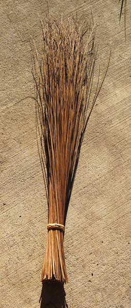

Gene, here is a photo of a Javanese --- or I guess Indonesian --- sapu lidhi:- a broom made from the rib of a coconut leaf.
Using your artistic eye, can you see a similarity between the coconut ribs that form the broom and the strips of pamor in the keris?

Posts: 2,928
LOL!! I must admit that I assumed such a well executed pattern would have a 'deeper' significance that that.
I do see what you mean though.

Posts: 7,289
LOL! Tough crowd!
Well Gene, i more than kinda like it...
Love this hilt btw. Simply and elegant.
Would love to see the blade in proper stain...

Thanks David,
I love the hilt, beautifully flowing and organic.
I thought the level of stain was ok, would it have been much darker originally?

Posts: 7,217
Gene, we don't really try to date keris in the way that you would think of time.
A collector in the western world will often try to attach a date to a keris so that it makes sense to him, but in keris culture in Jawa we don't date in terms of calendar years, we classify in terms of tangguh. There have been thousands of words written on this subject in this forum.
Briefly and simply tangguh is a system best applied to keris of very good quality; when applied to a relatively recent keris the determination of tangguh will often give an indication of a time frame that will make sense in terms of time as you understand it, however, the more distant from the present that a tangguh becomes, the less relevant that tangguh is to actual calendar years, until eventually you enter the realm of myth and legend.
It is very important to understand that the keris is embedded in belief systems, and these belief systems do not necessarily revere the formal measurement of time, nor interpret it, in the same way that you as a product of Western European culture do.
It is very difficult to apply an appraisal of tangguh to a photograph, as some of the things which need to be assessed to form an opinion cannot be assessed from a photo, so my opinion here is not being given based upon tangguh indicators. To me this looks like an East Jawa, probably Madura keris, and dating from around 1800 --- give or take 50 years either side of 1800. Stylistically it is Mataram, and because it is East Jawa we can use one of the alternate names for the pamor and call that 'pamor singkir'. Singkir was a Majapahit empu who was known for this type of adeg pamor.

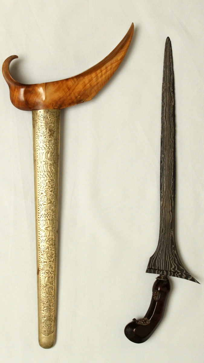

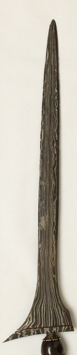

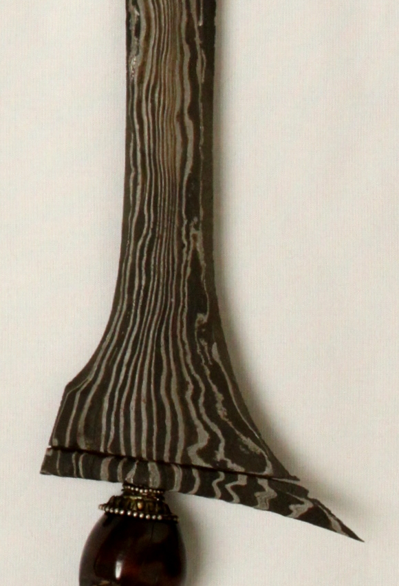

Attached are the pictures of another kris blade with pamor Adeg Sapu from my collection. The blade was recently cleaned in Solo and is probably not as old as estimated by Alan for Gene's blade.
Best regards

Thank you, it's nice to see how mine would look with a restain. Thats a fine looking Keris you have there.

Gene, I vote to not stain this particular blade (some will agree, some will not)--or generally old hopefully antique pieces/with nice patina, just a light coat of oil. The other day I oil my garden bench and all of the sudden it looks totally new and I missed all that old charm . Oil and staining if you go that route has been discussed several times on this kerispedia.

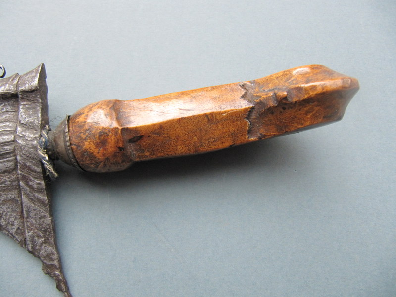

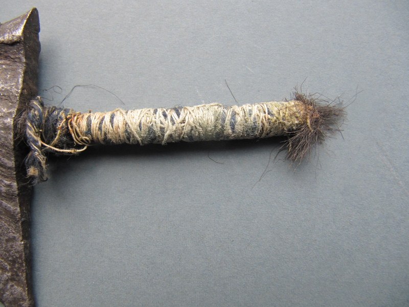

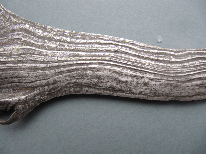

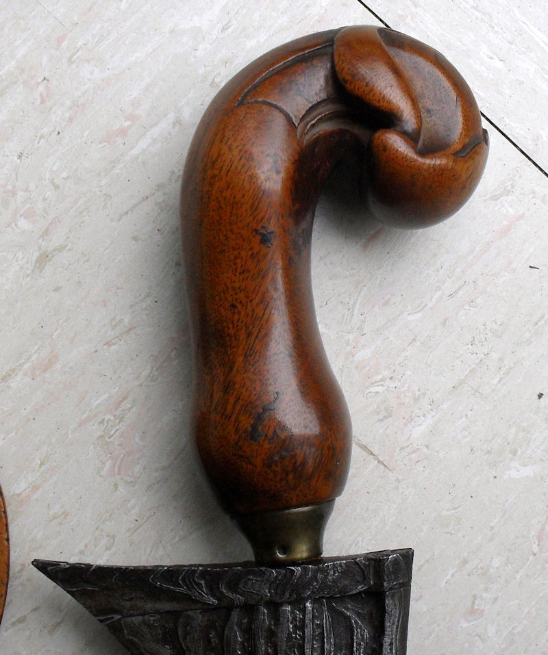

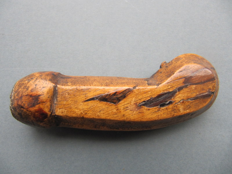

I acquired this some month ago, and on seeing Atlantia's (much better) one was struck by the similarity of the pamor. Would this also be adeg sapu?
It seemed to me that the rather crude hilt on mine may be a recent replacement. Comments from the experts would be welcome.
Yes, I would call this pamor adeg sapu. Similar to this but much finer lines were called adeg mrambut (rambut=hair).
Not an expert here but I think the hilt is original to the blade (the only hilt the blade has ever been fitted) or at least has been with the blade long enough. The simple hilt (without details) is common to East Java region. Hilt cup is also regionally correct. I notice (human?) hair on the pesi, this is an old practice. Hilt orientation is normally (traditionally) perpendicular with the blade (should be twisted 90 degrees clockwise) but this can be personal preference. Simple but handsome old keris. Congratulations!
