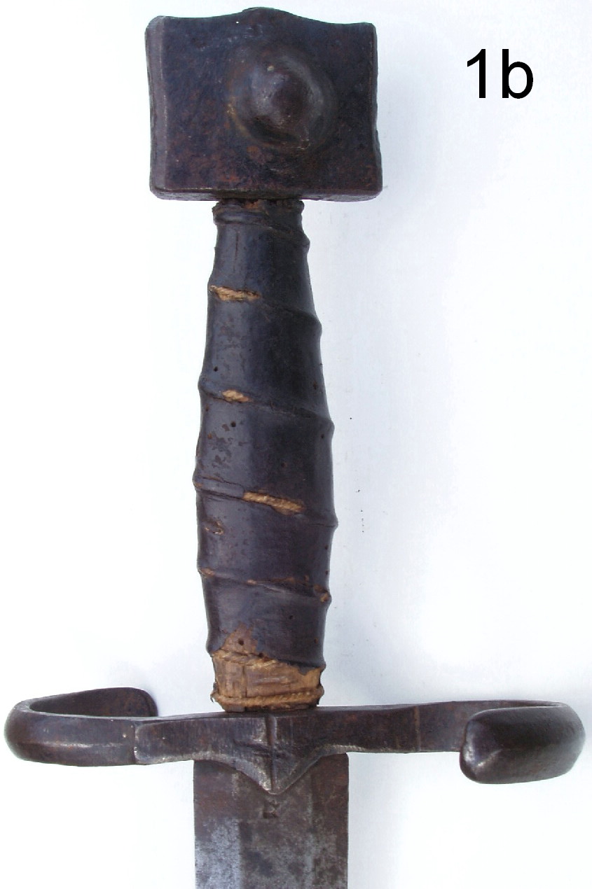

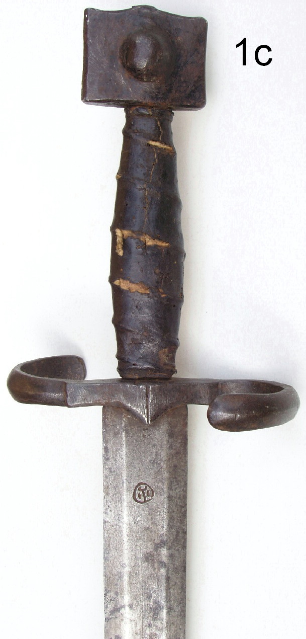

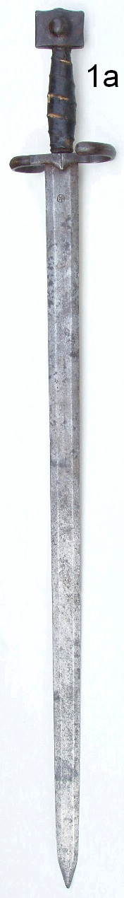

A Venetian `Spada schiavonesca´, last quarter of the 15th century. The blade bears a stamped Venetian workshop-mark on one side, the other is stamped with the Tamga of the St. Irene Arsenal in Constantinople. Hundreds similar swords of this type are still preserved at the Doges Palace in Venice, of course without the Tamga.

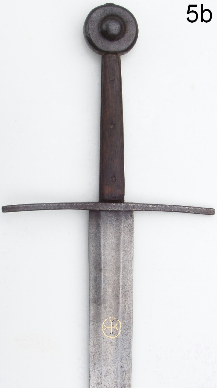

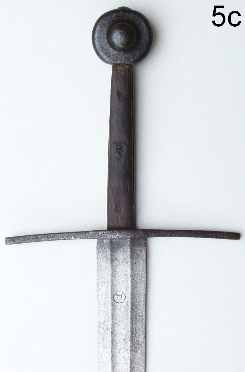

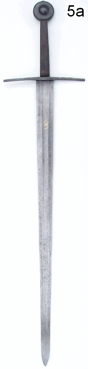

An Italian(Venetian?) hand-and a half sword, dating c. 1400. The long cross is slightly arched towards the blade, the disc pommel has a chamfered edge and a raised central hemispherical boss. The grip is the typical Arsenal sandwich-grip, which was added to many swords in the Arsenal in the 19th century, fixed with hollow rivets. The blade bears on one side a Gold inlaid Cross Fourchee in a circle, the stamped Tamga on the other. The central hemispherical boss on the pommel is similar to the boss on the square pommel of the Schiavona fig.1, threfore it is possibly also of Venetian origin.
The blade section is very interesting, because the cutting edges are hollowed out concave. This feature is common on many thrusting blades of diamond section, but is very rarely seen on flat cutting blades.

sword 5 has indeed a very interesting blade geometry. wherein the concave ensures that a strong and very sharp cutting edge arrises.
The light protective clothing, probably forced by nature, by the heat in these areas, explained the popularity of several types of European cutting swords there in the 14th and 15 century.
This sword could be a precursor of the highly cq. most efficient 2 hand-cutting sword, with a blade very wide at the cross, strong tapering and with a light centered mid rib,...........The oakeshott Type XVIIIC.
If this theory is true, the sword may be dated in the third quarter of the 14th century.

I know the Alexandria group of swords, but these are not really captured from the Europeans. These swords are often treated in other publications, therefore I have not mentioned them here. It is surely right, that the majority of swords with Alexandria inscription do not bear the Tamga, but some do exist. A friend of mine has such a one in his collection. The sword can be dated stylistically c. 1430, the cross has already a simple finger-ring. Unfortunately I don`t know if the inscription is dated.
Swords like fig.5 were surely in use during the second half of the 14th century, as well as during the first quarter of the 15th century, therefore I have dated it roughly c.1400.
Sword fig.5 has a flat and flexible cutting blade with a fuller running down nearly all the length, therefore it can not be of type XVIIIc. The swords of this type have stiff blades of diamond section, even the ones with a fuller.
If I have to categorise the blade, I would put it into type XIIa.

yes, sword nr 5 is indeed Oakeshott Type XIIA, I described it as a precursor/forerunner of the type XVIIIC (actually not as a type XVIIIC.)
Because it has a blade with a kind of wedge towards the cutting edge, caused by the concave, this really makes it like type XVIIIC a pure cutting sword.
The mid rib of the type XVIIIC causes a similar kind of wedge towards the cutting edge. When the geometry and balance of this XIIa sword are improved during the time it can evolve into a cutting sword like type XVIIIC.
The group XIIa was created by oakeshott some time after his classification , I believe with the publication of ROMS, before these 2 hand swords with tapering blades and longer fullers were (incorrectly) placed in XIIIa.

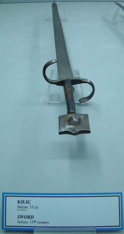

Schiavona in the Military Museum Istanbul, grip replaced.
Best

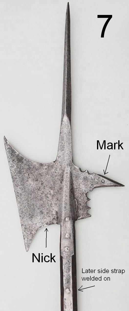

Fig. 7
A German halberd of exact the same shape as the one on the panoply. This halberd is not only a halberd of the same shape and workshop, it is the one depicted on the panoply! It has exactly the features as the one on the panoply: The same mark, the nick on the blade, and the later added lower parts of the side straps are welded on at the fourth hole. It was sold some times ago at auction.

Old 3rd June 2012, 11:22 AM   #9
cornelistromp
cornelistromp's Avatar
Join Date: Mar 2009
Posts: 1,071
yes it is indeed the same, very nice catch.

wishful thinking but I don't believe this is the same halberd, the tip is broken off and the shape of the last serration at the back is quite different... I would assume many would have the mark in the same place on the backspike?

The tip of the halberd 7 is a bit reshaped, the mark is not only at the same position, it is the same mark (only visible on the original scan of the panoply with a magnifying glass). The lower cog has a roundet tip (this was surely pointed when the halberd was new), the two cogs above have pointed tips.
What you need more?

The mark would be the same if it's from the same workshop ?I meant the valley between the last serrations is different, you can't reshape that without adding metal. My apologies for doubting

Posts: 1,071
there is no metal-metal added, it is removed and the latter curve has been re-shaped.
Even the dark discoloration effected in the metal match.
the outline corresponds, the mark and the mark postition corresponds.
the rivet holes, the fault line, the dents on the edge corresponds.
the corners of the spurs corresponds. ......and so on.......
this is not mass production each Halberd, even from the same workshop, is unique. It is very unlikely, read impossible , that there exist two identical halberds!
there are so many similarities that there is absolutely no doubt that this is one and the same halberd.

Ok I bow to greater enthusiasm, they do look very similar
the outline corrsponds, the mark and the mark postition corresponds.
best,
Thanks Cornelistromp,
You took the words right out of my mouth.
Best
