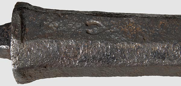

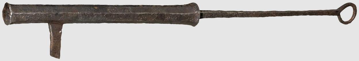

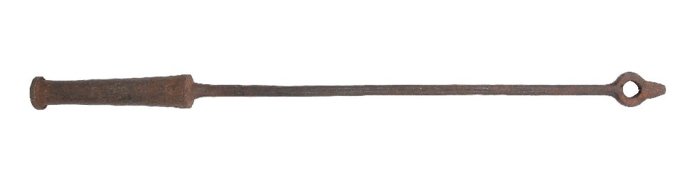

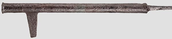

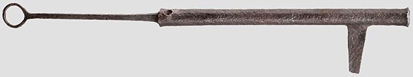

Handgonne from old German historica:
1. pic.1-2 "2nd half of the 15th century. Forged iron octagonal barrel in 16 mm calibre with a swamped muzzle and a forge-welded hook on the bottom. The vent is on top with a depression for powder. Horseshoe-shaped smith marks on the side and underneath. At the end of the barrel a tapering tiller of quadrangular section with a ring pommel. Pitted and corroded surfaces. Length 93 cm."(c)
Pay attention to mark which looks like horseshoe

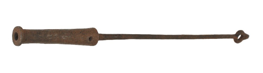

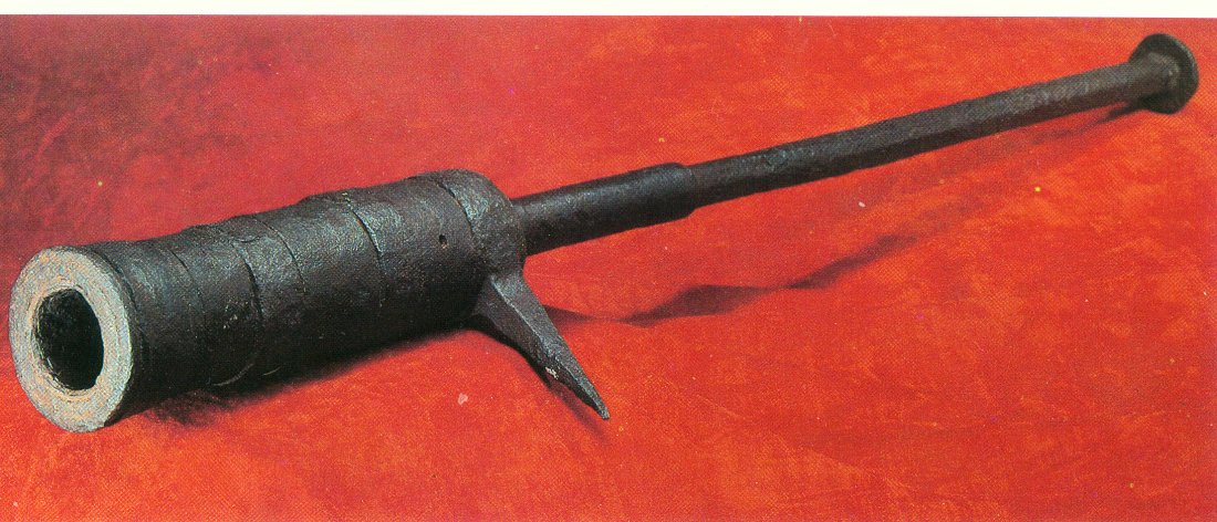

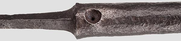

2. pic. 3-5 "Forged iron round barrel in 14 mm calibre with a swamped muzzle and a forge welded hook on the underside. Touch hole on the right side with a powder recess. At the end of the barrel there is a tapered quadrangular tiller with a ring finial. Pitted, corroded surface. Length 77 cm." (c)

Hi Alexander,
The first two tiller haquebuts can be closely dated to ca. 1500 and were offered for sale at a Munich auction house.
The third item is a crude modern forgery!
Thanks for posting,
Michael

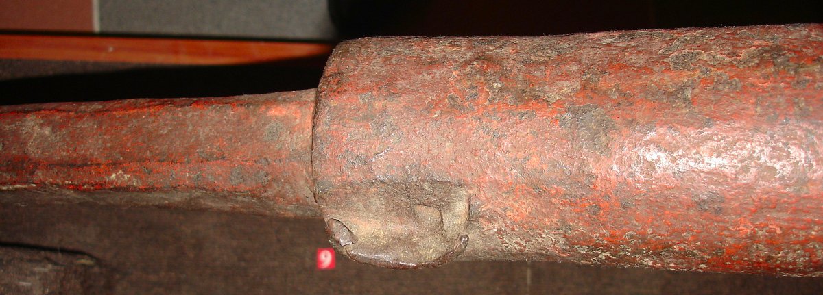

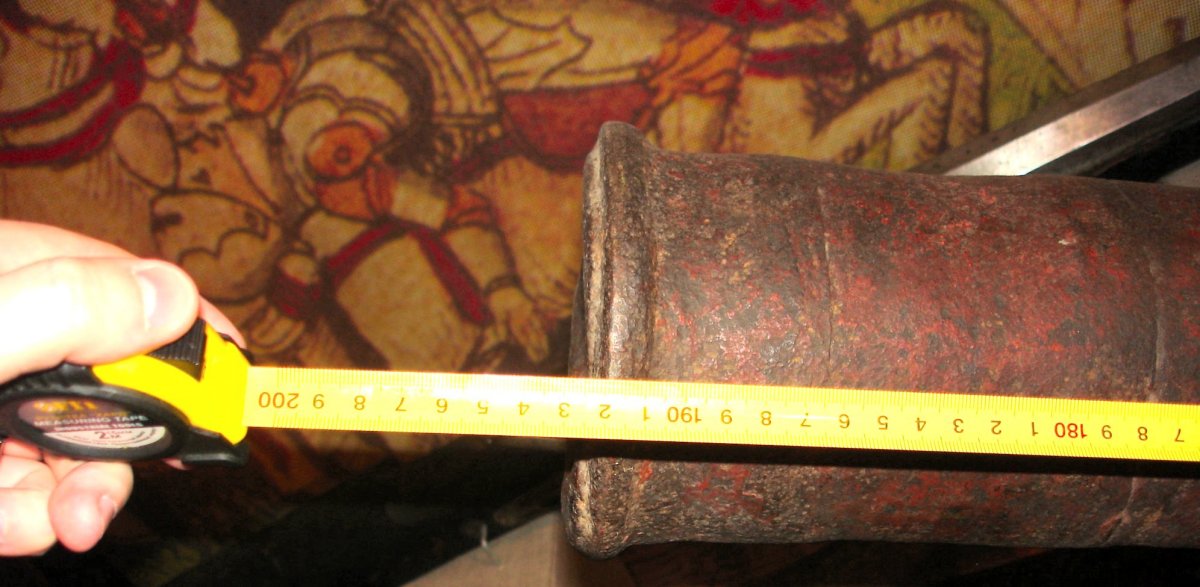

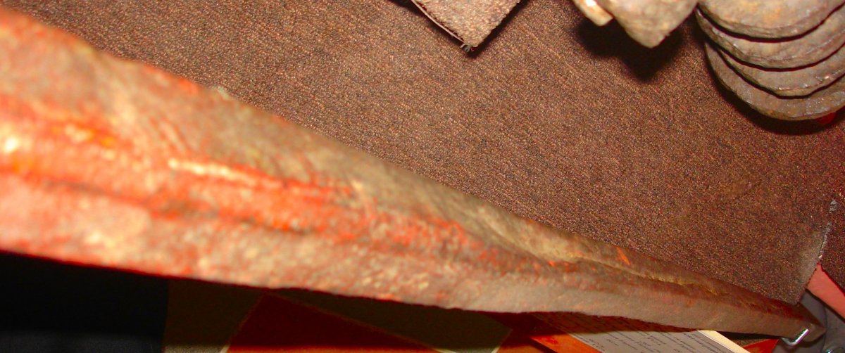

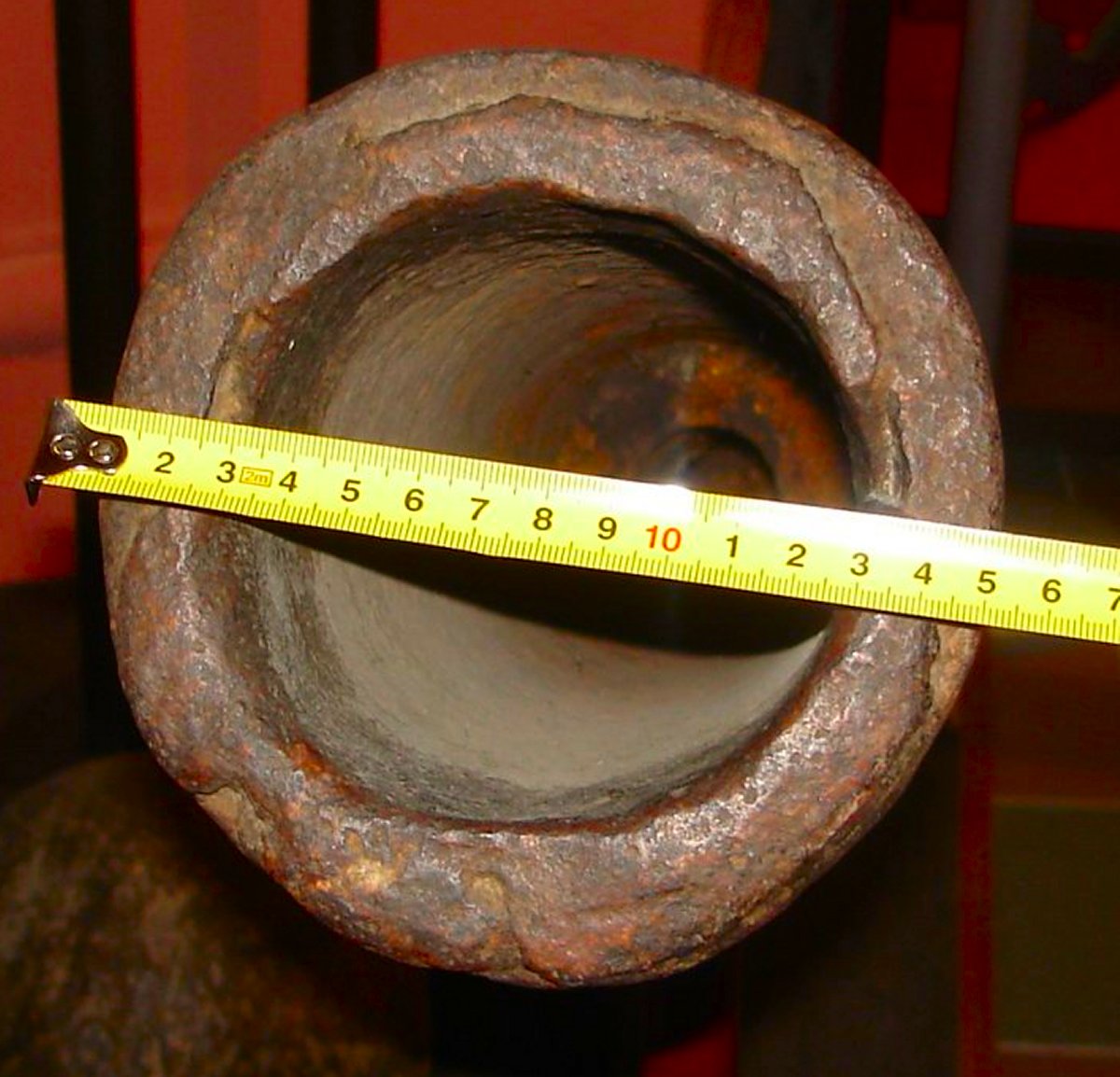

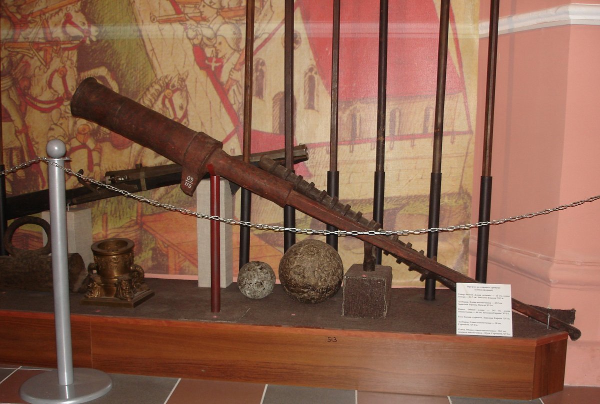

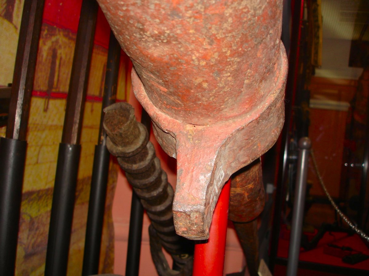

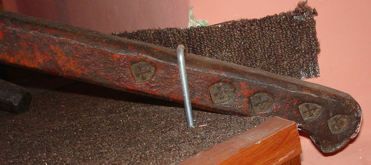

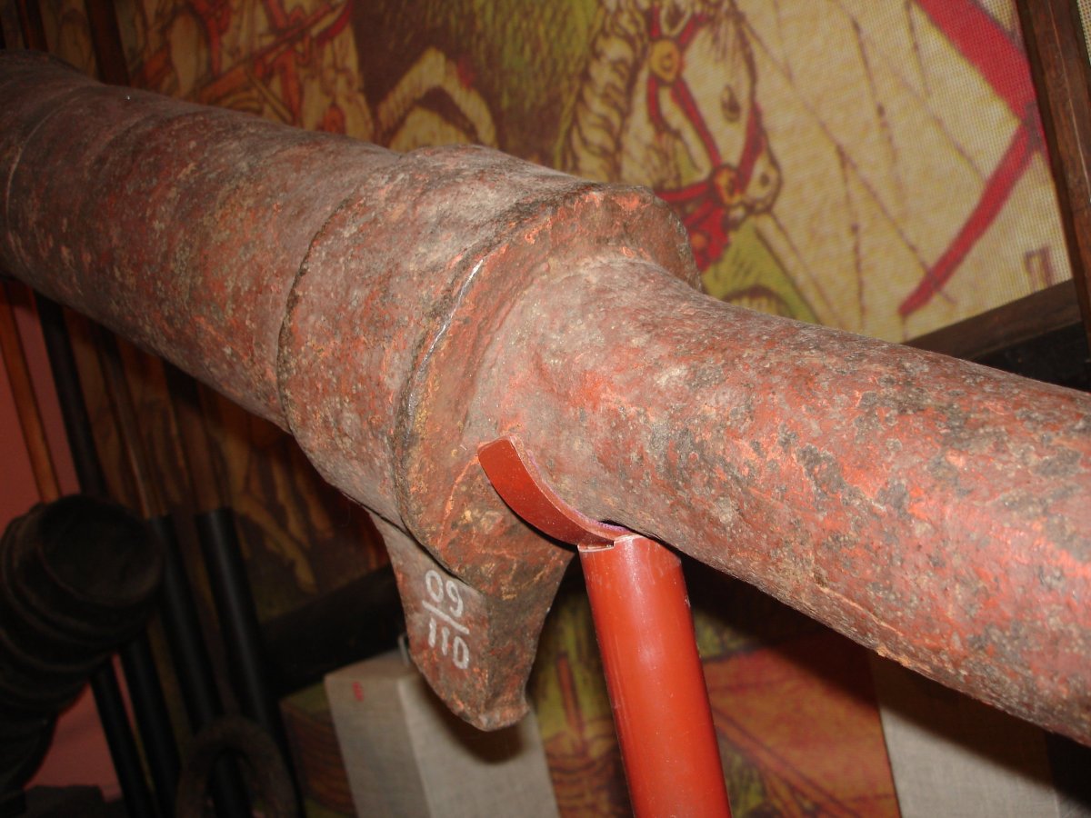

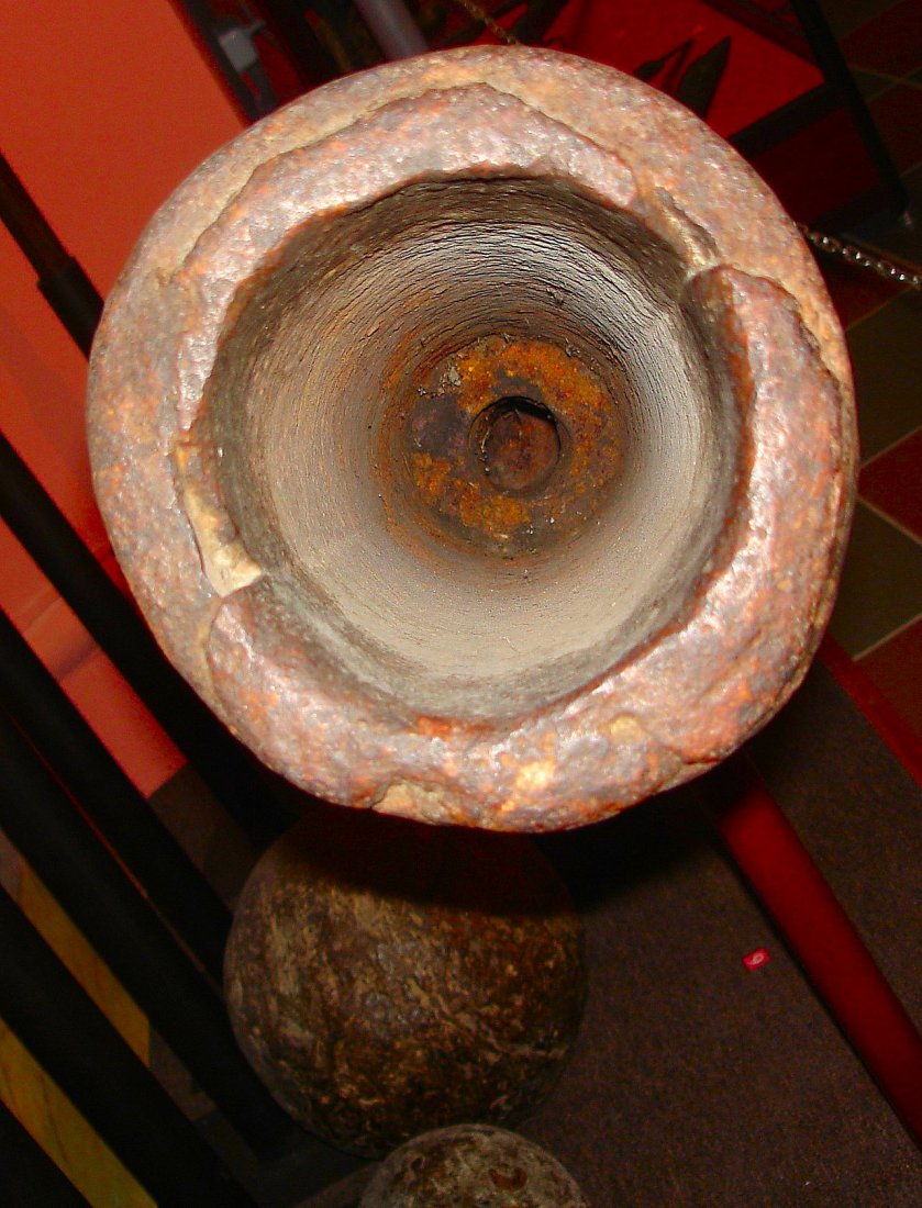

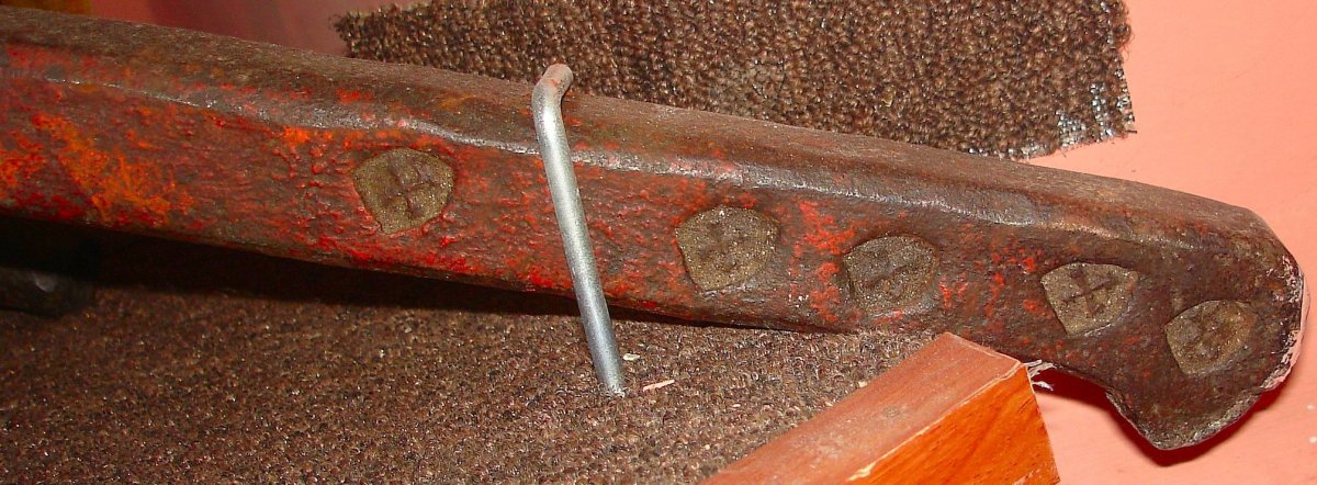

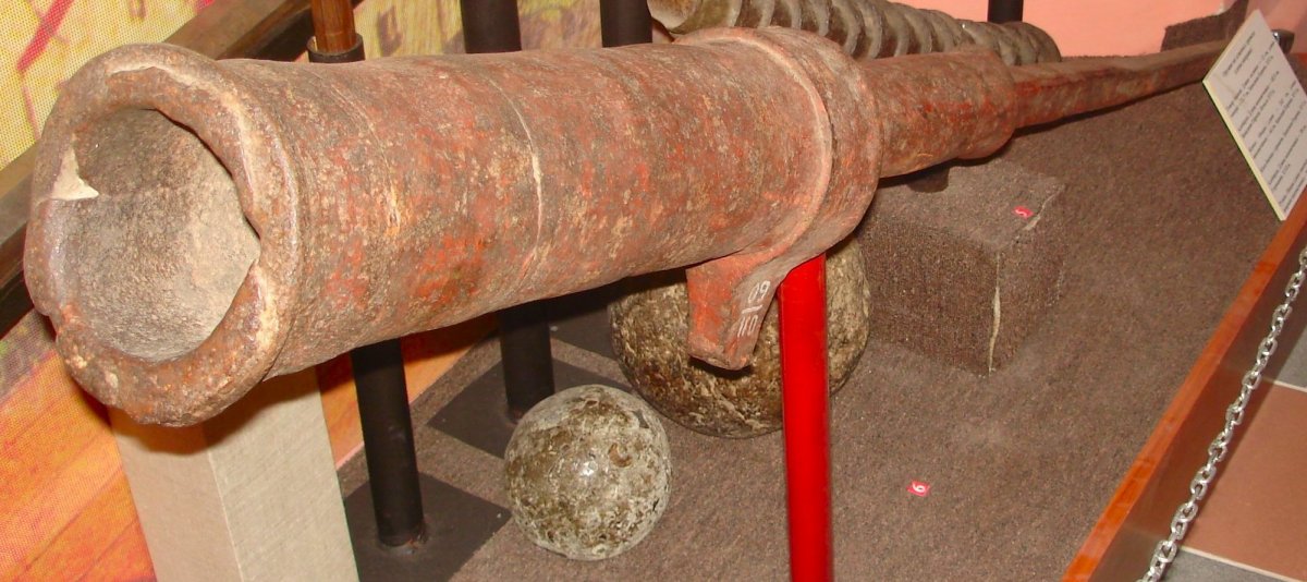

My friend Alexender photographed this very interesting specimen in the Artillery Museum St. Petersburg:
http://www.vikingsword.com/vb/showth...tillery+museum
I wish to repost his images in another of his threads where they probably belong the most, which is here.
The overall length of this huge and heavy all-iron tiller gone is 1.92 m, the monstrous bore 10.5 cm, denoting that it was not a portable but strictly stationary piece. Its rear grip end is shaped like the hilt of a knife and laterally punched with a series of decorative cross-shaped elements. The hook is rather short and blunt, mounted on a ring, and the outer surface of the gun retains its completely original red minium paint.
As the piece is fitted with a hook, and the right-hand side touch hole has what seems to be an integrally wrought pan molding, a date of late 15th c. seems appropriate.
This is the biggest tiller gun by far I have ever noticed! Its sheer dimensions are unbelievable!
Michael
Old 30th April 2012, 02:22 PM   #11
Matchlock
Matchlock's Avatar
Join Date: Sep 2008
Posts: 4,310

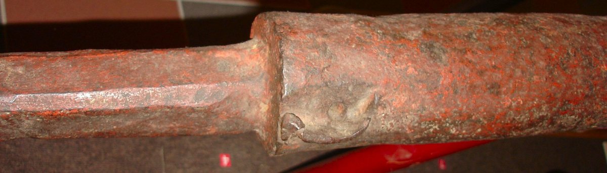

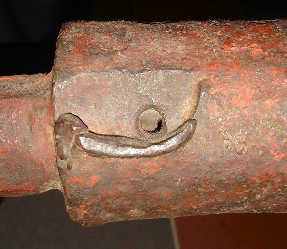

A close-up of the rudimentary pan-like molding beneath the touch hole, to receive the priming powder and be touched by an igniting iron or a length of smoldering slow match.
m
