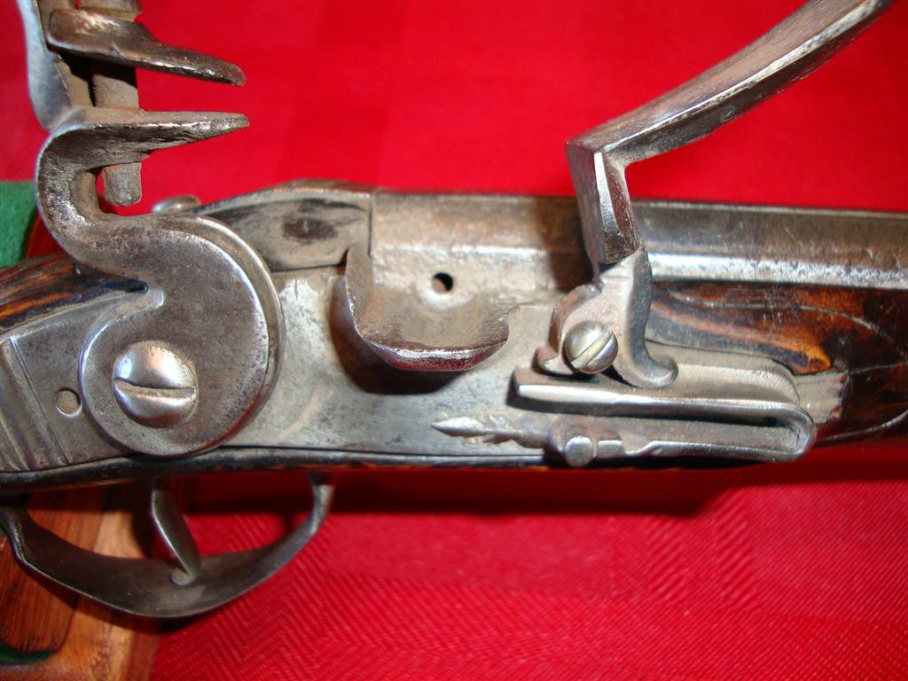

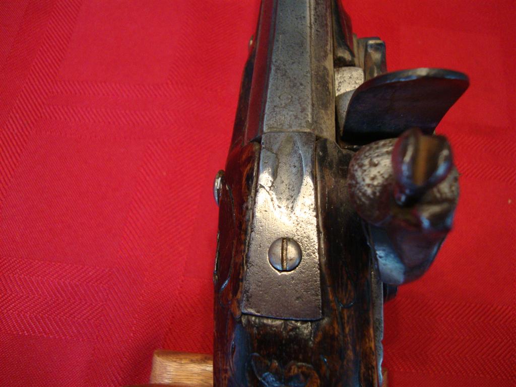

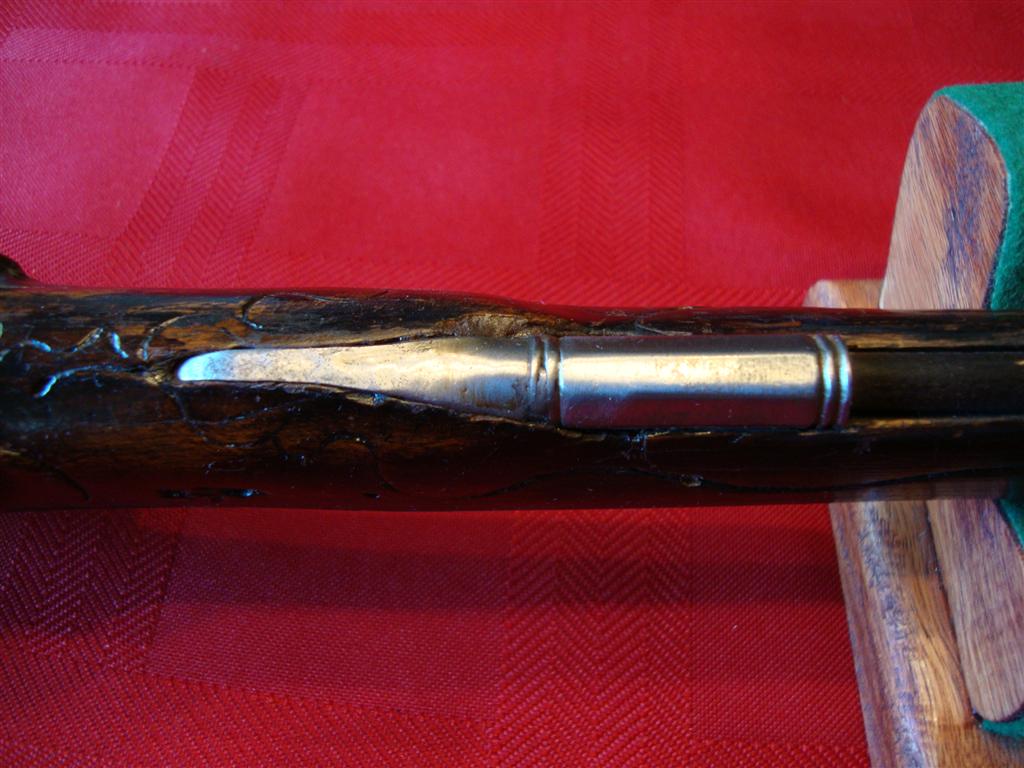

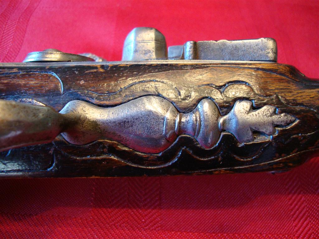

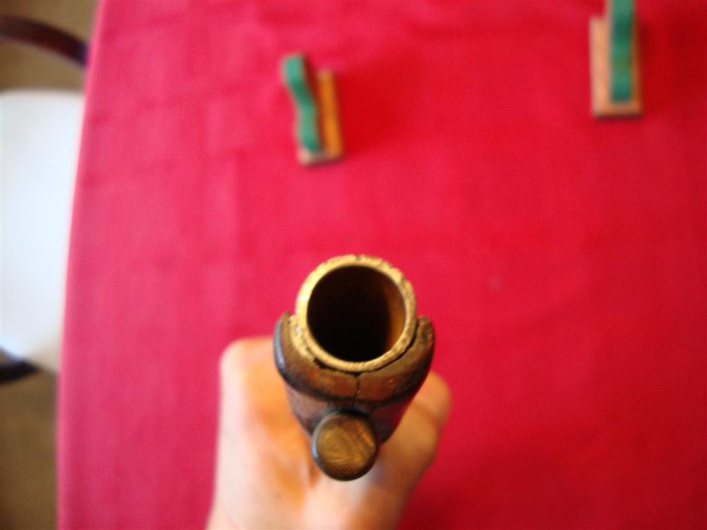

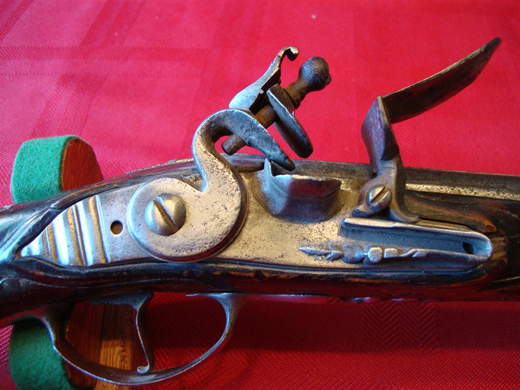

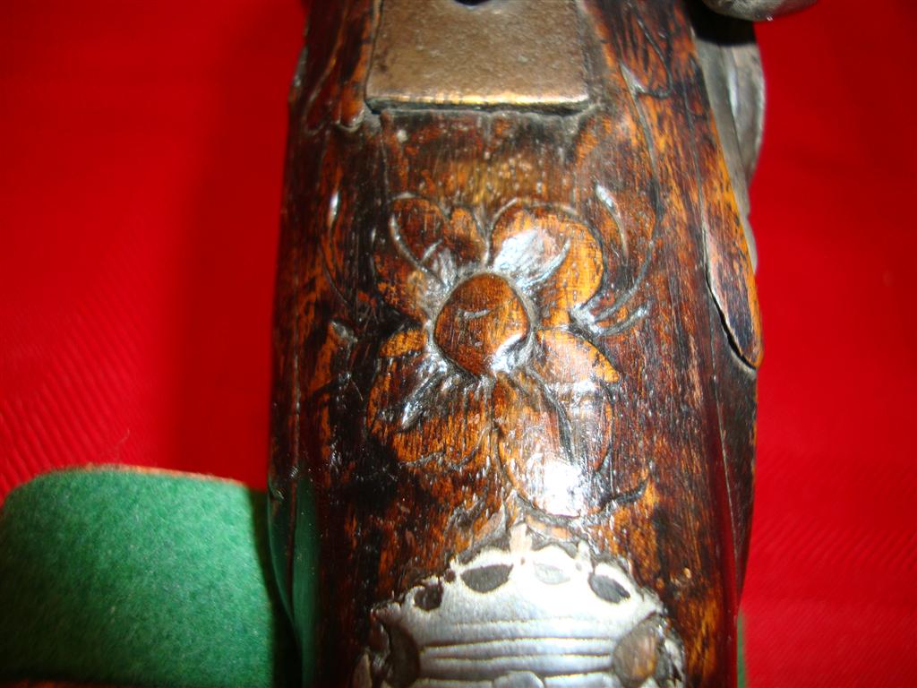

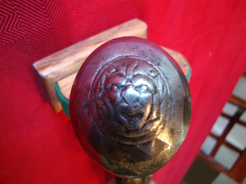

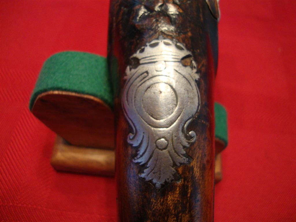

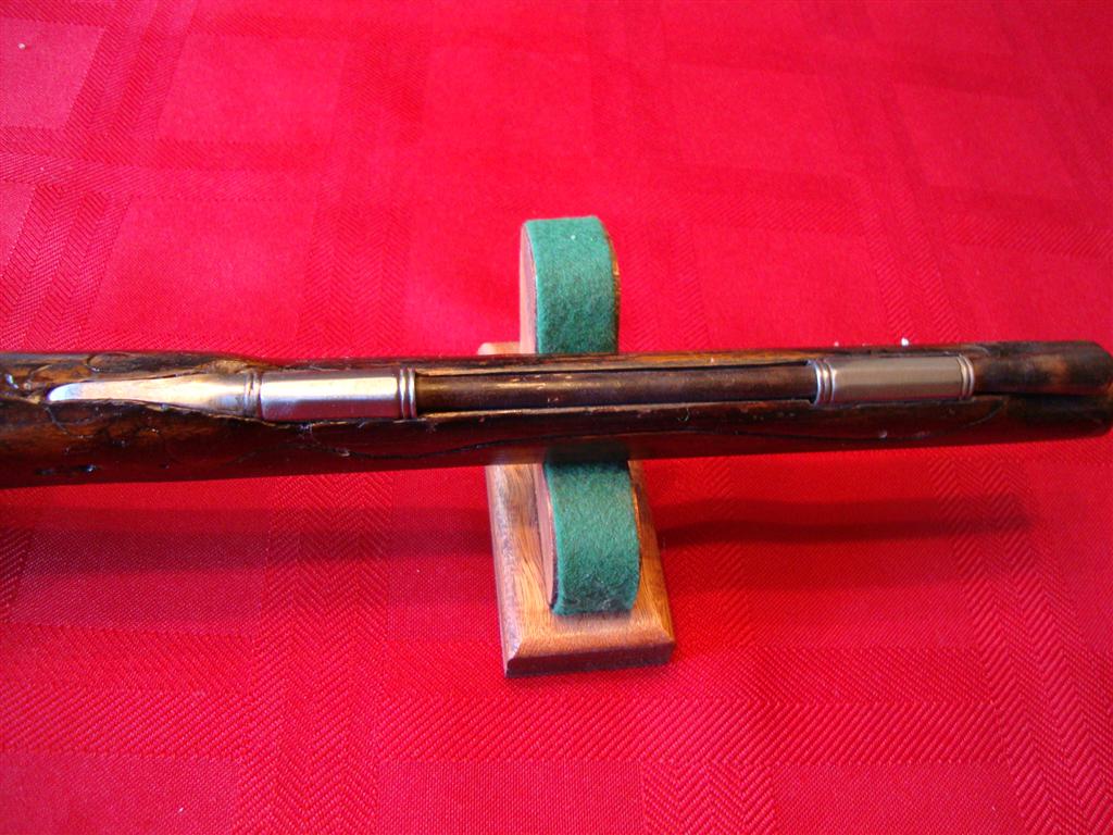

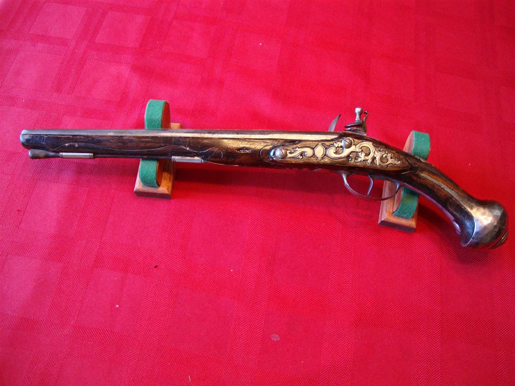

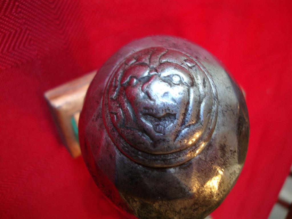

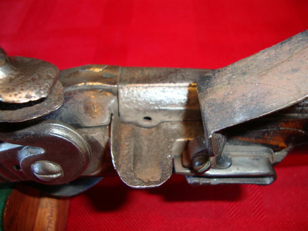

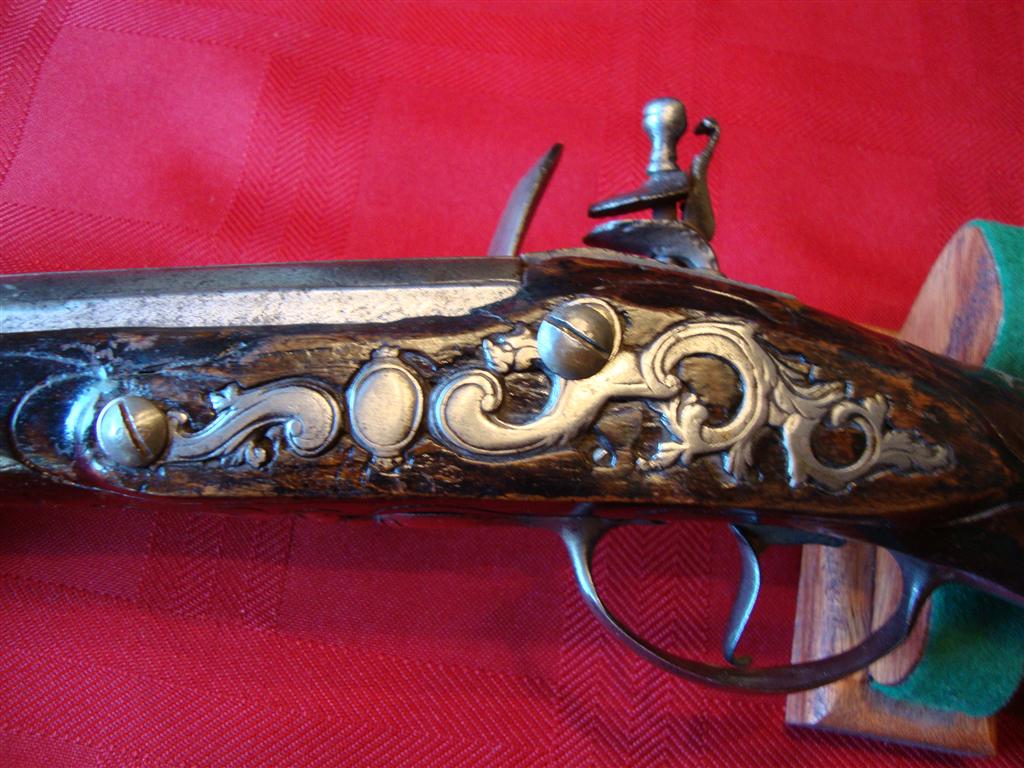

Well, yet another addition to my collection. I thought this was a really good looking horse pistol. Overall length is 21". Barrel length is 13 3/4" long about .58 caliber. The barrel is octagon for just the first 3" then fades to round with a central rib down the middle. Stock appears to be European walnut (?).

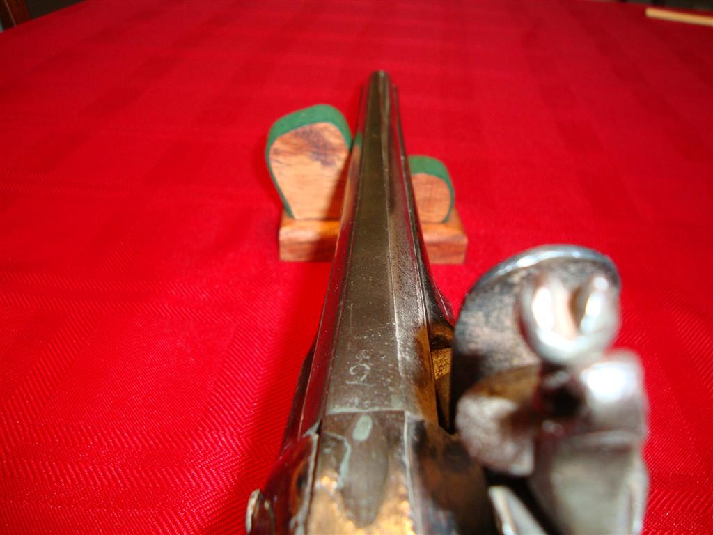

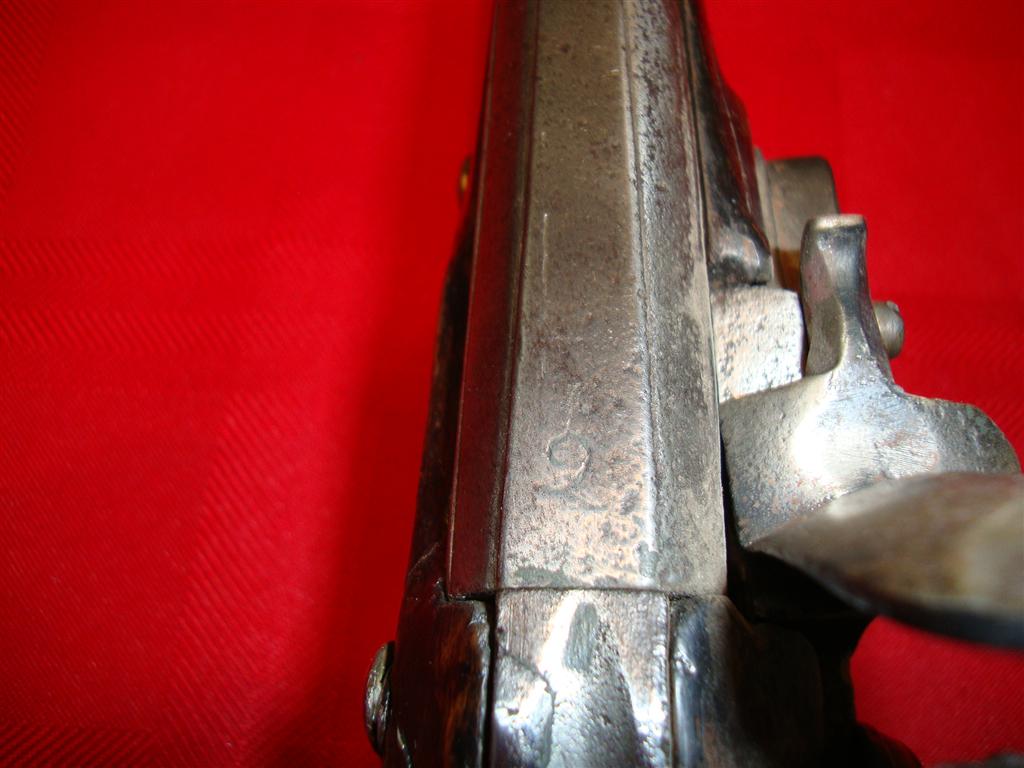

I'm thinking this pistol is German or Dutch maybe? It does not look French, although the side plate does resemble French pistols. The lock looks German. Maybe a Dutch pistol done in the French style? I'm thinking this pistol could even be pre-1750? There are no external markings on the pistol EXCEPT a #2 on top of the barrel breech. This usually means it is one of a pair. (Wish I knew where the other one was ).
I'll take the lock and barrel off this weekend and see if there are any marks and report back.
Meantime, here are a bunch of photos. Any opinions as to where this pistol was made and the time frame would be much appreciated. Thanks for looking. Rick.

Hi Rick,
The shape of the lock plate, flat and 'banana'-like curved, with a triple-fold incision behind the cock, clearly denotes a time of origin of the iron parts, including the mounts, of ca. 1730 - give or take five years.
The numeral 9 struck on the barrel is most probably an armory inventory no.
As I cannot remember seeing the carved flower ornament behind the tang on firearms before the 1780's, there is a possibility that this saddle pistol was restocked during its working life. The latter remark, however, is not exactly covered by my actual field of expertise.
The remark allowed, the item seems to be quite worn overall.
Best to Missouri,
Michael

Hi Michael!! Thanks for your reply. Since my first Post I took the barrel and lock off. No marks on the inside of the lock or bottom of the barrel.
I believe 1730ish is probably a reasonable estimate. I can't detect any old repairs, but yes, it has been well used. This gun looks like it's seen alot of action. But, it's all there and displays well. Thanks again for your comments. Much appreciated. Rick.
