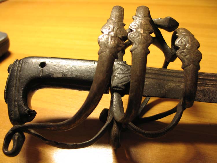

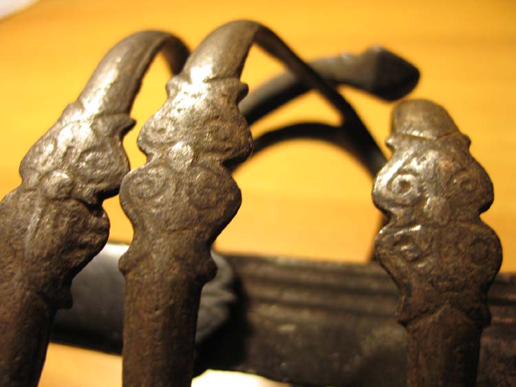

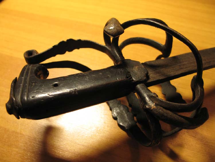

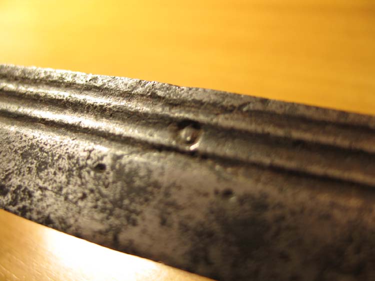

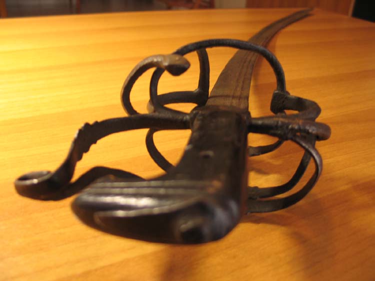

Dear friends,
I bought the sword in the photos bellow by an auction house that described it as a "18th century Turkish (?) sword"
What is your opinion? The sword seems even older than that, maybe even 17th century, but where it comes from? The guard reminds me european swords of that period, so could this be a hybrid of turksh and european elements? Maybe made by a an armourer that was once Christian and then became muslim and worked for the Turks?

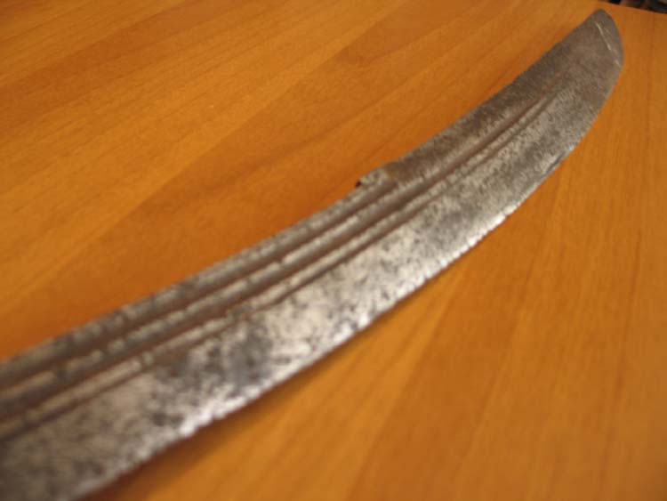

There is a makers mark on the blade, i hope it shows in the photo.

The blade and handle look like a saif or nimcha to me but the ring guard certainly does not fit that sword. A great find and I cannot wait to see what those who know more have to say.

Eftihis, I have a funny feeling that the ‘basket’ could have been added later – has it?

It is a very interesting sword, probably 17th century North African work-- don't see anything which suggests Ottoman forms. It is fitted with a trade blade, earlier than average one too, I imagine it is quite long for the type. Most likely it was assembled using or duplicating a rapier-type guard which the owner found more effective in protecting his hand than a standard Nimcha guard. This guard may have been reused at some point as the knucklebow finial has been bent over a bit in order to correspond in length to the pommel.
Anthony North, formerly of the Victoria & Albert Museum, London, published an excellent article on the origin of the Nimcha in Connoisseur Magazine back in the 70s. As I recall he identifies its progenitor as a little-known Italian saber of the early 16th century. It is an excellent article which proves his point admirably.
Sincerely,
Ham

I agree with Ham: nothing to suggest later soldering of the European guard on the pre-existing Nimcha guars. This sword was likely born this way. Tremendously interesting example of a "fusion sword".
Let's not forget, however, that the movement went the other way as well: the Europeans liked Nimchas so much that they produced swords with a similar guard for a long time and when David was charged with the responsibility of designing a sword for the French Revolutionary guards, he used Nimcha as an example.
Bidirectional crosspollination (rather pompous but true definition).

It is odd to see a slashing cavalry sword with a thrusting rapier type hilt but it looks like it was always made that way. It may well not be three centuries old. I can not think of many 17/18 century European cavalry swords with a rapier basket. Tim

Why then could this not be an early Italian sabre rather than an Italianate style Nimcha ?
I'm sure there's an obvious answer; but I'm missing it .

I am not an expert on European swords but I am sure this is not Italian craftmanship from the 1600s especially the sword of a wealthy man. To me it is North African 1800s why it has the rapier basket I do not know, If you look closely you can see one of the quillions has been braised back on and rather crudely. Tim

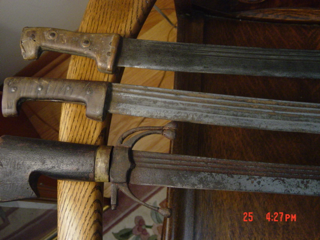

I think it has an obviously North African blade. I have similar blades on Beduin and Nimcha swords.

There is also a possibility this is a Swiss saber which was regripped at some point in North Africa; it is compellingly similar to a number of published examples.

Ham, I don’t know enough about European swords to be able to tell. How is the false edge on the Swiss swords you have seen illustrated?
Ariel, the blades on the Beduin and Nimcha swords you have, could they be trade blades?
Jens

The blade on your sword is exemplary of the type usually found on Swiss sabers, backedge included. This link will take you to the only image of a Swiss saber I could find online-- it is the bottom one.*
http://www.thearma.org/essays/FAH/css.jpg
Please note that there are a variety of different forms of hilts and blades to Swiss sabers, this is just one. However yours falls well within the realm of its type.

Ham, with respect I cannot see the similarity, the Swiss blade and the one in question, to me are chalk and cheese. The number and quality of the fullers remind of some 19th century India talwars and not the best at that. The basket is far too crude for European work on a weapon of the standard requiring a basket. Tim

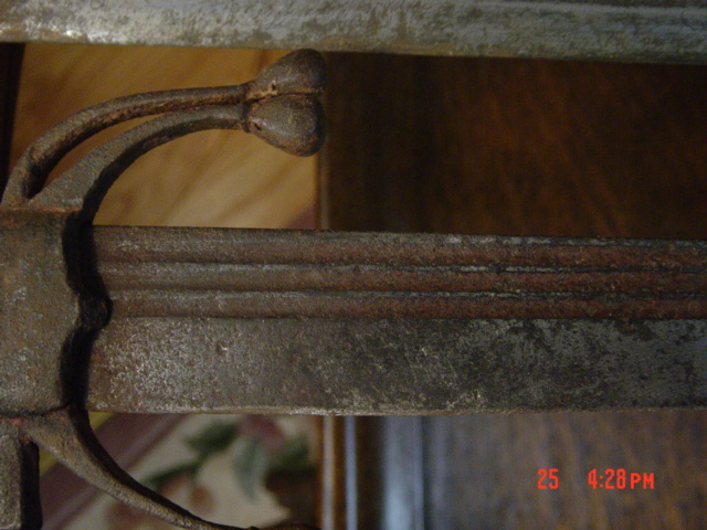

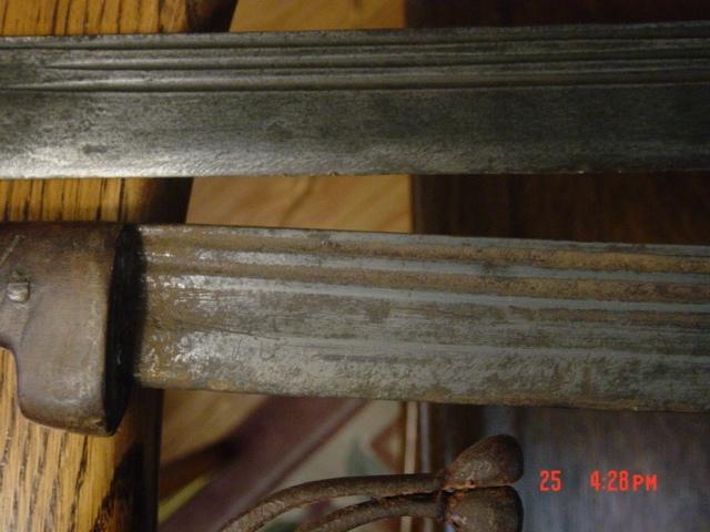

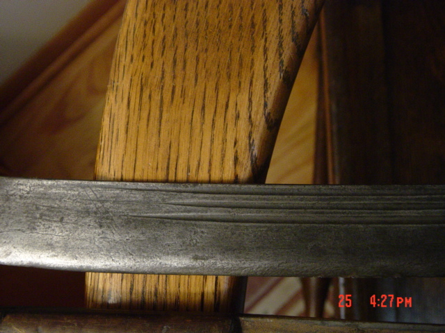

Jens
Here they are. The Nimcha has an eyelash mark. They may be trade: far too uniform to derive from different localities.
