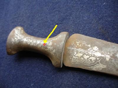

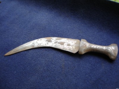

Just bought this via the internet, and now awaiting arrival by post. The first time I have ever bought a weapon without handling it. So a bit of an experiment, but the price was right, and I took the plunge. Comments and advice sought and welcomed.

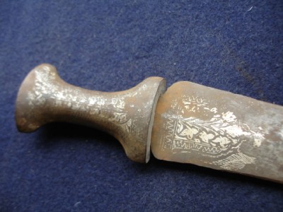

It arrived today, and there were no suprises, pretty well just as it looked in the pics. The silverwork looks to be foil applique koftgari, which I have seen done with gold before. Very delicate, I will need to be really carefull of it.
The blade to hilt fit does not look that good, the blade seems almost too big, but the motives match on the two pieces so not looking like a shotgun job. Anyone got pics of something similar to post, I wonder if this is a feature of this type of dagger. I will try and update as I work on it.

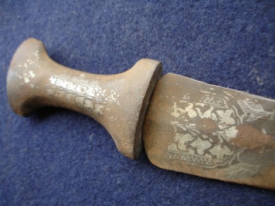

The blade is pretty well de rusted now, I have been trying out something I found online. Suggested for cleaning chromed items, coca cola and scrubbing with aluminium foil, the foil being soft enough not to lift the plate but harder than the rust. It has worked quite nicely on the koftgari, scrubbing down to the steel and not damaging the silver applique. In fact I am considering using it on the grip, just to remove the upper/looser layers of oxide.

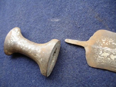

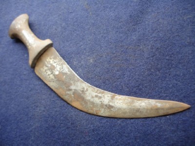

I have taken the cleaning as far as I think sensible, and the next step is to make up some cutlers resin and put it together again, which I intend doing over the weekend.
I post today 'cause of a little discovery...a pin or rivet traversing the narrow axis of the grip, in just the right place to hold a short tang blade. But not this blade, which I now think is possibly a replacement made during the working life of the khanjar...which would explain the poor fit to the hilt.
