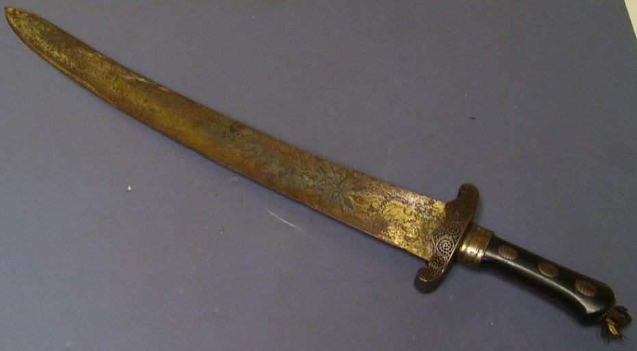

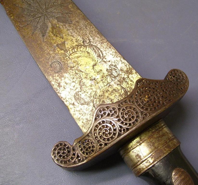

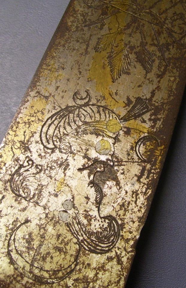

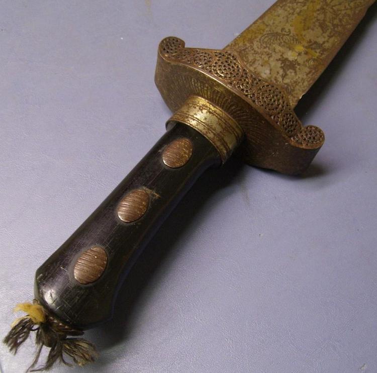

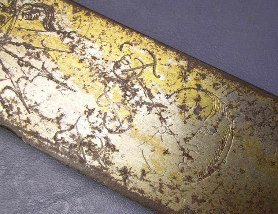

Went on eBay titled: (original) "18th Century Hunting Sword or Hanger with Talismans Eastern European"... and commanded some interest. the thing has some Ottoman symbols / (naval?) elements, even shows some age and relatively elaborately chiselled crossguard, but nothing in it makes sense. looks like someone put some efforts to produce a "fantasy" item, but still tried to make it look "original". lack of literacy, or an attempt to be "original"?:-)

I've seen quite a lot of similar ones in museum exhibitions: it was a popular form with popular decorations on the blade in the 17-18th centuries. The blade seems to be nickel-plated later, but it was also a widespread custom in the 19th century.
In short, I might be mistaken, but without actually holding it in my hands, I find nothing wrong or faked with it.

I am inclined to agree, I think it has had a rough "life" but the pieces look ok....as said though, would need to be seen and handled to be sure about it.

I could be wrong of course, but despite looking old and relatively good quality it does not look right to me. You're certainly right that without handling and seeing it's hard to tell, but... crude and mixed blade decorations, clean "drilled?" holes at the crossguard, wooden handle, etc. Are there any references to similar swords and descriptions pointing to 17/18 C? Thanks again!

Any possibility that this is a Victorian era wallhanger ?
Those plugged holes in the blade don't seem right .
The whole piece seems a bit 'discordant' .

Good call Alex with the examples you posted, Im not sure which book these are from but the style is as noted, well placed. In the 18th century there was a profound attraction in Europe to oriental exotica in addition to the well known intrigue with occult, magic and esoterica. These were the source for considerable blade decoration and motif. There were actually even Chinese artisans brought into Poland for work on the flamboyant weapons sought by gentry and nobility. The advent of the smallsword carrying these themes was paralleled by the 'hunting sword' which is misleading in that rather than strictly utilitarian items, these were fashionable elements for dress and court wear.
This type of sword also gained considerable popularity in its use by the flamboyant units of auxiliary troops known as 'pandours' in Austria, which subsequently became known throughout many European armies by the end of the century. This is the reason that military themed panoplies often joined the magical/talismanic motif on the blades. Bashford Dean (1929) illustrates a number of these among the smallswords in his examples, and one notable element I recognize is the striations on the boss type rivets, seen on it seems several of these shown as 18th century. As I have always followed, these kind of subtle nuances are not typically seen on reproductions and 'wall hangers'. As shown in your examples posted, the openwork is also characteristic and recalls similar on many Chinese guards of this period.

This looks to me a sound example of a European hunting/court sword of mid to late 18th century following the styles well established as discussed.
