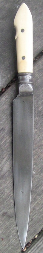

I just returned from a trip to Jaipur, India, where I saw quite a few well made daggers. Some of you may be familiar with the Damascus pattern that they're using for reproduction of antique daggers, mostly dense small dots and concentric rings. I had a very difficult time finding anything old, especially wootz. finally my tuk tuk driver said that he knew a place that had “old” things. I told him, explaining with photographic examples from my iPad, that I knew the difference between “real” old and “new” old, and that I would walk out laughing if they trird to pass off some of the new stuff on me. He brought me to a very large emporium, where a gentleman stood in front of a large display of the obviously “new” antiques. When I asked him to show me something old, he took down on old, battered looking dagger that was the same new material as all the rest. I laughed and started to walk out. “Wait, Sahib, I just wanted to make sure.” He said, then took me upstairs to the “back room”, where I was delighted to see about a dozen nice pieces of wootz, among other antiques. one of these pieces, This small knife/dagger, I liked a lot. Upon examination, I noticed a clear wootz pattern, not very visible in these photographs, and bought it immediately.
I have not tried to etch this blade, especially since reading some of the “restoration” threads. the pattern is absolutely plainly visible in sunlight. Any suggestions? Comments? If somebody can tell me more about this piece, I would greatly appreciate it.

NOT MY FIELD BUT THE TYPE STRIKES AS CLOSEST TO A KARD AND THE HANDLE LOOKS PERHAPS BOSNIAN IN FORM TO ME. OVERALL LESS INDIAN AND MORE ARABIC/TURKISH TO MY EYE. I CAN'T SEE THE STEEL AND YOU WILL HAVE MUCH MORE KNOWLEGE THAN I IN THAT. JUST OBSERVATIONS HOPEFULLY SOMEONE WITH MUCH MORE KNOWLEGE THAN I WILL GIVE YOU A POSITIVE IDENTIFICATION.
ITS ALWAYS NICE TO FIND SOMETHING GOOD WHILE TRAVELING VERY NICE KNIFE!!

yes, it does have that "Eared" look that some Balkan daggers have. The people where I bought it claim that it came from Bikaner, a small kingdom north of Jaipur.

Salaams Montino Bourbon ~ Nice story and a familiar one to many who have trod the same or similar path...I think they term wootz as Johar in India..I note from forum library the two distinct types of wootz. You could try polishing the blade (etching) with vinegar rather than plunging in with strong acid.Hot vinegar is quite agressive...so be advised. Then clean it off in hot water and soap..and with a 00 grade paper bring up the grain..see what it looks like...Regards Ibrahiim al Balooshi.

Hi Montino,
I would say that the trend is staring to change in India from out and out reproductions towards rebuilds and restorations to maximise the value of 'old pieces' as collectors demand the genuine article.
I would say that the knife you have bought falls into that category.
I could be wrong as I am basing my thoughts on just the pictures of course, but it looks to me to have been recently polished/etched and I would suspect that the hilt slabs are new.
However, that said it looks to have been done very well and unlike many I see, it wasn't a project that started with a very poor worn blade.
Overall a rather nice thing.

A gentleman on another forum swears by pineapple juice to bring out the pattern, and I have had decent results in the past from worcester sauce.

A weak solution of ferric chloride 3 parts distilled water to one part ferric chloride should do the trick you can either dip into the solution directly for 30 seconds or apply even coats until the desired effect is reached but be careful not to over etch it. Rinse with warm water to neutralize the solution dry and apply a drop of mineral oil to the blade.
