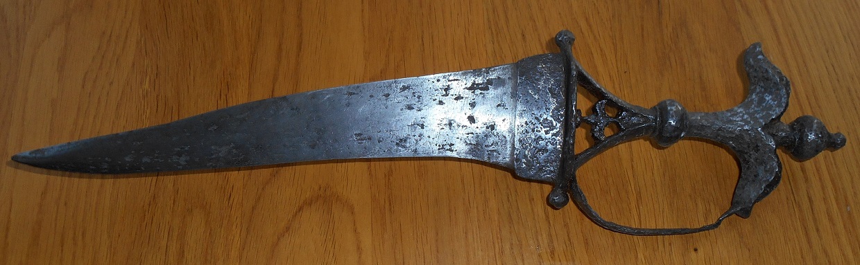

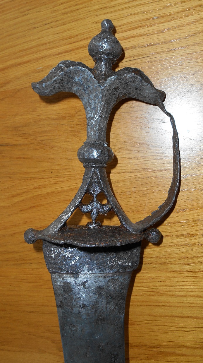

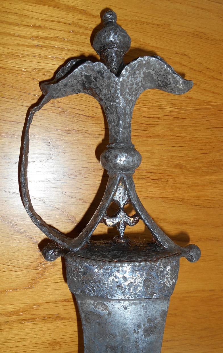

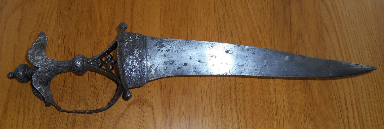

Hi Guys
Thank you all for your help
Here is the maximum that I can do.
I didn't want to go too far as there are bits of gold everywhere...
Kubur
