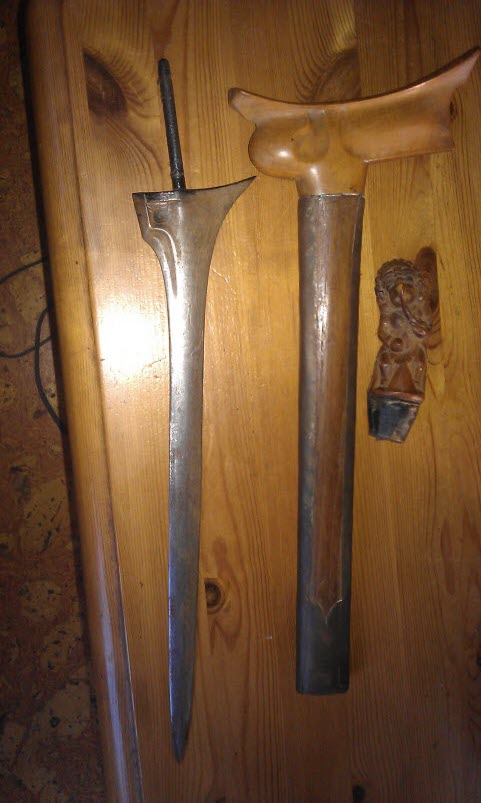

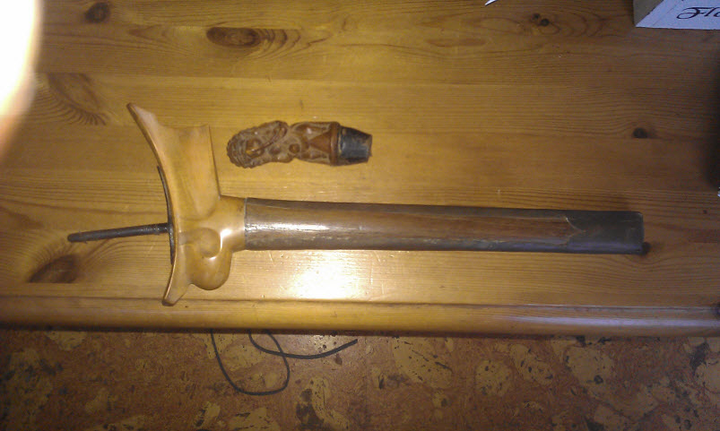

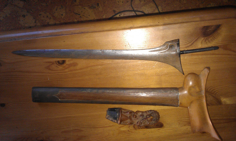

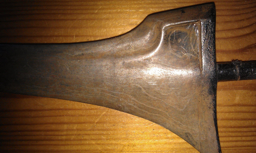

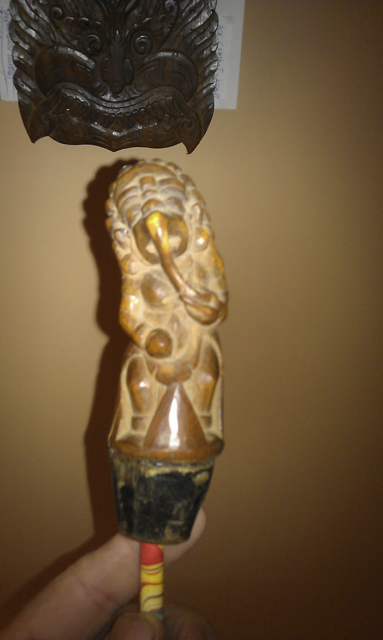

Hello everyone,
I am new on this forum, but it feels like I been here for months, there is so much to read and to learn.
But I have a question, and I hope you can help me with it.
I recently bought a keris, with a Sumatra sheat, de keris fits like a glove, en there are no sins of recent adjustment to it, there was a Bali hilt on it, I think Ganesha,
de keris itself looks like it’s been polish, just what I have seen on Bali wliah’s , the peksi is about 8 mm thick and 8 cm long, so no small hilt on this one, the wilah without the peksi is 38 cm.
The pendok looks like it’s home made, and not a very good job.
The only thing I now about it is that came to Nederland between the two WW, the person that brought it here was a teacher in Indonesia.
So the question is, is this a Bali wilah or Sumatra or ......?
I hope you guys can help me out, and sorry for my bad writing.
kind regards, Ben

Hello Ben,
first welcome to the forum!
The sheath isn't from Sumatra but from Bali/Lombok and called sesrengantan but not a very well carved one and I think that the blade is as well from Bali/Lombok not only because it is polished. Do you have opened the pendok which have a East Java/Madura style? Maybe it was attached because the gandar is damaged?

Thanks Detlef,
I was convinced that it was Sumatra, but i am glad to hear that is is from Bali, then things come together.
I have removed the pendok, and i don't no if you mean the lower part of the warangka(gandar)?, if so it was not in good condition, and definitely was made for a pendok, the bottom was straight cut, and open.
But that is no problem, i could replace that part.
regards Ben

Hello Ben,
yes, the part down from the sampir/warangka or wrongko is called by javanese keris gandar; by keris from Bali penyejer. The pendok from your keris isn't a balinese one so my assumption that it was placed to cover a demaged gandar/penyejer. A gandar isn't never original cut in down or open.

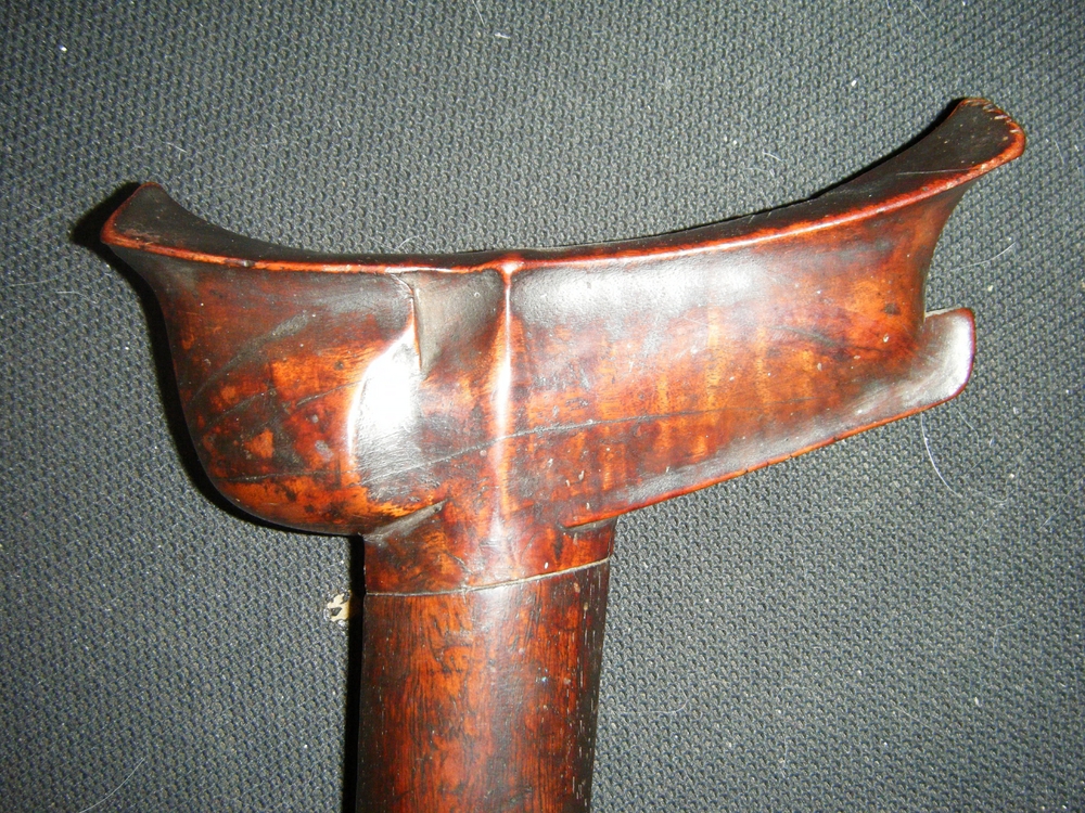

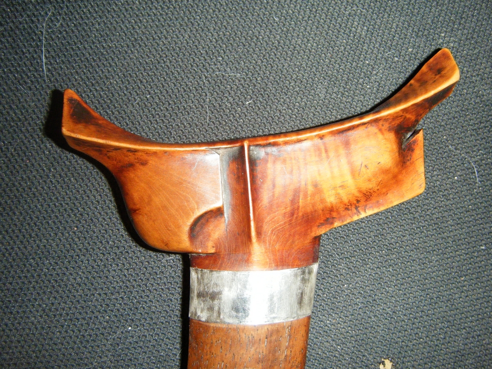

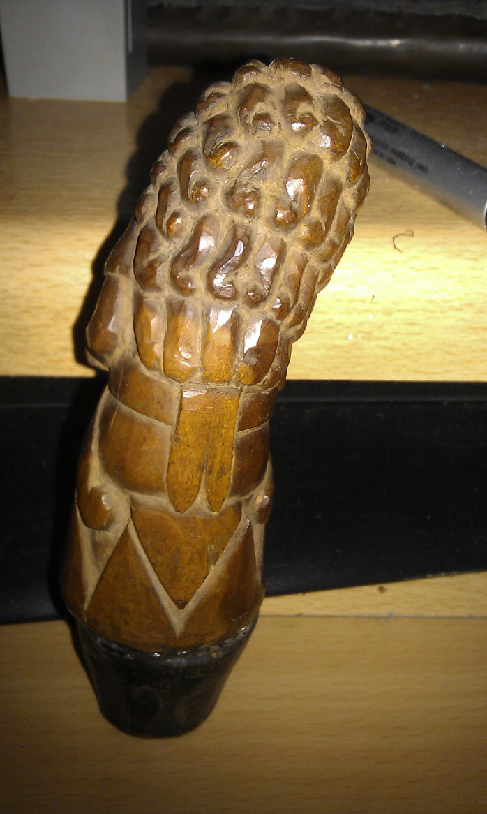

Posts: 7,298
There is also a chance that this is a Bali/Madura piece, that is, a keris from Madura that is for a member of cultural Balinese living there. This type of pendok with the open window down the center is not something i have seen on Bali or Lombak keris and is more common to Madura/East Jawa wrongko. I would also like to see a closer view of the hilt because i an not convinced from the present photos that this hilt is truly Balinese. There appears to be a missing "selut" of some sort and it does not look like the kind that i would expect on a Balinese hilt. At 15 inches this could well be a Bali/Lombok blade, but they often tend to be even longer than that. The state of polish alone is not necessarily an indicator of place of origin.

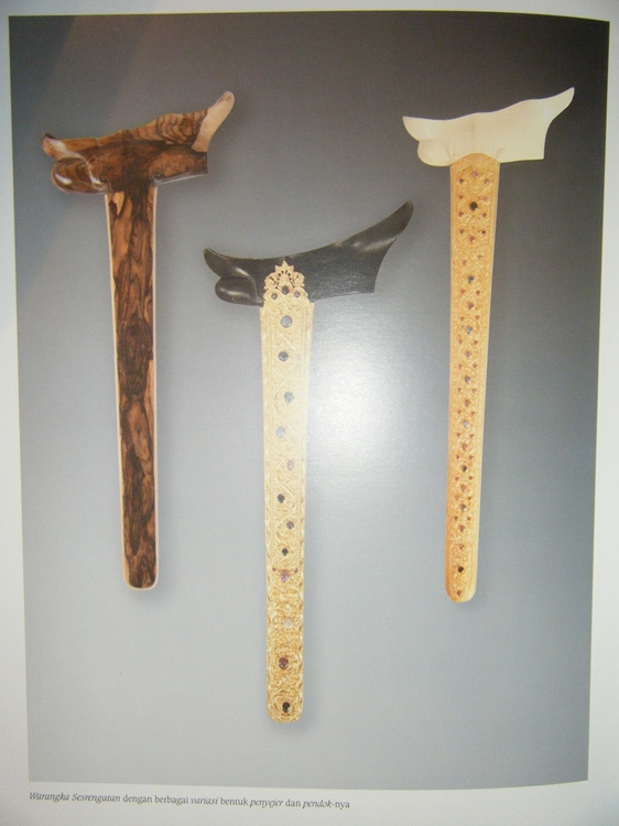

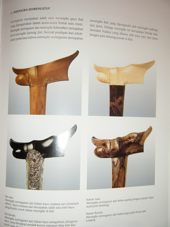

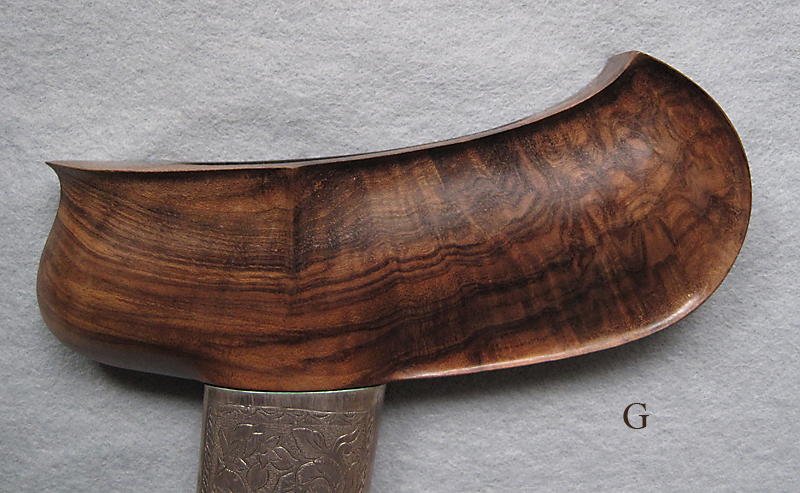

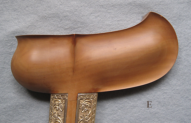

Old 2nd December 2011, 06:19 PM   #6

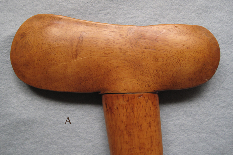

When I look again to your sheath I understand why you have thought that it is a sheath from Sumatra/Palembang. The sheath look like the carver hasn't known how to look a sesrengentan sheath from Bali and have created a mixture from this both sheaths.
For better understanding I have attached pictures from your sheath beside from both sheath forms. The sesrengentan pictures are taken from the book "Keris Bali Bersejarah".
