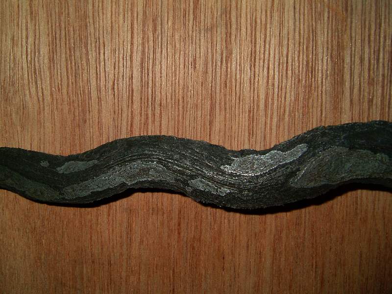

Below is an example of the results of a few hundred years of washing ; the parallel lines running down the blade are strands of the base iron .

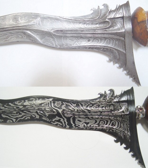

Why is the Iron black?? if you look at a modern keris like the one I seen on this forum (bellow) it is silver as we would expect since it is steel but my old keris is black like the one in your photo but it is not dye, the Iron is black

The iron in certain old blades is prized for it's quality. However, i am unaware of there being "black" iron. All keris that have the pamor pattern raised with the iron black get that way through a staining process which uses arsernic to stain the iron black while leaving the nickelous pamor material silvery or gray. Traditionally this was a process which was done on a yearly basis yielding the results you see in Ricks example.

Pusaka, i would image that if you ever (heaven forbid ) were to cut your old blade in half you would discover that it 's core is not black like the surface. You blade just has the remnants of it's last arsenic treatment.
