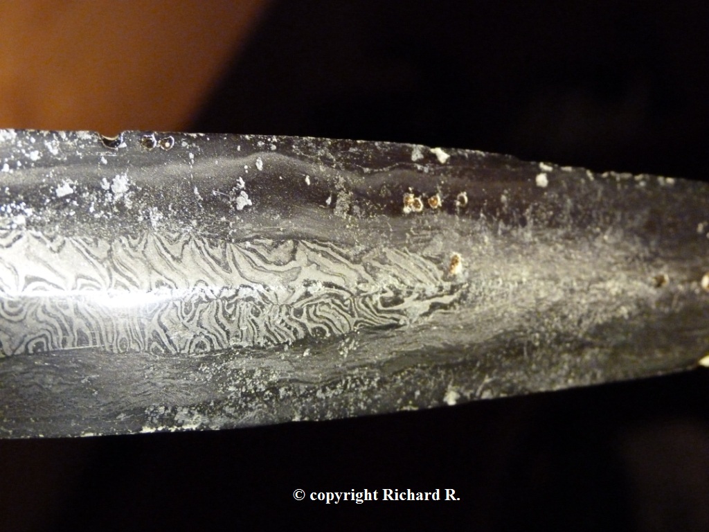

I developed an interest in twist core (pattern-welded) blades fairly early in my collecting 'career' and so I have accumulated a number of examples. At one time I naively believed there had to be a continuous path of the technique from medieval Europe, but I since have realized that it is, in the end, a relatively simple technique that any iron working culture will clearly discover at the forge. I do perceive that there is still a qualitative difference in the patterns in the medieval European material from the later ethnographic material, and I presume this arises from difference in material or in how the component rods were constructed. My 'ethnographic' examples, I believe dating from the 18th and 19th centuries, seem to follow the same patterns as are seen in modern bladesmith's work and in the earlier European revival of the technique.
I have an Ottoman rifle barrel obviously built up of twist core rods and dated to the 17th century when the previous owner lent it for a museum exhibition. I thought I had posted pictures on the forums in years past, but I have not found the correct keywords to bring it up if I had. I believe that such Ottoman barrels are found from at least the century before this and so, this may be the 'origin' in Ottoman work.
We know the medieval European work almost exclusively from archaeology; and not what will have come in to our collections from examples well-preserved and cared for indoors. Hopefully, some members will be familiar with local archaeological work for some of the 'ethnographic' types and be able to assist with an earliest date for those types.
Outside of keris and nihonto, the other issue is that we often do not know what we have. One yataghan of mine has an inscribed date in the 18th century; I believe another to be older. I suspect my 'protobudiak' may be otherwise be my earliest example; but as yet, I have no framework upon which to accurately date the blade.
I will ponder this and try to bring a few examples up on the board for discussion.

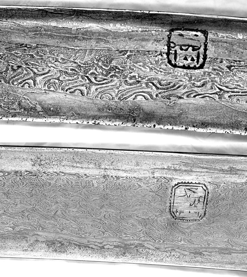

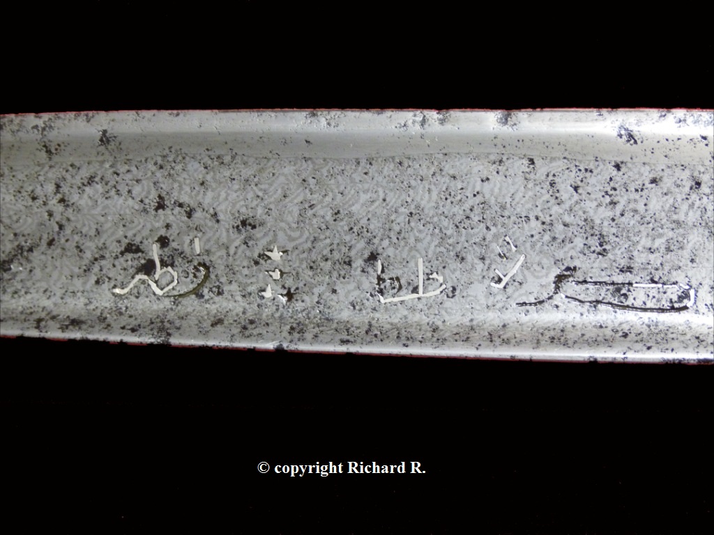

I had only viewed the mark on the older yataghan in abstraction previously, but if we accept the bottom line in the cartouche on the lower blade as the date 1204 (=1799, just barely 18th century) and interpret the similar region of the upper cartouche as being an honest date, then 1001 (=1592).

I wish I knew. I am going to guess that the mounts were serviceable and in current 'style' when the spear left home, likely about a hundred years ago. When I dismounted the blade, there was no evidence of fresh rust in the mastic. However, the tang has heavy stable dark oxidation, just as I have observed in older (koto) Japanese swords, so I suspect this spearhead was far from new when last mounted. I have tried to lure the forum community into trying to work out geography versus chronology in the styles of these lance heads and that should ultimately be possible, but I doubt there will be reliable absolute dating unless some new technology emerges.

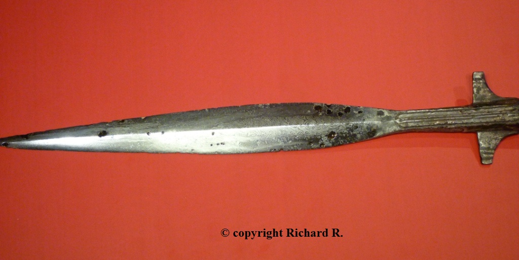

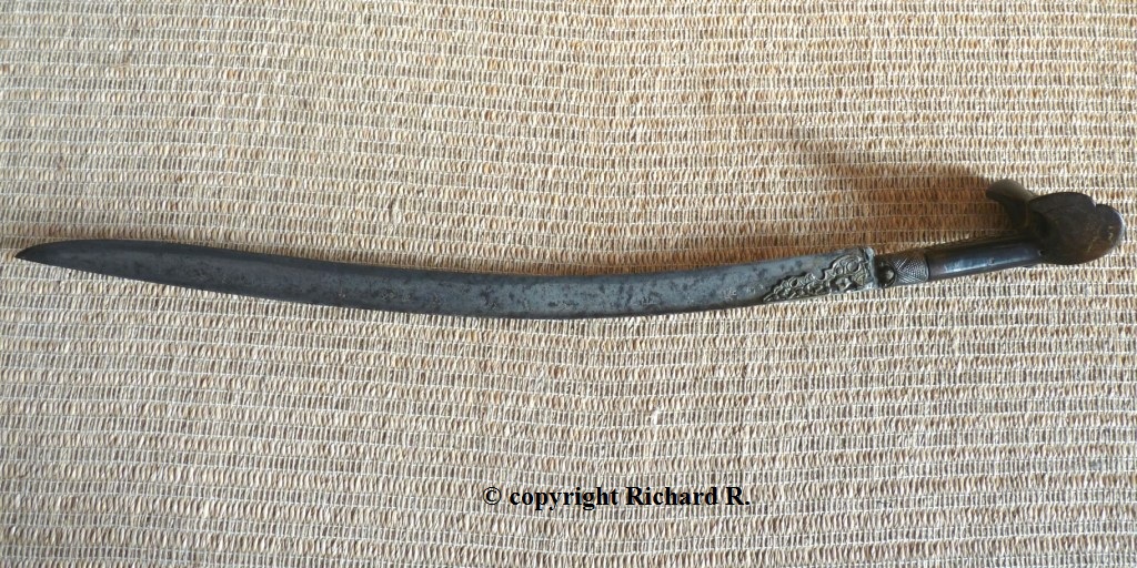

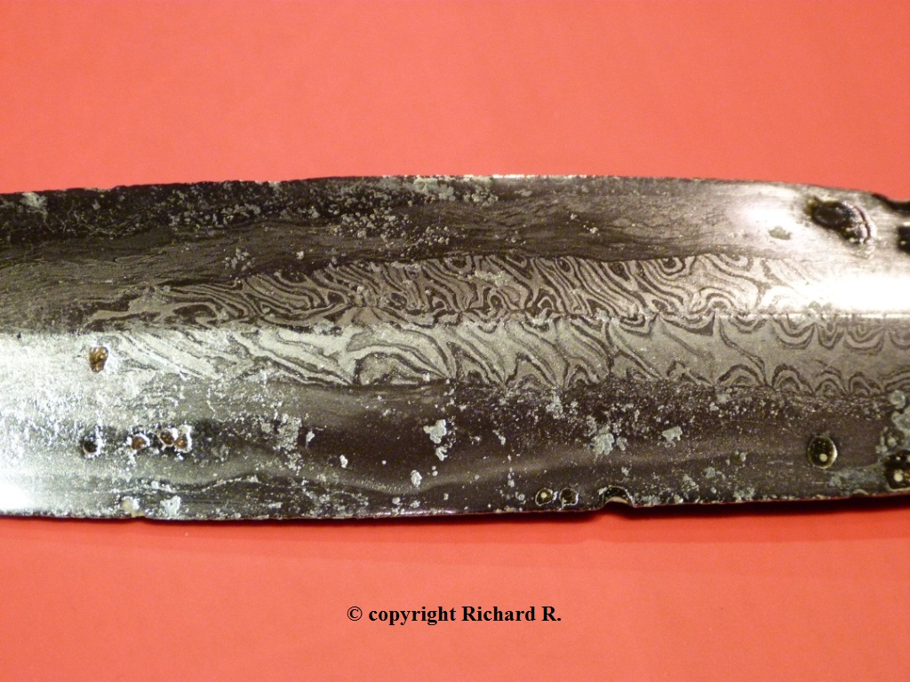

Thank you for the very good pictures. Could you send me pictures where I can see the whole Yataghans? I attache some pictures of a yataghan of my pattern-blade-collection. I need some help. Any ideas about the age and origin of this blade?
You also can find two pictures of a polished 9th Century twist core Western-European Spearhead to compare with your Eastern Spearhead.
Richard

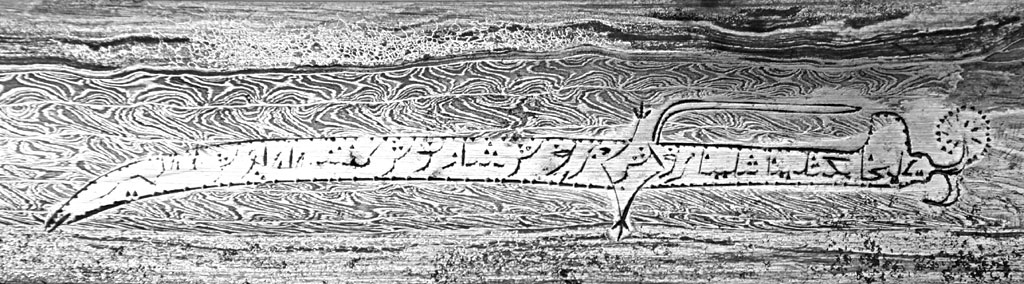

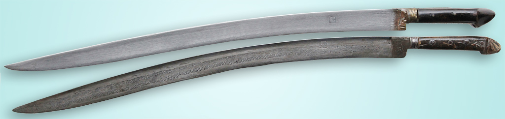

As requested, an overall picture of the yataghans (caution - the order is reversed from the close up of the cartouches above) and also of an inscription on the newer blade.
Unfortunately, I am no yataghan expert, having only collected a few with good examples of the twist-core work, so we will have to rely on other members to assist with the age and origin of your example.
Your winged spearhead is most attractive and it is nice to see the pattern-welding brought back to its former glory. Presented in polish, the nature of the bands of twist core is very reminiscent of what we are seeing on the yataghans.
