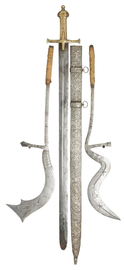

This recently sold at auction in the UK, did a forumite get it by any chance? It fetched quite the price. Scabbard is silver according to the auction description.

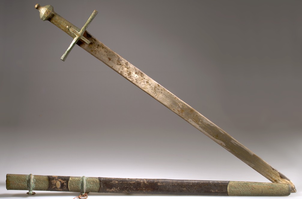

Has this style been identified with a particular area or time period? It is certainly quite different from the usual styles of either the Beja swords or the Darfur examples. In fact in some ways it is closer to a takouba with a bulbous pommel and rounded tip...
I'm aware of a similar piece in the American Museum of Natural History collections, but don't recall off hand any other examples like this (although I am sure there are).
Anyone have insights into this?

Just in case my initial post wasn't clear, I didn't win it (or even bid!), but the sale price inclusive of premium was £2,160. More than a little out of my league. I'm not even sure if the price wasn't more for the throwing knives... I gather they are quite rare.
Any thoughts on on regional or ethnic classification for the sword? I find it quite different visually to the examples usually encountered, particularly the blade geometry.

Is that it? how much???? What about thoughts on period (Mahdiyya) or more on regional possibilities

Very nice sword. My guess it was made in Egypt as a presentation piece. Makers used Mamluk style grip and cross guard to simulate a Sudanese kaskara. Virtually no design elements suggest to me a Sudanese origin.

Thanks Stephen!!! Thats more better!!!! I think these presentation type pieces took on quite more elaborate character during the British occupation of both Egypt and Sudan post Omdurman and as noted by provenance much later.

Sadly that was the only auction picture I'm aware of. I'd forgotten to include the provenance, thanks Stephen.
I'd also wondered about an Egyptian connection, the style does seem fairly classic Mamluk? In particular the scabbard construction is certainly not normal for Sudanese swords.
If these are presentation pieces... I have to wonder if they are entirely from the early 20th century to cater to British tastes... Or if there is some old example which could give some insight instead into the influences the Sudanese swords themselves draw on? The question of course is, was the example in this thread made for the British gentleman who took it home? Or something older...

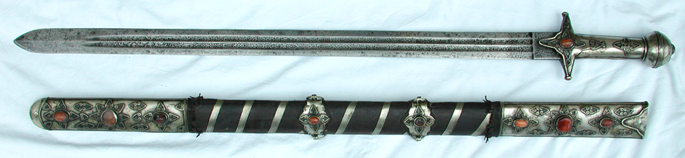

Here is the other example of the style I'm aware of - from the AMNH online collections. Donated to the museum in 1974. Interestingly there seems to be a engraving or stamp on the blade near the guard.

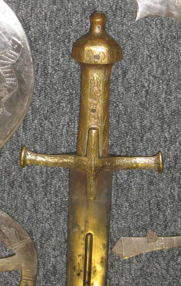

Here are some hilt detail images, I hope they help your discussions.

Thanks Gav, that answers a lot of questions for me. The entire thing looks rather new...
I guess then this was a "made for export" item. Still an interesting hybrid of influences.

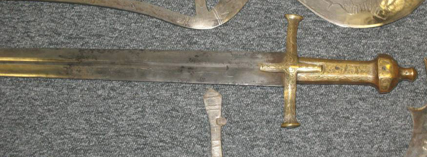

Well done Gav.
This is interesting. I don't immediately recognise the decoration as Egyptian work now that I can see it more clearly.
In fact it reminds me more of the style of decoration sometimes seen on the brasswork of Telek daggers.
The close-up also seems to show an abnormally long tang with two or is it three? pegs running almost to the top of the hilt.

This sword seems to be a ceremonial or diplomatic item which reflects influences of domed type pommels on some swords hilted in San'a or perhaps Hadhramaut in Yemen. In the time of the Anglo-Egyptian condominium the British Protectorate of Aden in Arabia included these regions, which were in turn of course connected to Khedival Egypt and the Sudan.
Iain, the example you show in post #10 has scabbard mounts very similar to sa'ifs mounted in Hadhramaut.
The kaskara style in the remainder of the hilt is evident.

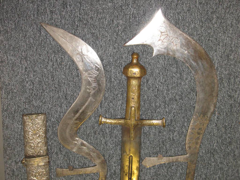

The two knives are Kpinga from the Azande of S.Sudan in form and again evidently produced in embellished form for probably diplomatic purposes as gifts and representative in grouping of traditional weapons.

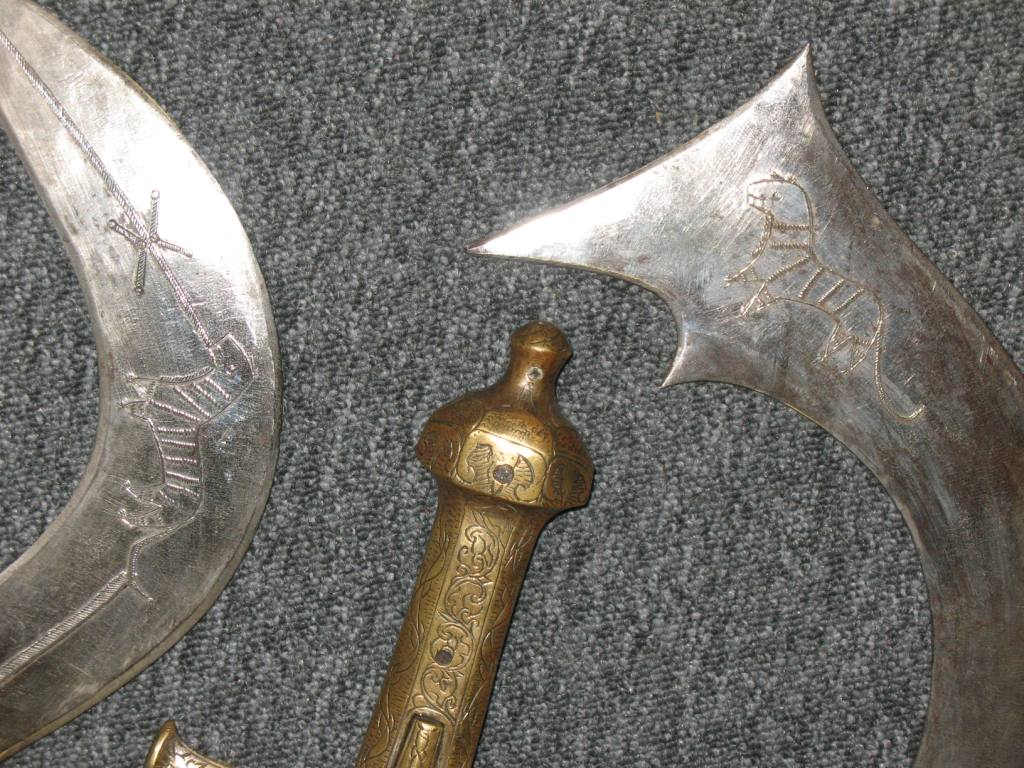

Regarding the two throwing knifes, which belong to this sword lot. They are also a bit strange and not decorated in the traditional style. The shape is the shape from the two main typs of the Ingessana throwing knifes, one the so called sai ("serpent") and the other typ called ("muder"), the scorpion. But incised patterns on the blade's surface represent normal a snake, lizard, and spider and a scorpion in the second case and not this animal (maybe lion) we can see on the blades. So they are for sure not produced for the Ingessana.
Wodimi is offline   Reply With Quote

Thanks for the additional closeup photos of the knives. I think it is pretty easy to see the quality of the work and if I am not mistaken the execution of the shape and form of the knives (not just the engraving) looks a little "off" as well.
Personally I find it fascinating that a "weapons for tourists" industry sprang up so quickly and from outside the ethnic origins of the weapons themselves.
