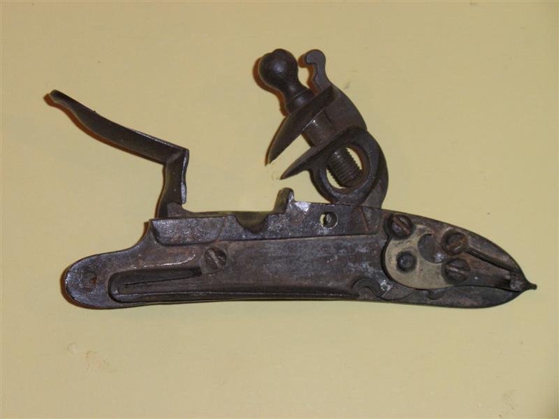

Hello all. Well, here goes with another lock. Can anyone identify this as a European lock? Lockplate is 6 3/16" long X 1 3/16" wide. Unfortunatly, there are no marks of any kind on the lock. The really unusual thing is the bridle - only - is made of brass. The rest of the internal parts are iron. The brass bridle has the same amount of wear and patina as the rest of the lock. Three of us are speculating back and fourth on this lock. One of the most unusual I've seen. Any speculation appreciated. Thanks, Rick.

Para mí se trata de una llave militar, copia del modelo francés, de las últimas llaves (Lock) de chispa (flintlock). El pié de gato (cock) es del tipo reforzado (Chien a espalet) y no del tipo "Cuello de cisne ". Lo realmente raro es la brida (bridge) de bronce. Puede ser una copia del algún país europeo
AHello, Rick
For me it is a military key, copy the French model, the latest keys (Lock) spark (flintlock). The cat's foot (cock) is reinforced type (Chien to espalet) and not like "swan neck". The really strange thing is the clamp (bridge) of bronze. It may be a copy of any European country
Affectionately. Fernando Kfectuosamente. Fernando K

Hi Rick,
I agrree with Fernando K.
French military lock, ca. 1750-60. The brass bridle retaining the tumbler is highly unusual indeed. Might also have belonged to a pre-Revolutionary American musket or pistol.
Great condition, anyway!
