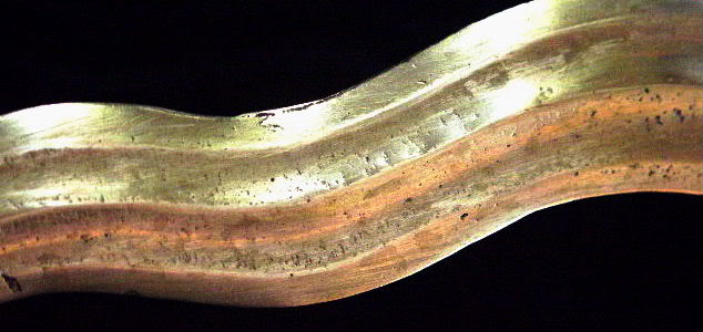

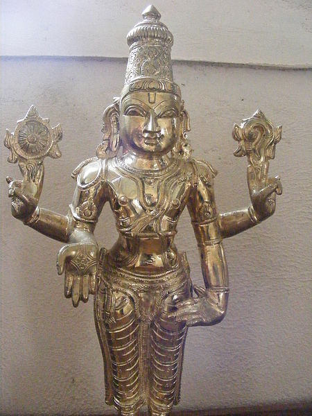

I cant upload a picture of the pendok right know but it is the same colour as this panchaloha statue, not as yellow as brass but not as rich/golden as gold. It hasn’t tarnished unlike a brass pendok. There is nothing special about the construction of the pendok itself, actually very plain.
I have seen a metallurgical analysis of antique Tibetan singing bowls and it demonstrated that they were made from a complex alloy which contained also quantities of gold and silver.
My understanding is that they were (not modern ones) made from five metals (panchaloha) and westerners made up this concept of them being made of seven metals to fit their own understanding i.e. one metal for each planet.
Just consider the addition of quicksilver to represent the planet mercury and you will know it is impossible i.e. it will boil off before the other metals are even red hot filling the room with mercury vapor

The photo of the statue is fairly useless in this conversation since the true color of the mixed metals here are unknown. Color shifts dependent upon light in which it is shot and white balance used. Also colors shift from one computer screen to another. Telling us that your pendok looks like the metal in this statue does not bring us any closer to determining the materials that your pendok have been made of. It probably looks different on my screen than on yours. You would have to have it tested to know anything definite.

I've got a pendok that is on an old Solo keris that is made from a metal that is the colour of copper, but it has never tarnished like copper. It is definitely not suasa, I have no idea what it is. I've had it about 45 years.
The keris that goes with this keris has some kinatah work that I thought was brass when I bought it, but it also never tarnished, and is not gold.

The pendok looks like copper, but has never tarnished like copper; it has not maintained a bright, polished finish, but the build up of tarnish that we commonly find on copper that has never been polished over an extended period of time is missing.
The kinatah on the blade has a brassy look to it, but again, no cleaning for the time I've had it, just an occasional oiling, and no tarnish. I've had keris with brass kinatah, and in my experience the kinatah has tarnished pretty quickly.
I find this puzzling, but it is fact. Don't ask me to explain it, I cannot, I'm simply reporting it.

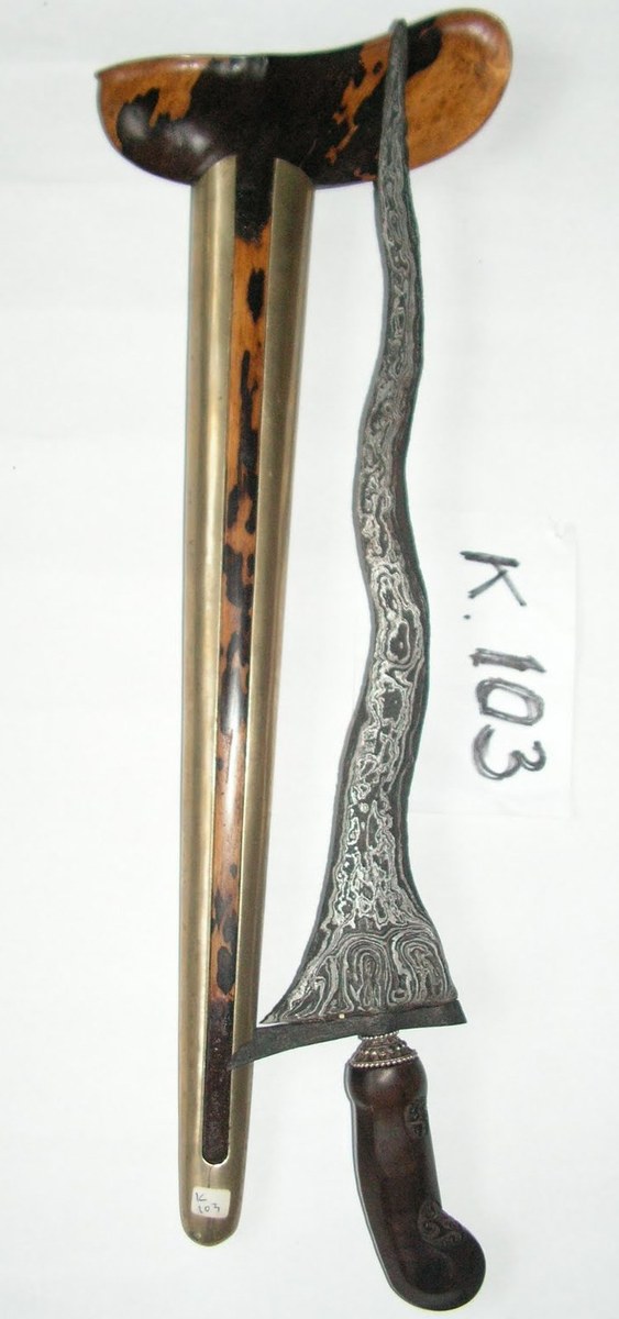

I think that the alloy described by Pusaka could be gongso, I saw some very nice pendoks made from this materials but don't own any in my collection. I have some old "singing" bowls and confirm that they did not tarnish at all since 20 years, I can send some pictures if you are interested.

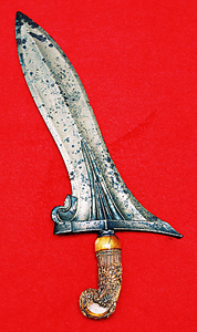

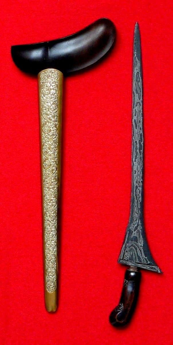

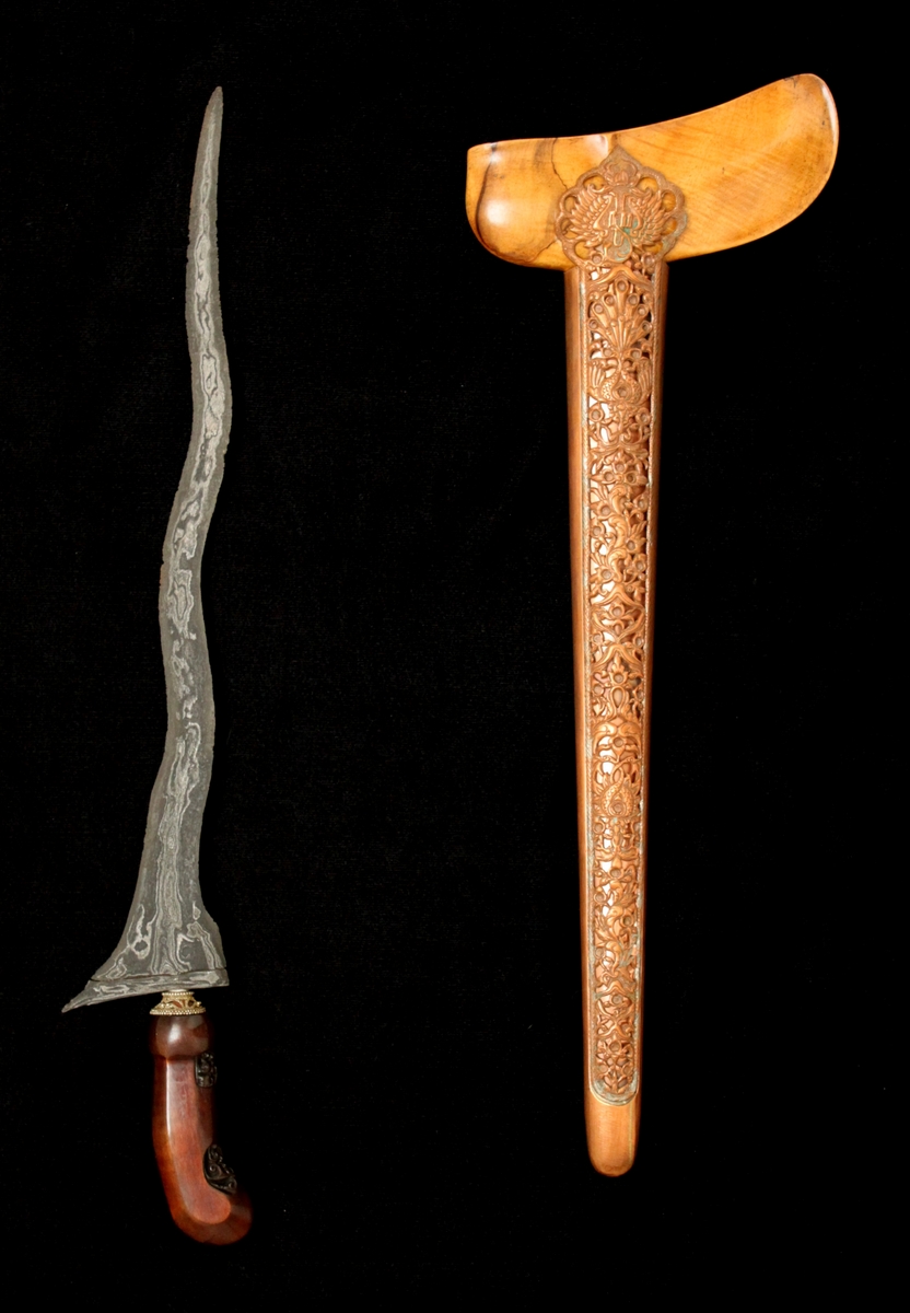

Sorry, I forgot this kris (1.4.4) which has a pendok made from gongso I think (looks like gold, very thick, does not tarnish).
And the pendok of kris 1.4.13 is made from a copper alloy which does not tarnish much as described by Alan.

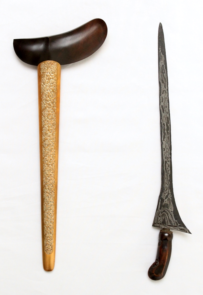

Jean I think you hit the nail on the head, I did a google image search for gongso Pendok and have included the an image below. This pendok looks exactly like mine, as you can see it also has not tarnished.
What I also found very interesting is that when I did the search I found many images of gamelan instruments which suggests that musical instruments are also made of this alloy. It would be very interesting now to know what gongso is made from and if it is similar to the metal Tibetan singing bowls are made from.
http://cherykeris.blogspot.com/

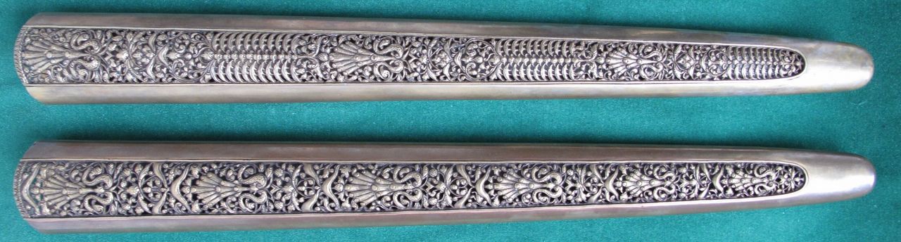

Since last year, in jawa tengah we have a lot of pendok gongso for sale. Most of them is jogja style with silver plate in the middle. The price is quite dear due to gold content (very little) and hard to make, unlike silver easier to work on.
Some people selling Bronze pendok (dirty - and called it gongso). If broze; when cleaned we can see the bronze color but with gongso - you still can see the gold color like Suasa (but the one with very low gold content). As you may know suasa also have different colour depending their gold content.

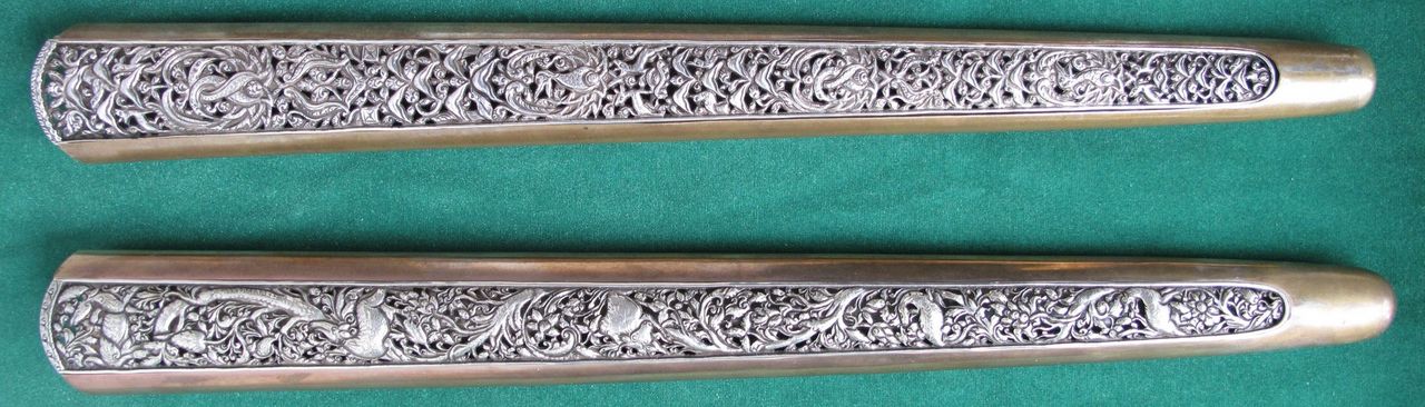

Originally Posted by rasjid
Since last year, in jawa tengah we have a lot of pendok gongso for sale. Most of them is jogja style with silver plate in the middle. The price is quite dear due to gold content (very little) and hard to make, unlike silver easier to work on. Rasjid
Attached are examples of such gongso pendoks with silver slorok.
Best regards
